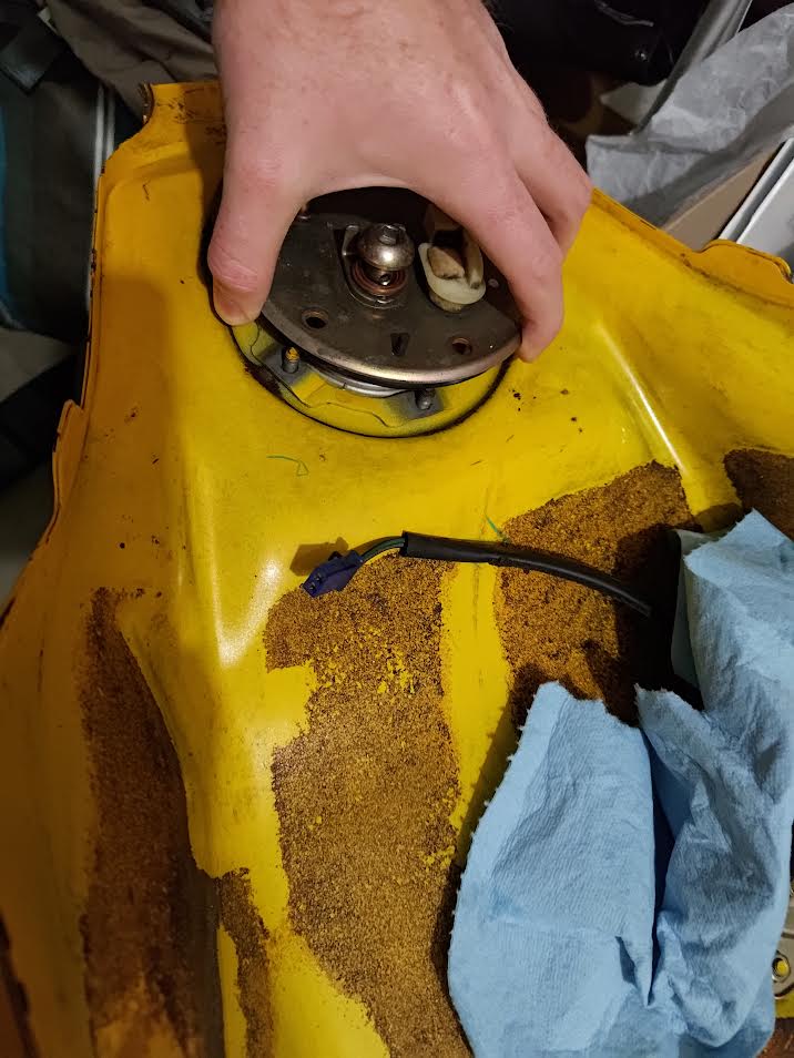

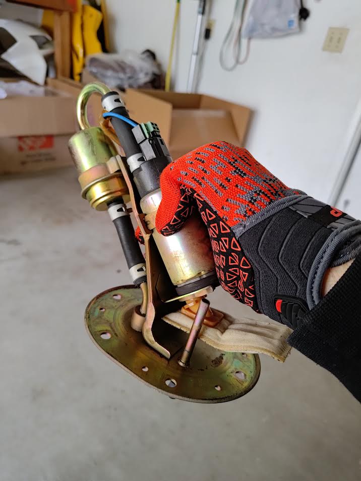

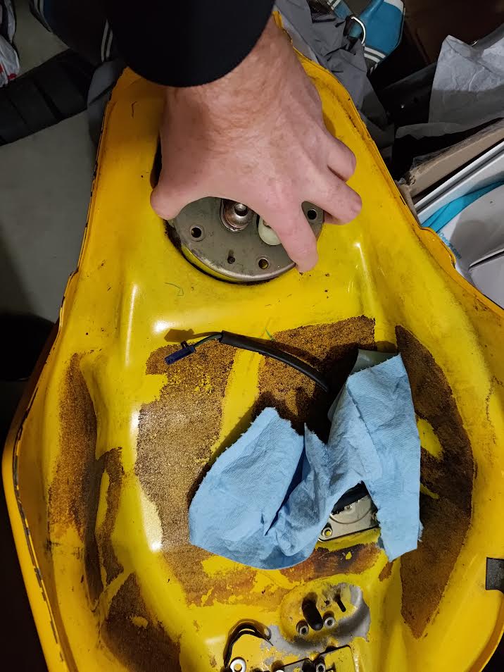

Member Contributer Ughandi Posted February 24 Member Contributer Share Posted February 24 Howdy, VFRD! In my effort to take everything apart and go boldly where no man has gone before on this hog in 23 years, I decided it would be a good time to take a look at that fuel filter. ...However I cannot fadangle nor finesse the darned thing out. Any advise, tips or tricks to pull out the unit would be more than welcome!! Some off topic questions as well: - Is there anything else I should do/replace "while I'm in here"? (seals, hoses, etc) - How can I scrub that OE glue off of the tank? I'm getting nowhere fast with a sponge and rubbing alcohol & brake-clean, and I'm going to need a clean surface for the heat shielding I'm going to apply underneath the tank. Muchos Gracias! Quote Link to comment Share on other sites More sharing options...

Member Contributer ShipFixer Posted February 24 Member Contributer Share Posted February 24 For awareness...a lot of the stuff around the bottom of the pump is the metal mesh filter and a rubber bladder thingy that sort of prevents starvation at low levels. So there is a lot of "give" in these two things as you try to wiggle the pump out. Good news is goes-in is easier than goes-out! 1 Quote Link to comment Share on other sites More sharing options...
Member Contributer Ughandi Posted February 24 Author Member Contributer Share Posted February 24 6 hours ago, bmart said: I've had good results including swearing. 4 hours ago, ShipFixer said: So there is a lot of "give" in these two things as you try to wiggle the pump out. So It sounds like I should just muscle up and "Give Em" to remove the assembly. Thanks, folks! Will report back with results. 6 hours ago, DannoXYZ said: acetone or adhesive remover (xylene). Also Goo-off The first one of these I find at home depot wins. Thanks!! Quote Link to comment Share on other sites More sharing options...

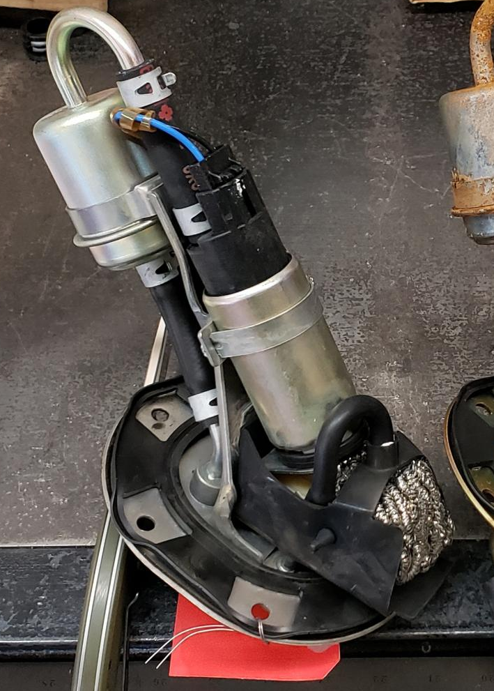

Member Contributer Tirso Posted February 24 Member Contributer Share Posted February 24 Borrowing a pic from Seb's recent Ultimate post, on the attached picture on the lower right you'll see the rubber bladder holding the metal mesh. I used nylon pry tools to move the rubber/metal combo out of the way. As mentioned installation is easier. Sugget replacing the rubber gasket used to seal the fuel pump to the tank. Also, what heat shield are you using? 1 Quote Link to comment Share on other sites More sharing options...
Member Contributer Ughandi Posted February 24 Author Member Contributer Share Posted February 24 Success!! ...but basically everything rubber turned to rocks, which is probably why It was so difficult to remove. I'll have to order all the bits that are no longer attached 😅 Will also order a new fuel filter with the u-turn on it. Honda does not seem to sell the filter anymore. Anybody have a good experience with Quantum Fuel Systems? https://www.highflowfuel.com/quantum-fuel-filter-for-honda-vfr800-1998-2009-replaces-16700-mcw-d02/ I hate the $40 price for a filter, so I'm open to creativity here. 4 hours ago, Tirso said: Sugget replacing the rubber gasket used to seal the fuel pump to the tank 10-4. Mine was permanently deformed after removal. Partzilla to the rescue! 4 hours ago, Tirso said: Also, what heat shield are you using? DEI Reflect-A-Gold. I am told it's the good stuff. 9 hours ago, bmart said: Whichever is less likely to be damaged I ended up damaging everything rubber to get that sucker out, levering with a mini-crowbar, but we made it work! 😁 3 Quote Link to comment Share on other sites More sharing options...
Member Contributer Dangeruss Posted February 25 Member Contributer Share Posted February 25 I bought all the parts to redo mine but haven't tackled it yet. I really resented giving Honda $12 for a pot scrubber in a Honda bag. I got a new filter from them as well, the filter listed for '98 and '99 was NLA (straight filter with long 'J" shaped hose), but the '00 and '01 part is still available. It's the filter as shown in your picture, curved pipe and a straight hose, pretty sure the filter/hose combined ends up the same. Both parts are still available. The inlet strainer is not available as a separate part, it comes with the pump. If a $40 filter eats at you don't ask what the pump costs. FILTER, FUEL 16900-MBG-013 HOSE B, FUEL PUMP 16712-MBG-010 2 Quote Link to comment Share on other sites More sharing options...

Member Contributer Ughandi Posted March 17 Author Member Contributer Share Posted March 17 It's Fuel Pump Friday, everybody!! Partzilla took a HOT minute, but they did deliver! Out with the old... etc,etc. My inner pyromaniac tempted me to light the old filter up, but I resisted. And as assembled, she stands strong It did go in a bit easier than it came out, most likely due to the new rubber having an ultimate tensile strain of greater than 1.00005 Onwards and upwards!! Quote Link to comment Share on other sites More sharing options...

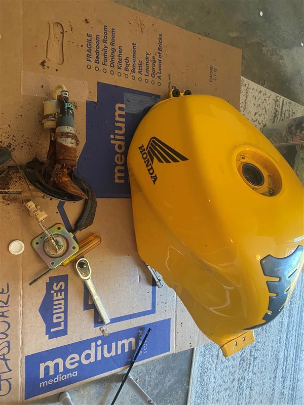

TDChip Posted April 12 Share Posted April 12 On 2/24/2023 at 4:44 PM, Ughandi said: Success!! Hey! How does the pump work? Does the pump leak gas when the bike is off? Before I found this thread, a mechanic told me that the Quantums don't have a fuel cutoff (something OEM has) so if there is a full tank, the pressure can push fuel into the engine when the bike is off. Quote Link to comment Share on other sites More sharing options...
TDChip Posted April 12 Share Posted April 12 This is what I'm struggling with... Quote Link to comment Share on other sites More sharing options...
