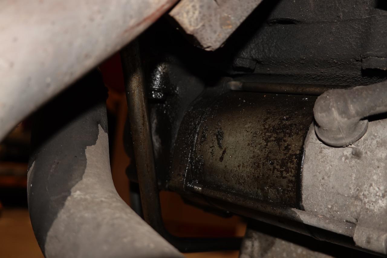

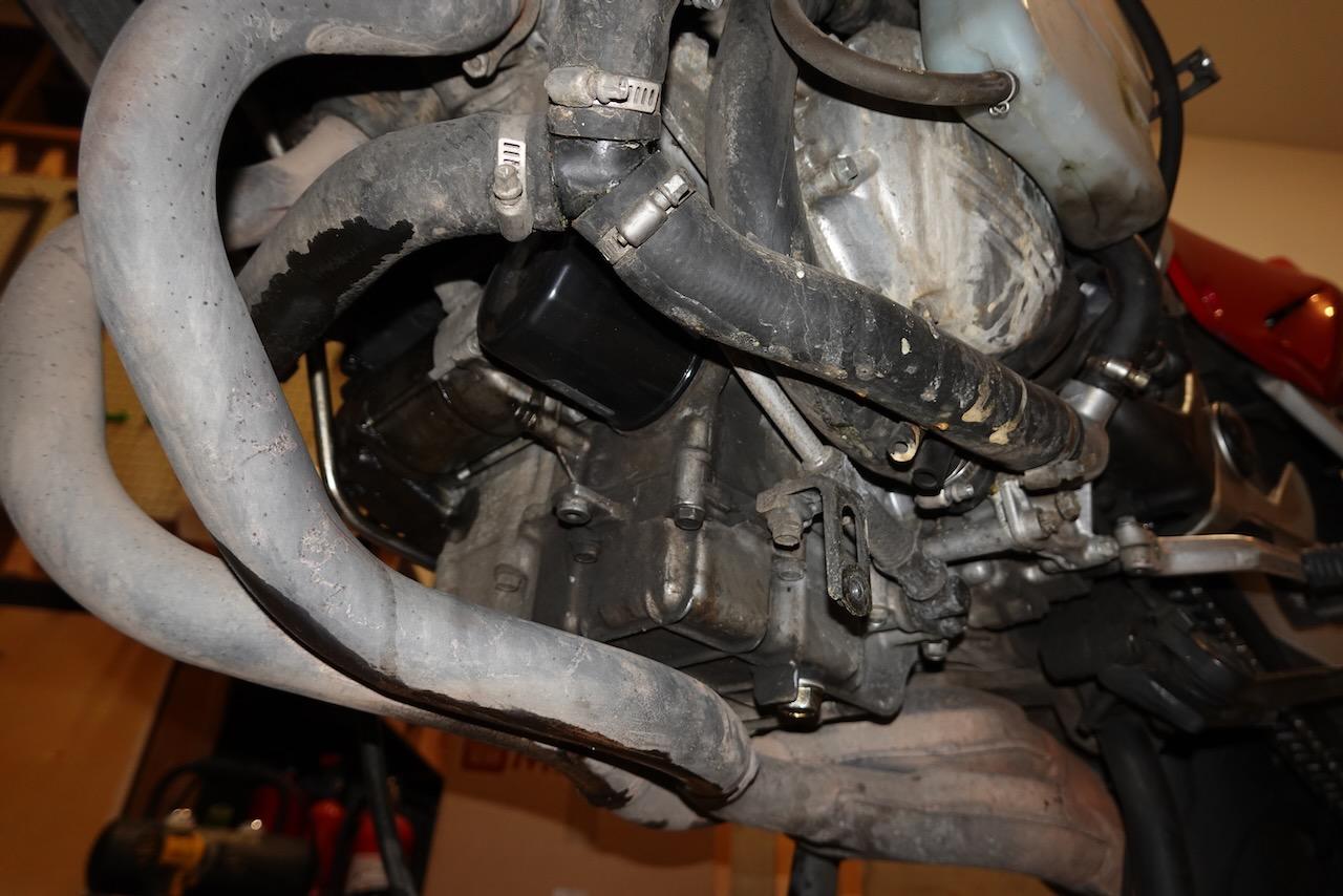

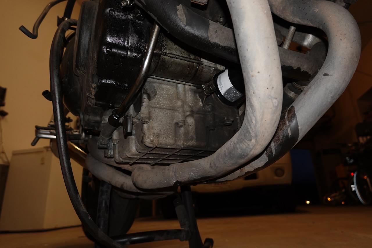

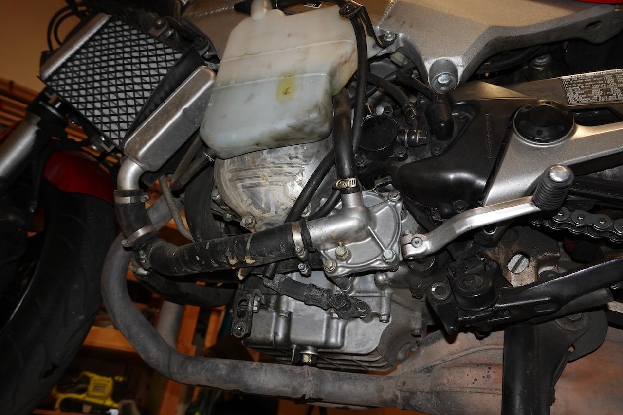

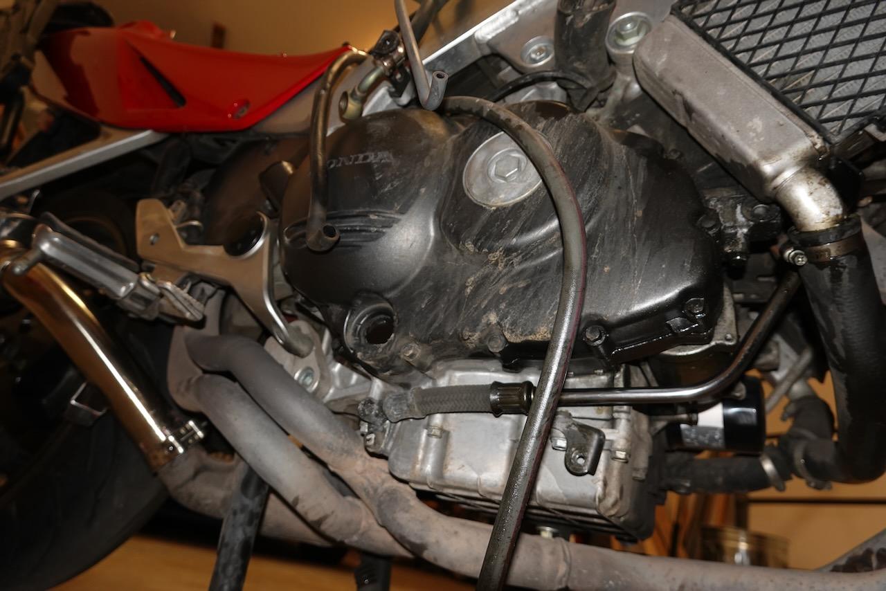

Rode my '99 (50k miles on it) home from work on Monday and discovered it was dripping oil on the garage floor immediately. Left a puddle maybe 1/4-quart size on the floor overnight!
I pulled the fairings and gas tank off last night knowing that the rear valve cover gasket has been slightly weeping for a while now, but that didn't look like the cause. Probably long overdue for a valve adjustment anyway so I plan on pulling it all apart.
When I got the fairings off I discovered that something had been *spraying* oil somewhere below the front head exhaust outlets. The lower coolant hose was wet, the insides of the lower fairings were wet, and the starter is soaked. It's wet enough that my only worry is if I just start cleaning it off I won't be able to see where the leak is coming from, but I also can't pinpoint anything now. The front valve cover gasket is still fairly clean and most of the oil was below the head, so I don't think it's the valve cover.
Any ideas, and has anybody seen a leak like this? I'll keep pulling it apart to see what I find. Also looks like my coolant bottle has overflowed or leaked before. 😢
Thanks in advance for any help!

Looking at your pictures the oil starts higher than the filter & lower than the head the last pic shows the hard oil cooler line covered in oil, so thats my prime suspect.

Good point Mohawk. A close look at photo 2 shows the oil level sight glass, its well overfilled and this is after the  discovery of the leak. Seems like a very overfilled oil scenario.

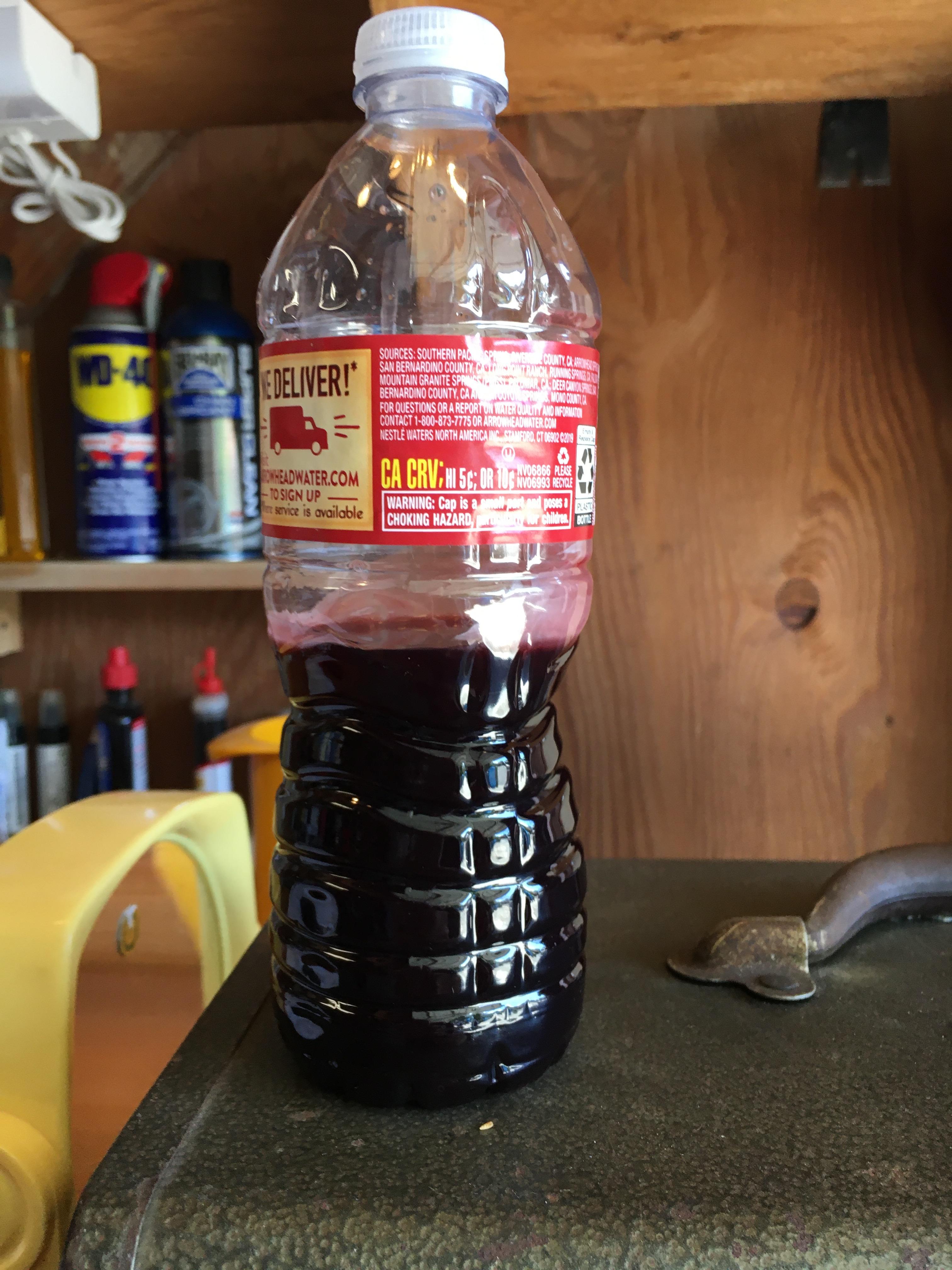

I am lucky to have an independent shop that I can walk home from. The mechanic is a former long time Honda dealer tech. But...he is getting closer to retirement, and last May I had a "leak" on the RC-51 which I could not diagnose, a week after returning from the shop. Got a siphon out, and this is what it took to get the oil level down to the top marker on the glass eye:
