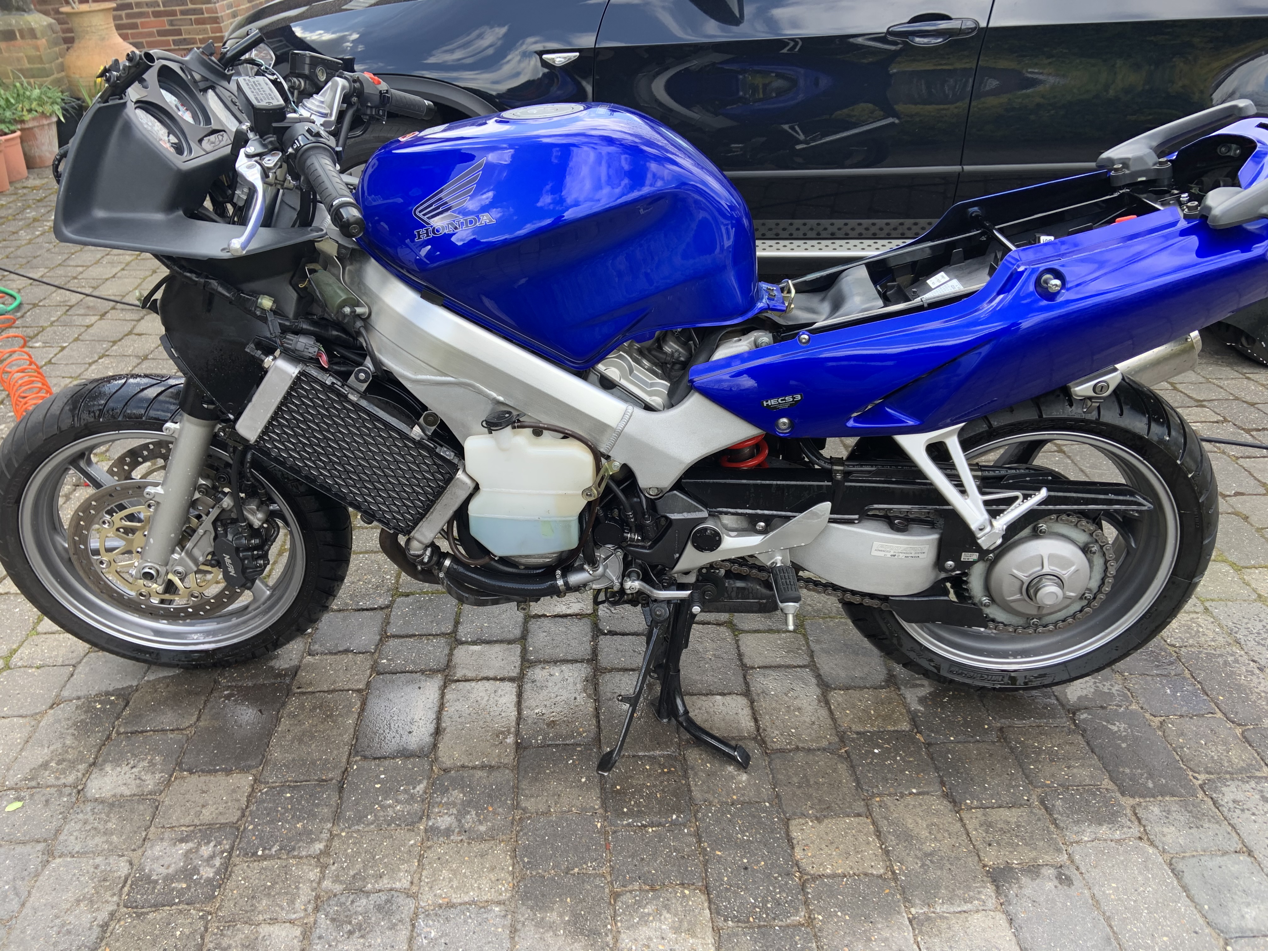

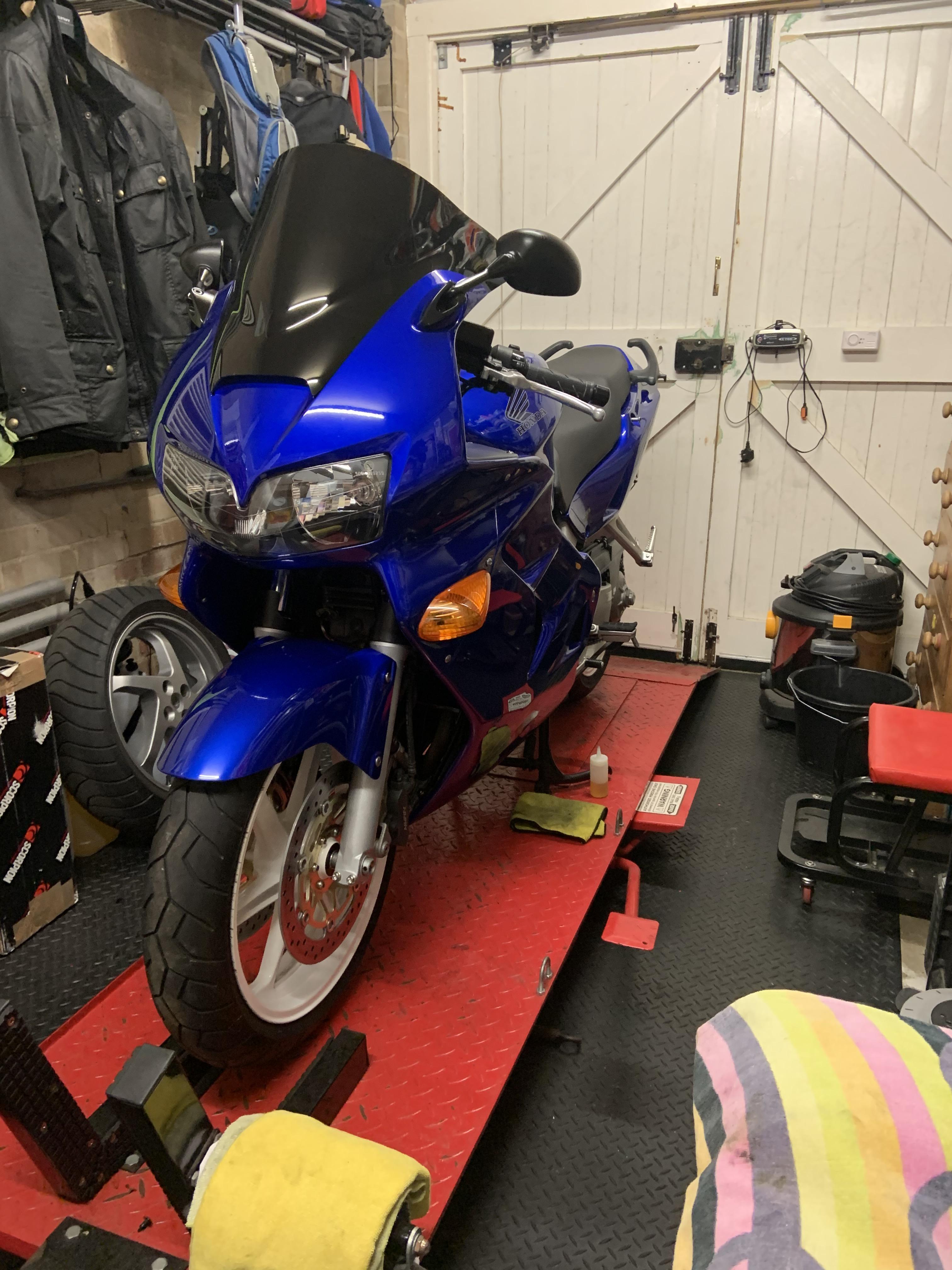

This is how it came to me and it is presented to you after a wash.
First job was to strip it of all its bodywork and give it a really good clean .

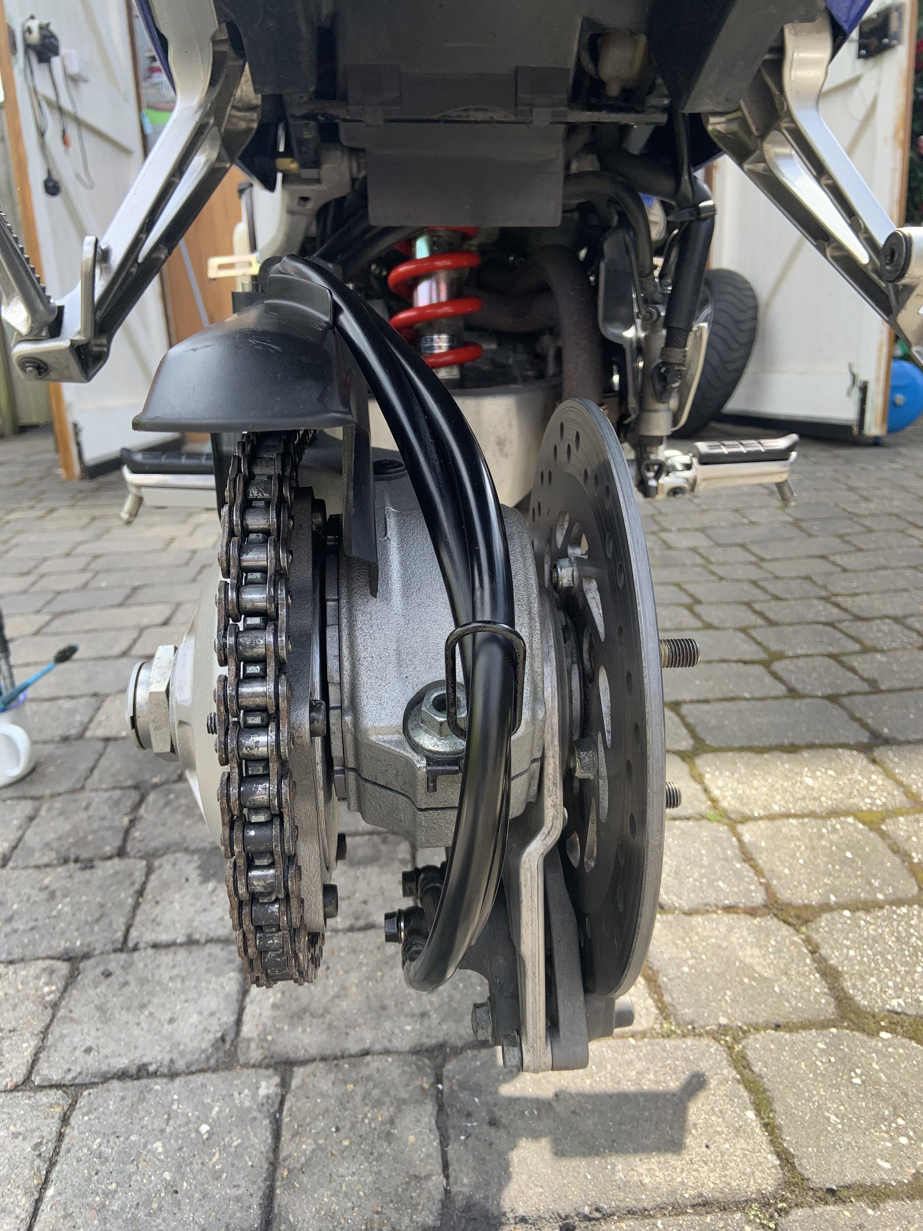

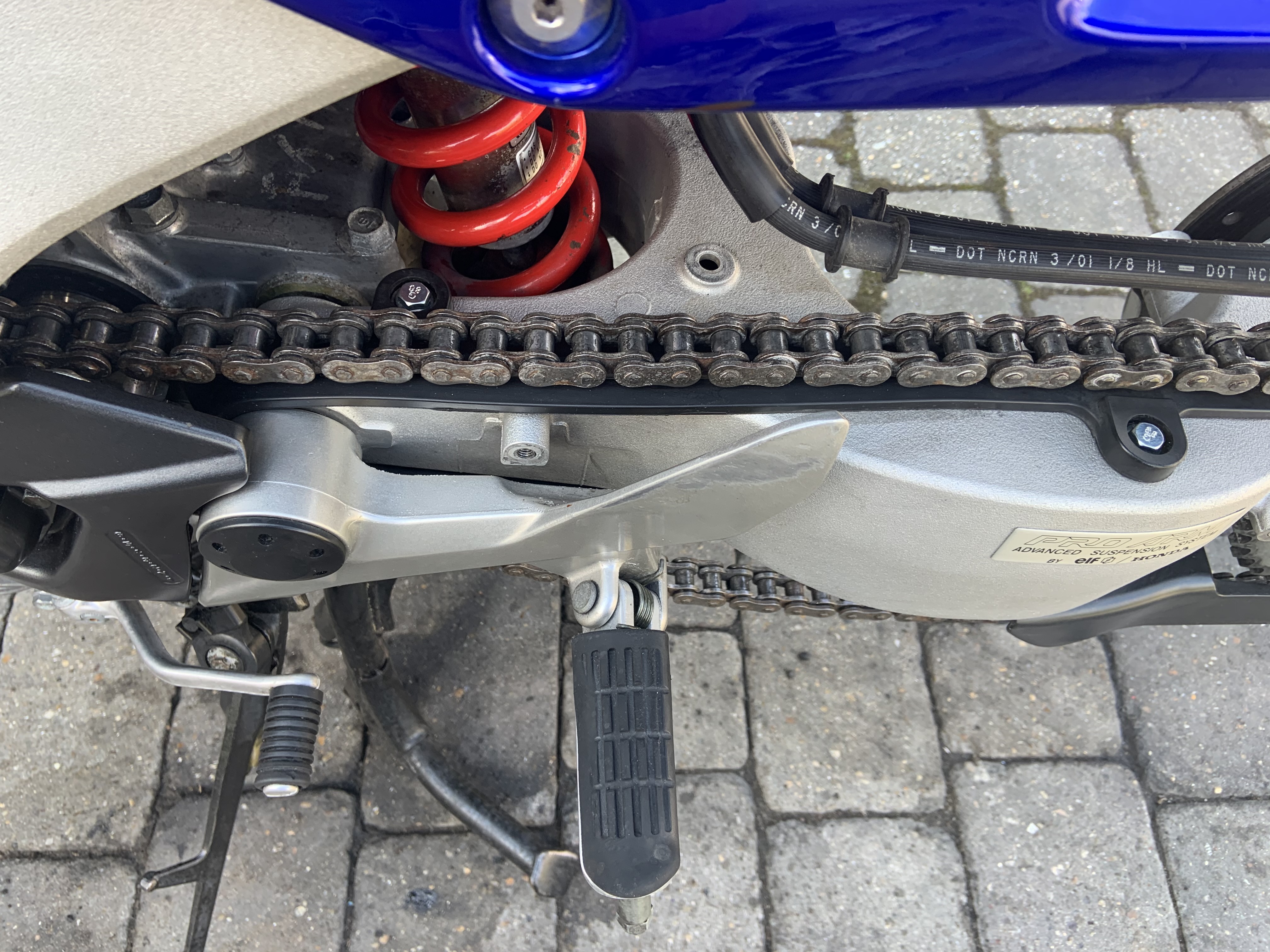

There was 2 years of chain wax/grease all over the back of the bike and the front sprocket cover was oozing the stuff.
All cleaned up .

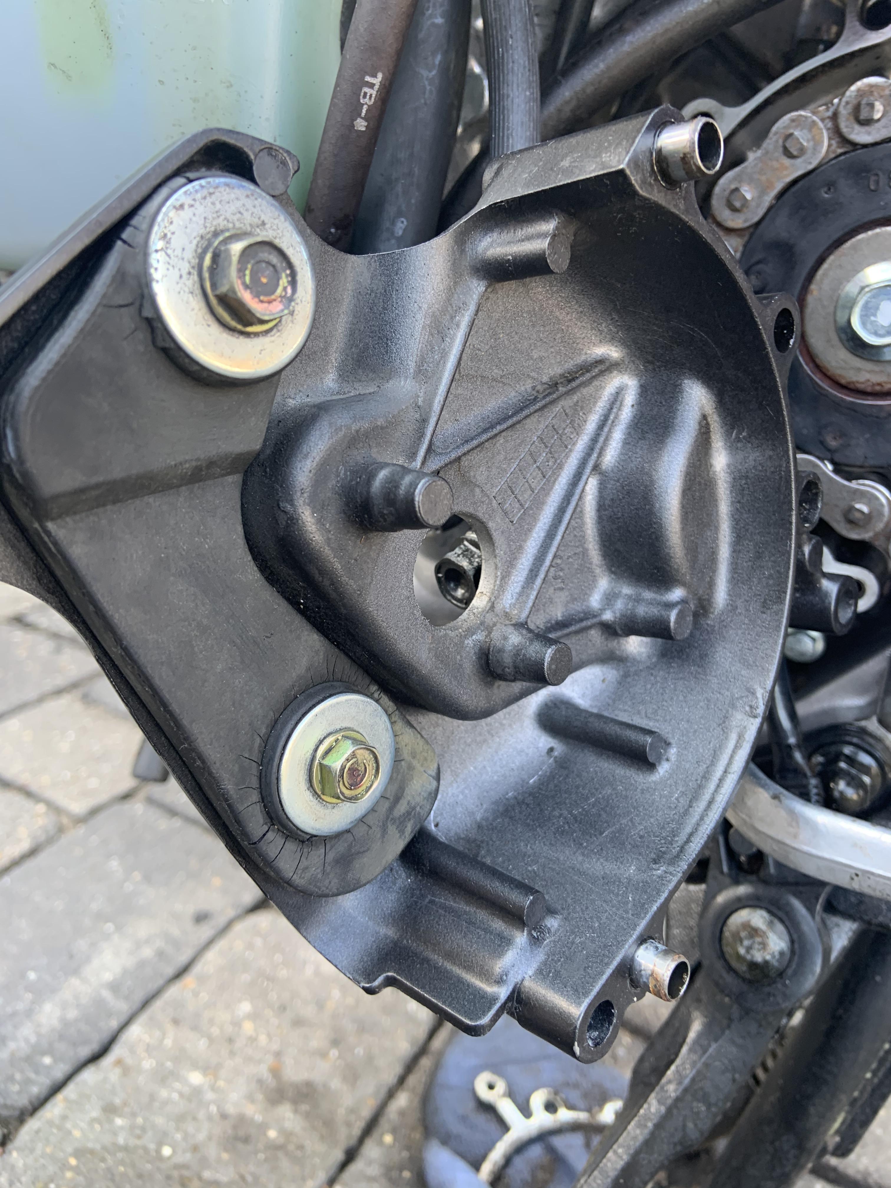

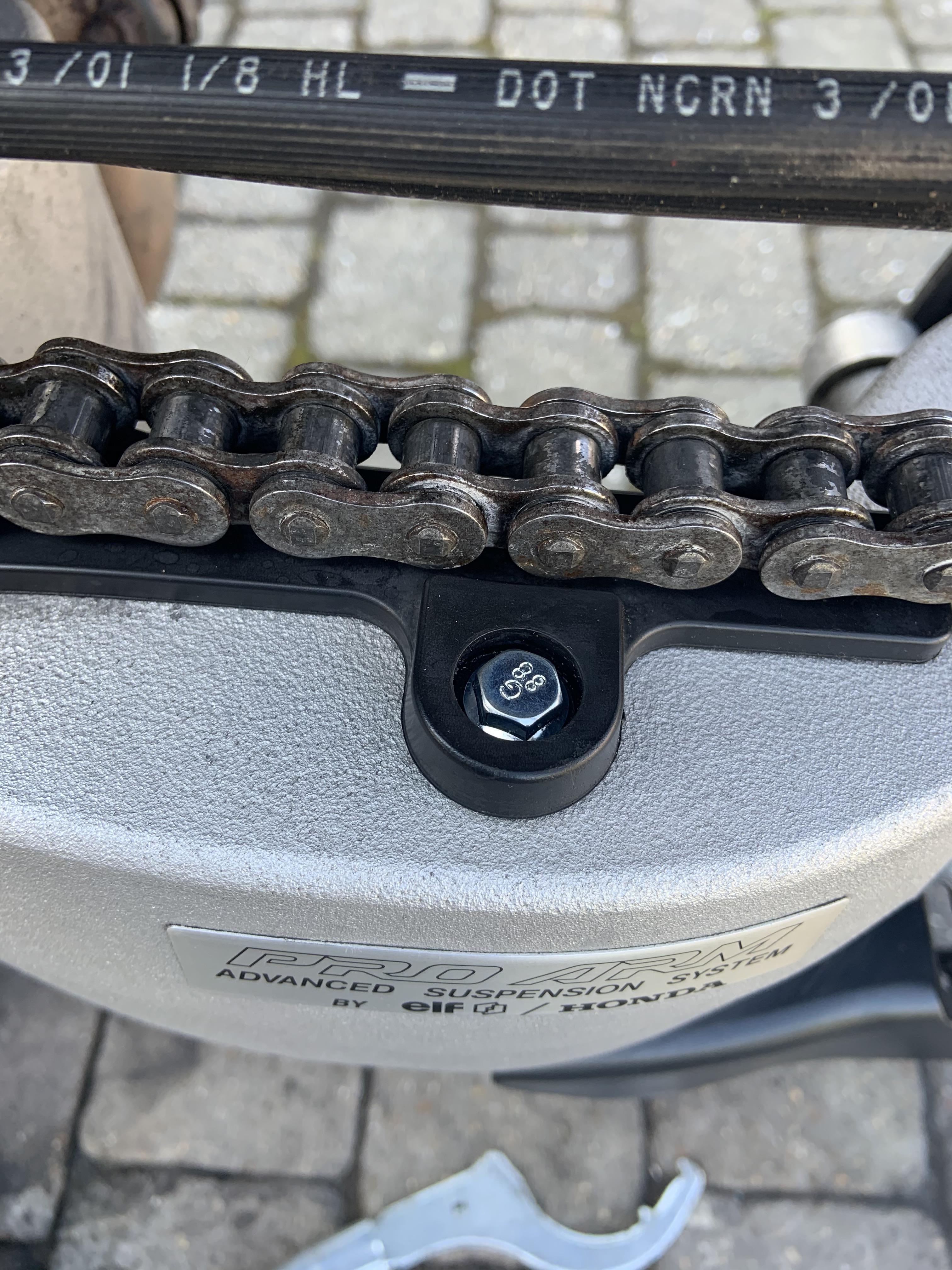

Chain guide removed. Old rusty bolts replaced with stainless steel items. Swing arm cleaned along with the entire back end.
I used a lot of brake cleaner & degreaser.
Back end looking a lot better, and the chain adjuster is nice and free.

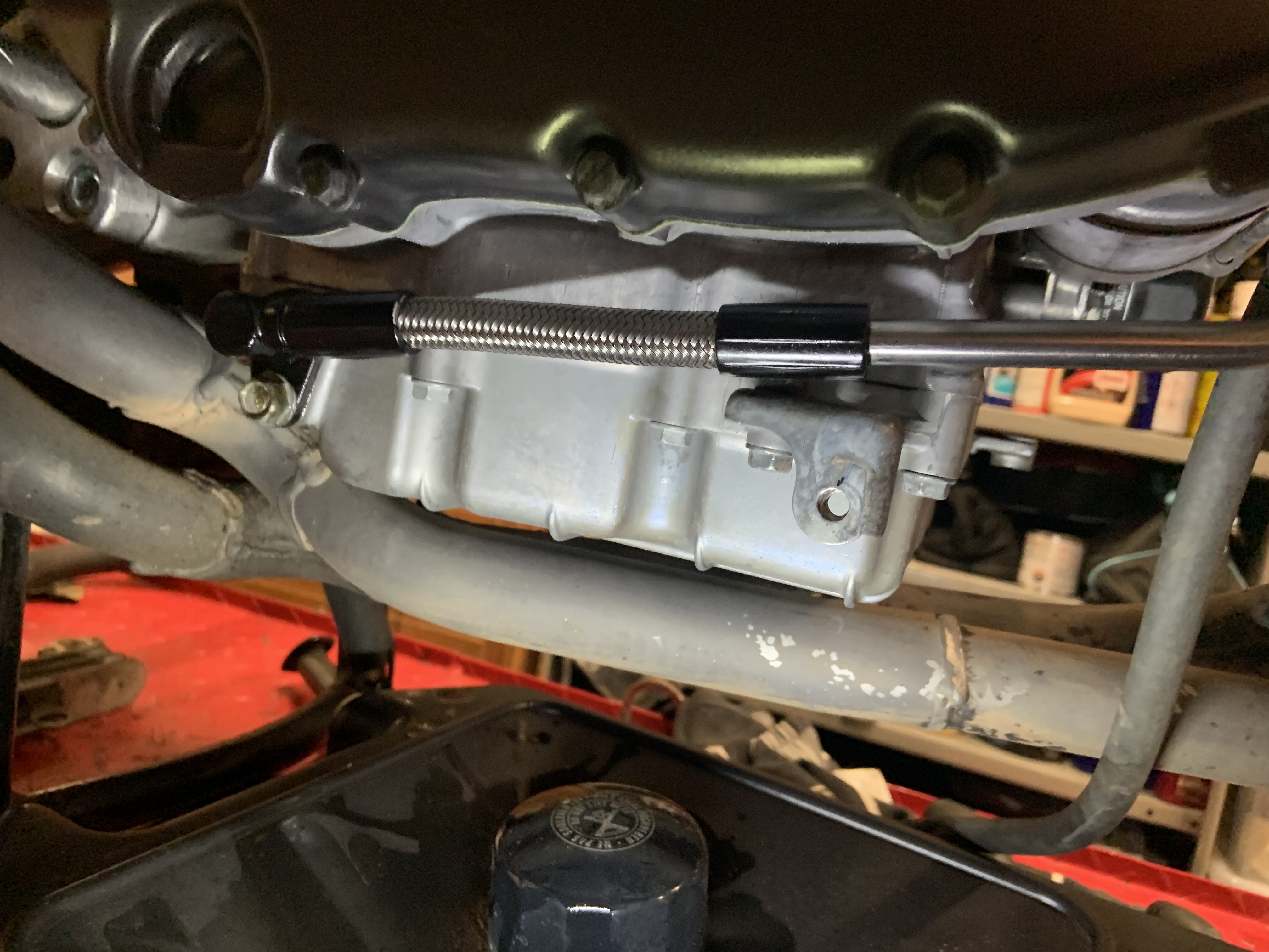

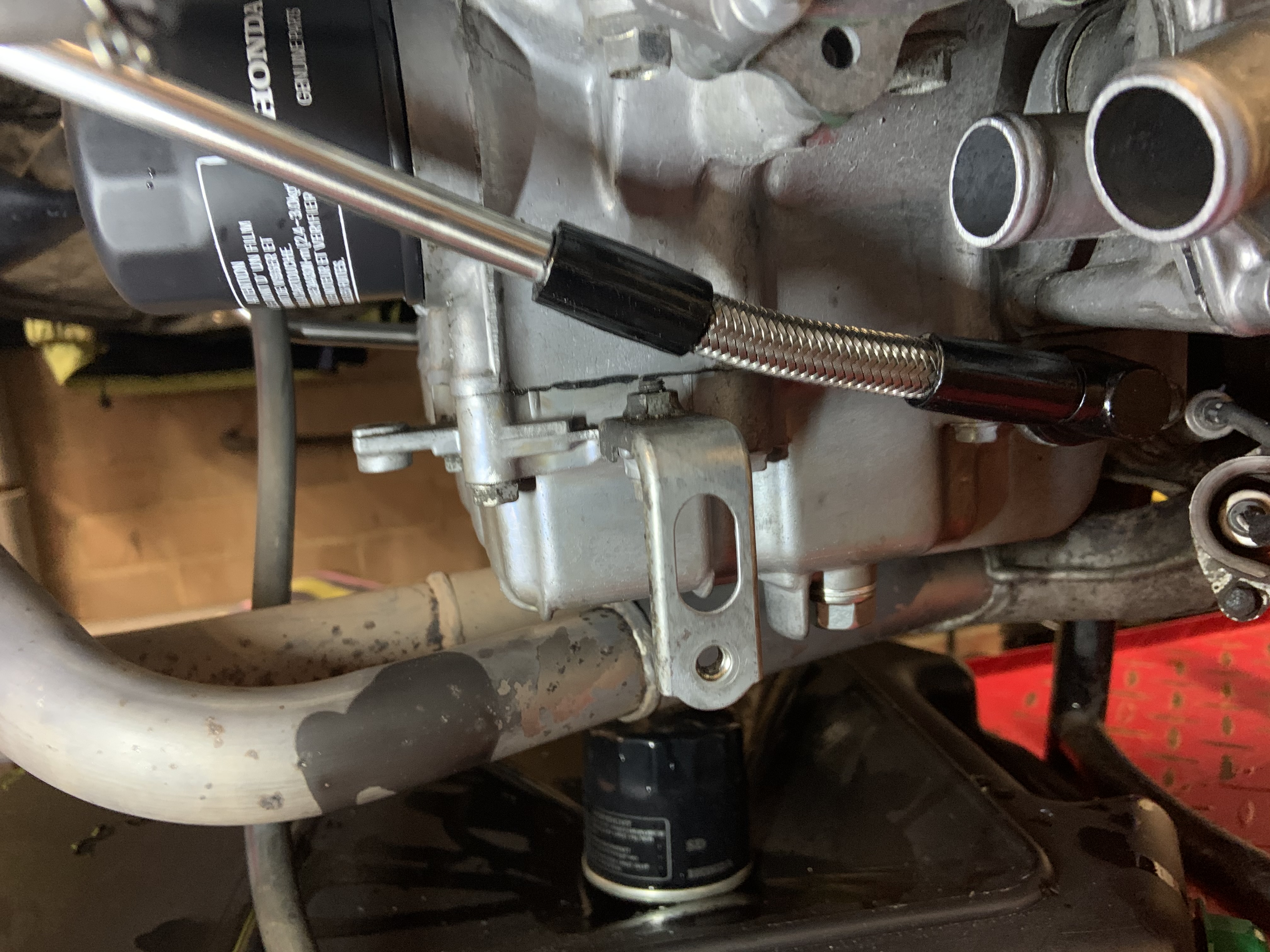

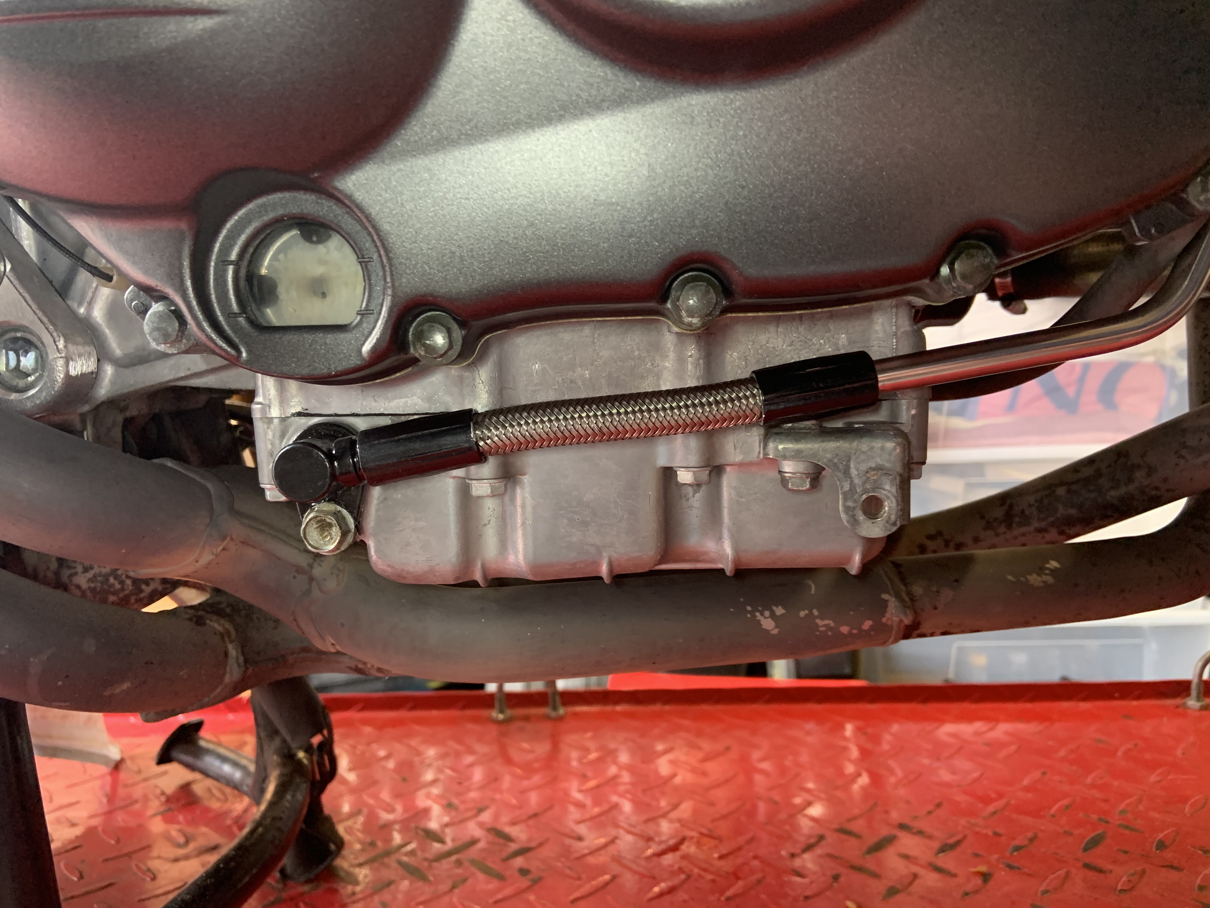

The next job was to clean the engine, replace the coolant, oil and filter , fix a coolant  leak , couple of new coolant hoses and clips and replace the oil pipes with some better stainless steel items that are made for us over here at less than half the price of the Honda part. I also replaced the fan housing, as these rust and I had a freshly powder coated one so on it went.
New oil line and clean engine cases.

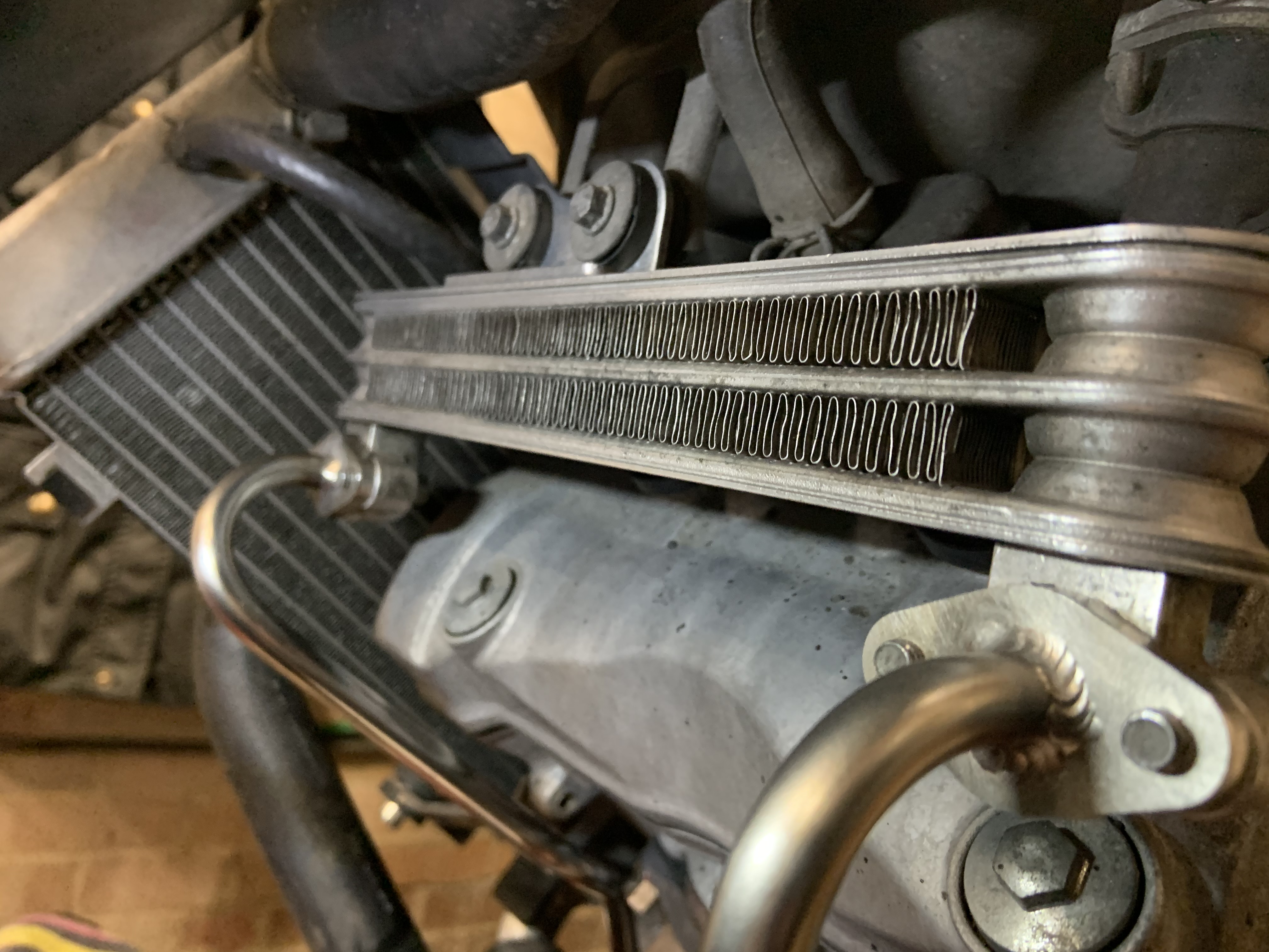

Cleaned oil cooler and new lines.
New oil line, oil filter and clean engine casing.

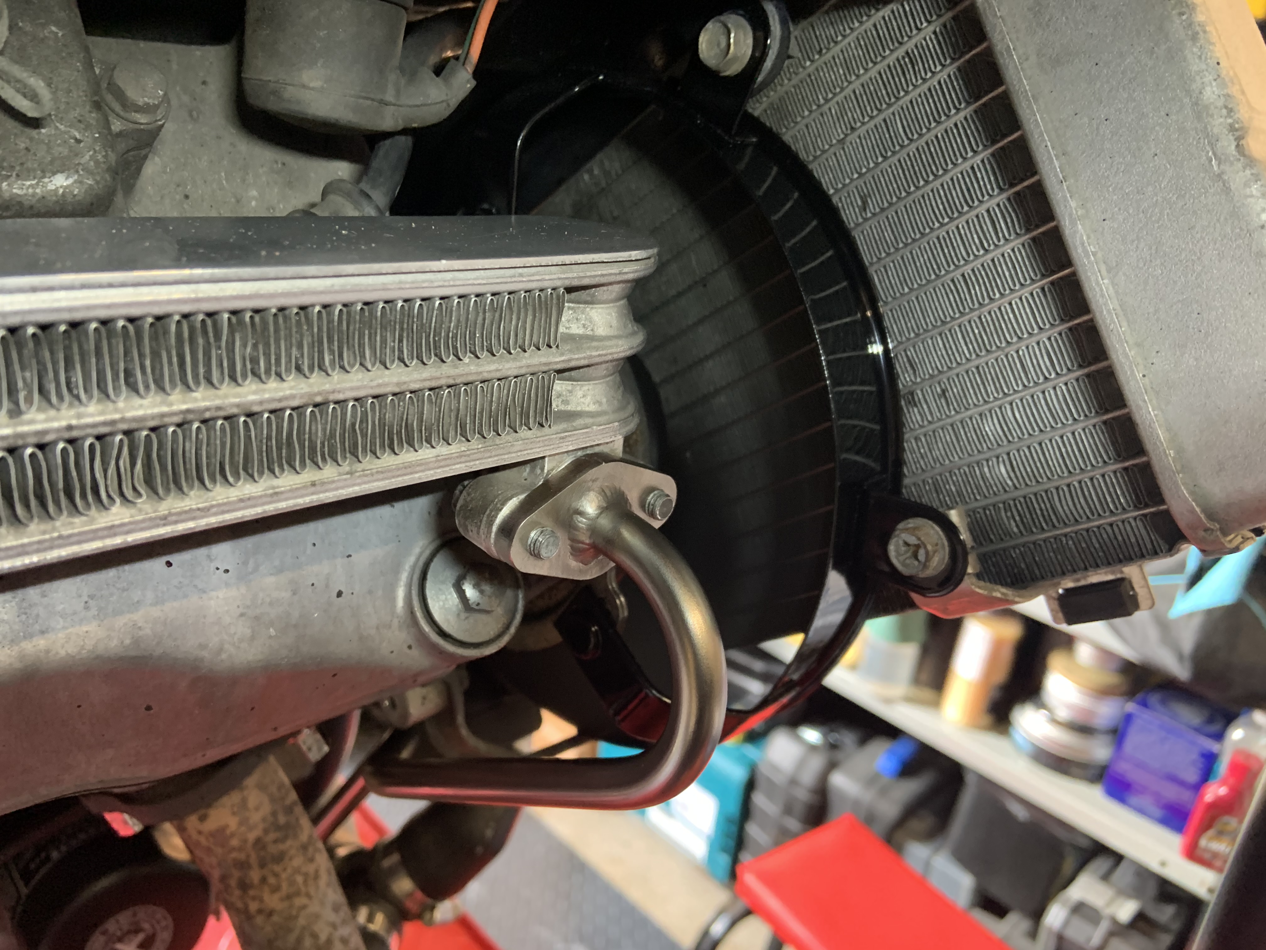

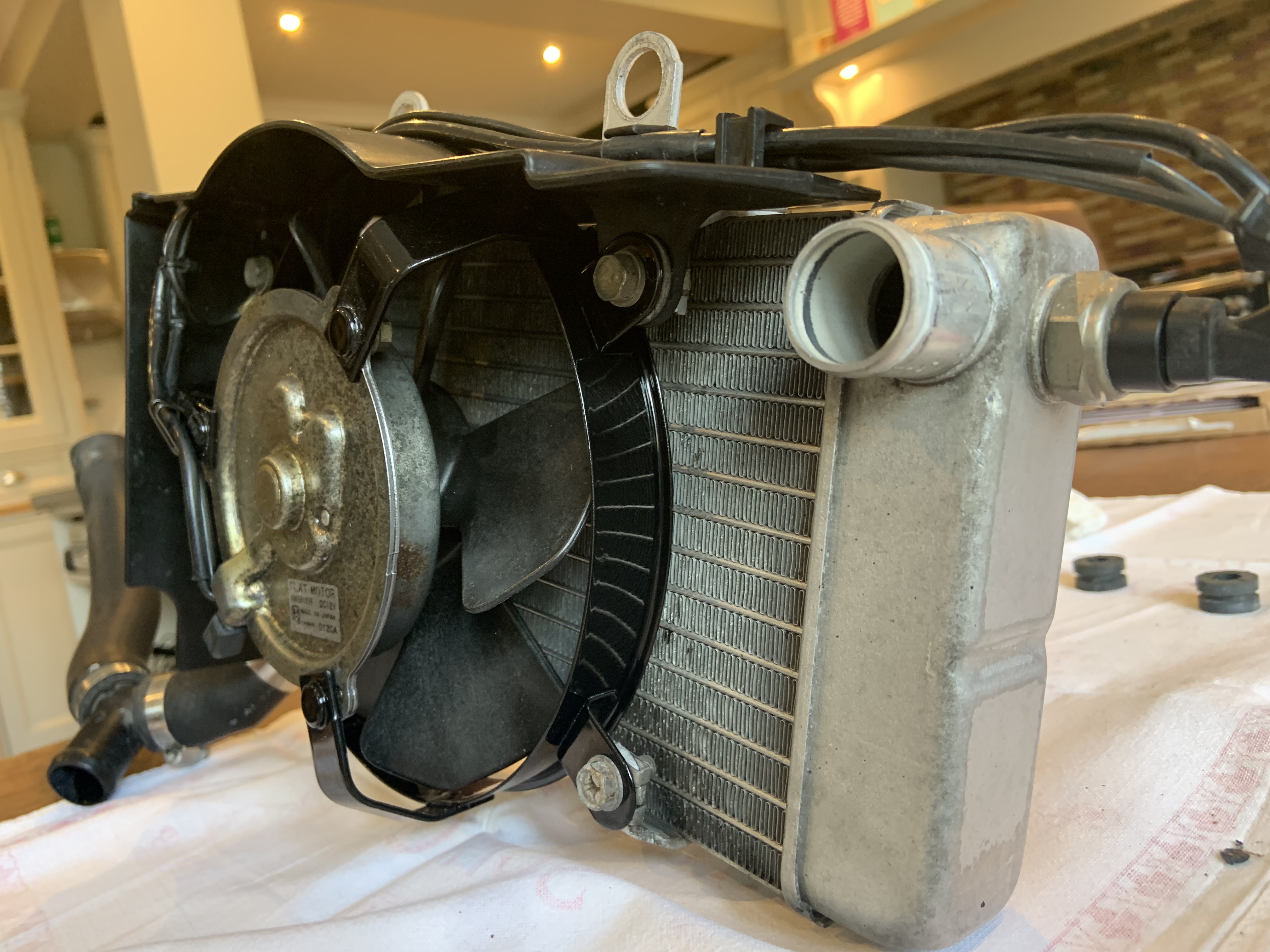

Radiator off and the fan housing has been replaced by a freshly powder coated one.
It looks so much better and will be much more durable.
Fan and rad back in place and being tested for leaks and making sure the fan kicks in at the right temperature.

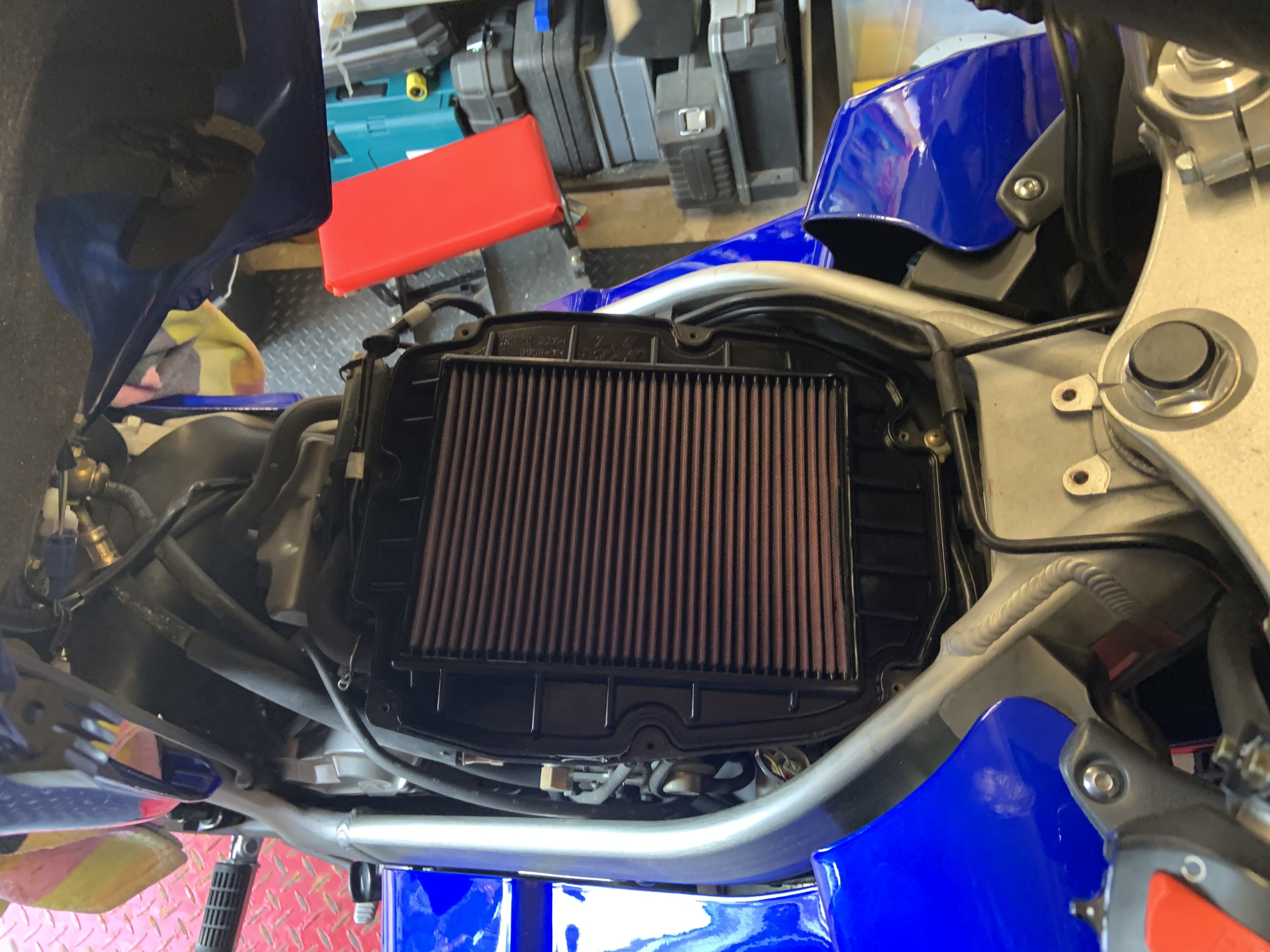

Next job was to change the air filter for a K & N item .
All reassembled and everything here was inspected and cleaned .

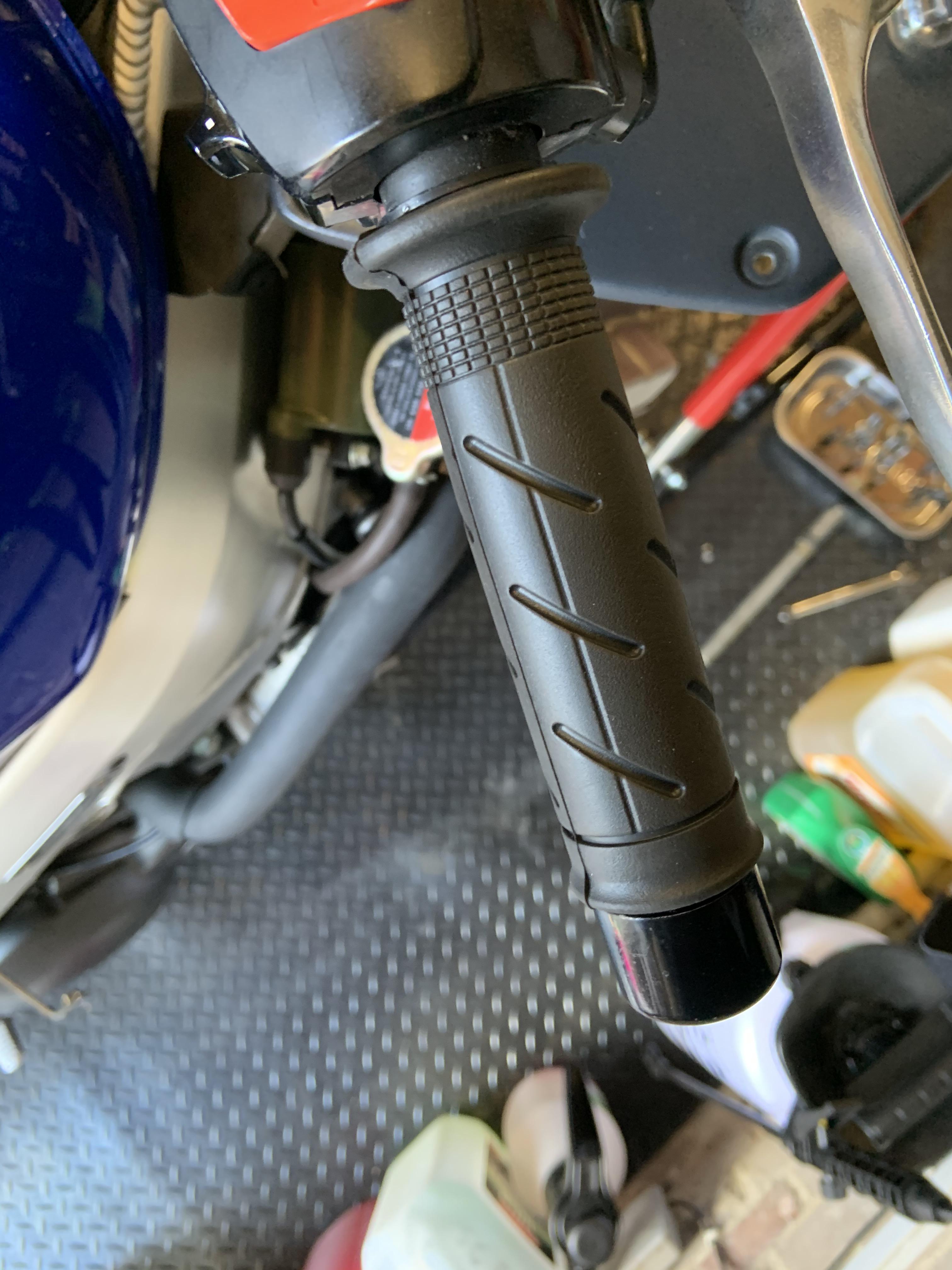

The VFR had heated grips that didn't work. They had to go and new grips were fitted.

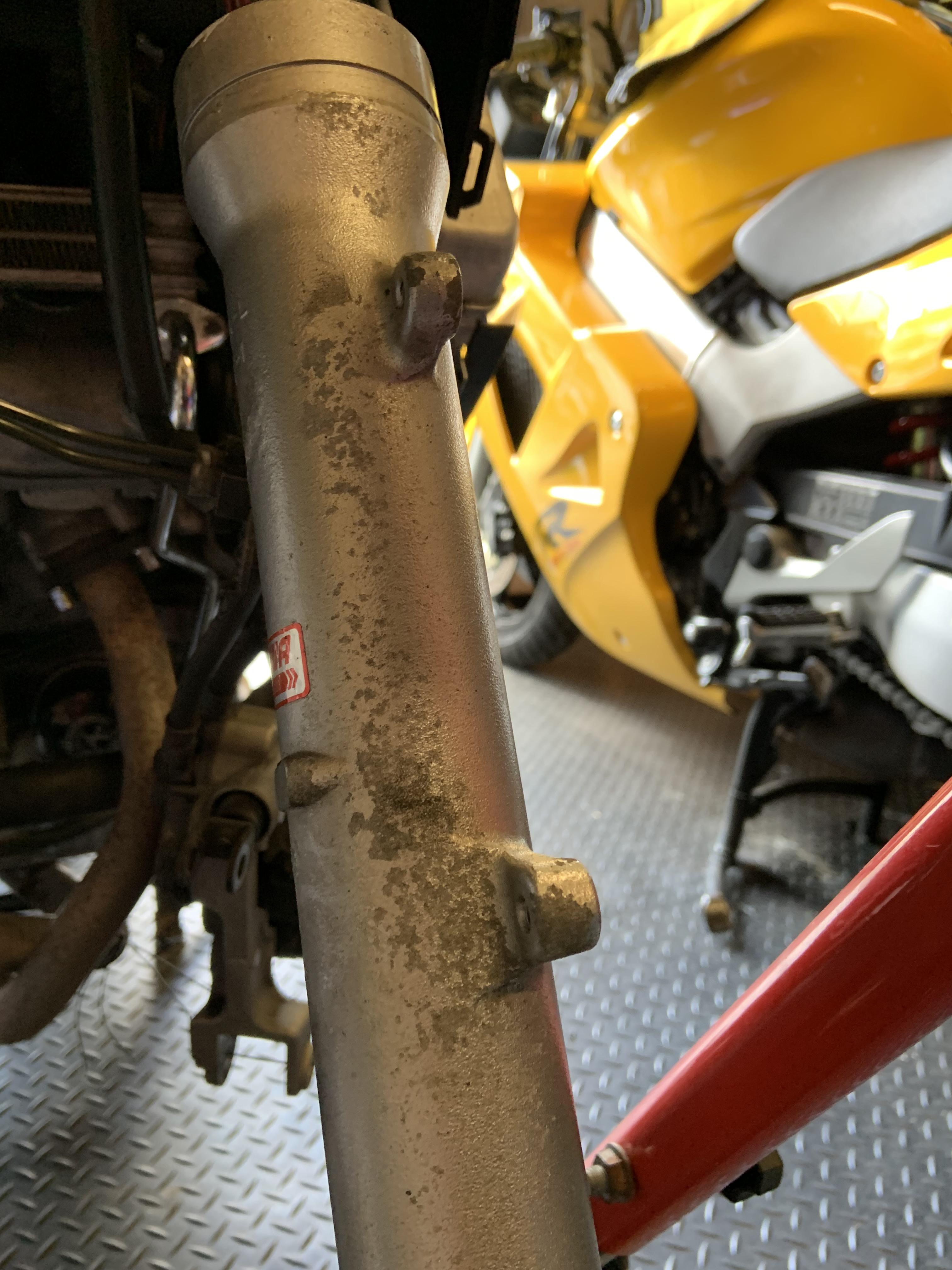

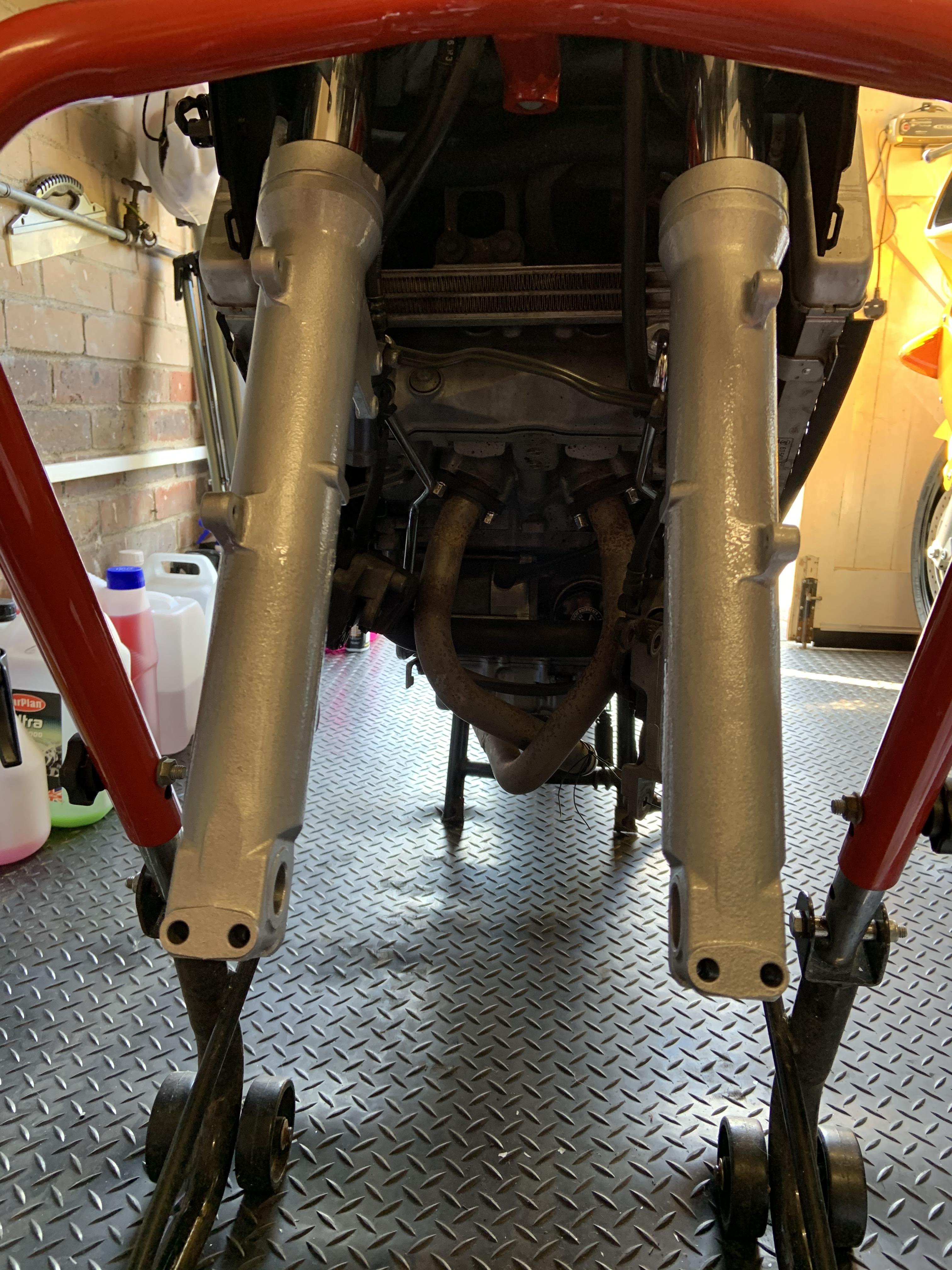

Then it was time to tackle the front end. Fork seals, stanchions were cleaned up. Lowers were striped, cleaned and repainted.
I have seen much worse.
After a repaint, waiting for the legs to dry .

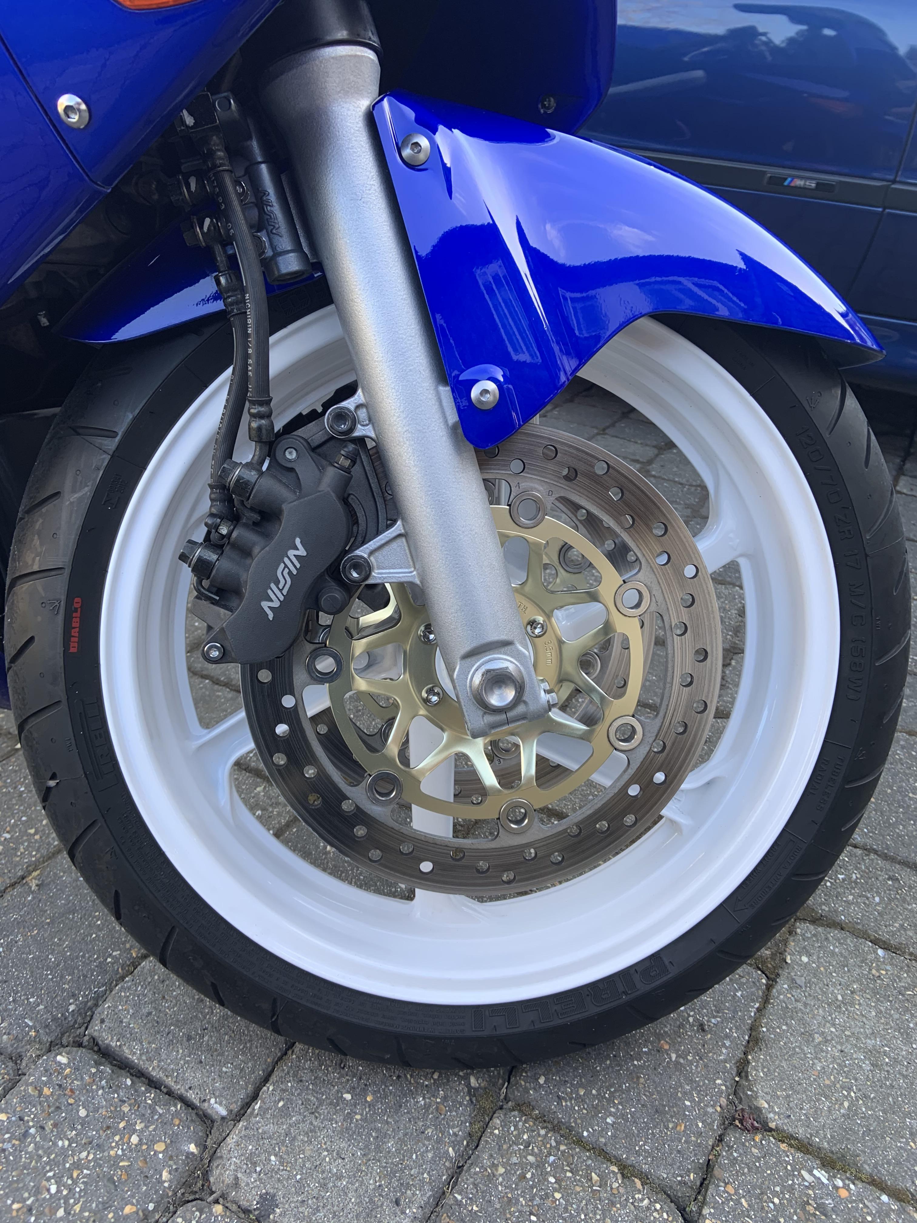

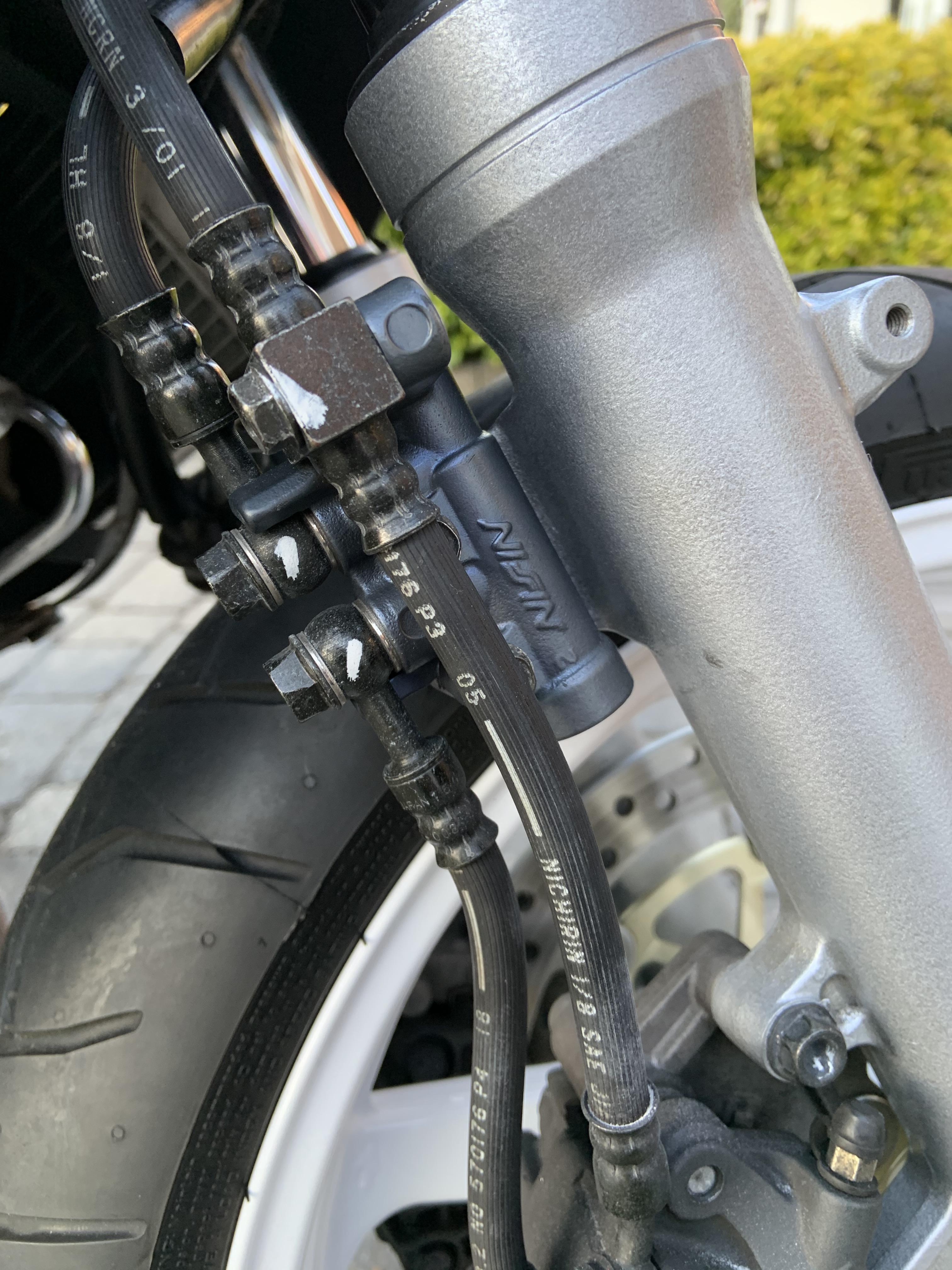

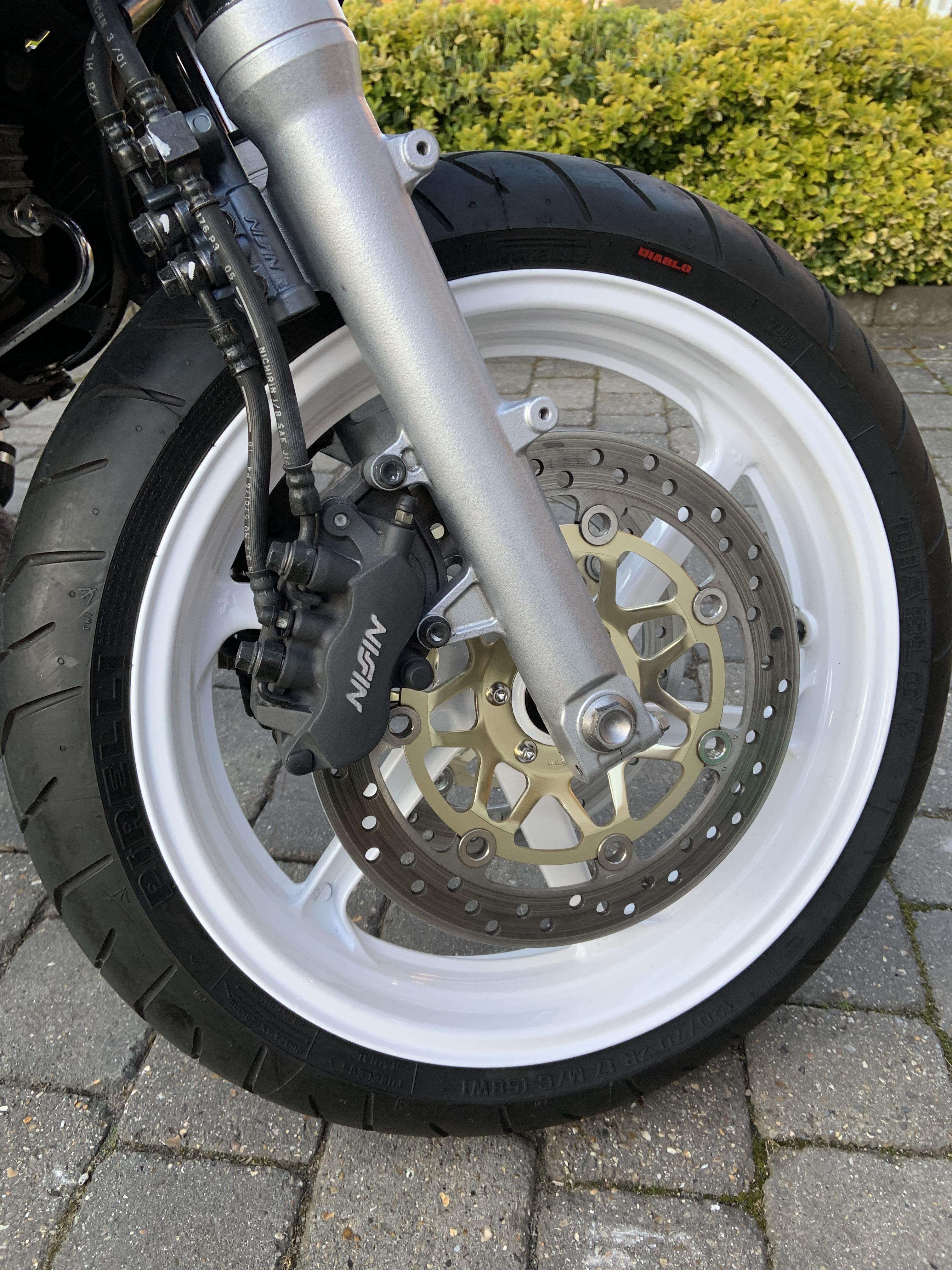

The front brakes were fully serviced. Cleaned and any internals where needed were replaced. I always replace the pad pins with titanium items ad Ti doesn't rust and use Ti caps.
New brake pads from Mr Honda fitted all round and all the brake fluid was also replaced.

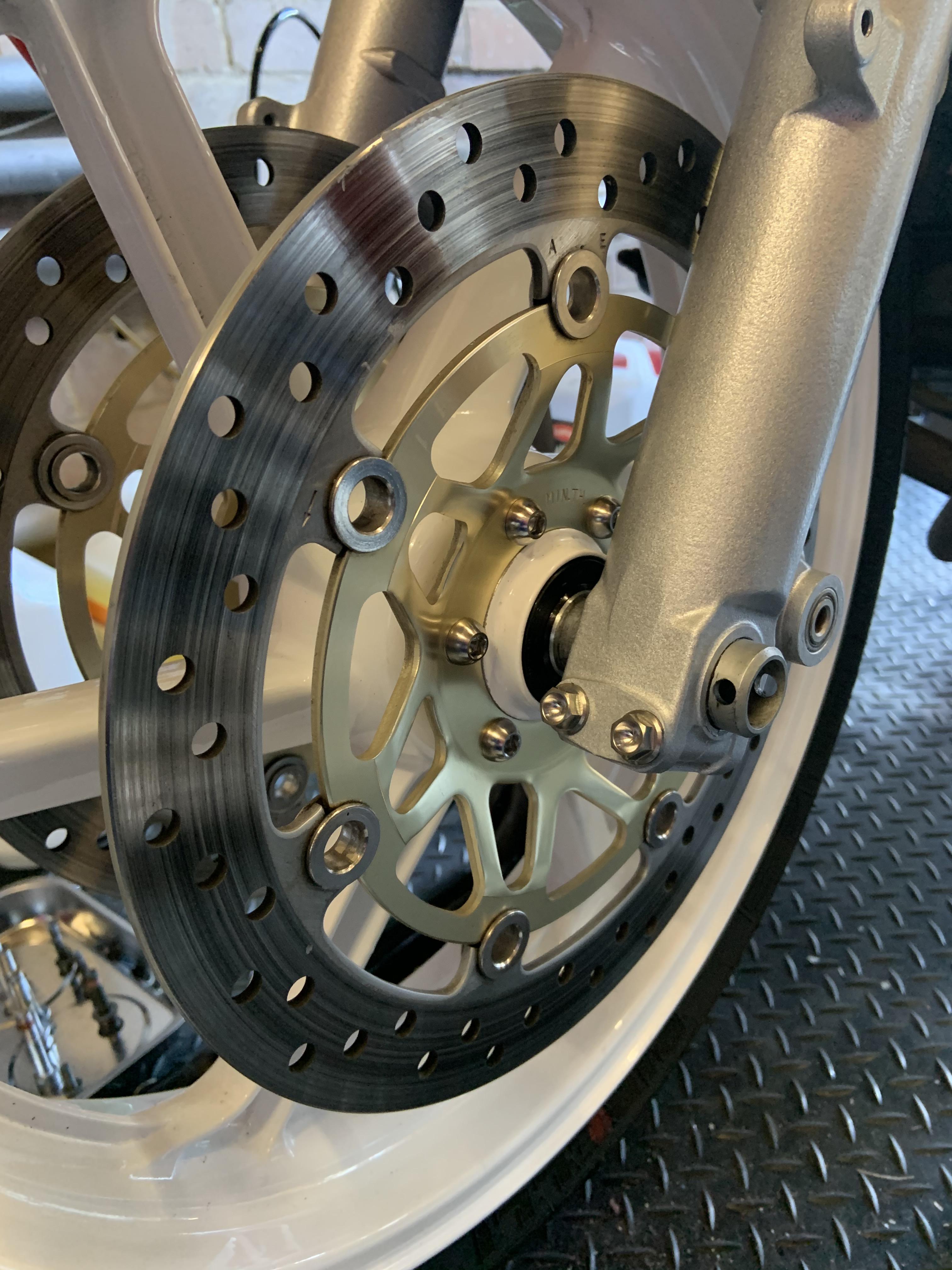

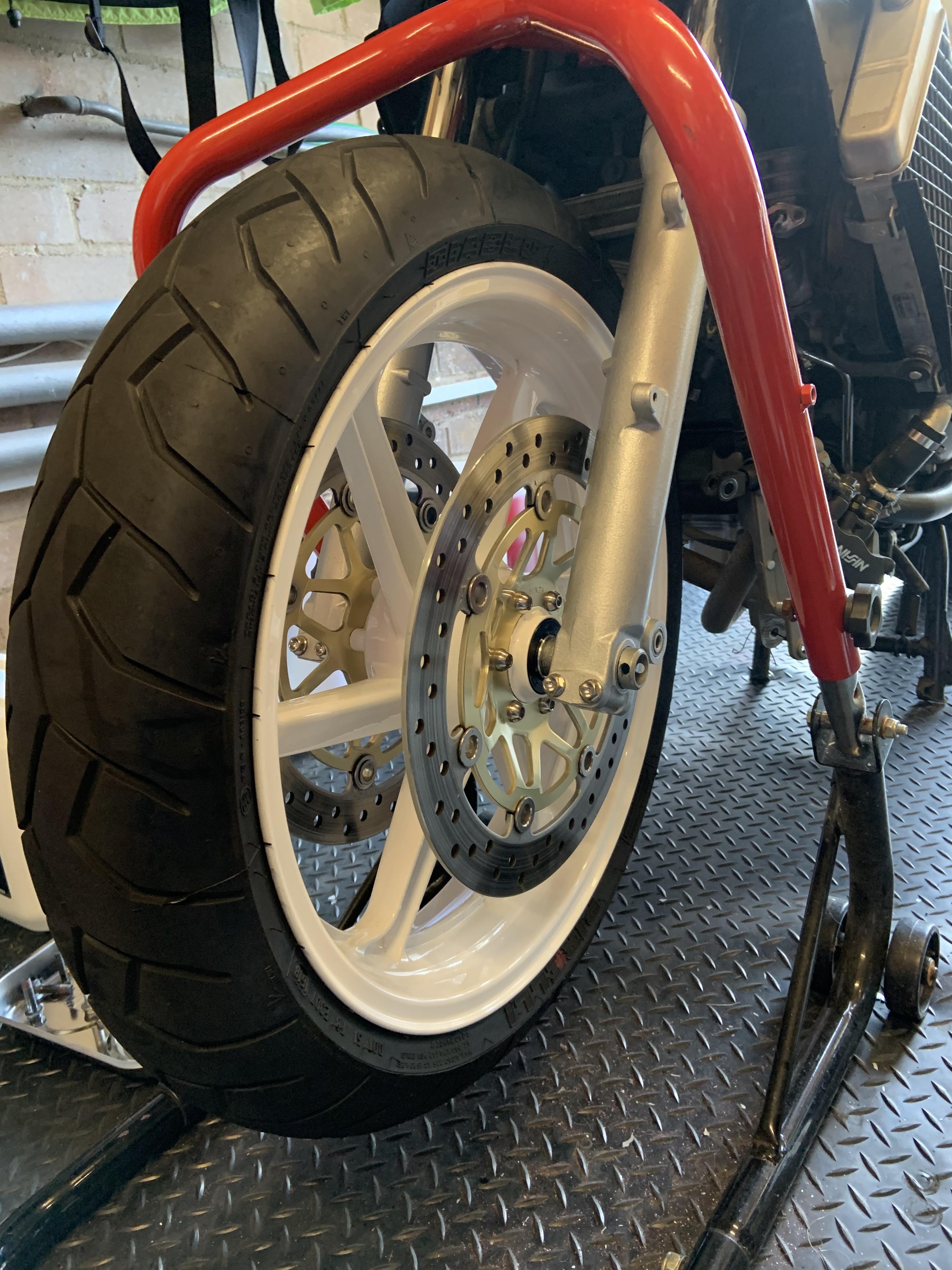

The wheel was replaced with a white item , with new bearings, Ti disk bolts and Ti pinch bolts . Disks were in excellent condition and were cleaned up .
New Pirelli tyres were also fitted .
A different view in daylight so you can see the result.
I think its come out very well .

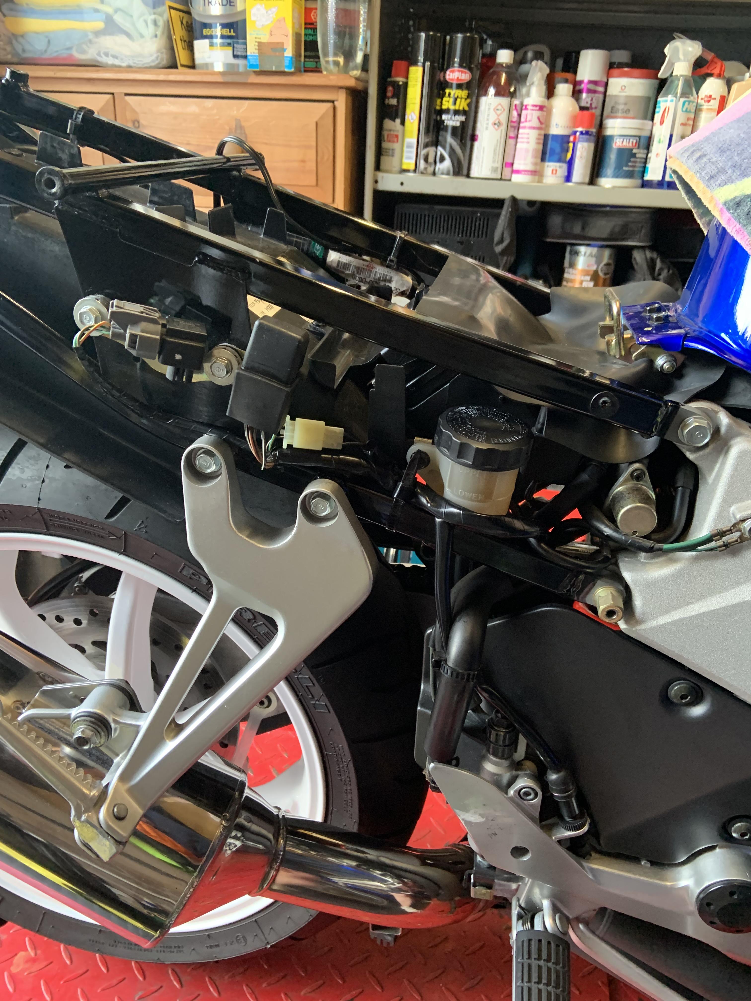

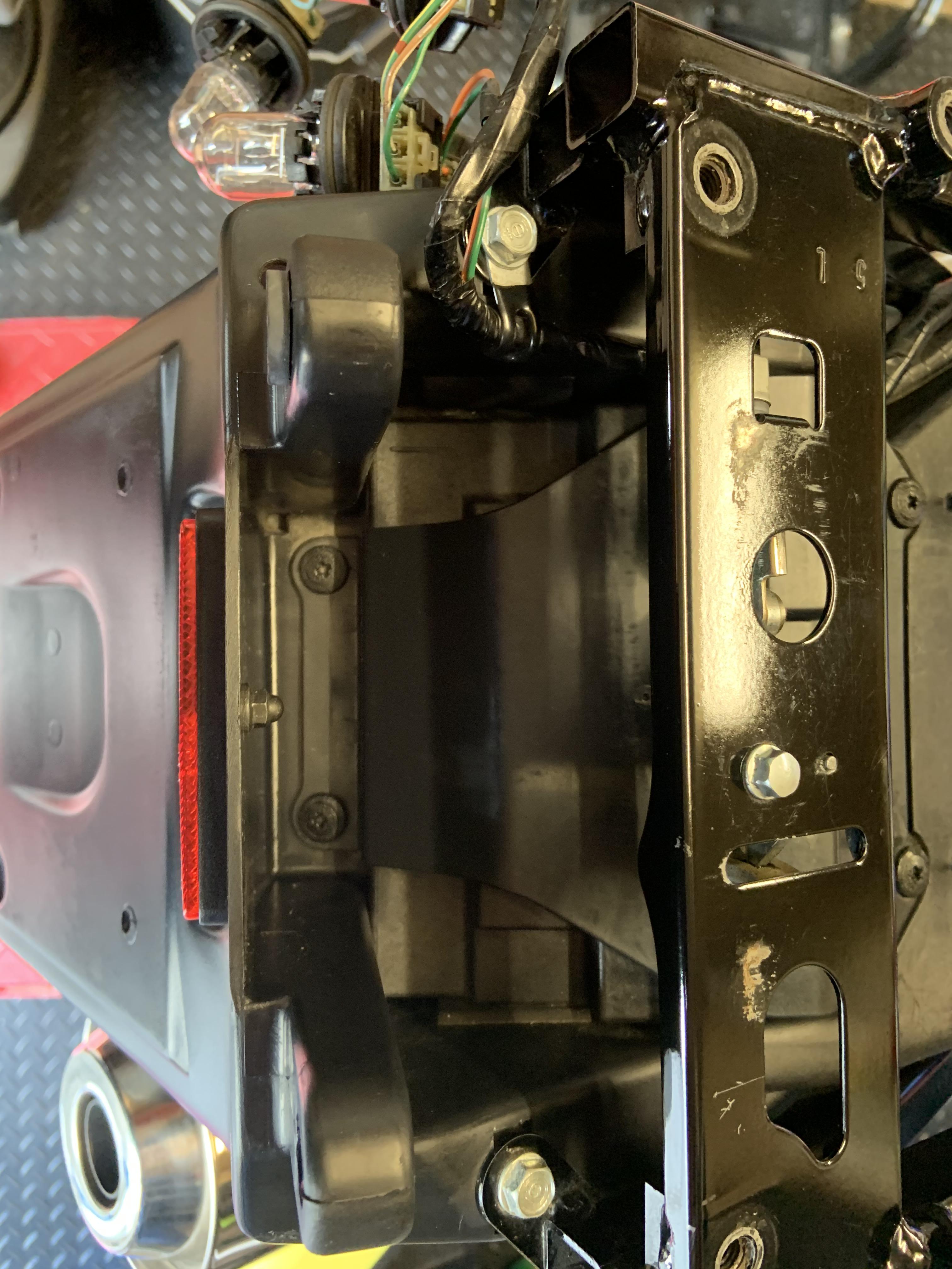

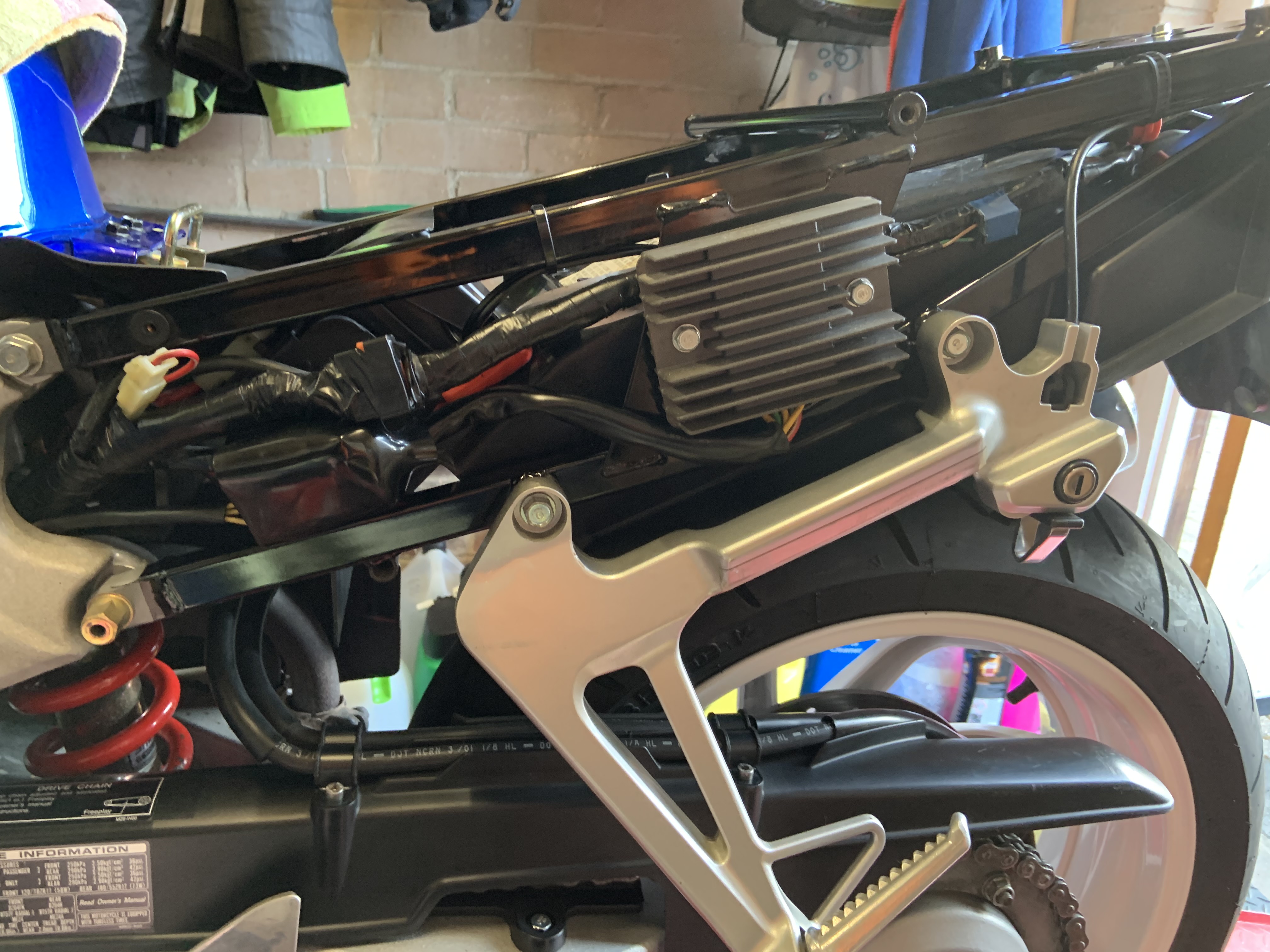

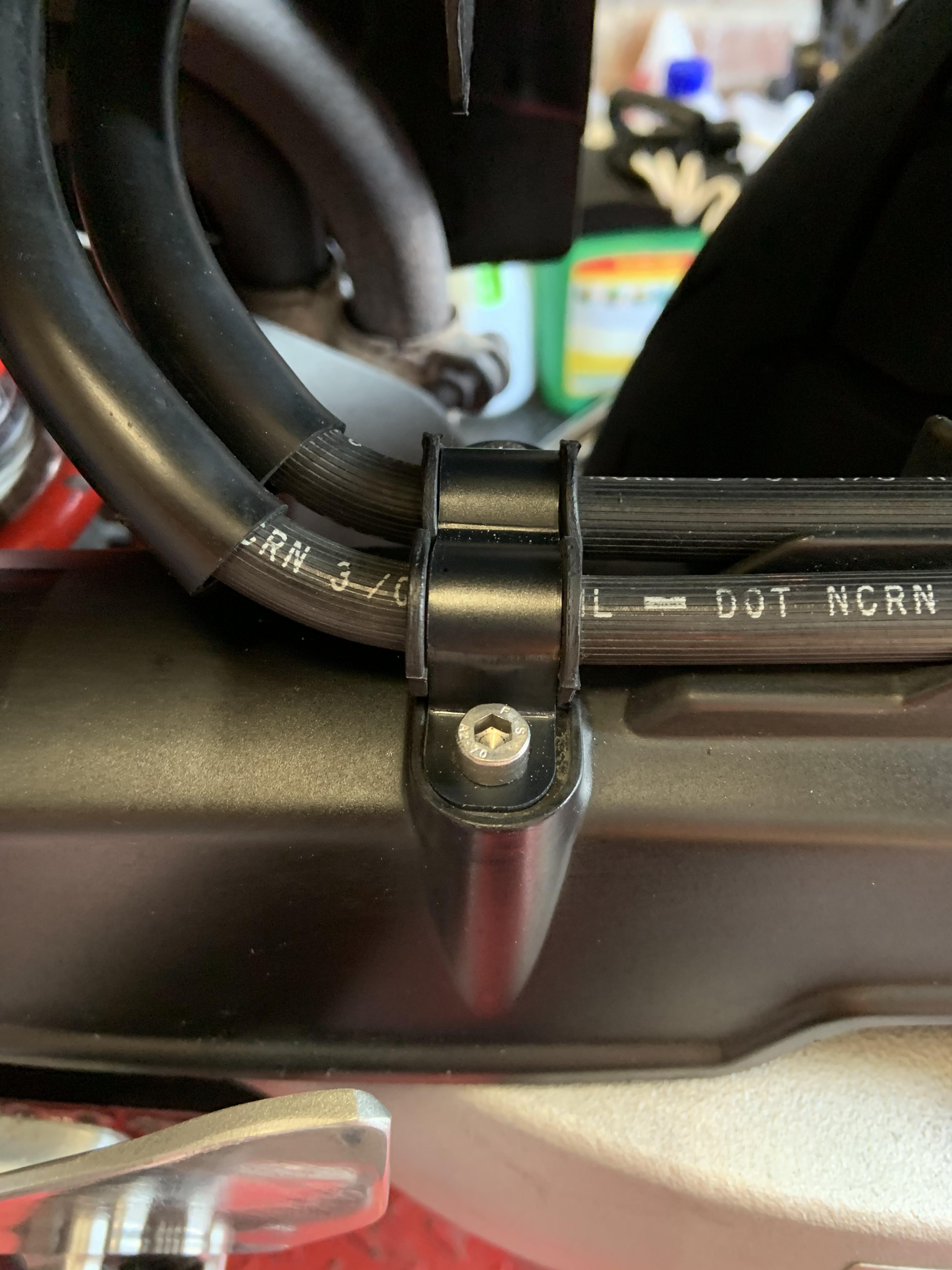

Thats the front end done. Now took the back of the bike off. Everything was checked , cleaned and every connector removed and refitted to make sure it all connects as it should, especially the RR connections.
New clips and bolts for the rear brake lines too .
Its all good this side.
And this side .
And also in here.

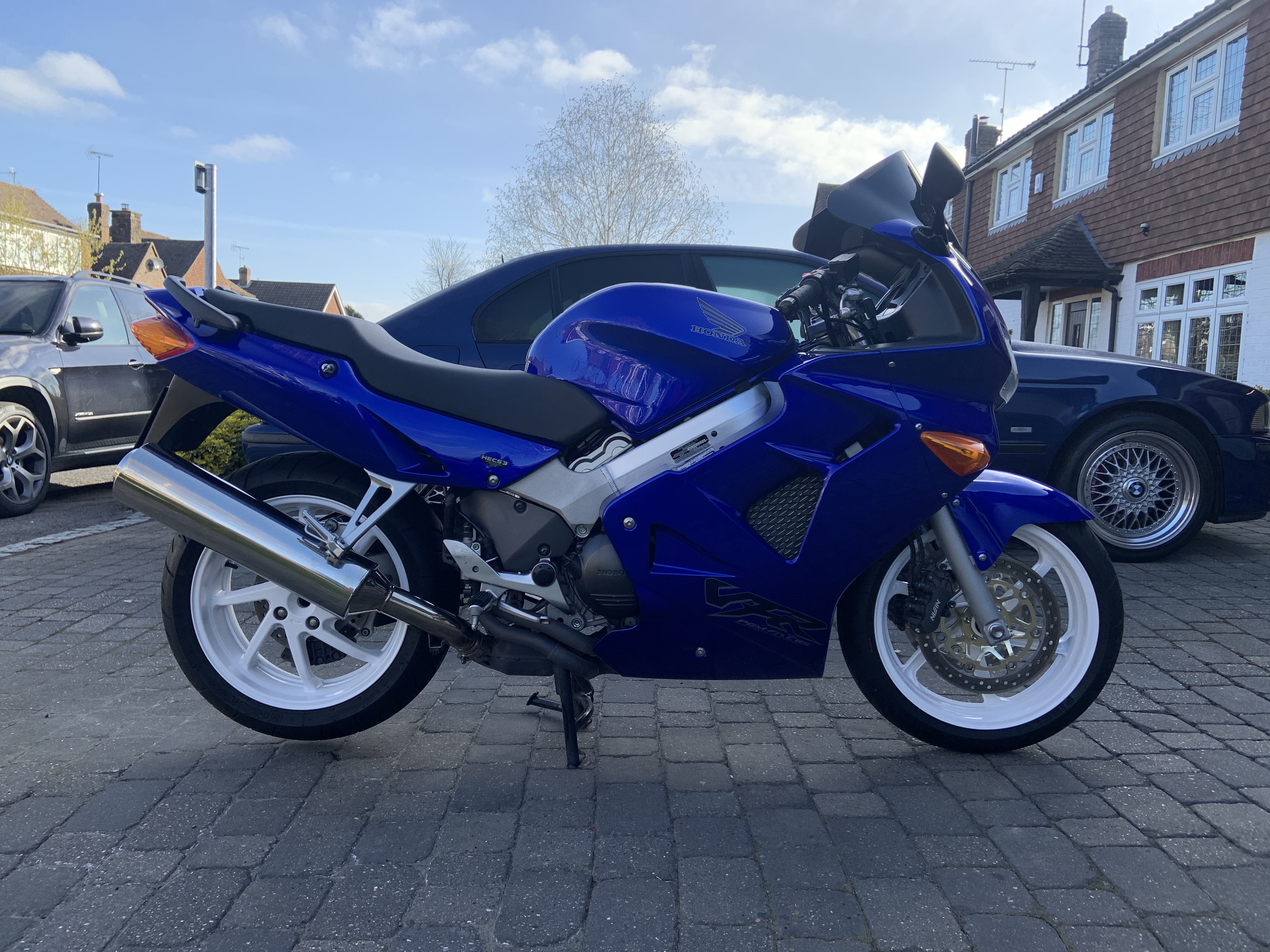

 Then all the bodywork was put back and the whole lot was mopped and polished. Its easier to to on the work table.

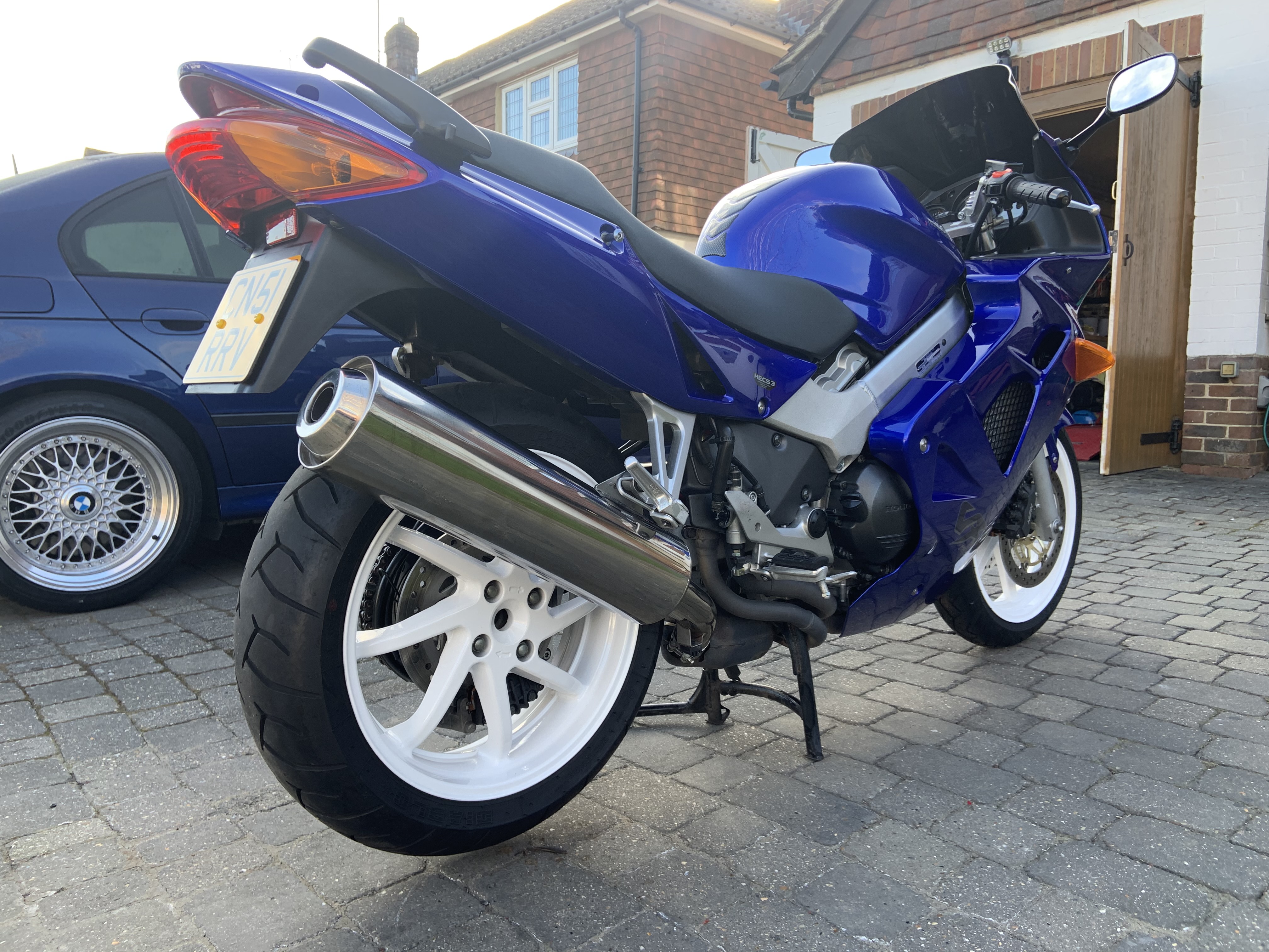

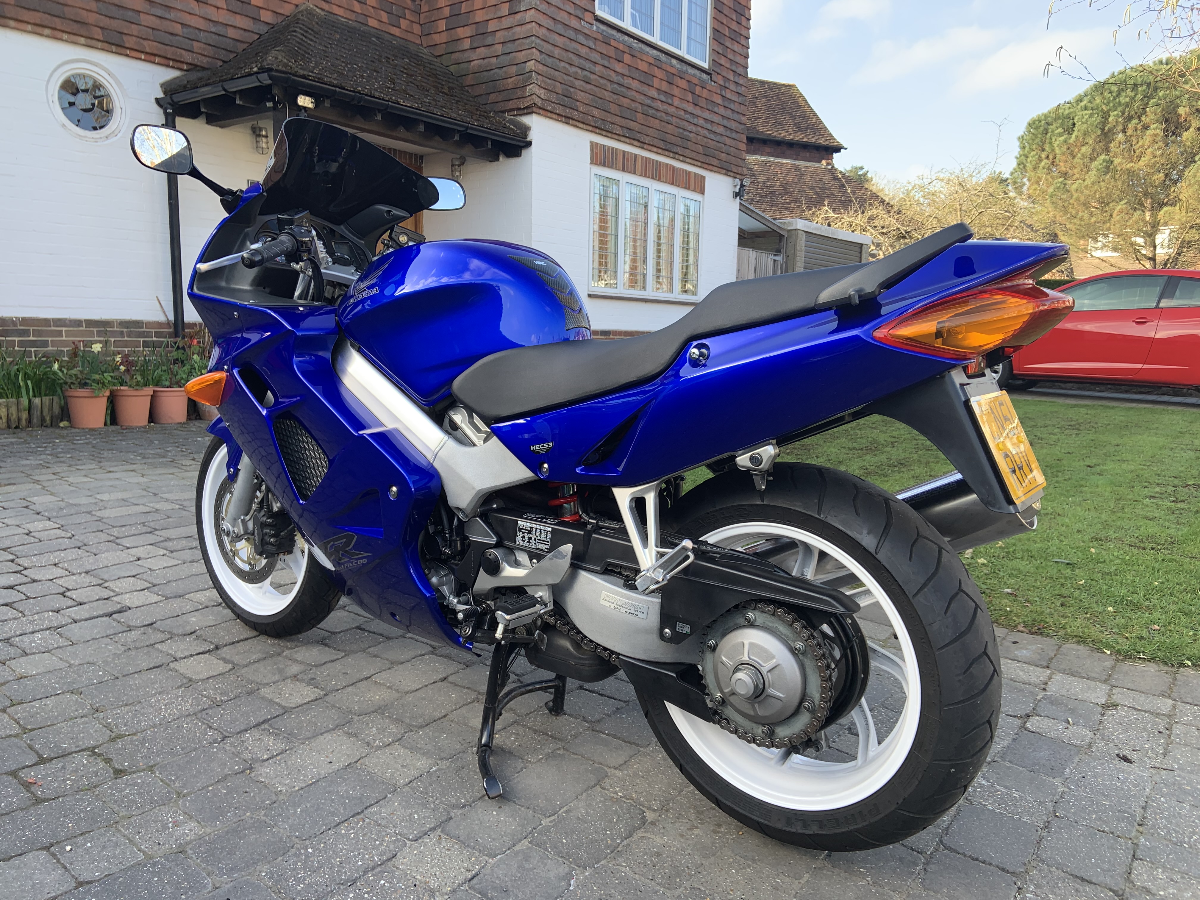

And there you have it.
One 20 year old VFR , refreshed and ready to do another 20 years.

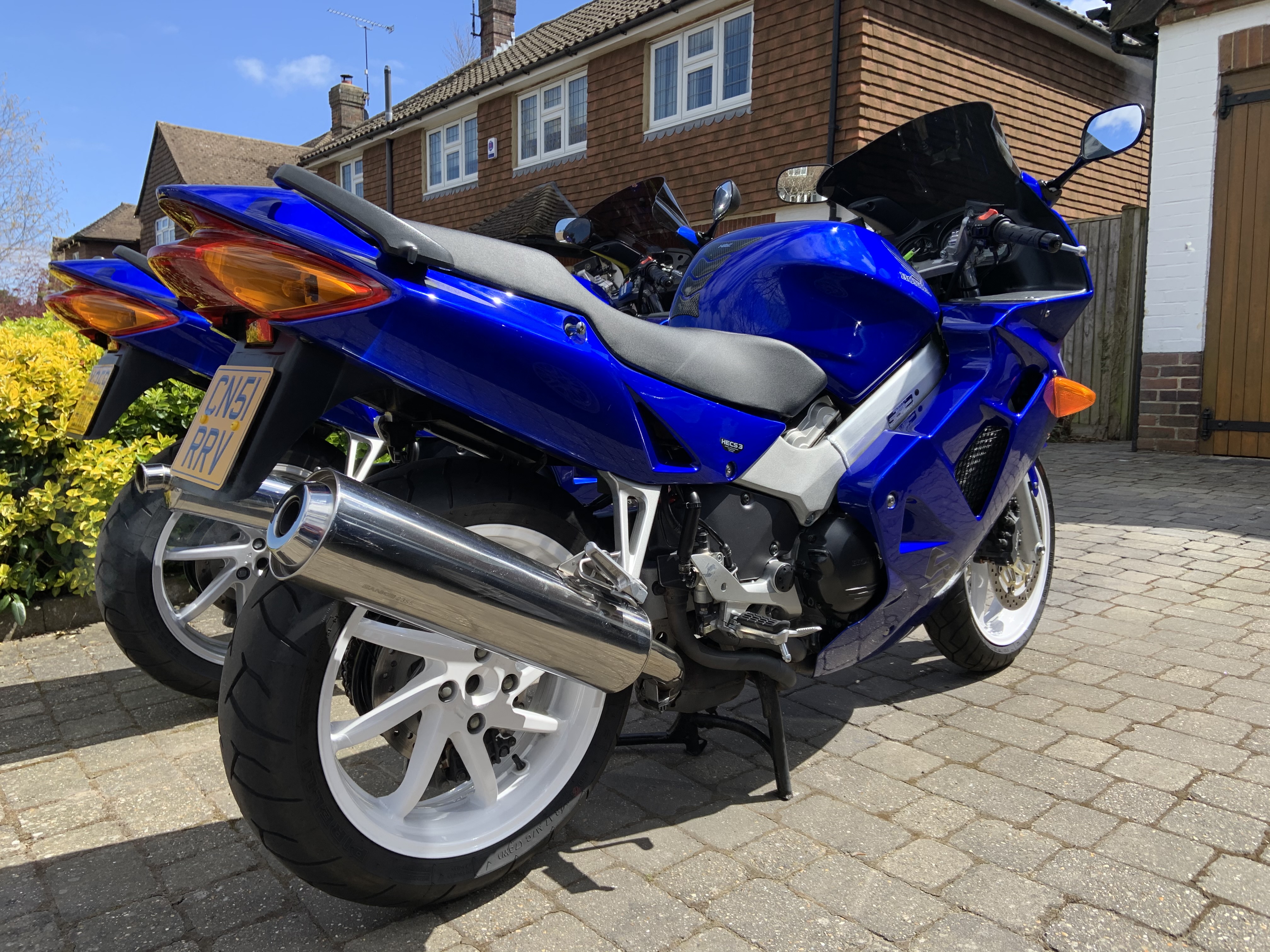

Out with its older brother today as the sun was out .
Proof that you can have more than 1 VFR and get away with it. As they are both blue my wife thinks I only have 1 bike and its the same one she sees. At least thats what I tell her .
Now looking for my next project VFR.

Where did you get the new oil pipes??
The oil pipes are made by a man in Wales.
He only makes 5 th gen oil cooler lines .  Made in 316 stainless steel and stainless braided hose.
Each set is test fitted to a spare vfr he has.
They are £140 for the pair . He would appreciate you sending back the the old engine ends from your old ones as those are cleaned and reused to make new lines.
They fit very nicely .
