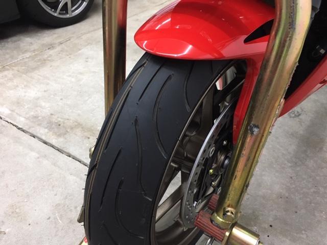

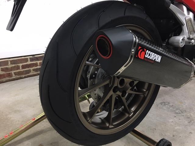

YYZ Posted June 12, 2019 Author Posted June 12, 2019 Tires came in today, Michelin pilot power 2C. Very easy to mount. The first bead goes on easy by hand, then (just in case it gave me trouble) I zip tied the tire to the rim and pulled it tight into the rim well and spooned it on. It really couldn't have bean easier. For me it's not about saving money. I just want to know it was done right. I had a really bad experience at a dealership years ago and I just have a hard time turning my bike over to someone that's in a hurry to get the job done. I use a torque wrench on every bolt, carefully remove the old wheel weights and balance the wheels to my satisfaction. It rides smooth, and turn in seems good. 2 Quote

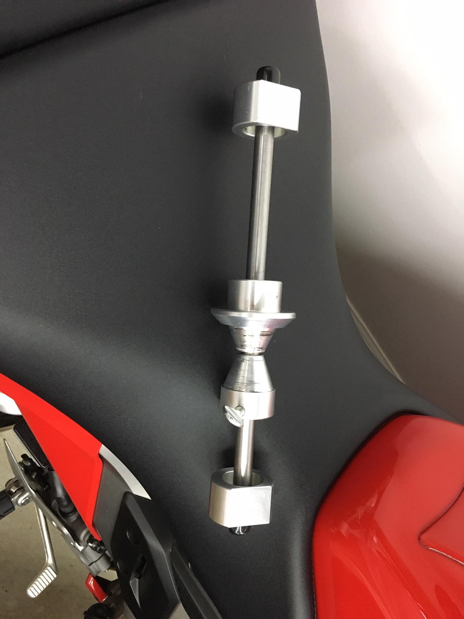

YYZ Posted June 12, 2019 Author Posted June 12, 2019 1 hour ago, VFR750F3 said: where is your tire balancer? I use a Marc Parnes Balancer. Quote
YYZ Posted June 12, 2019 Author Posted June 12, 2019 I have used the HF in the past. The Marc Parnes balancers are much better. Quote
YYZ Posted June 12, 2019 Author Posted June 12, 2019 I know what the next question will be so I'll just leave this link here. https://www.google.com/url?sa=i&rct=j&q=&esrc=s&source=images&cd=&ved=2ahUKEwiOuufBhuXiAhXrguAKHbPCCf4QjRx6BAgBEAU&url=https%3A%2F%2Fwww.youtube.com%2Fwatch%3Fv%3DrFsuwBnpYjw&psig=AOvVaw3Ybwd_PNsWOENOg9xe72iD&ust=1560466931632921 Quote
Member Contributer Cogswell Posted June 12, 2019 Member Contributer Posted June 12, 2019 1 hour ago, MadScientist said: Absolutely the same reasons I change my own tires. For anyone else using the Harbor Freight changer, check out mojoblocks. I also have the mojolever. Good tools, if a bit expensive. Can't recommend them enough. Not sure what he uses, but I've been using a Marc Parnes balancer for years. I had the balance checked the first couple times and they were inconsequentially close. Takes a bit of time to check, add weights, then check again, but at least I know it is done right. I've made a set of "weights" that I tape on to do the balancing, then remove and stick the "permanent" weights on. +1 to the Parnes balancer and Mojolever. Together they make tire changes a job anyone can do well. Quote
