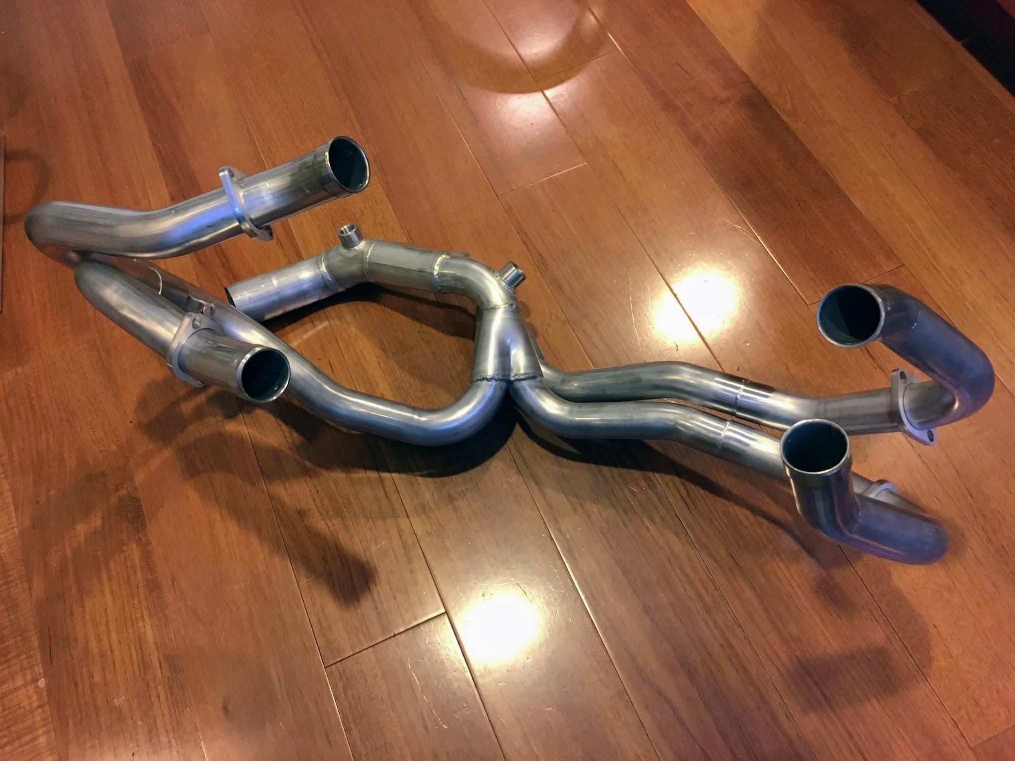

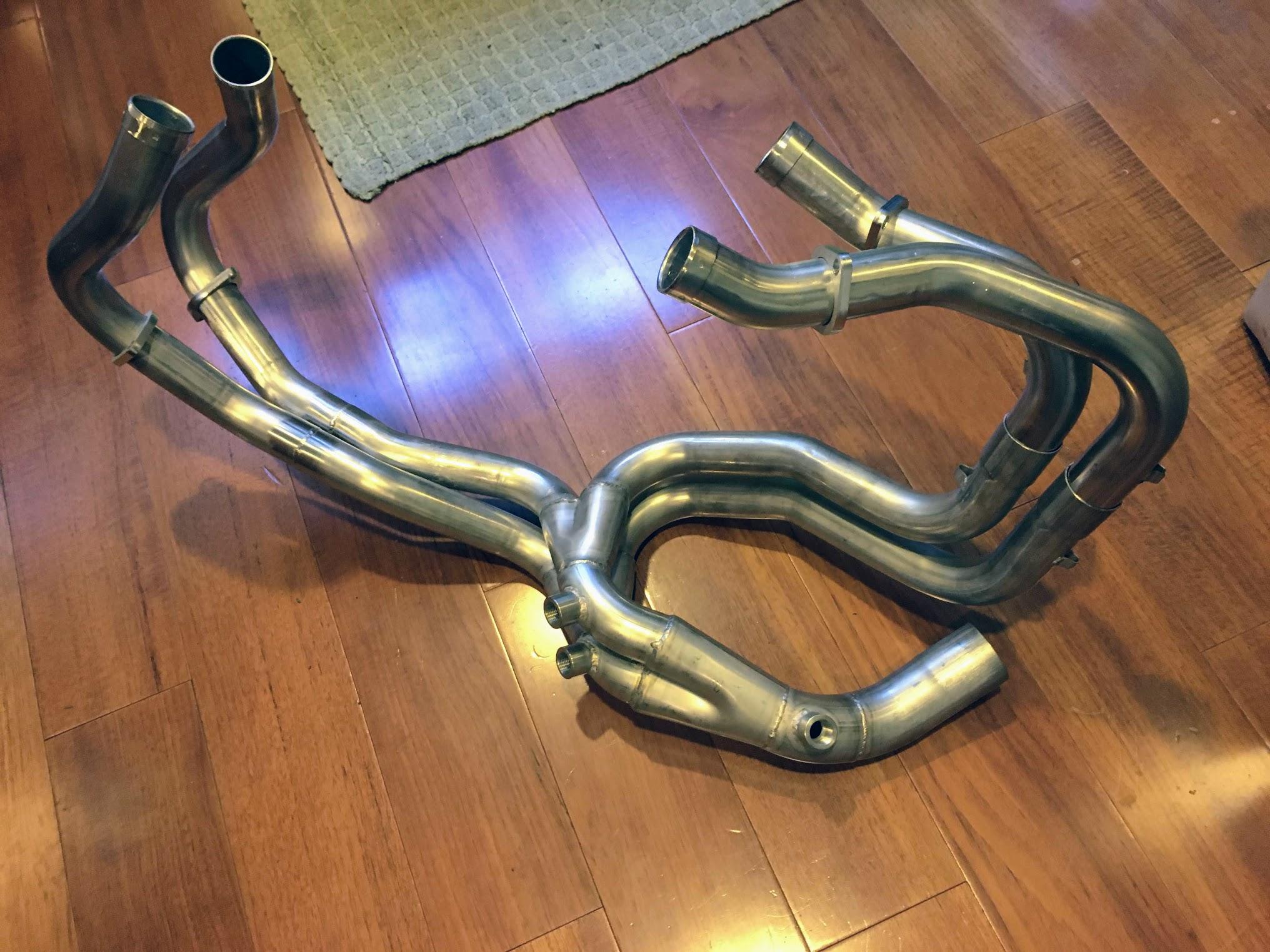

Member Contributer sfdownhill Posted August 28, 2021 Author Member Contributer Posted August 28, 2021 The only difference between the 5 gen headers and the 6 gen headers is the 6 gens have 5/8” cut off their collector exit pipe to allow the complex 6 gen midpipe/dual muffler assembly to fit. Having just installed a set of 6 gen mufflers on these headers, I’m thinking we should have cut off 3/4”...maybe even 7/8”. Any other 6 gen owners think a little bit shorter collector exit would have been a better fit? Quote
Member Contributer Cogswell Posted August 28, 2021 Member Contributer Posted August 28, 2021 2 hours ago, sfdownhill said: The only difference between the 5 gen Having just installed a set of 6 gen mufflers on these headers, I’m thinking we should have cut off 3/4”...maybe even 7/8”. Any other 6 gen owners think a little bit shorter collector exit would have been a better fit? Not here. Actually if they were not cut off at all I'd probably be fine with it. It's easier to remove material than to add more. FWIW I have Remus cans and midpipe. Each brand / type is probably somewhat different. I'd thought about moving these to my G5 once the 8th headers go on to accommodate other mods, but it's not clear to me that they'll fit up to the G5 midpipe / can having been cut. Who knows - maybe I'll be in for a G5 set if another batch is run. 1 Quote

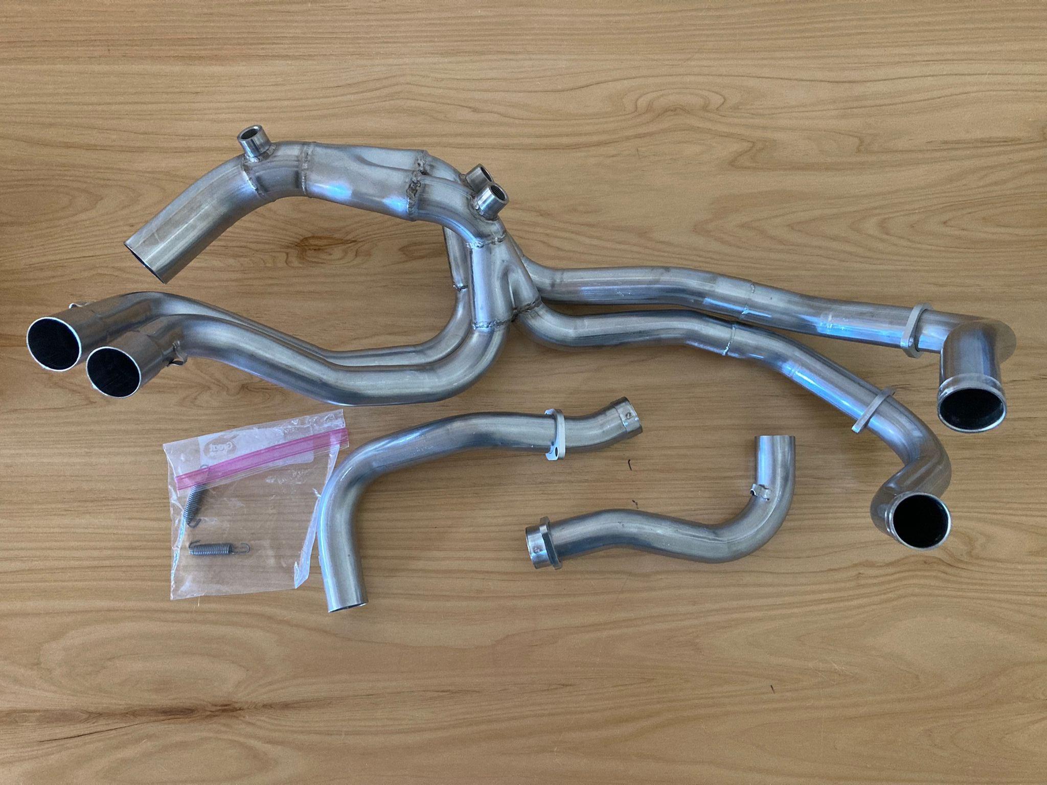

Member Contributer ae86andkp61 Posted September 14, 2021 Member Contributer Posted September 14, 2021 My headers arrived unscathed! Mr. Squiggle did a very thorough job of packing, and he even threw in all the hardware, gaskets, and aluminum Sebspeed center stand stop that he had collected for the header! 😆 Due to the fact that now is coming into some of our best riding here (cool mornings/evenings, warm afternoons, mountain roads open and clear, many days still sunny) and due to a lot of my spare funds currently going to my Suzuki Cappuccino restoration project, I will probably install these and work on a tuning solution sometime this winter. Here's a few photos of the big sturdy box, and the headers out of the box on the kitchen floor. And before someone asks, yes, that is a dirt bike wheel in the front entry of my place. 😜 6 1 Quote
