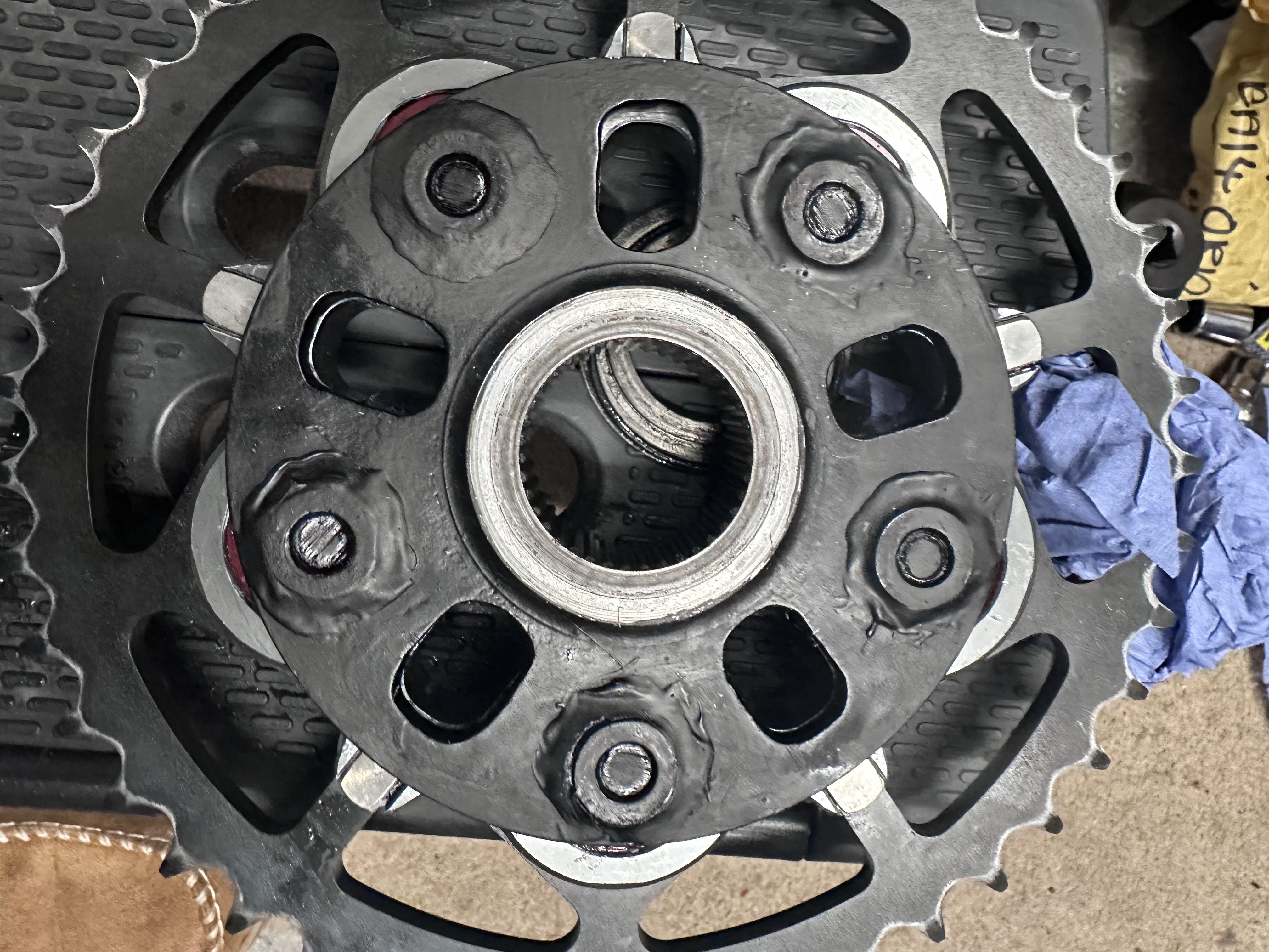

Member Contributer Mohawk Posted April 21, 2024 Member Contributer Posted April 21, 2024 For anyone that follows HighsideNZ's excellent CAD diagrams based on my original design, please note that after 25K miles the bobbins M10 bolts pulled out of the alloy inner. If you used HighsideNZ's bobbin retainer then they won't come out all the way, but mine came out far enough to lose drive. I have now reengineered the alloy centre hub section with steel inserts press fitted into the alloy. This should now last without further issues. Outside view Inside view There is 2mm clearance between the alloy inner side & the hub carrier. I turned some flanged nuts down so the flange was 1.5mm thick + 6mm of nut to press fit into the alloy. 1 Quote

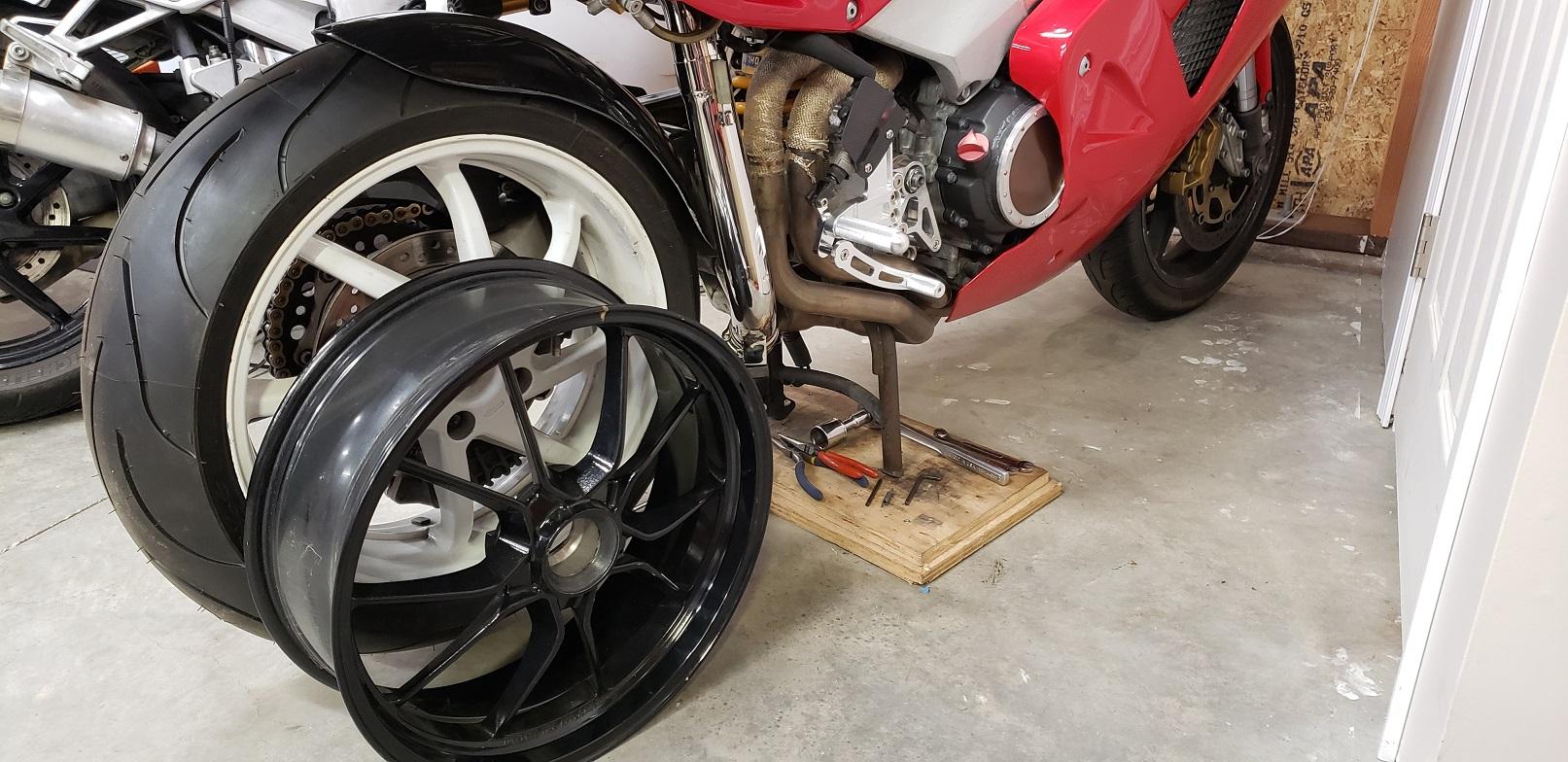

Member Contributer vfrcapn Posted April 22, 2024 Member Contributer Posted April 22, 2024 On 9/16/2020 at 5:48 PM, lplplplp said: oh right i thought it 5.5" damn oh well, i want to stick with 180. maybe weigh with tire on and minus quoted weight of tire? Sent from my ASUS_I01WD using Tapatalk 4 years later.. just weighed this afternoon when changing tires, using a postal scale. Marchesini forged wheel from a 1098 Duc - 7 lb 14oz VFR 5g-6g oem 5-spoke - 13lb 4 oz 2 1 Quote
