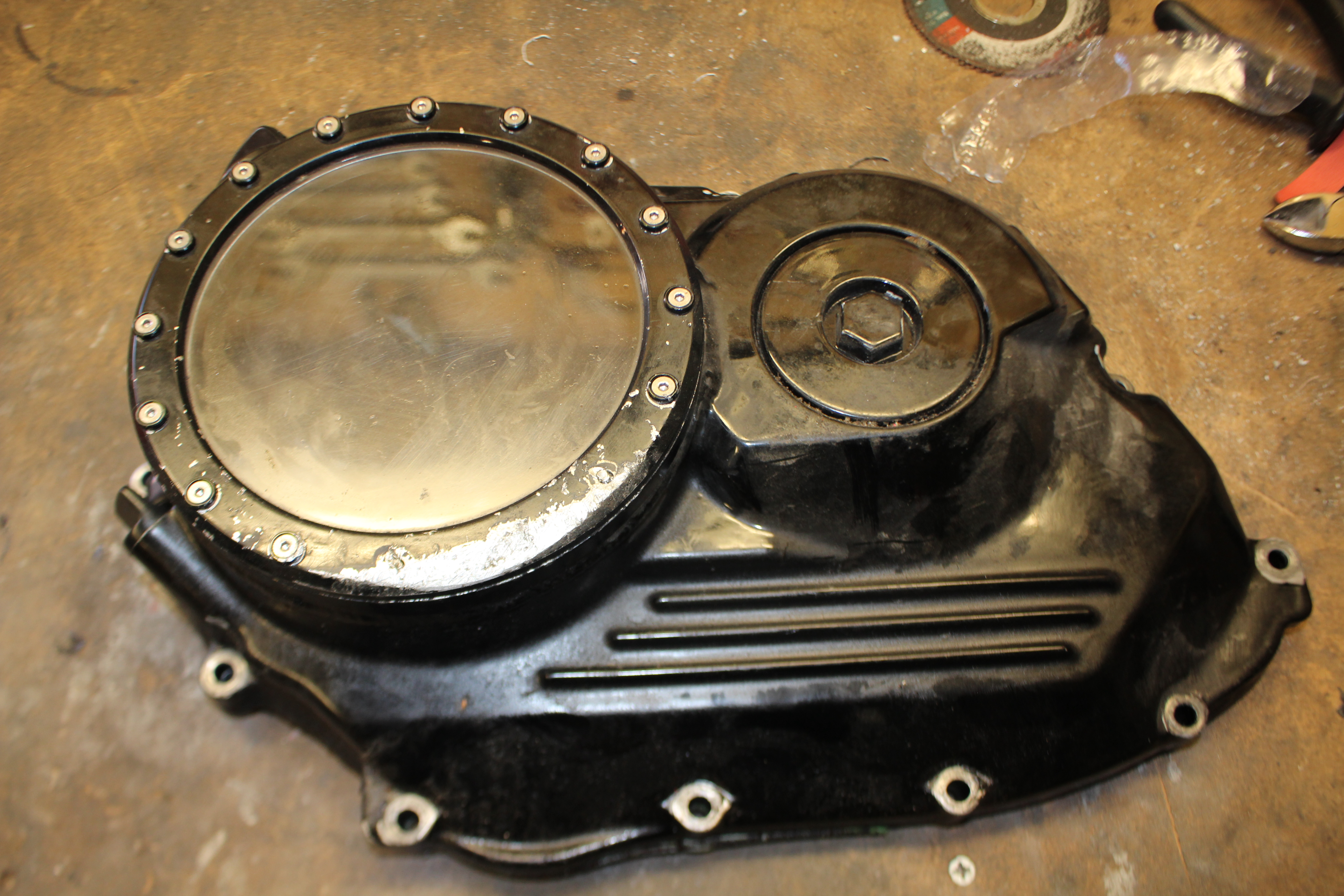

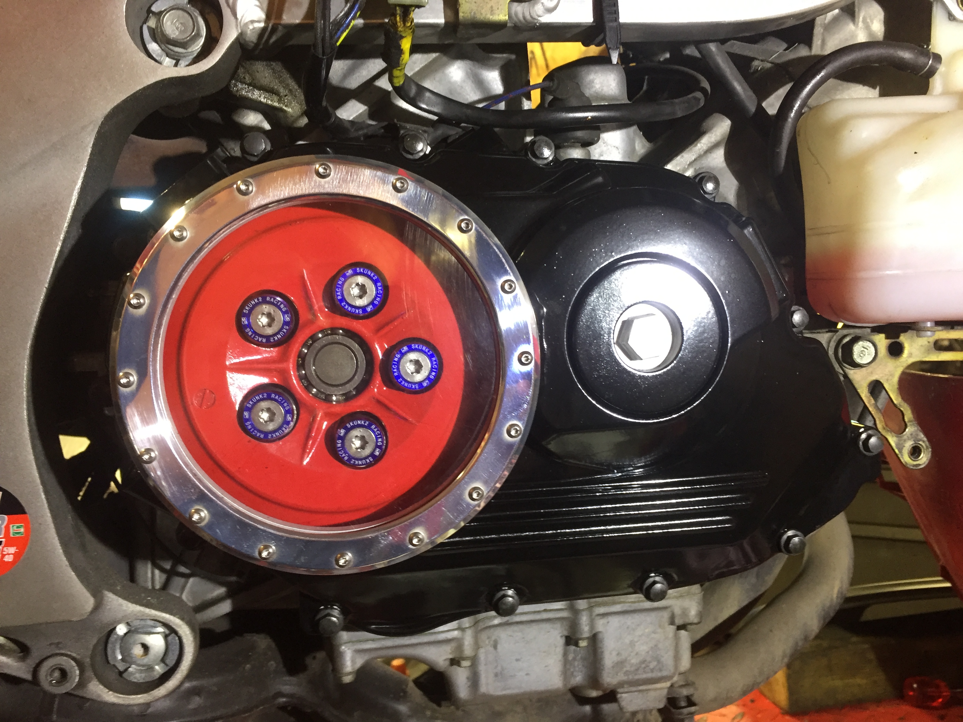

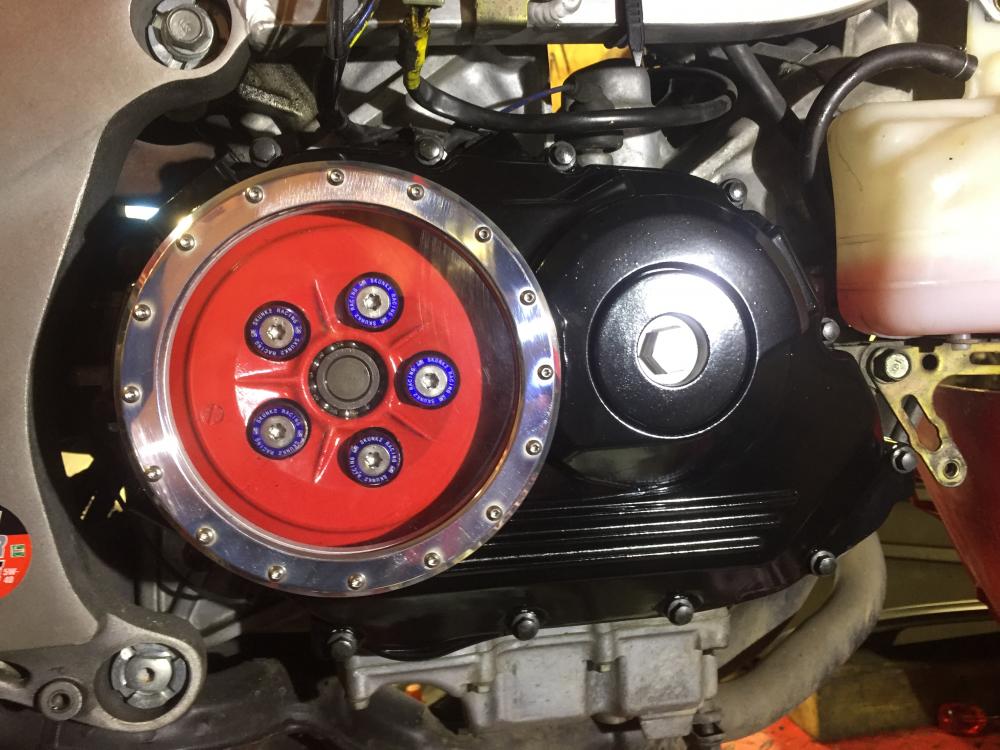

TheDutchy Posted January 15, 2017 Posted January 15, 2017 The clutchcover of redslut has been revived... 2 Quote
Member Contributer LangoPTC Posted January 15, 2017 Member Contributer Posted January 15, 2017 Lovely work. Quote

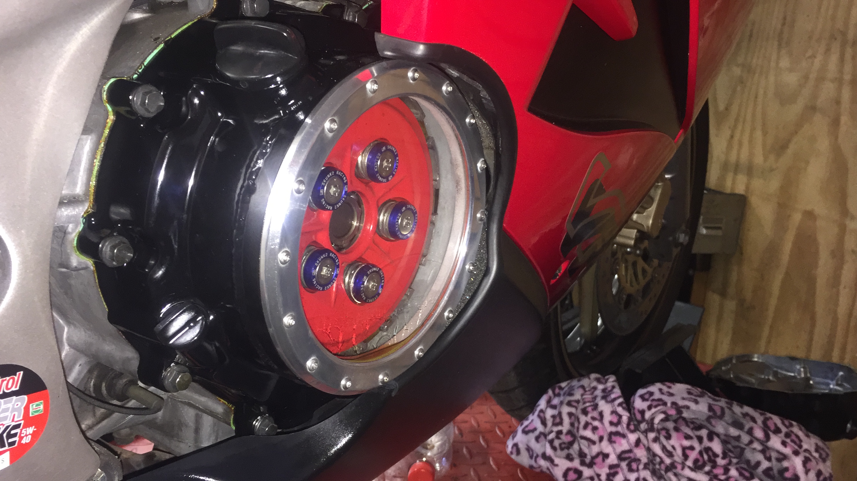

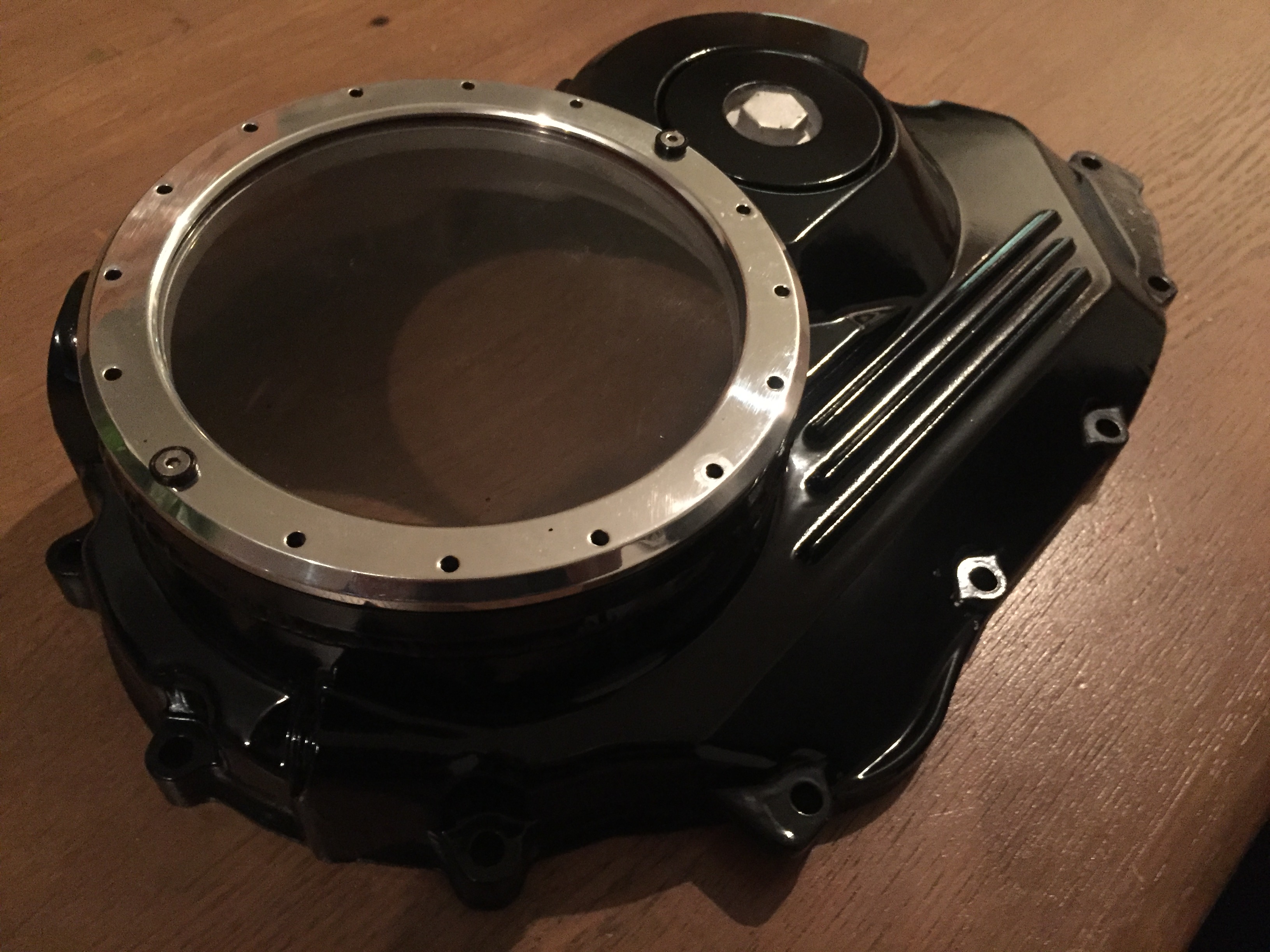

Member Contributer Dutchy Posted January 16, 2017 Author Member Contributer Posted January 16, 2017 Quote
SEBSPEED Posted January 16, 2017 Posted January 16, 2017 Looks good, can't wait to see it out in the wild! It is the first known crash survivor! :D Quote

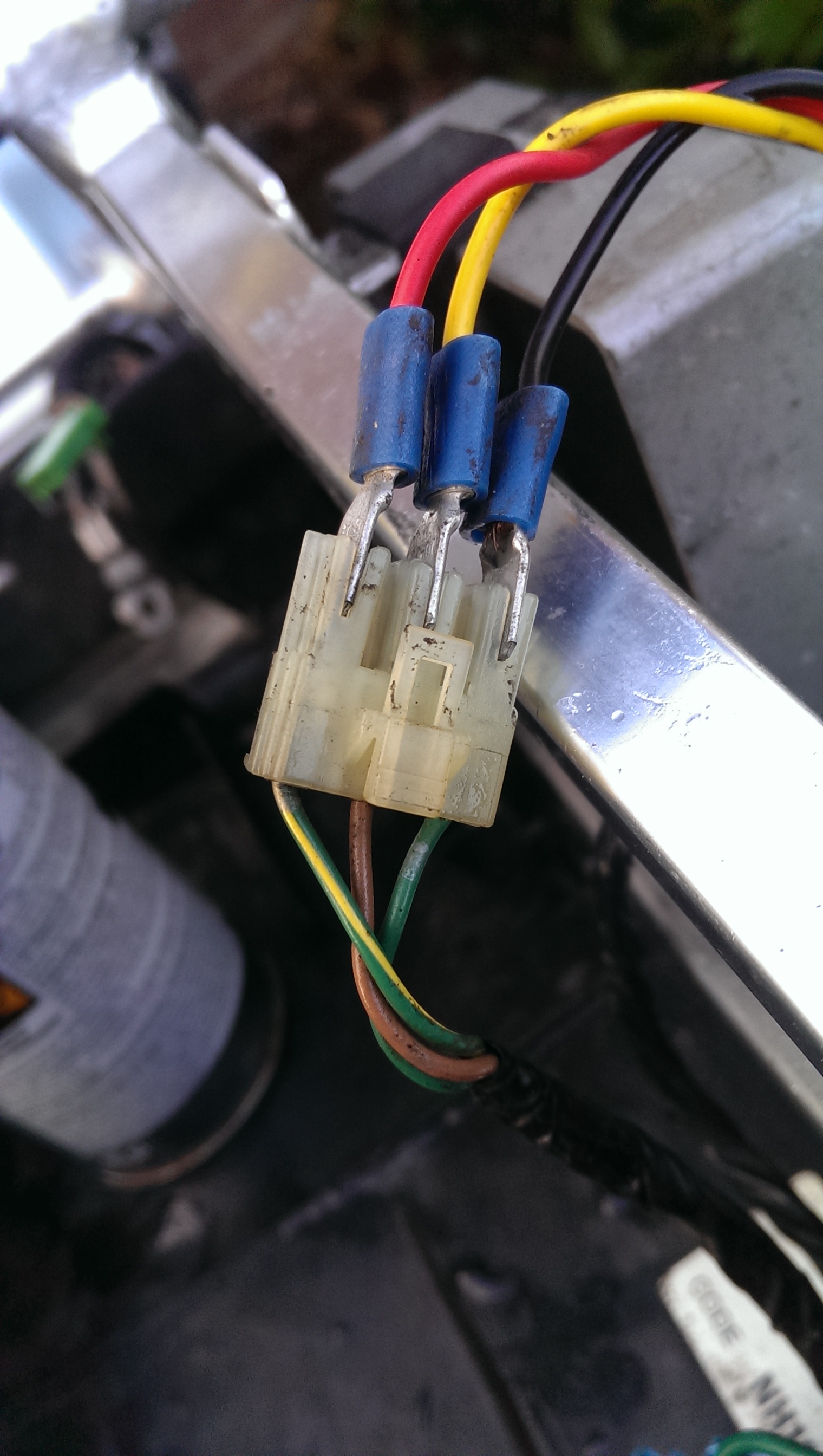

Member Contributer Dutchy Posted January 17, 2017 Author Member Contributer Posted January 17, 2017 Interesting wiring "solution" :-) Quote
atx Posted January 17, 2017 Posted January 17, 2017 Haha wow, that "solution" is a fire hazard waiting to happen. Quote

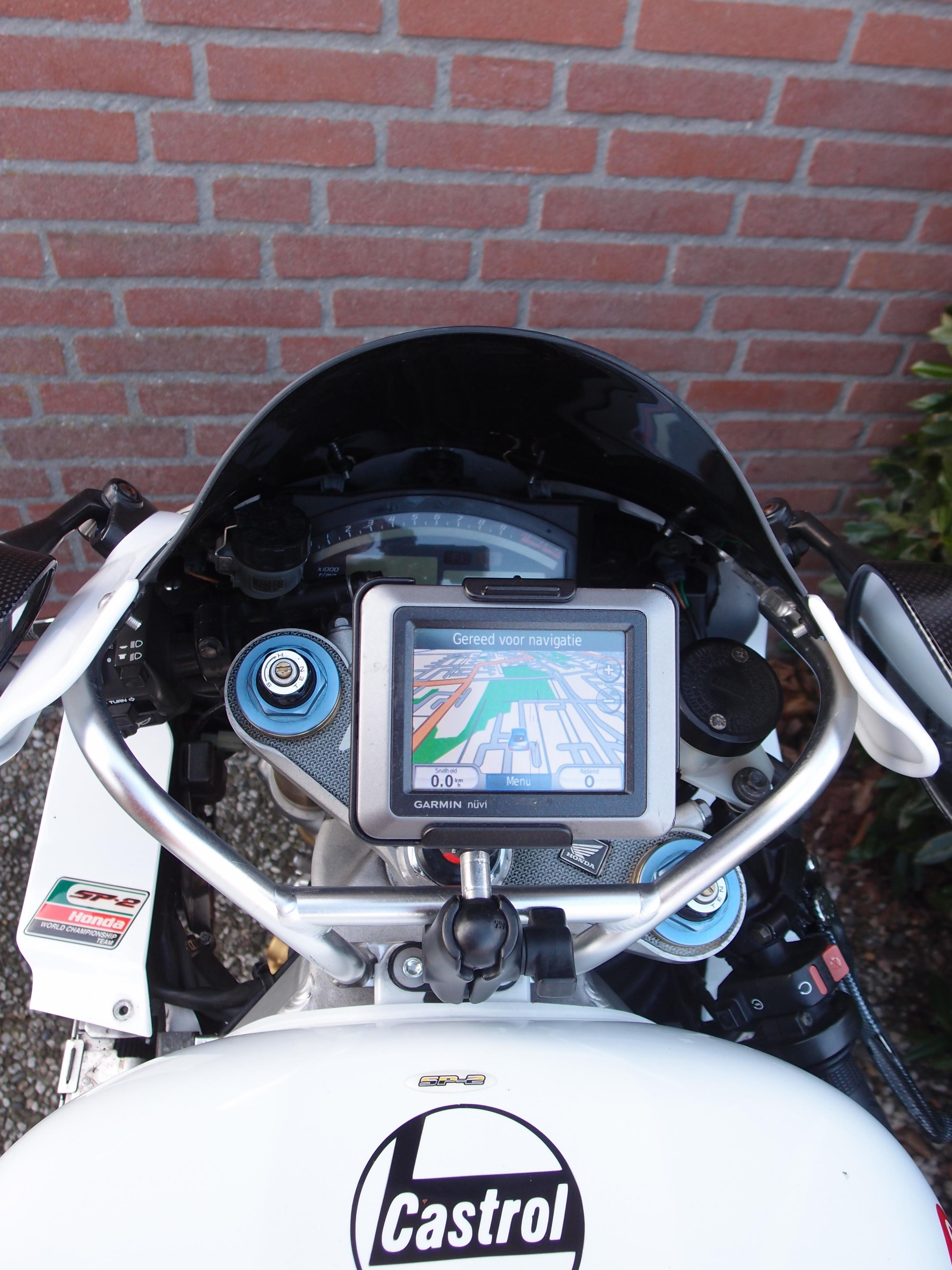

Member Contributer Dutchy Posted January 17, 2017 Author Member Contributer Posted January 17, 2017 OK, she's no tourer no.... But with a (constantly updated) POI database of speed cameras in Europa.... Quote

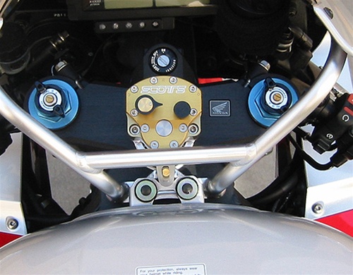

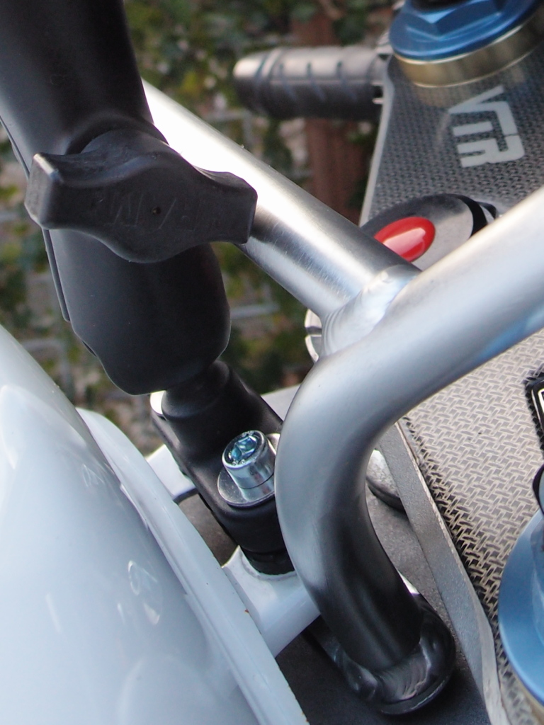

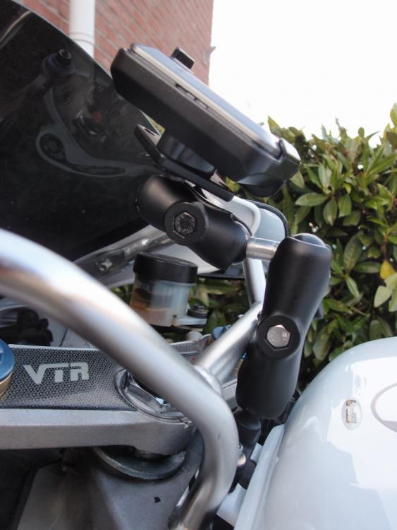

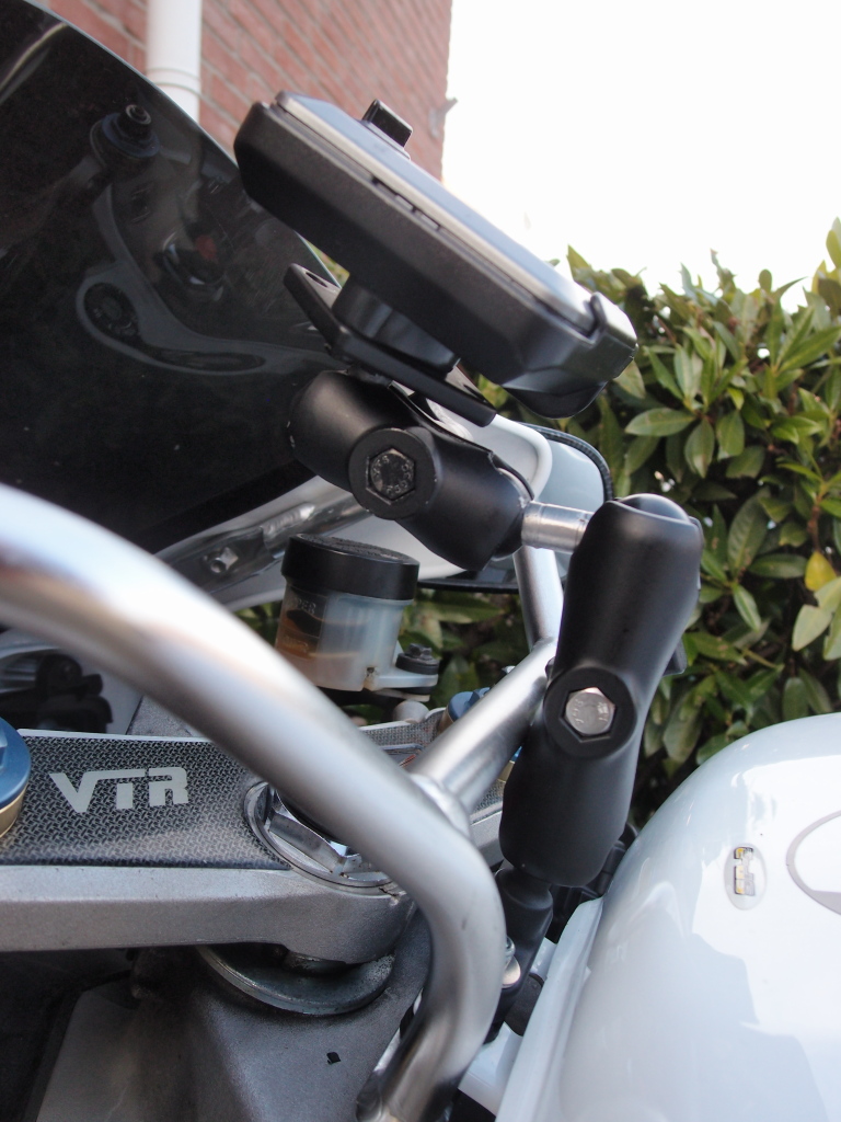

Member Contributer JZH Posted January 18, 2017 Member Contributer Posted January 18, 2017 10 hours ago, timmythecop said: WOULD THAT WORK WITH MY DAMPER? I doubt there's clearance, but you could clamp to the cross-bar. Ciao, Quote
Member Contributer Dutchy Posted January 18, 2017 Author Member Contributer Posted January 18, 2017 Very nice bit of bling; well it would be for me anyway...... :-) Quote
Member Contributer 007 Posted January 18, 2017 Member Contributer Posted January 18, 2017 2 hours ago, JZH said: I doubt there's clearance, but you could clamp to the cross-bar. Ciao, The fairing stay bar is ripe for U-bolt RAM attachments. One for GPS. One for radar. A drink holder mount up there would be an instant touring upgrade! Quote

Member Contributer JZH Posted January 18, 2017 Member Contributer Posted January 18, 2017 10 hours ago, 007 said: The fairing stay bar is ripe for U-bolt RAM attachments. One for GPS. One for radar. A drink holder mount up there would be an instant touring upgrade! Ooouuurrr... Hate those sodding things, personally. Someone must make nice, machined clamshells into which a RAM ball can be installed. Whoops, thread-jack... Ciao, Quote
Member Contributer Dutchy Posted January 18, 2017 Author Member Contributer Posted January 18, 2017 Jack at your leisure... :-) Quote

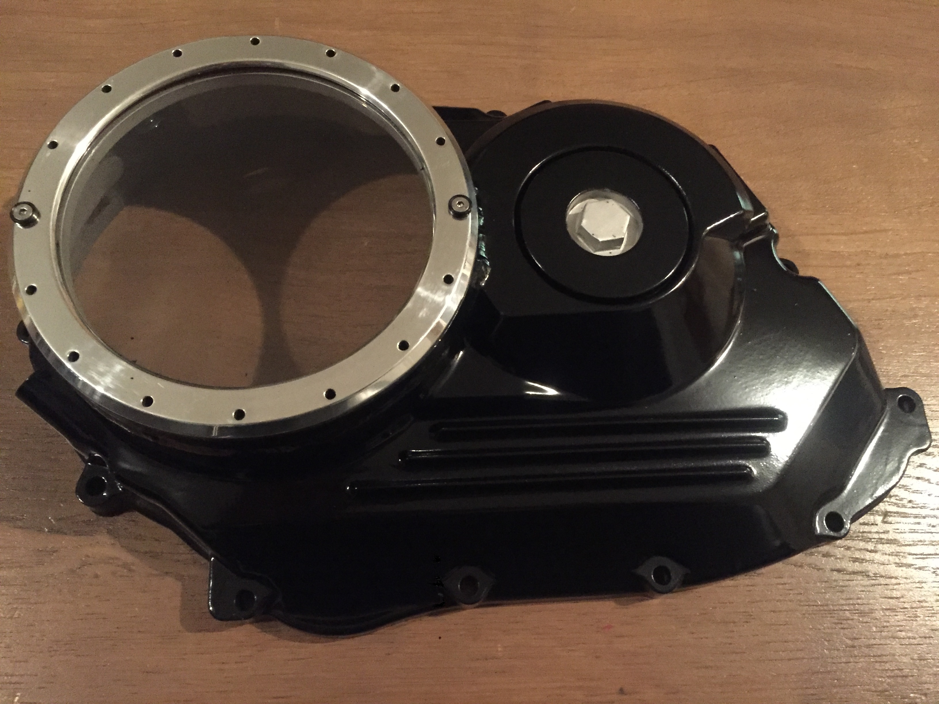

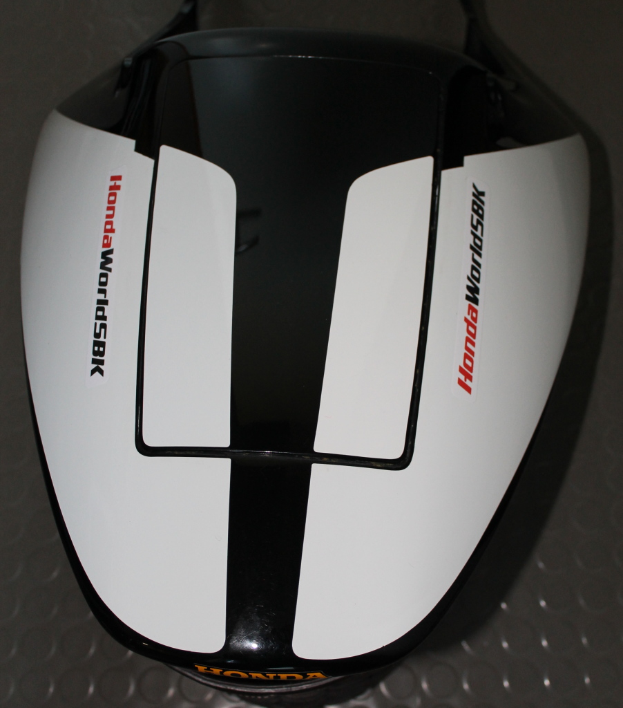

Member Contributer Dutchy Posted January 19, 2017 Author Member Contributer Posted January 19, 2017 A friendly SP'er in NL sent me a bit of white vinyl. Me happy (although there is a tad color difference and I could problably cut it even finer; plenty material left) from to 2 Quote

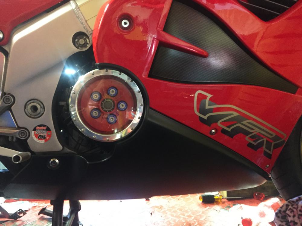

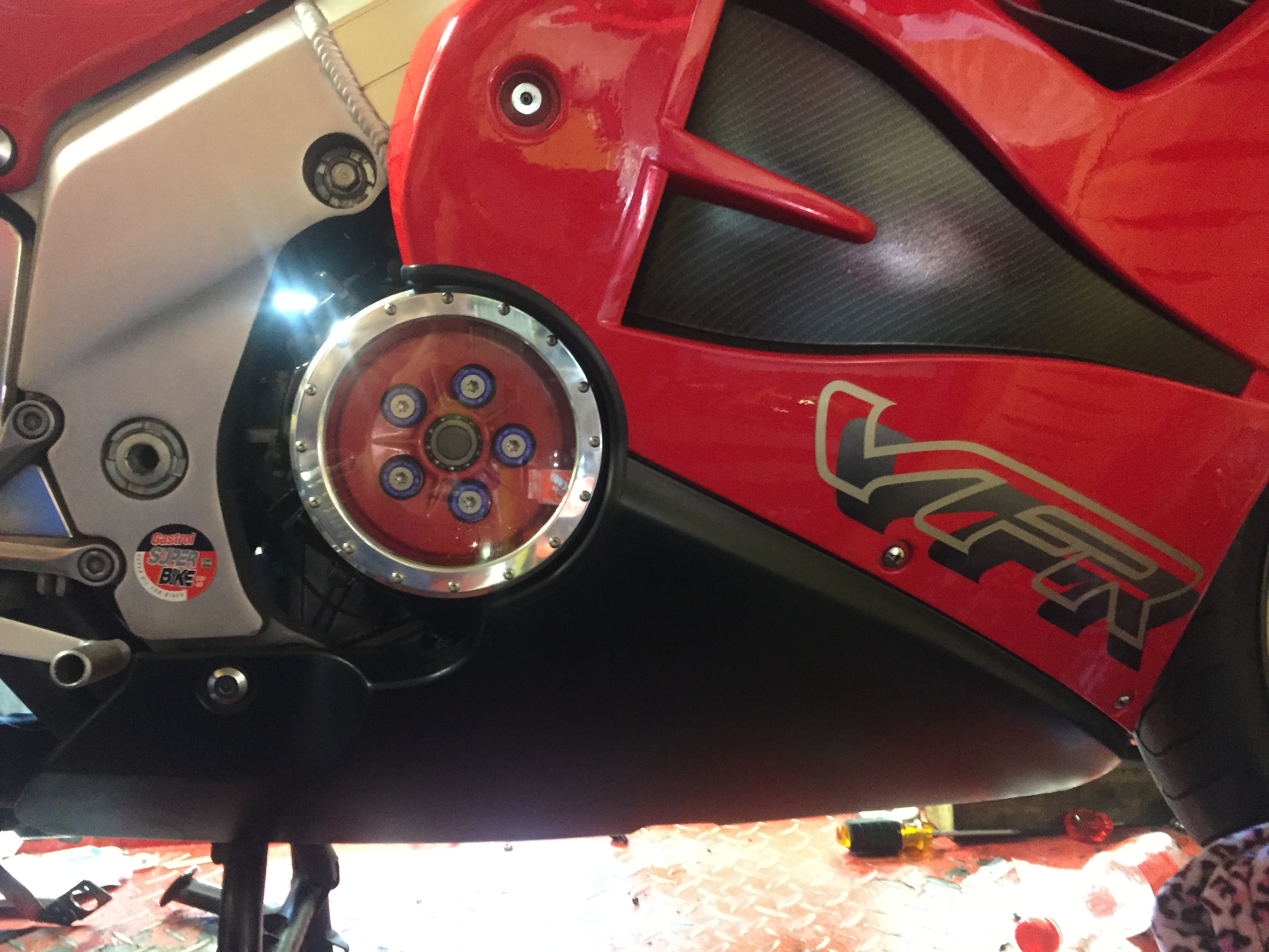

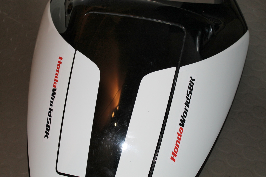

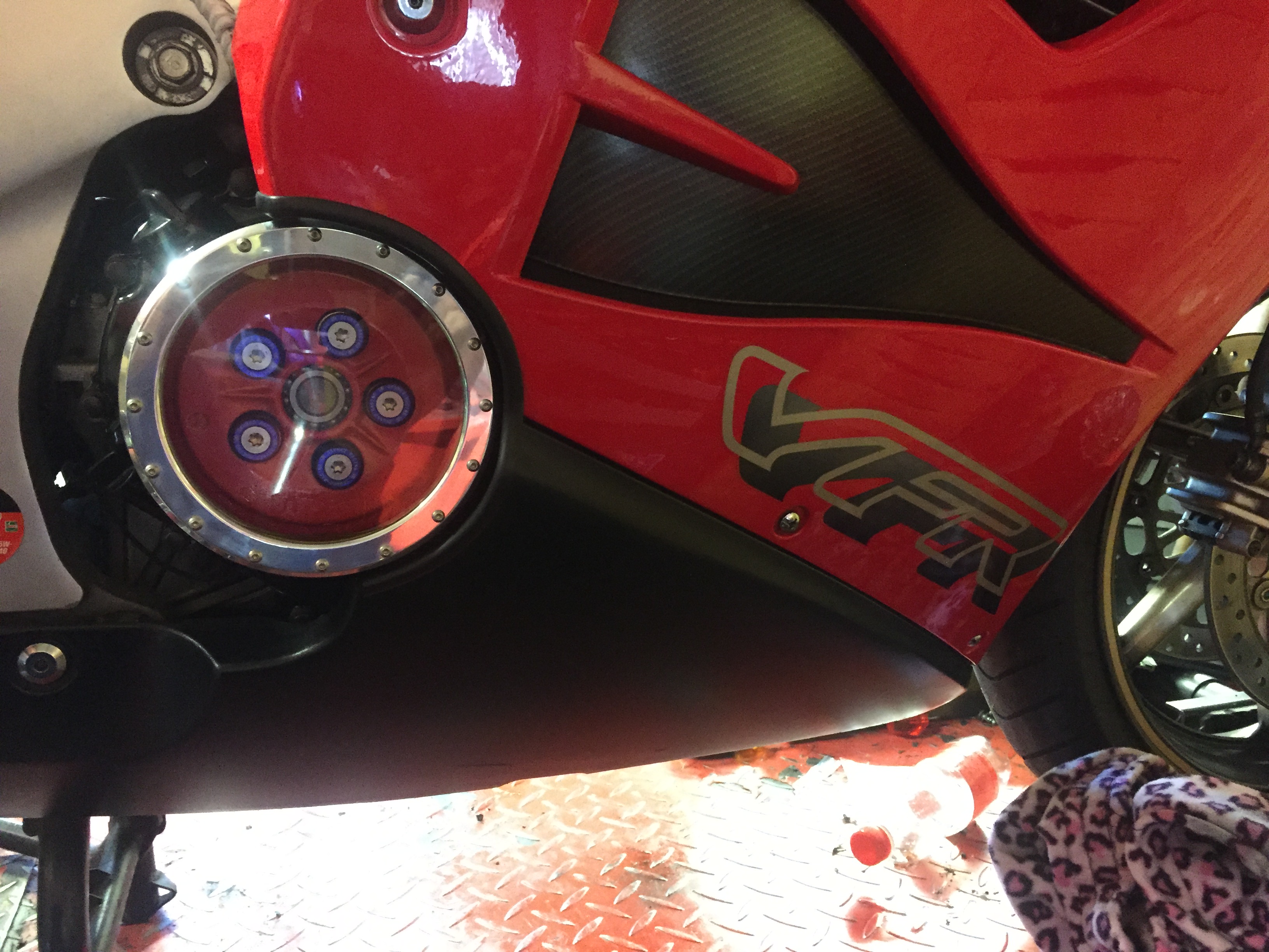

TheDutchy Posted January 21, 2017 Posted January 21, 2017 On 16-1-2017 at 4:10 PM, SEBSPEED said: Looks good, can't wait to see it out in the wild! It is the first known crash survivor! :D Installed the cover on the engine... Did the scary bit... Cutting the fairing bits looks OK from the side..... Still want to change the covers a bit.. The "from the side look in" doesn't satisfy me yet.. But it does have the bling factor.... 3 Quote

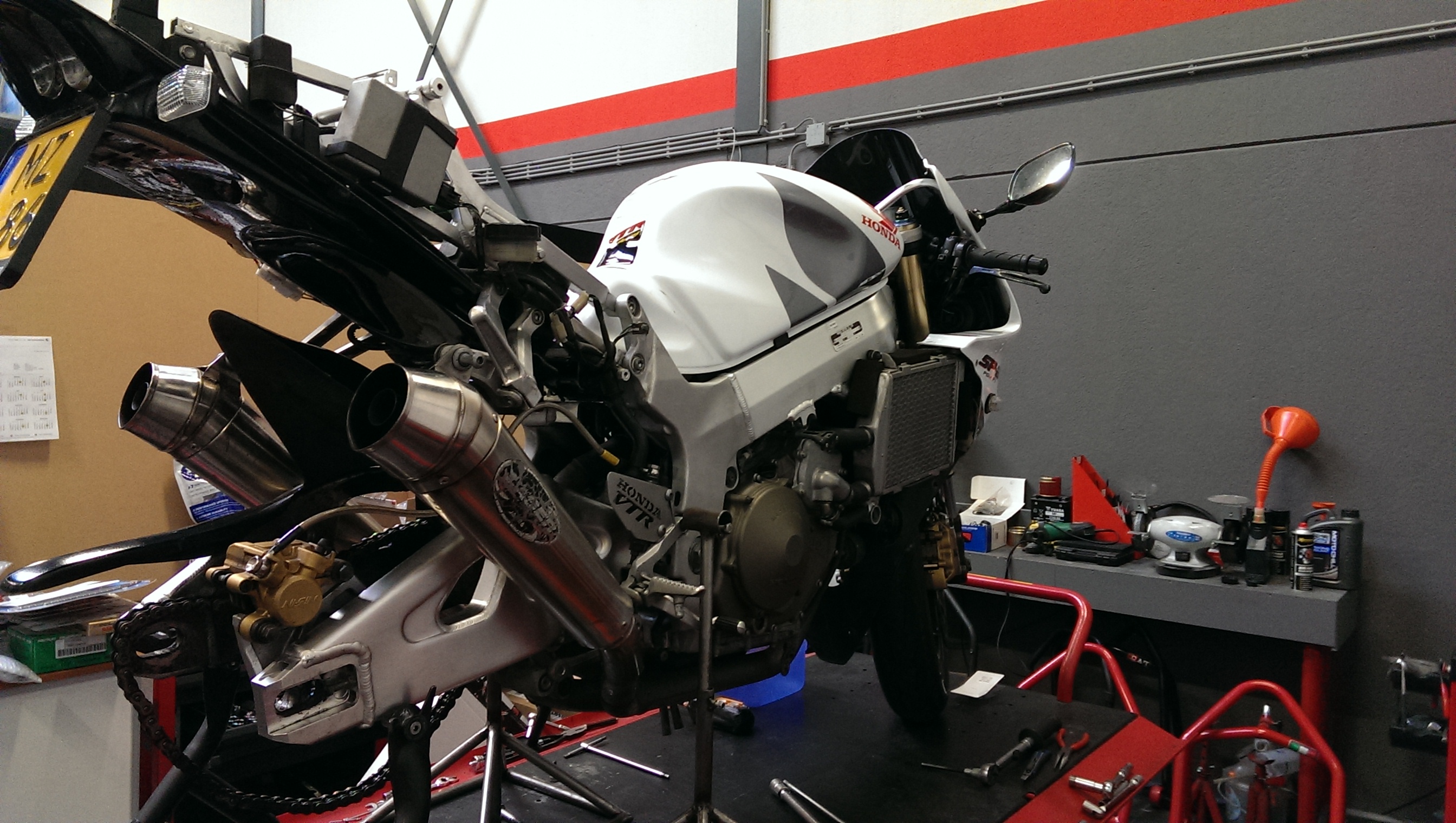

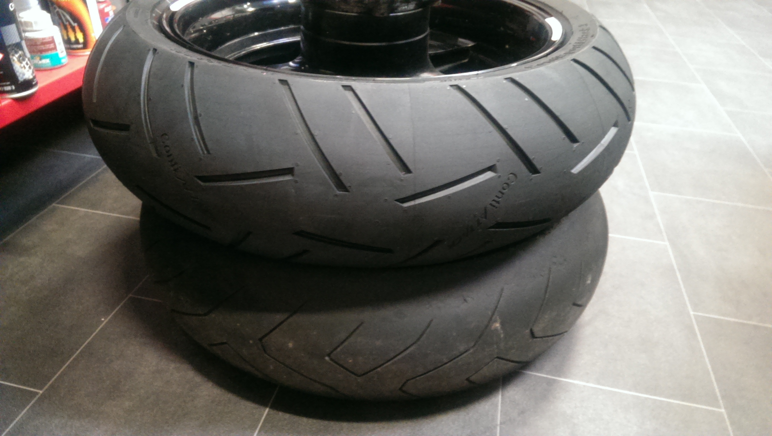

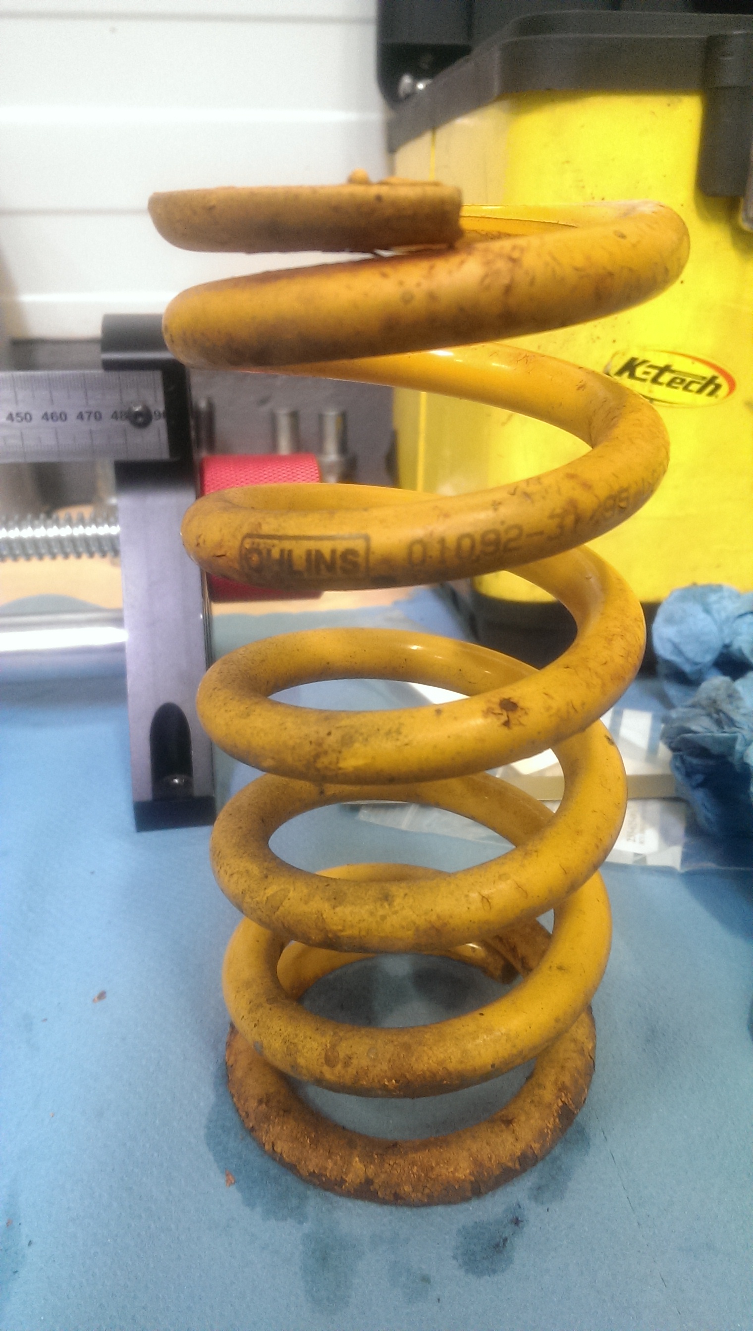

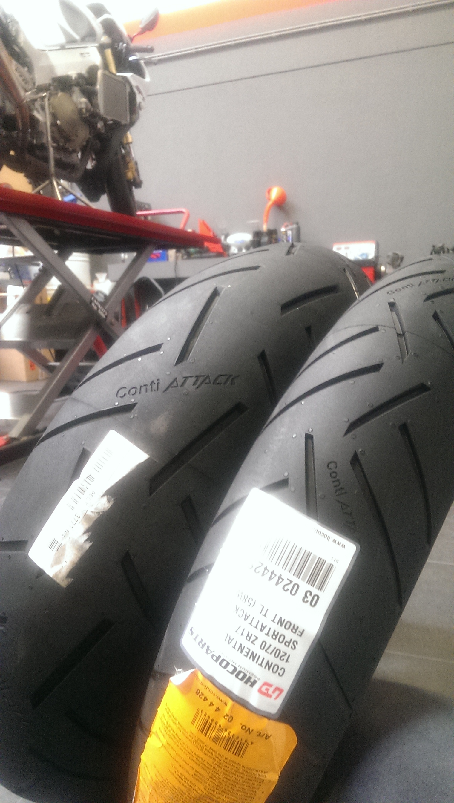

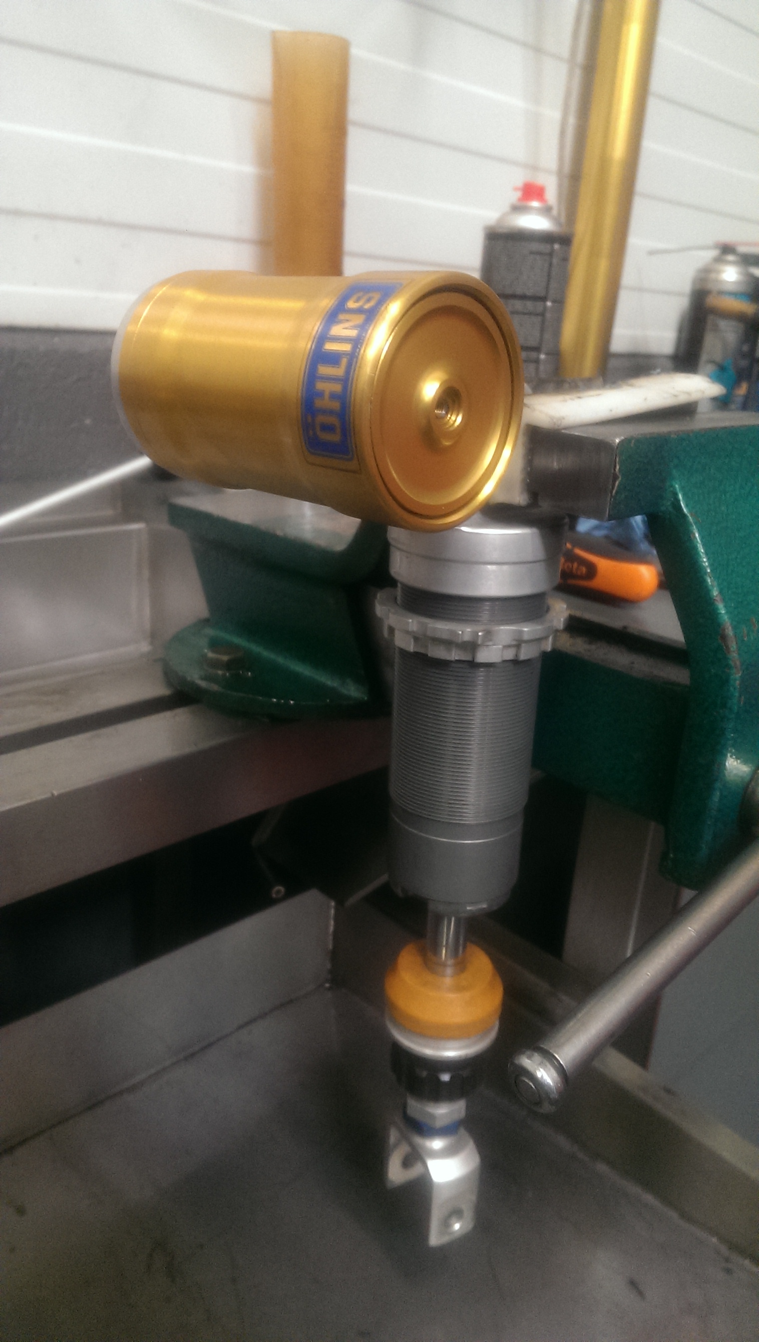

Member Contributer Dutchy Posted January 21, 2017 Author Member Contributer Posted January 21, 2017 Looking good! Salvage complete!!! Stopped by the mechanic today to discuss going +2 up on the rear sprocket and long and behold, they were already fettling her... hussy... Checked that there will be enough "room" for it; the 190/55 is larger (it now has a 190/50) and a larger sprocket mean moving the wheel back a bit. As the chain+sprocket set is on for 3k miles, we'll just put in a new sprocket alone. front sprocket will stay as is, it will want to wheelie enough as is thank you.. The oil in the Ohlins was sticky, so that was well due Good thing they do a lot with Ohlins so a replacement spring was already available. cos this looks like shyte The pre-load adjuster only "did something" near the end of rotations, so that will be services as well New shoes for the old girl John then showed me some really nice Galespeed stuff "that would be nice"... Radial brake/clutch pump+levers and oh yes, rims.... but at 2k I will give them a miss.... 4 Quote
