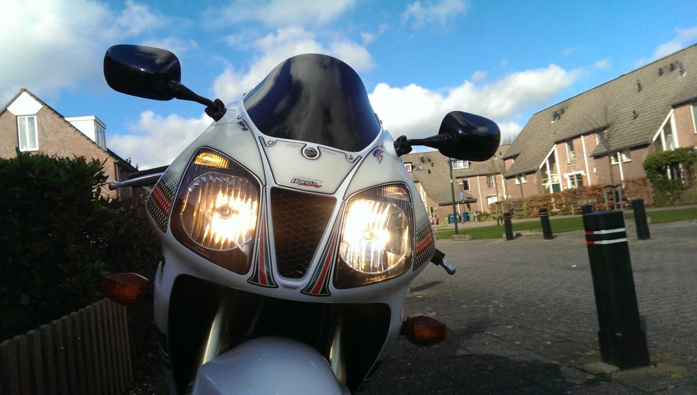

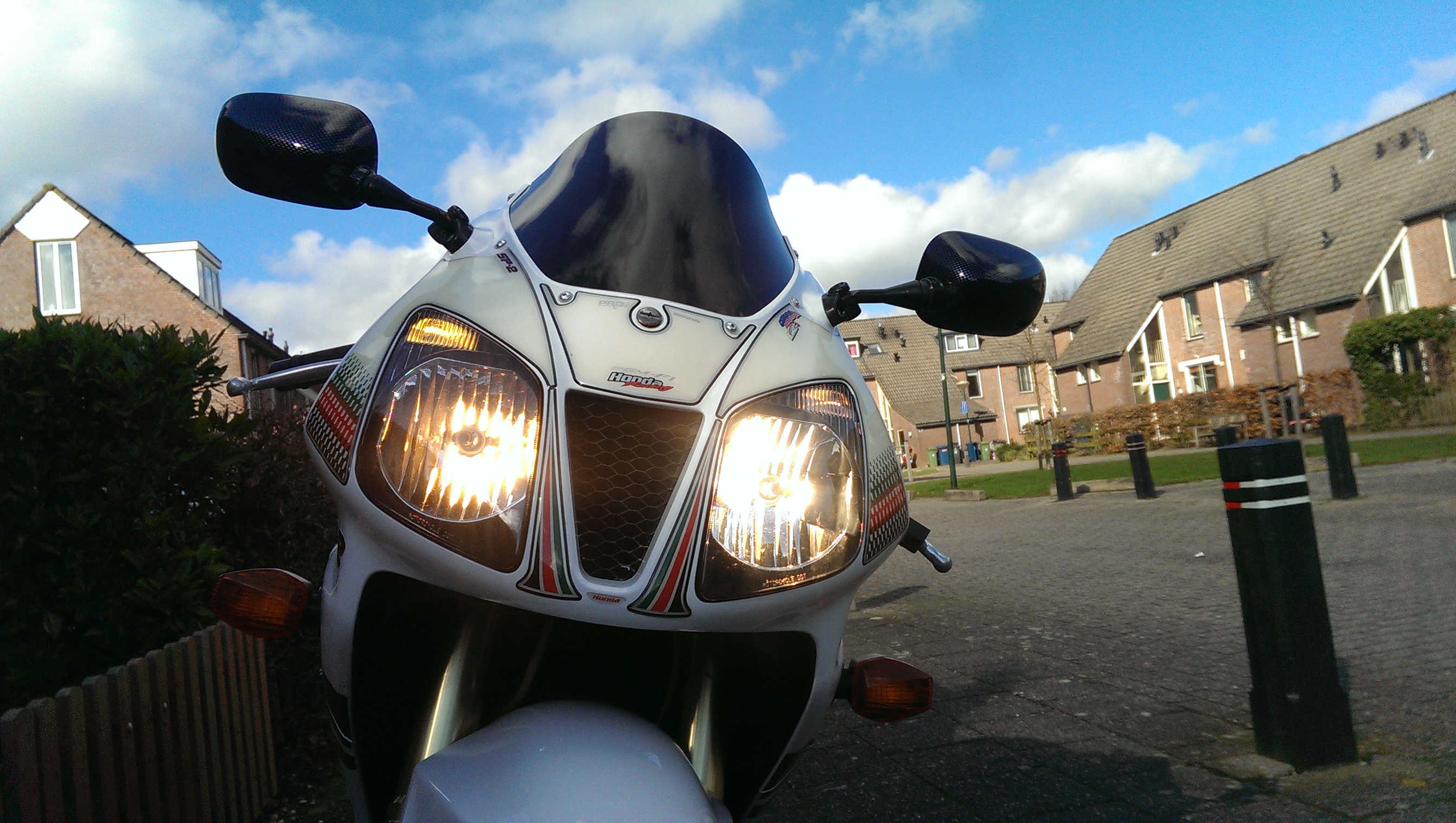

Ok, dual headlights on redslut didnot prevent the Lithuanian driver from not seeing me, but nothing ventured nothing gained...
OEM is 1 headlight mirror "normal" and 1 shaped "hi-beam", both use regular H7.
Connected the hibeam through a control unit that allows me to adjust the strength down so it matches the normal beam/stops ongoing traffic from getting annoyed.
Full power Hi beam/flash function remains.
And yes, there are different light bulbs (one yellowish) in the "running lights"..

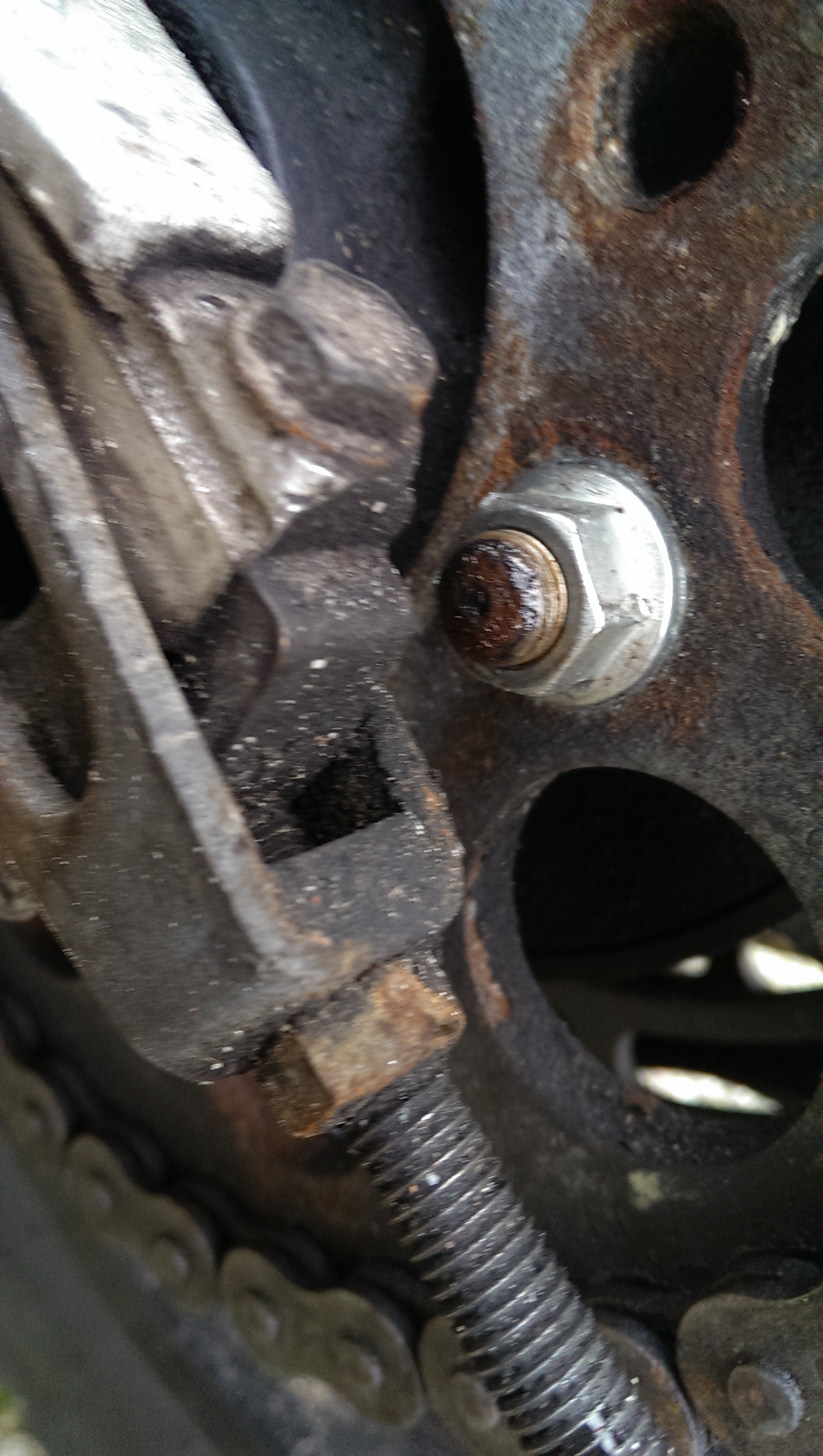

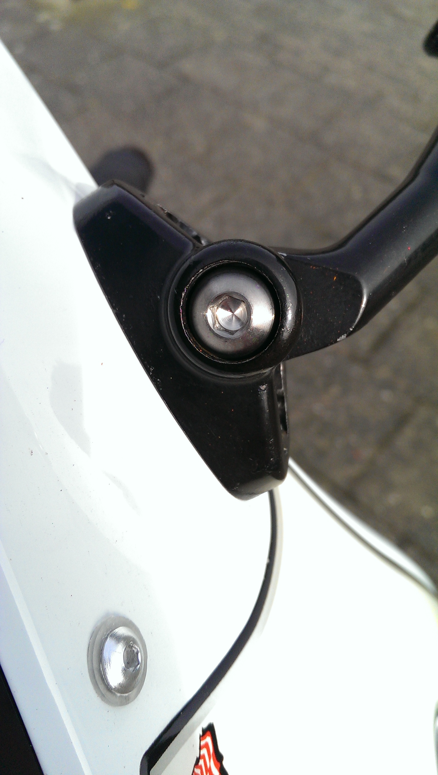

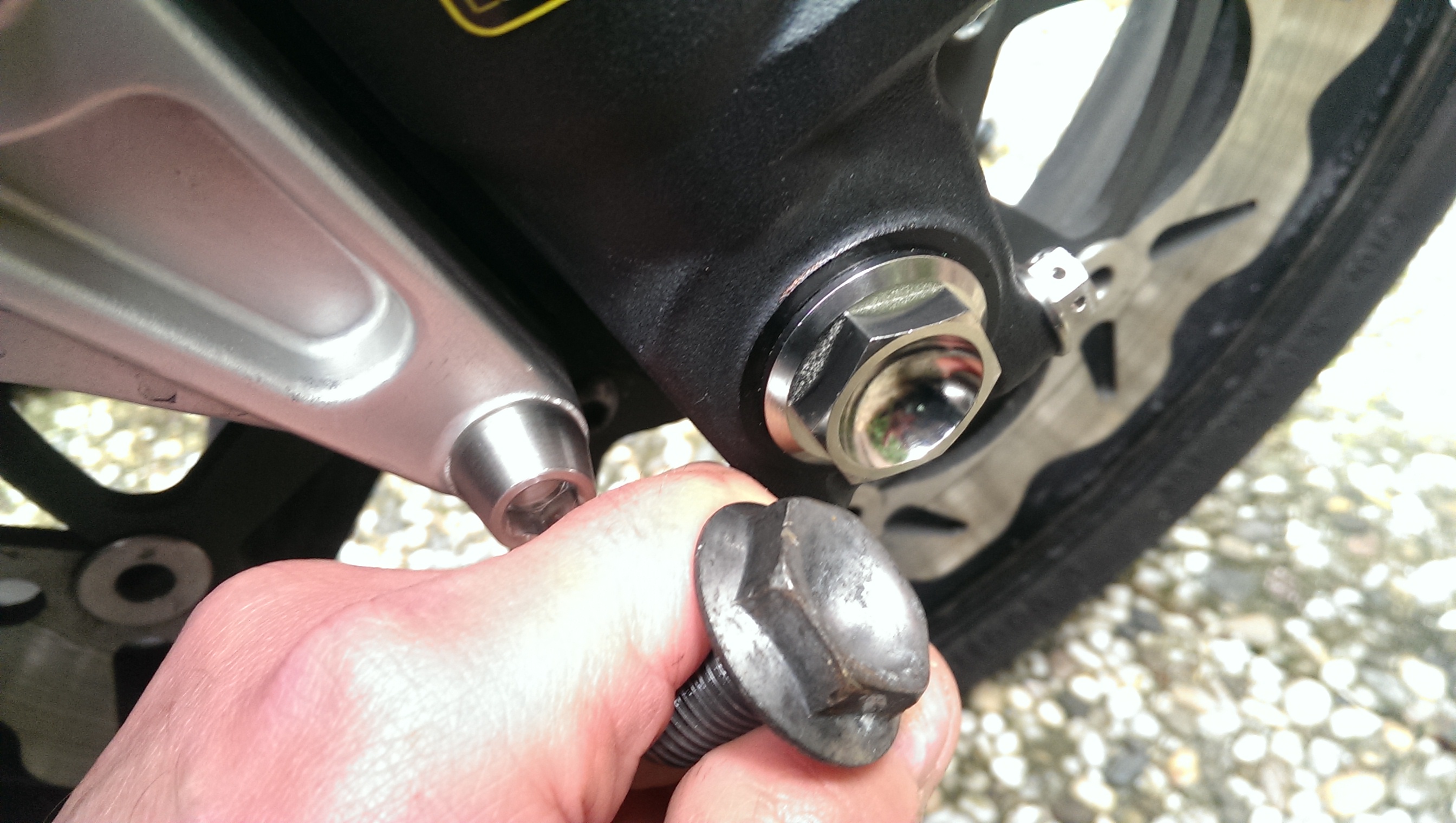

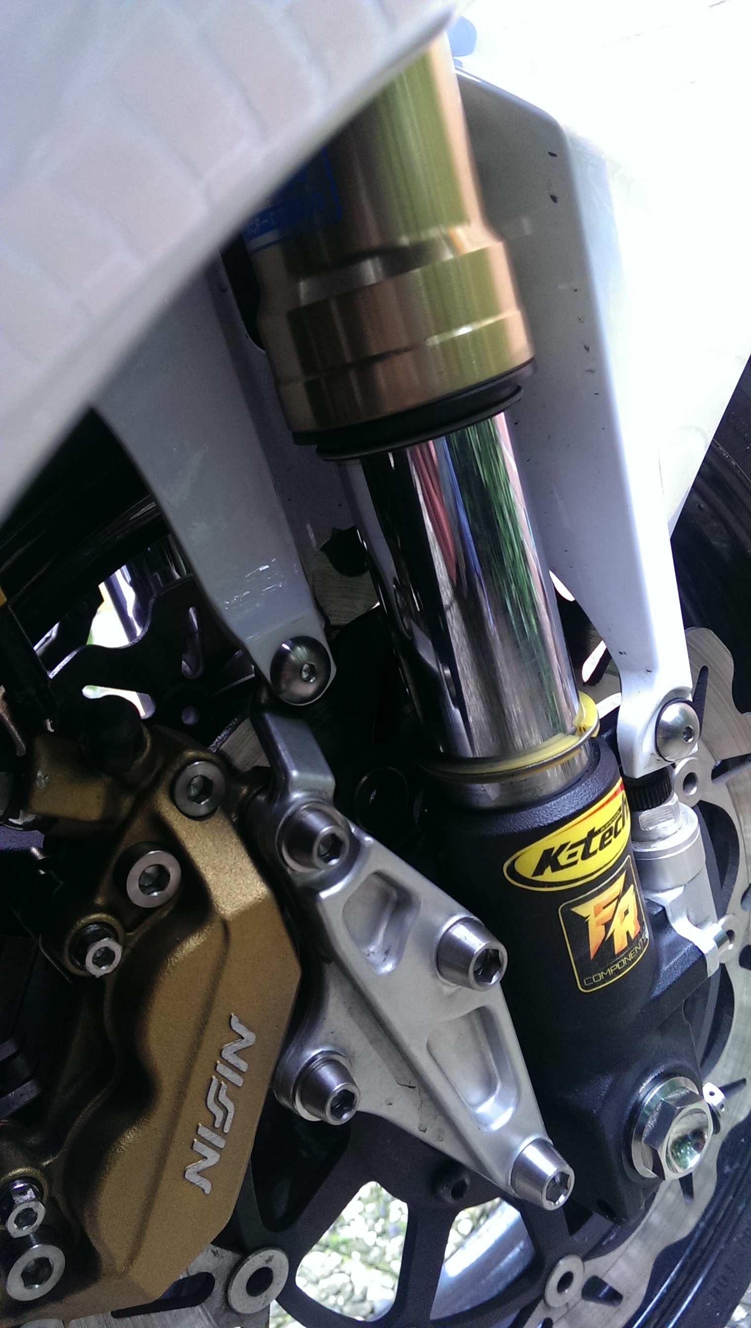

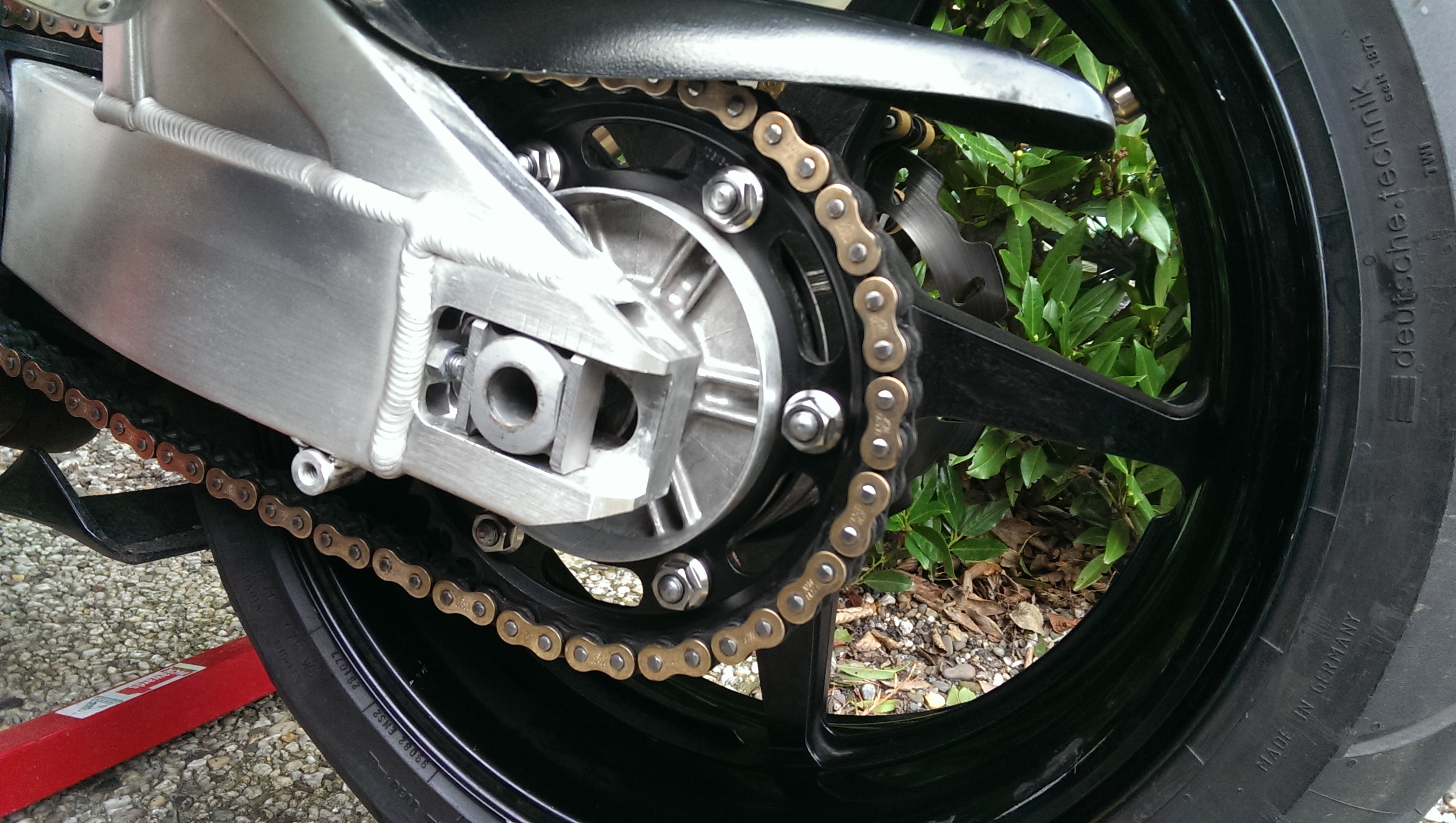

Continued replacing some of the (visible) grotty nuts and bolts on the SP (the VF's sprocket nuts are due too...)
New slider pins are on their way, they are a bit marred from the pads..
Sacrilege???

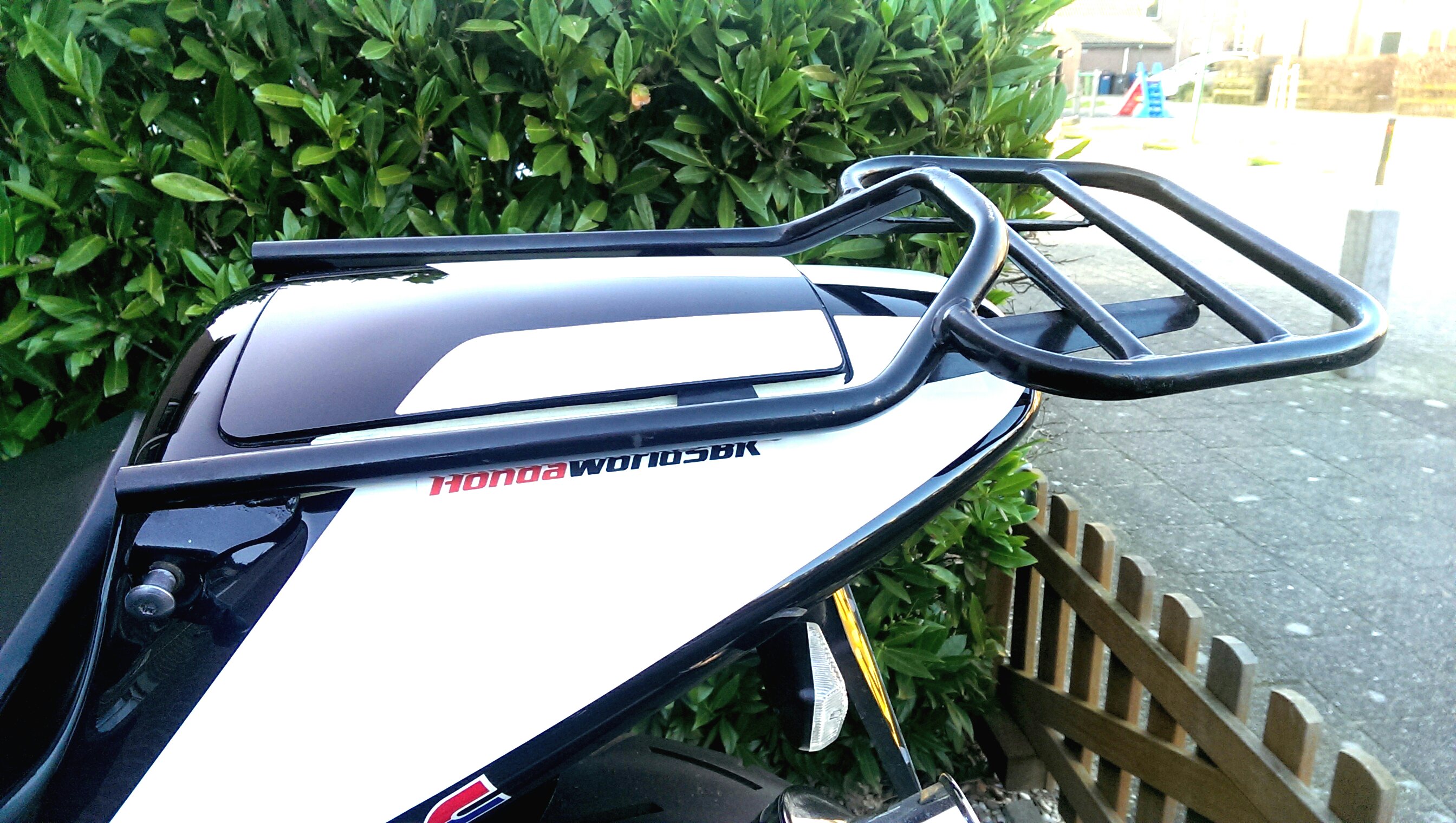

What, no top case?
Patience grasshopper, patience... :-)

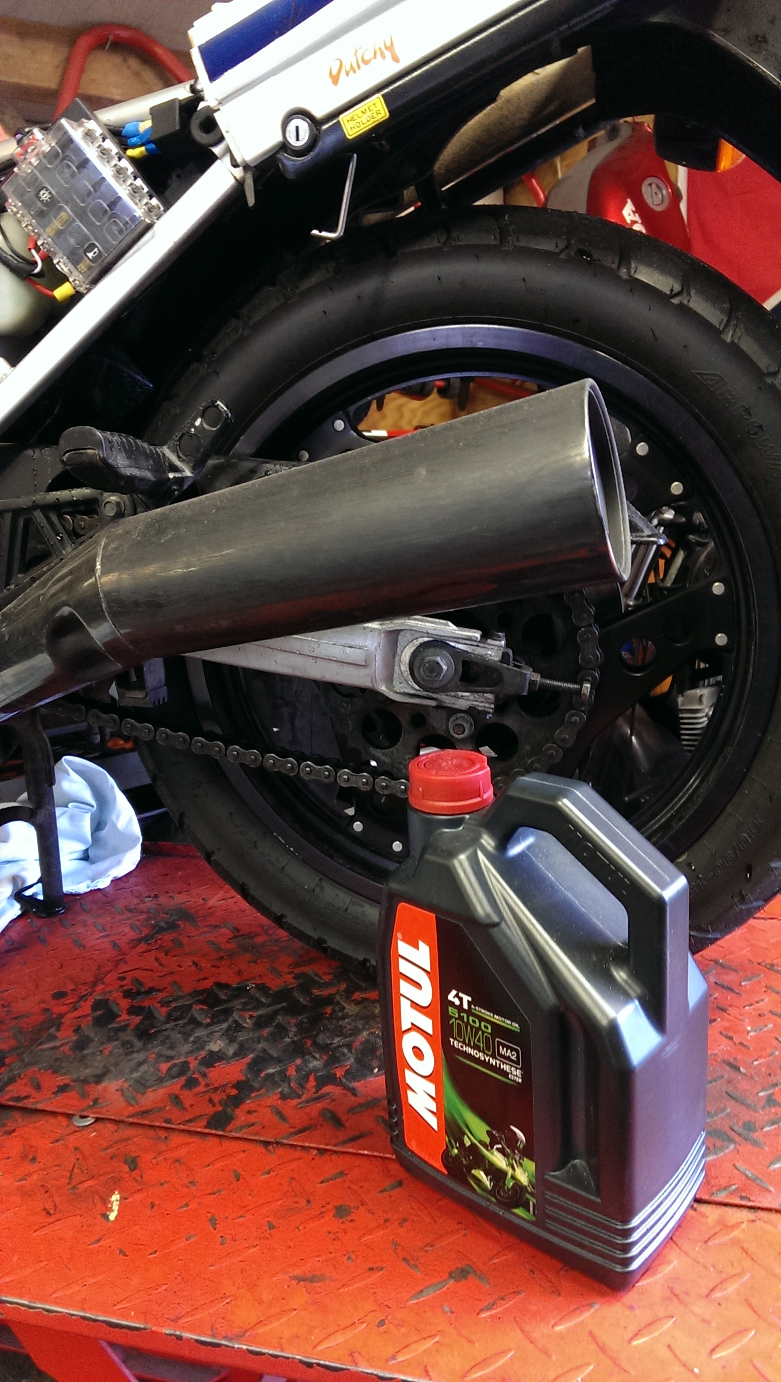

After 6,000km's the Vf was due some TLC.
fresh MOTUL 5100

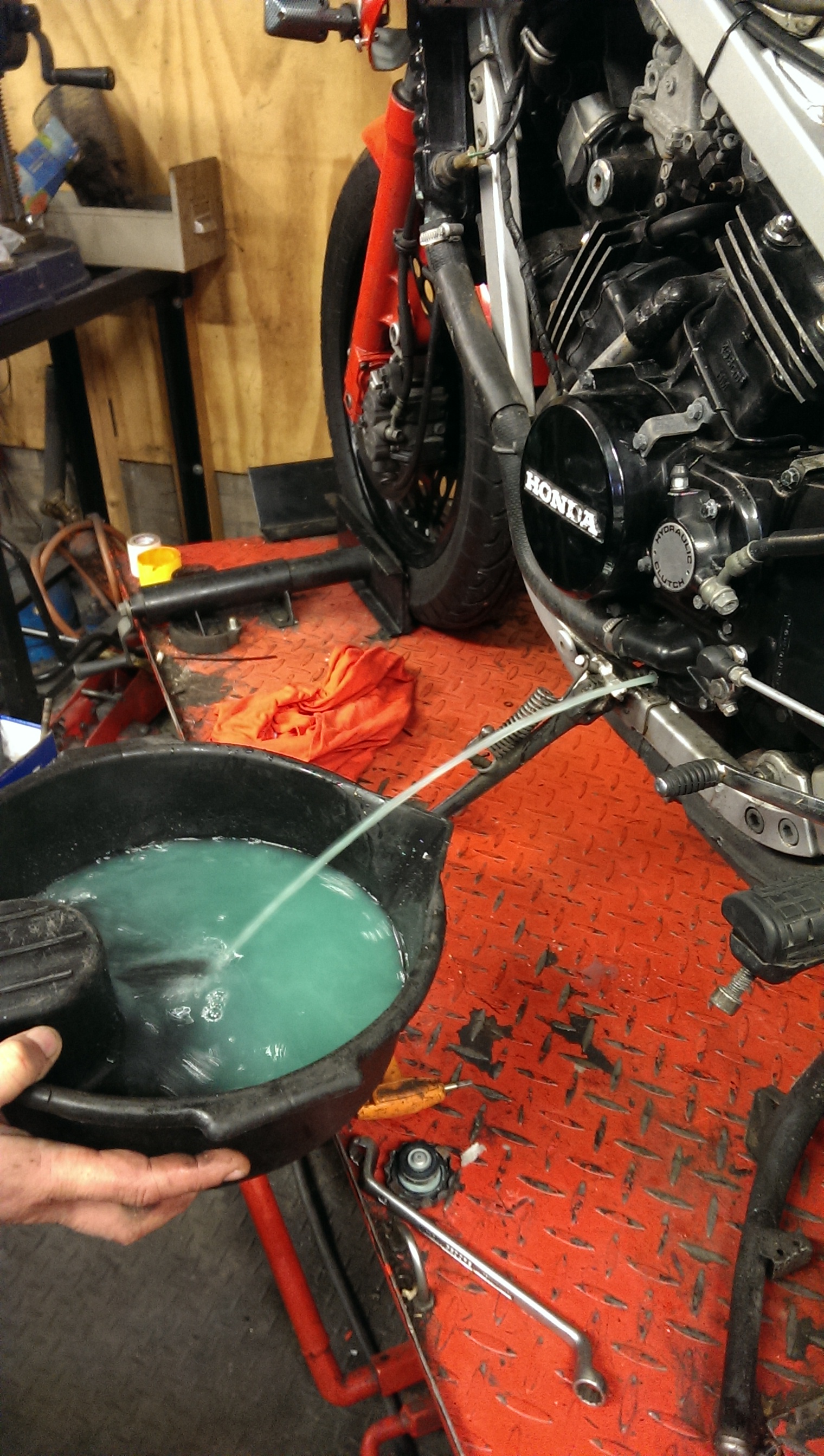

 Fresh coolant (had this milky hue..  mmmhh lets hope this was just "old")

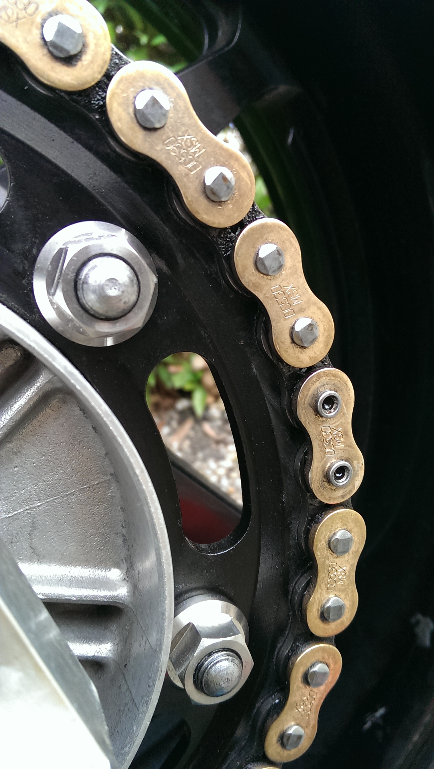

Freshly galvanized nuts on a still grotty looking sprocket

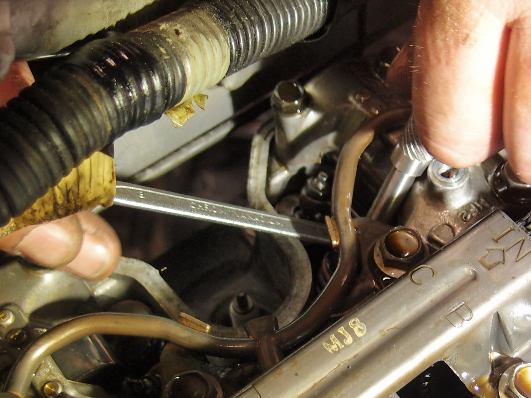

and last but not least got schooled on setting the clearance myself (with the proper tools of corise)

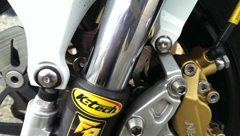

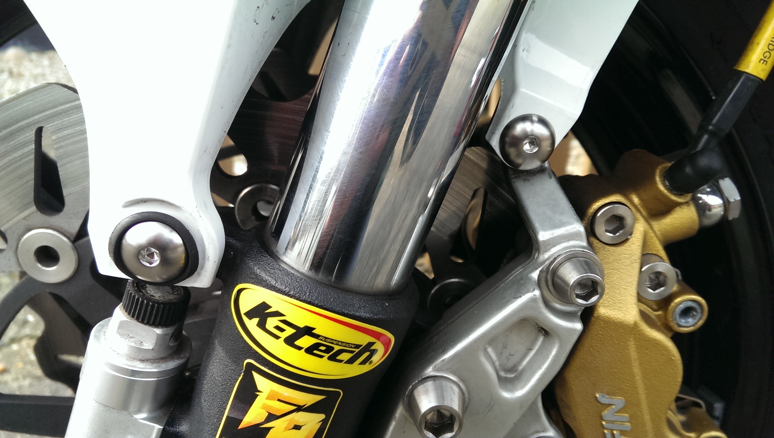

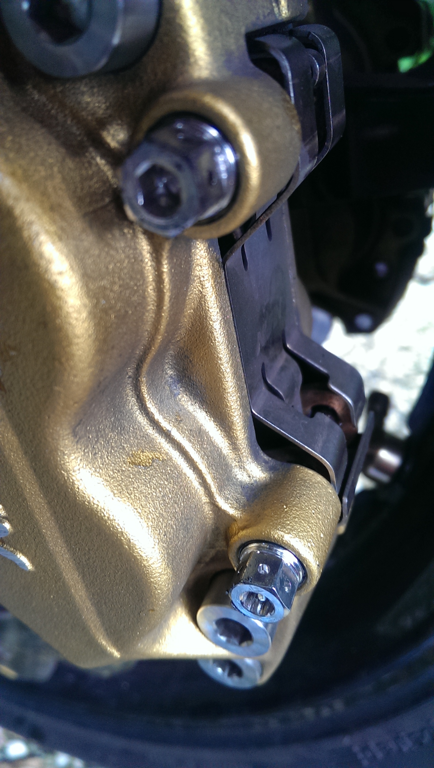

Finalised "cleaning up" the front with some bits from Pro-Bolt
Slainte!!
Now put on some safetywire on those bolts to get the real performance look..
:wink:
Yeah, but will do that by hand, a special pair of pliars for 4 sets of 2 bolts a bit too expensive...
When I teach my students how to safety wire, they MUST do it by hand first and be competent with that, then I show them how to do it with the pliers. To me, safety wire, well it's important, but it is also art. You can tell alot about a mechanic by the way they safety wire!!!
They sell these at Harbor Freight for less than $20. Although as the reviews will point out, not professional grade but they do work.
http://t.harborfreight.com/catalogsearch/result?q=Safety+wire+pliers
Come autumn, I hope you get to inspect my handiwork then in person!!
A fellow SP rider has some spare wire (and pliers) so I will see in the coming weeks that I hook up with him.
When safety wiring, remember if one bolt loosens, it should tighten/put tension on the other one. The best way to think about it is a reverse  or mirrored "S".
http://navyaviation.tpub.com/14014/css/Safety-Wiring-Methods-116.htm
