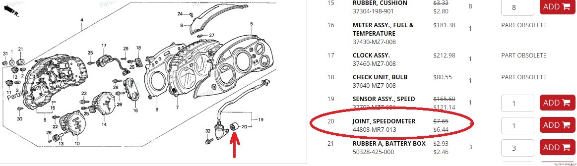

Member Contributer MaxSwell Posted December 1, 2015 Member Contributer Posted December 1, 2015 Slightly off-topic but I learned something with my last chain and sprocket installation. My Honda dealer had a new-to-the-VFR mechanic do my changeout. First issue: he trapped the sidestand wire between the front sprocket cover and the engine case (?) which kept the speedo drive from working. I discovered it on the way home, went back to the dealer and the mechanic pulled the ss switch wire out of the way and reinstalled the cover. 600 mi later, on the way to SumSum3, my speedo/odo stopped working again. Then while picking up Miguel in Co. Springs, Miguel fixed it. What had happened: the sprocket that was removed was thicker that stock, as noted to me buy the shop manager at the time, but did not realize the complication it would cause. With the thinner sprocket, the speedo drive white plastic male nut cover (Dutchy insert comment here) did not engage the countershaft (?) nut. Miguel slid the white plastic thingie on its axle toward the nut, engagement was achieved, and I was back in business. Thank you HS! I hope this spares someone some head scratching in the future. 1 Quote
