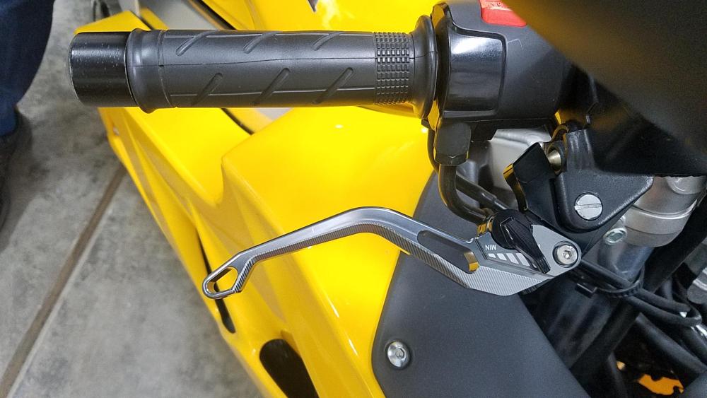

fabio222 Posted February 14, 2025 Author Posted February 14, 2025 Meant to come back to all of your good folks on this... I took the nice milled aftermarket levers off of my VFR 750 and put them on the 800. Man, the levers made all the difference! I'd already cleaned and greased the calipers so I knew they were in good shape and the fluid is fresh in both brake and clutch reservoirs. The new levers allow me to use the clutch far more effectively and the new front brake lever is more adjustable but, more importantly, allows for far more "feel". I can now feel how much brake pressure I am applying. The brakes, as they always were, are plenty powerful for me, but I now know what they are doing too. Simple as that, new levers! By the way, these are the levers. Cheap and cheerful. I've had them for about 7 years now and they've been very nice to use on my RC36. Generic Chinese levers, nothing fancy. Quote
Member Contributer bmart Posted February 14, 2025 Member Contributer Posted February 14, 2025 Those are the standard Chinese kiddo made ones. I also have them on nearly all of my bikes. I did try an alternative on the '00. 1 Quote
Member Contributer MBrane Posted February 15, 2025 Member Contributer Posted February 15, 2025 Interesting. I never saw the value in aftermarket levers, but then I have large hands. I do prefer thicker grips as the stock/thinner ones tend to give me hand cramps on long trips. Quote
Member Contributer Captain 80s Posted February 15, 2025 Member Contributer Posted February 15, 2025 I have haven't liked how some aftermarket levers (clutch) seem to screw with feel of the friction zone. Like it moves it or changes the duration, as if the leverage ratio has changed. 1 Quote
