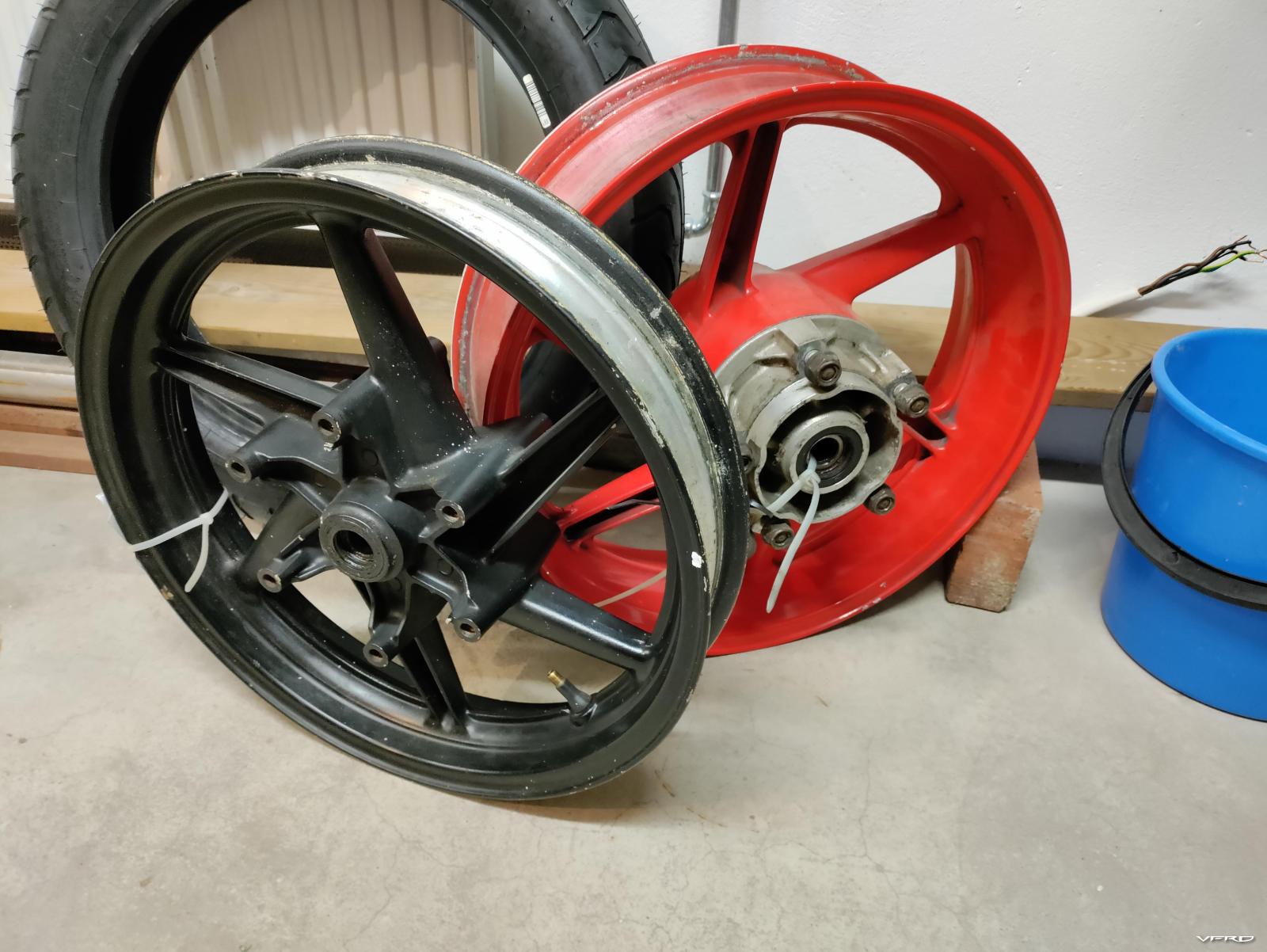

Today 2 quite different size boxes arrived
Β
What was in the 2 boxes
Β
The black in the smaller box whit just some styrofoam on other side of rim, the red in the bigger box that had a lot of cardboard (sheets as boxes) inside, how I like to see things packed! Both had survive the shipping ok thro
What rear tire are you gonna mate up with that bias front?
Β
That's a 4.5x17 rear?Β  And a 2.5x16 front?
Posted (edited)
Yes, 2,5x16 front 4,5x17 rear. I was first thinking of a cb seven fifty F2 (1992 on) rear wheel that is 4" wide as a rear and convent from 17 to 20mm axle, but then thought at 4,5 is a better choice if I in some point decide to try the cbr1000f fork I have...
I'm not sure what size yet tire
Been looking at outer diameters and sizes and 150/70 or 160/70 are mostly what I been looking at, depending on what shock I end up whit. I can go bias or radial in those size. The 160/60-17 that the CBR F2 has as stock is slightly smaller in diameter. I know one that has used the StreetSmart front whit a Radial (Avon) rear whit excellent results (on a FJ1200 that has 16" wheels).
So a matching StreetSmart or RoadSmart perhaps or a GPR300 if a Dunlop, I will see, next summer I plan to still use OEM rear wheel as it has a good tire, to see the bike runs good, then next winter do bigger change to the bike, rear wheel as shock and hopefully the CBR900 fairing.

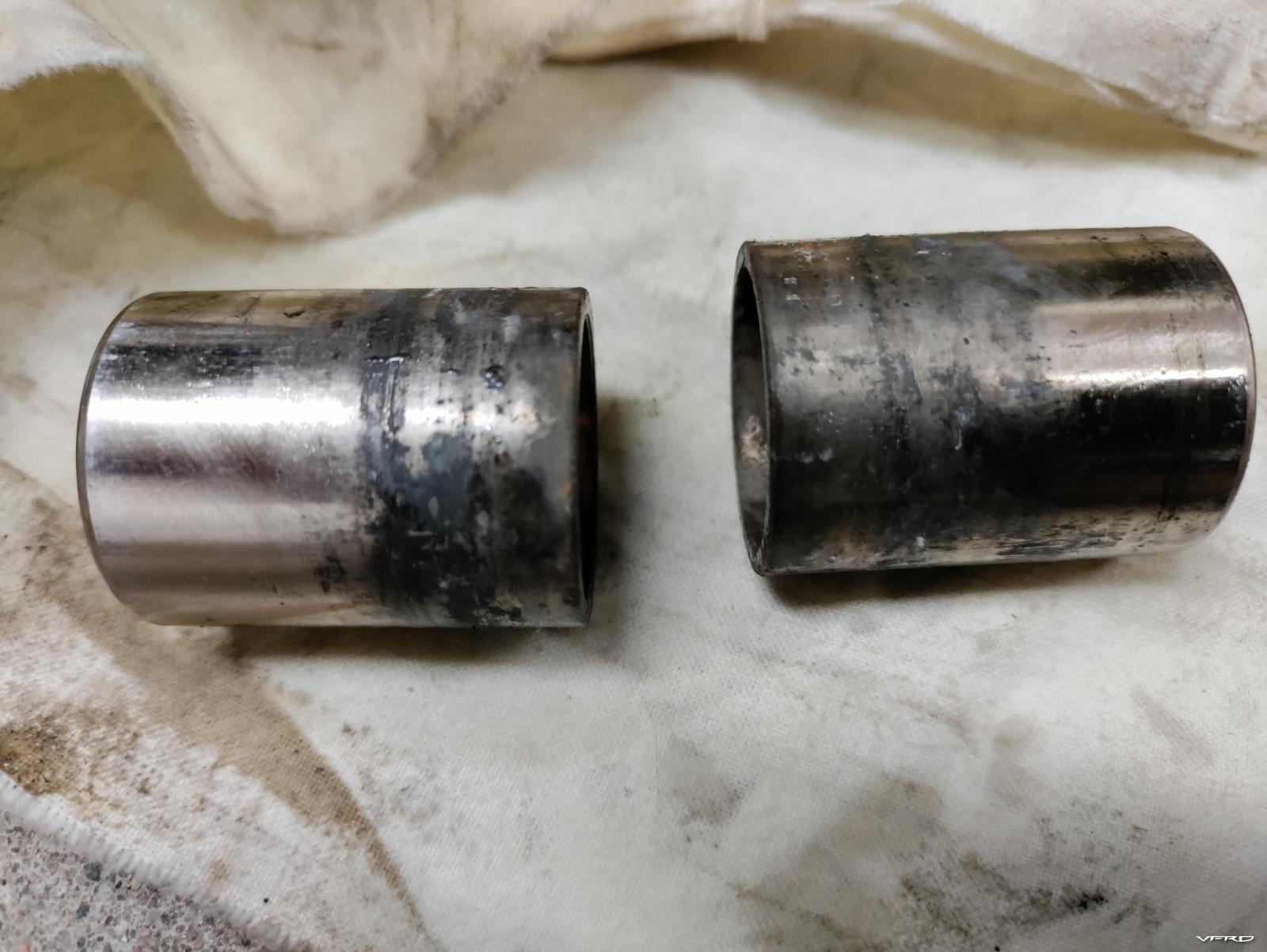

Rear brake caliper pistons out finally, need seriously cleaning, but will probably then be good to use again.

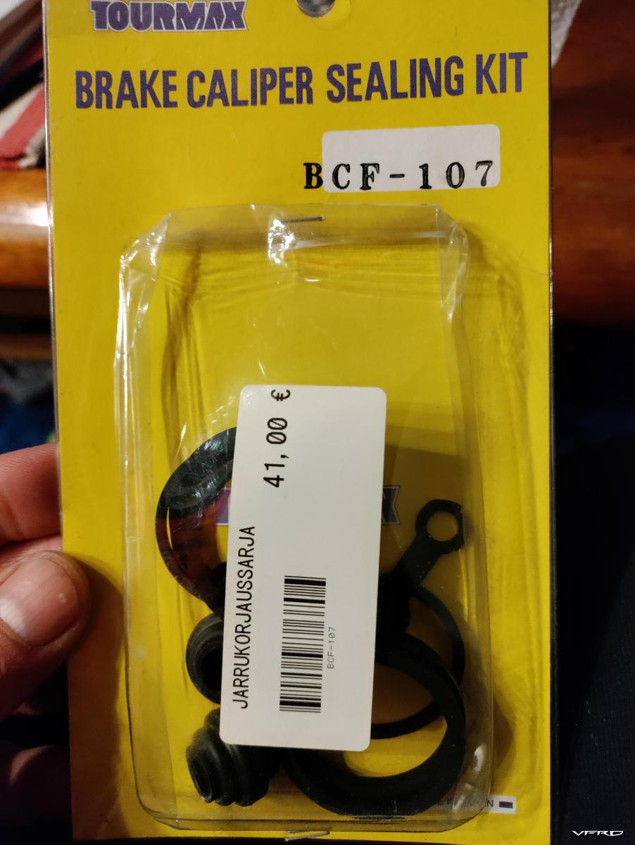

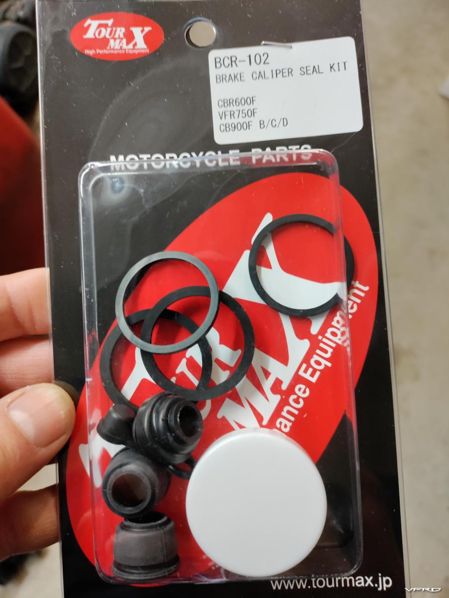

Also got this in the mail today
A rebuild kit for front brake calipers! A rebuild kit for the rear is on the way.
I just couldn't resist this as even the label says 41€ (69€ in a local motorcycle stores webshop) I got this for 20€ (+2,5€ postage) that I think is a steal, I recall how much better the front brakes became on my 87 back in time after I did rebuild the front brake calipers whit new rebuild kit.
It's amazing how much better brakes become when you open them up, clean out the crud and corrosion behind the seals and put in nice new seals with cleaned up pistons. I'm not sure if it's braking power increases or brake feel but, either way, it's really worth the time to do!Β

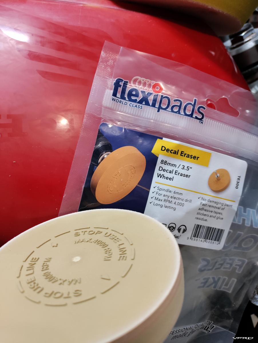

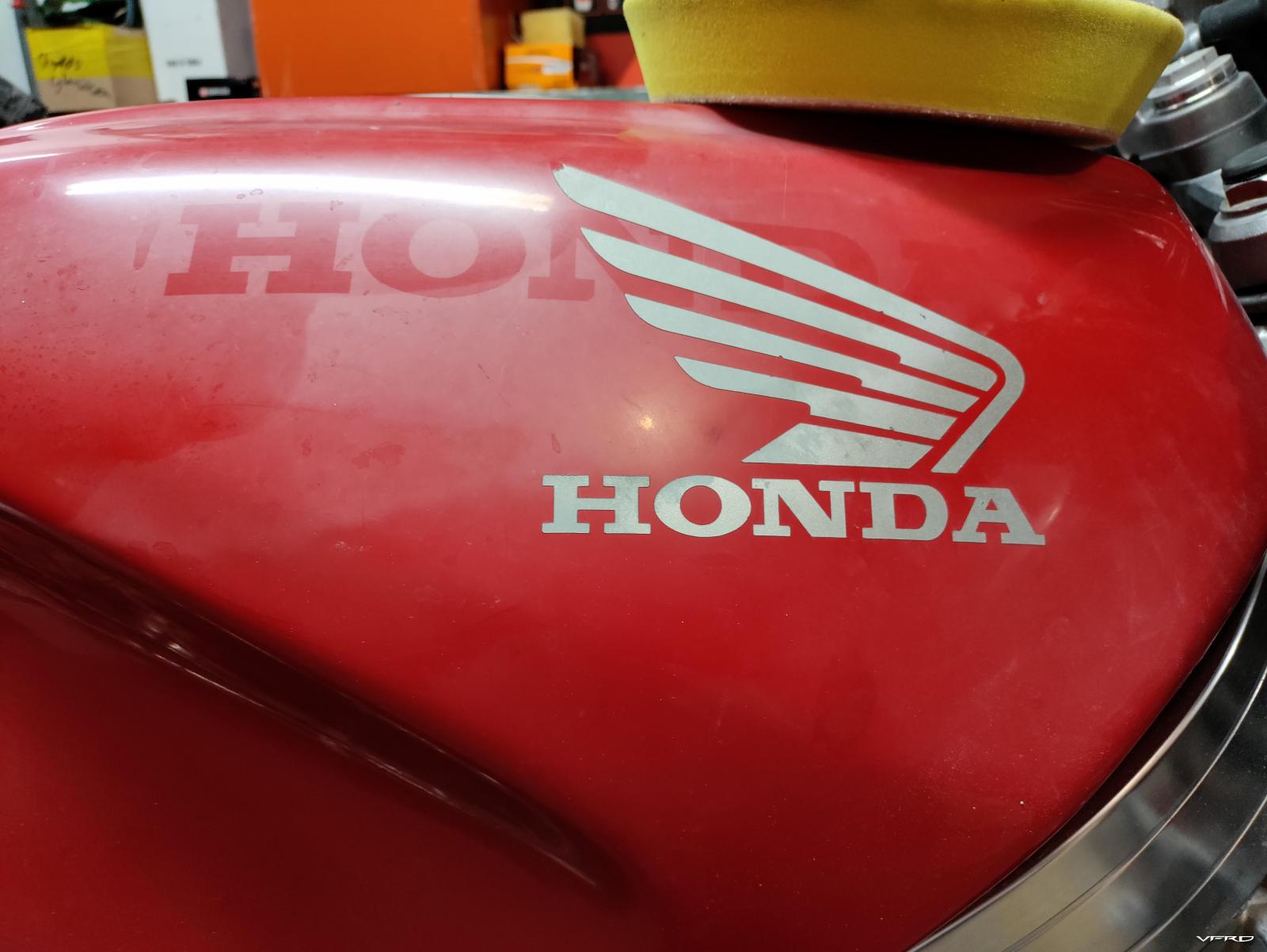

Saturday did buy a pad that erase stickers as I want the current silver stickers off, a very effective tool for that!
large.IMG_20240220_065738.jpg.2d3edf079ca6fa8c2faef069be236ad6.jpglarge.IMG_20240220_071500.jpg.c2fe9ce89eba2ca3ead9be5ee6bcff34.jpglarge.IMG_20240220_072658.jpg.cae561ff741cb35fbc39b76dc98e2fd7.jpg
Now the polish can begunΒ

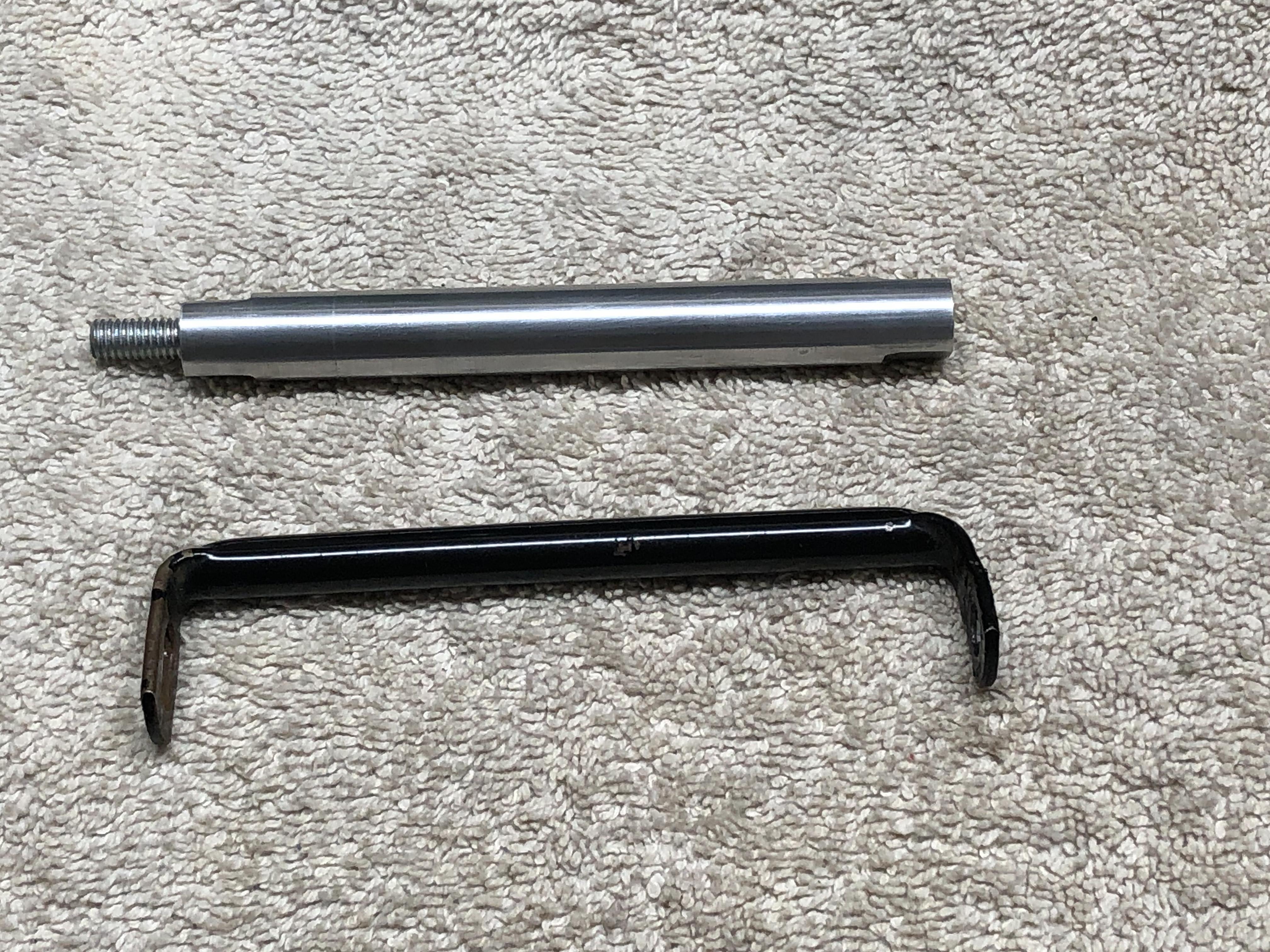

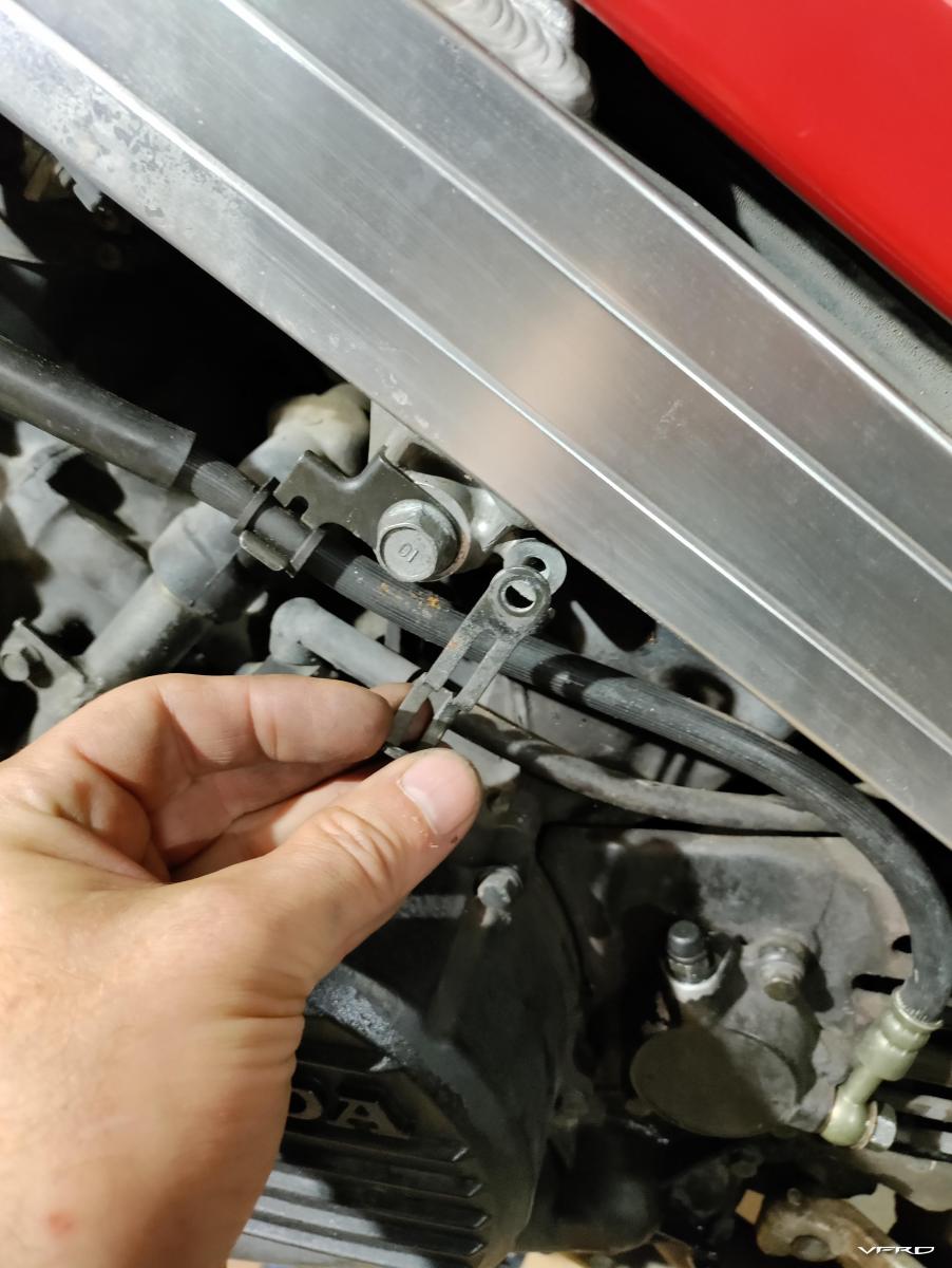

By the way what is the length of the faring mount where the 86 had the clutch line mount? I know the 86 has a cool special long bolt whit treads for fairing bolt in the end where 87 has a small bracket, I want to make a special bolt for this, now has just a straight pin whit treads in both ends....
Keny, I have a hard time keeping up with these forums but did you ever get this issue worked out? Between then and now I made a set of these and have a set to give if you want.

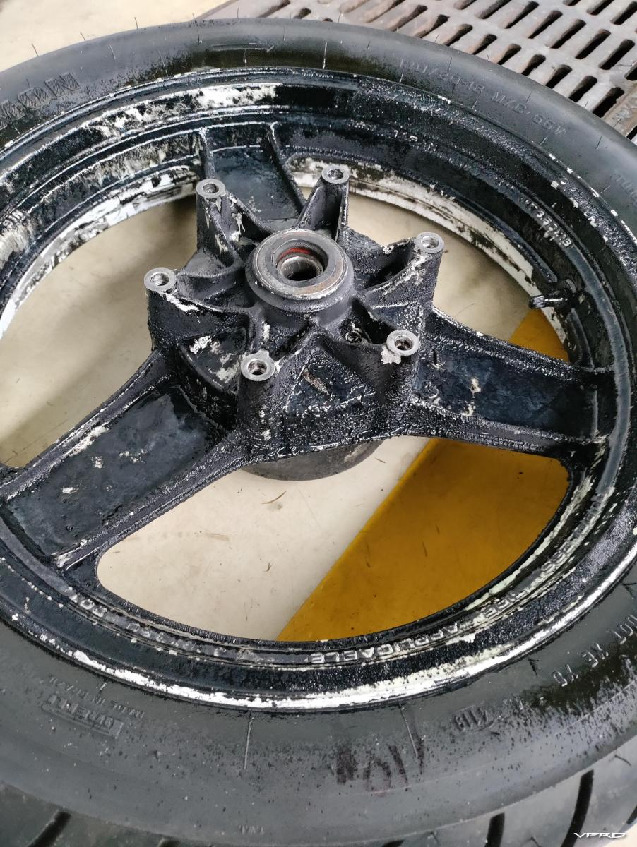

Trying to erase the black paint from stock rear wheel, by eraiser that you spray on as wash away
In picture fluid is doing the magic
After power washer done it's job, needs a second round and better clothing to not get wet....

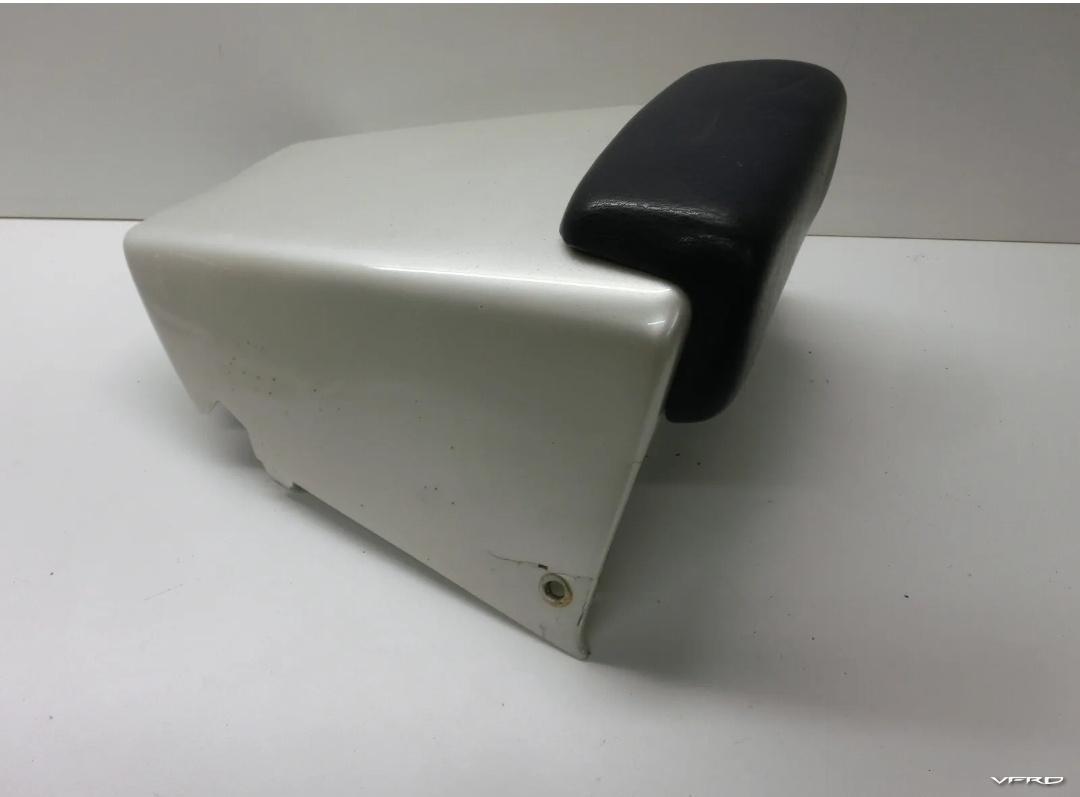

Happen I scored a reasonable price passenger seat cover cowl, not perfect but will do
Should get it in a few weeksΒ
So today got a few boxes again.
First the passenger seat cowl arrived, not perfect but ok, will be painted anyway.

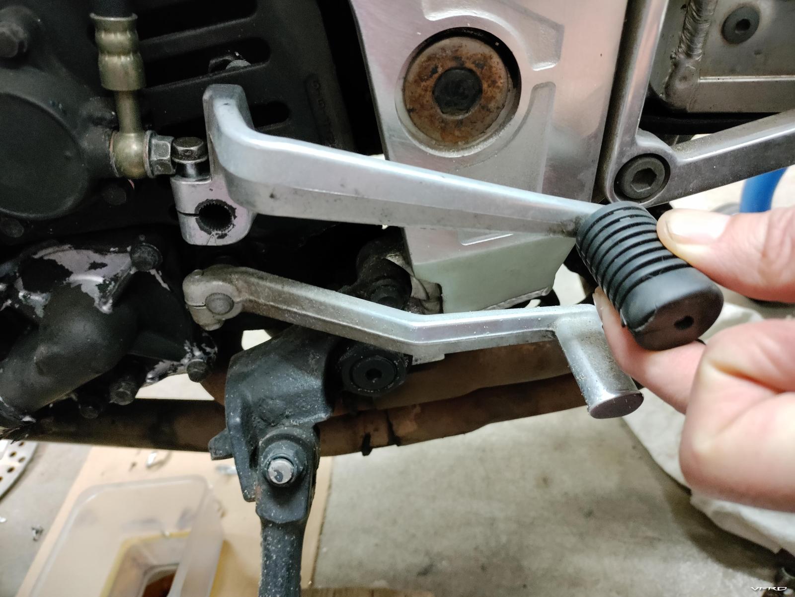

Then from a other place ordered a few bits that are from a 88-89 model, a gear shift level as min is missing the rubber, but even length is same design is sure different!

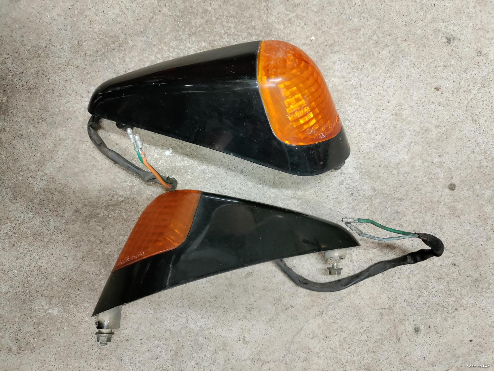

A pair of front turn signals that I hope to retrofit to the front fairing

Another sign of how different the different years of RC24 are.Β
Β
The 88/89 uses the same gearbox as the RC30 (although different ratios), with the exception of the shafts and gears themselves all the parts are RC30!Β
Β
...but the actual gear change shaft comes out in a different location hence the different lever!Β

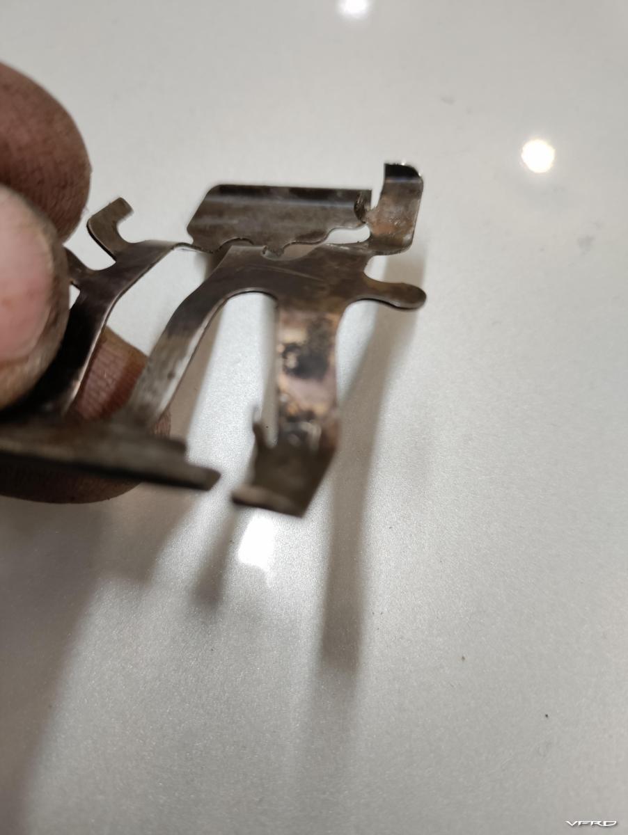

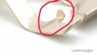

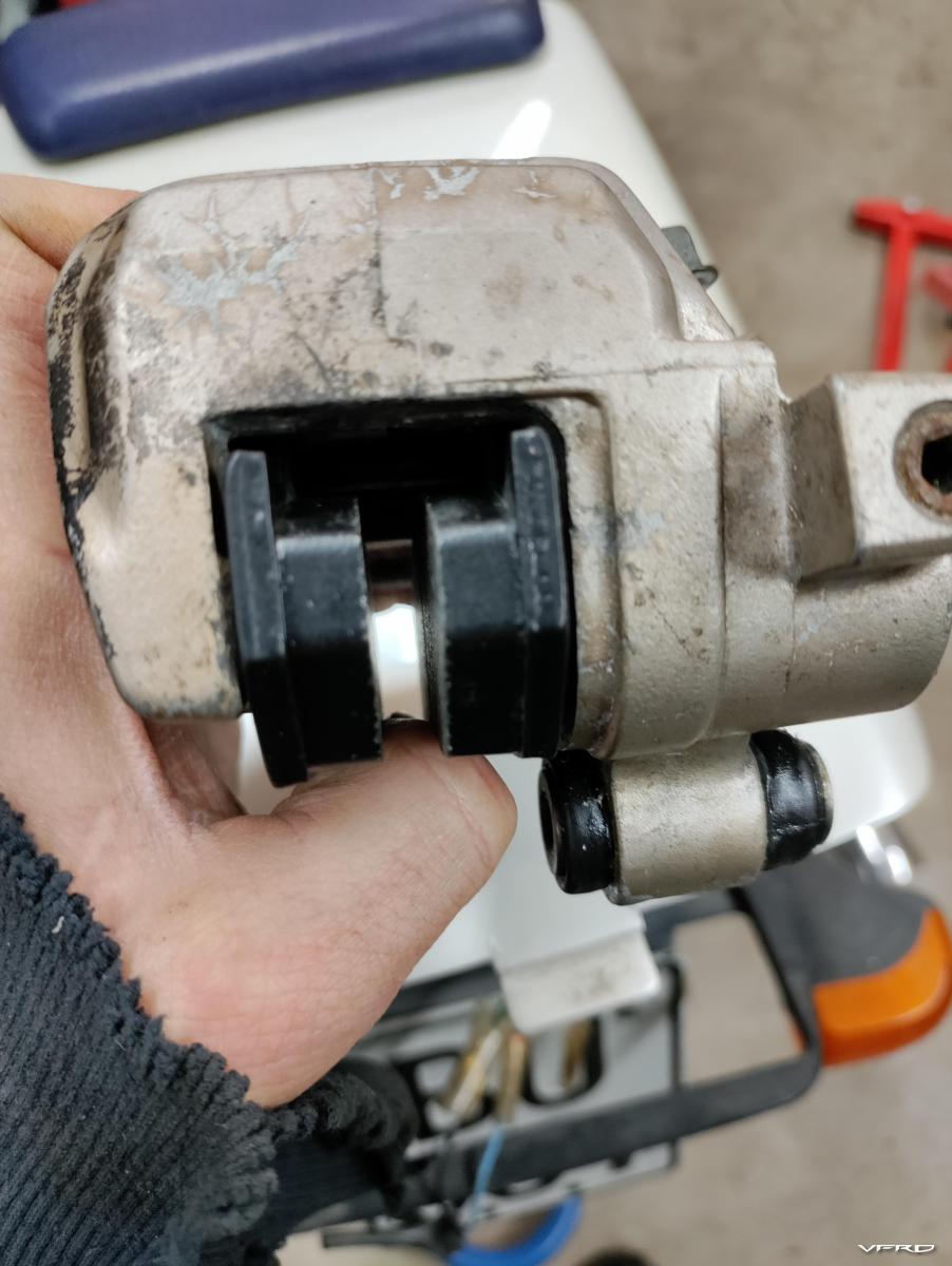

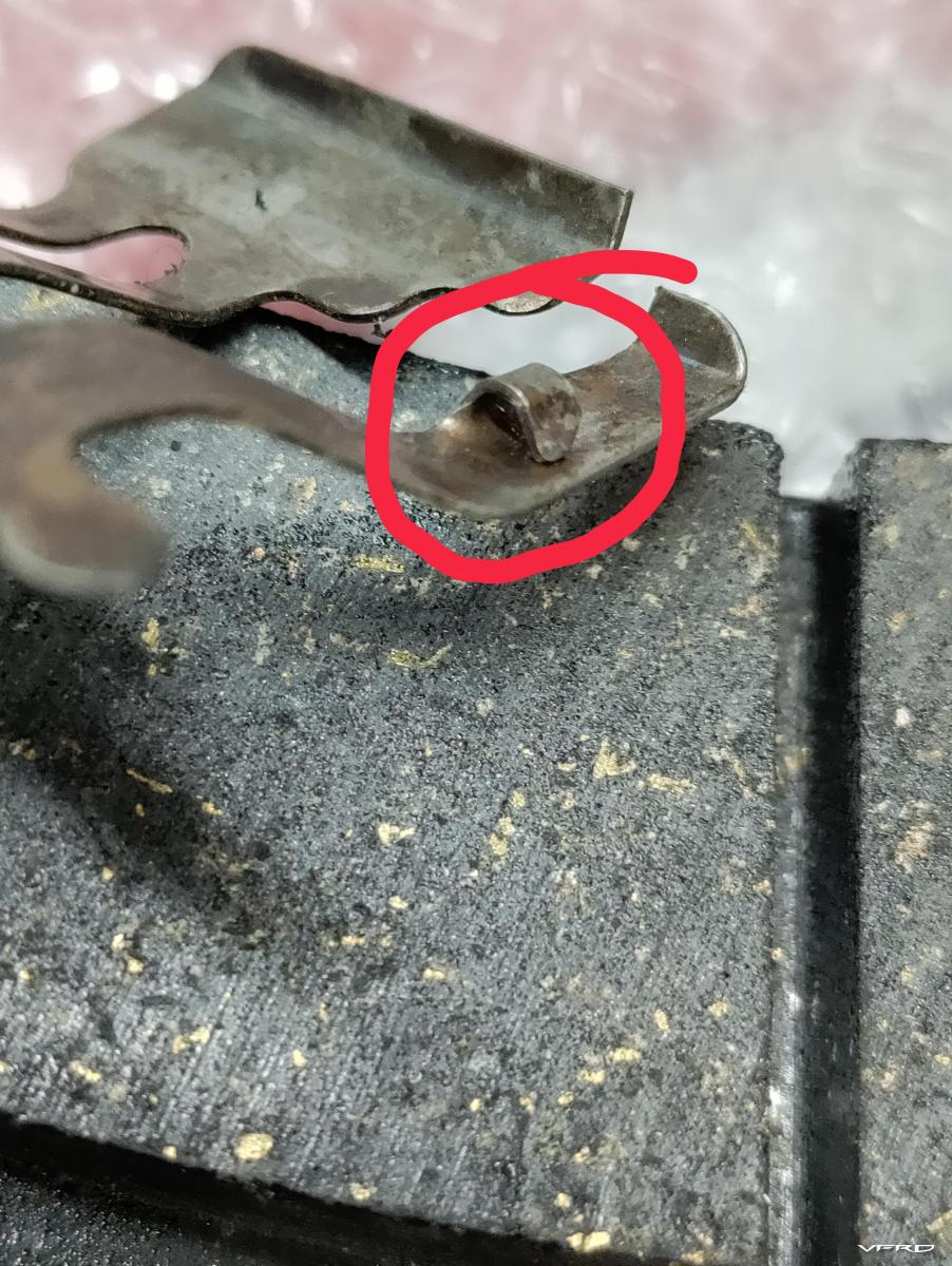

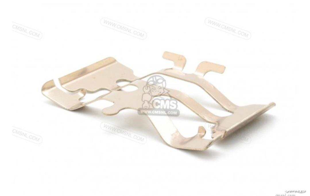

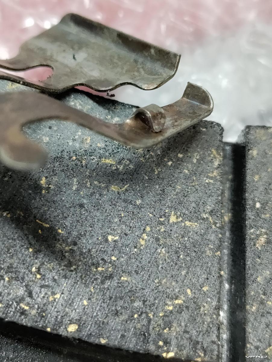

Found it issue why other brake pad is angled bad. The plate in bottom of brake caliper has Ben modified badly
This is how it should look
Β
Better
Now brake pads are angeled good
Also got the stripped tread for the plate that hold the pins fixed
Now I just need to find the plate I should have, it order a new one.....
I have done that myself on my 800; tried to install the pads while the calliper was mounted to the disc and managed to catch the edge of the pad spring during installation. Made for a weird brake as the spring would push the pad off the disc so there was lots of travel until the brake was pumped up fully. I would just straighten the pad spring out.

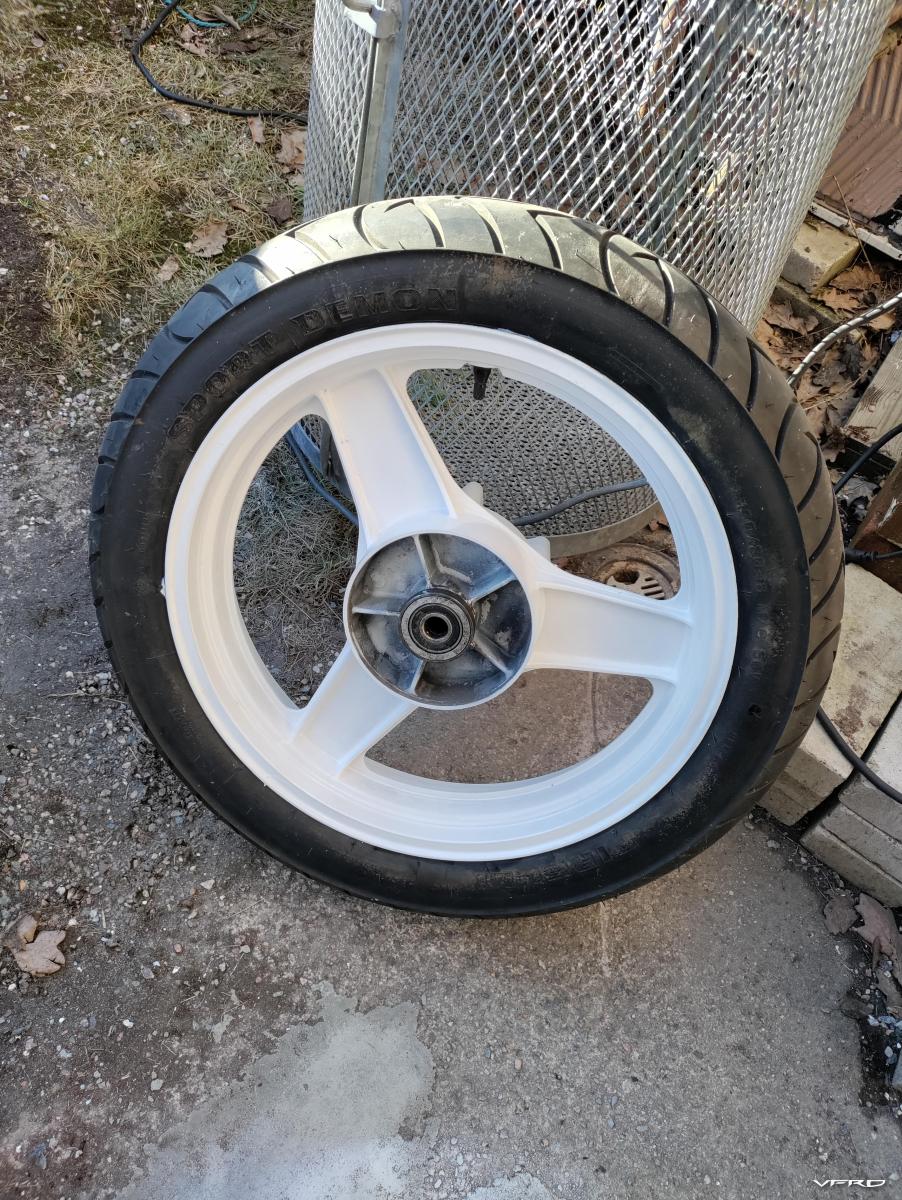

Well finally remembered to buy some white wheel paint (in spray can), so orginal the rear wheel is white again, not that pretty but will do for one season

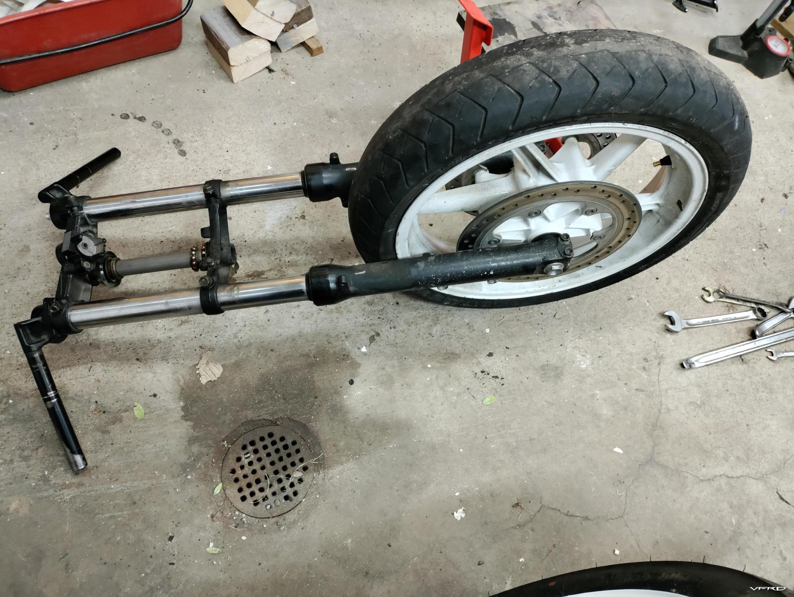

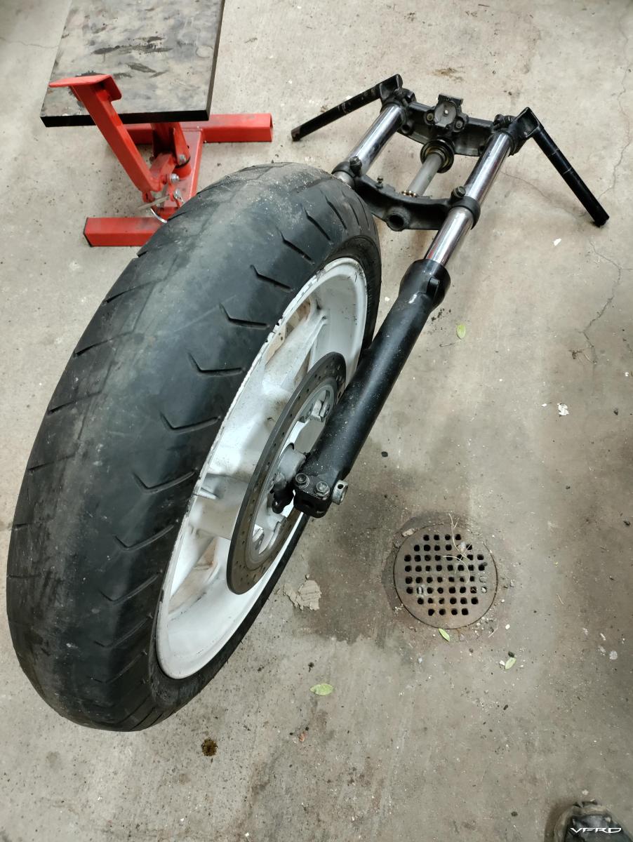

Then could not resist this CBR600F front as got it for price of wheel
large.IMG_20240331_074525.jpg.008d35ca48fa9483c3dde19f2e460757.jpglarge.IMG_20240331_074152.jpg.aef025b982da929203beb5666e7f1009.jpg
Came whit brake disc's but no calliper's, tire is rubbish (well used 020 Bridgestone dot 09) and spring adjuster is broken in other leg's cap, but otherwise solid.

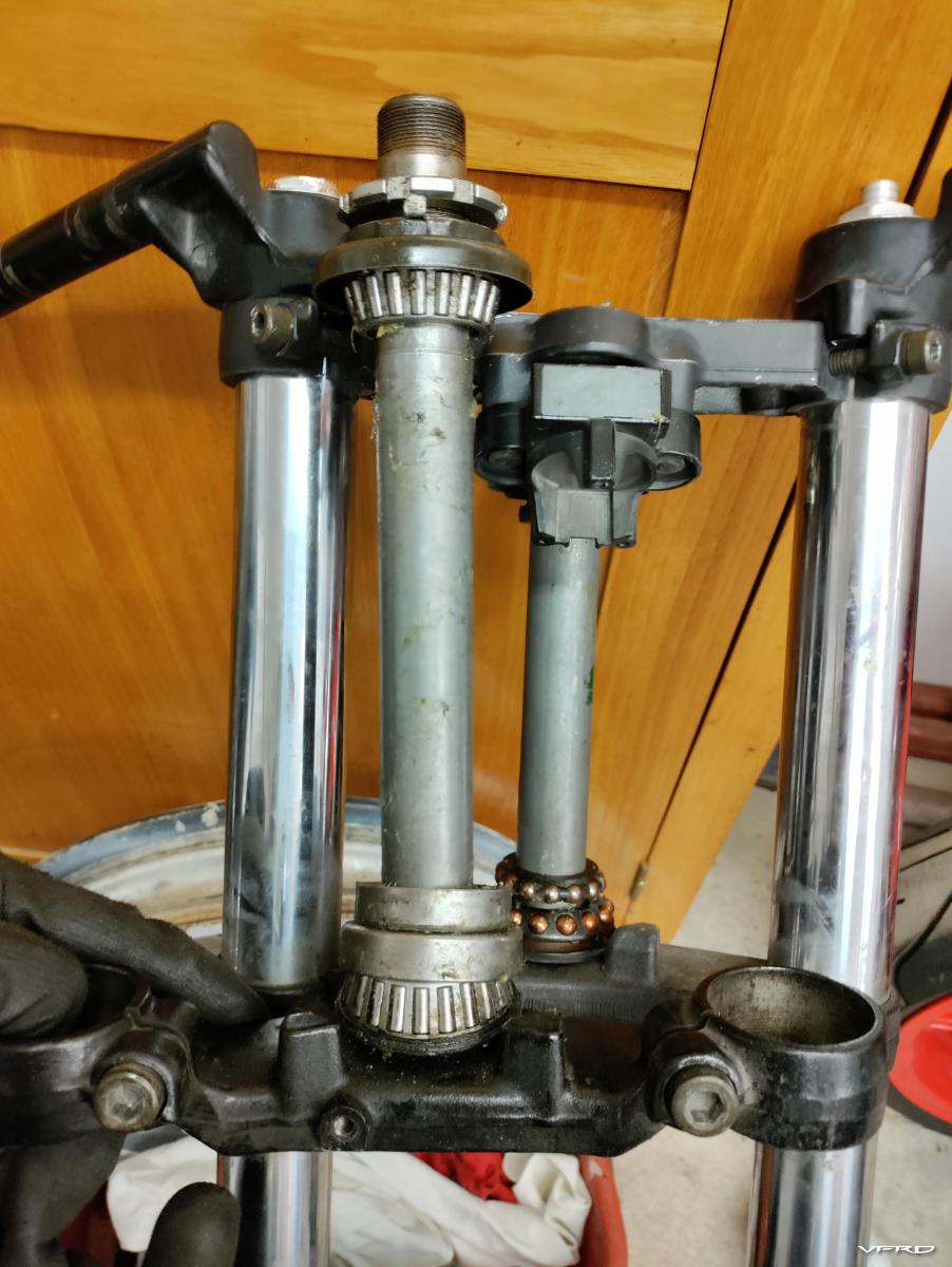

Interesting is that the triples offset is same as on 1990 CBR 1000F, easy to find out as I have the parts
Here 1000 on top of the 600s.
So as the 1000 is a bus compared to the 600 the sharper angel as lower profile tire make the 600 dance sharper.
A other difference is the 1000 lower triples has the longer steering axle that the RC24 use if I'm correct.Β
So even I'm in for keeping the 16" wheel for now, might do a fork upgrade in a future...

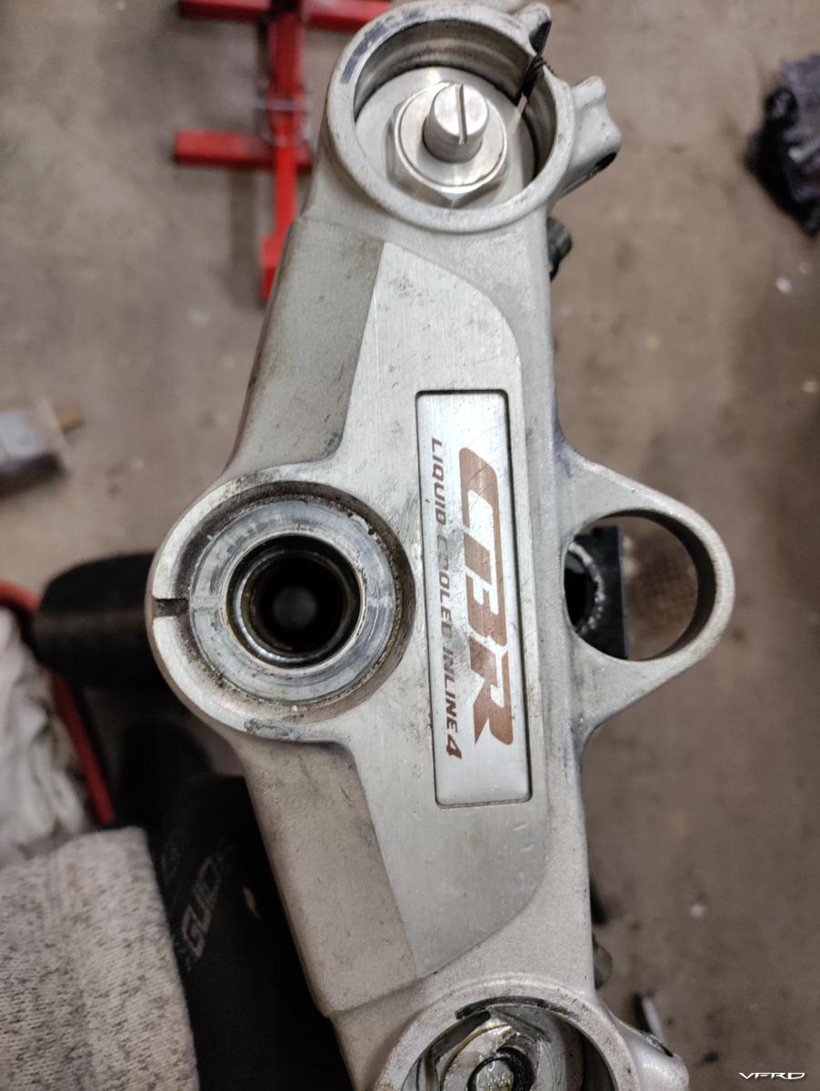

Hmmm
Looks to me the cbr600F2 as 1990 cbr1000f has same offset, as in picture below the 1000 upper triple on the 600, both on the fork tubes
Oops you're right.Β  Got mixed up.Β  Just confirmed here too.Β  90 - 97 VFR then.

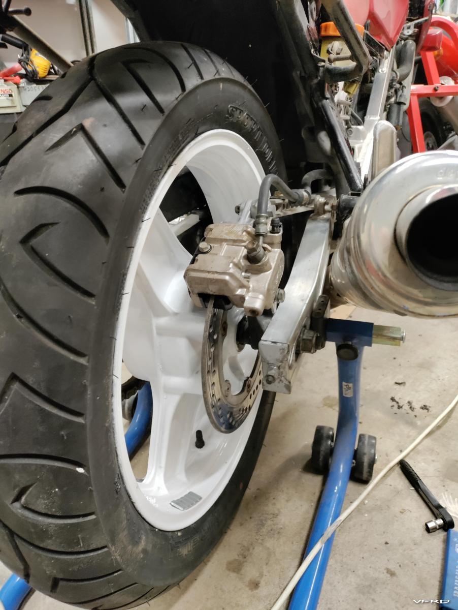

Other things, rear wheel as brake is back on bike

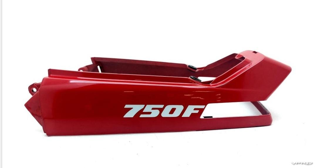

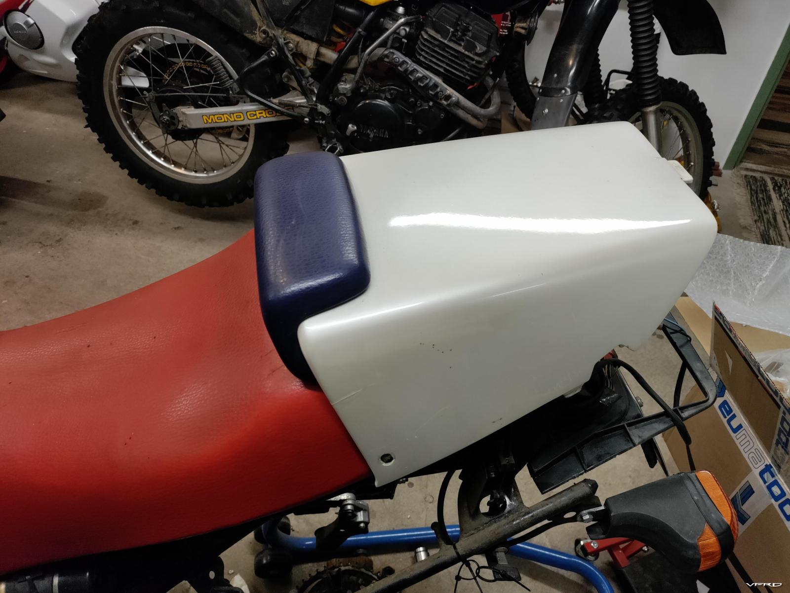

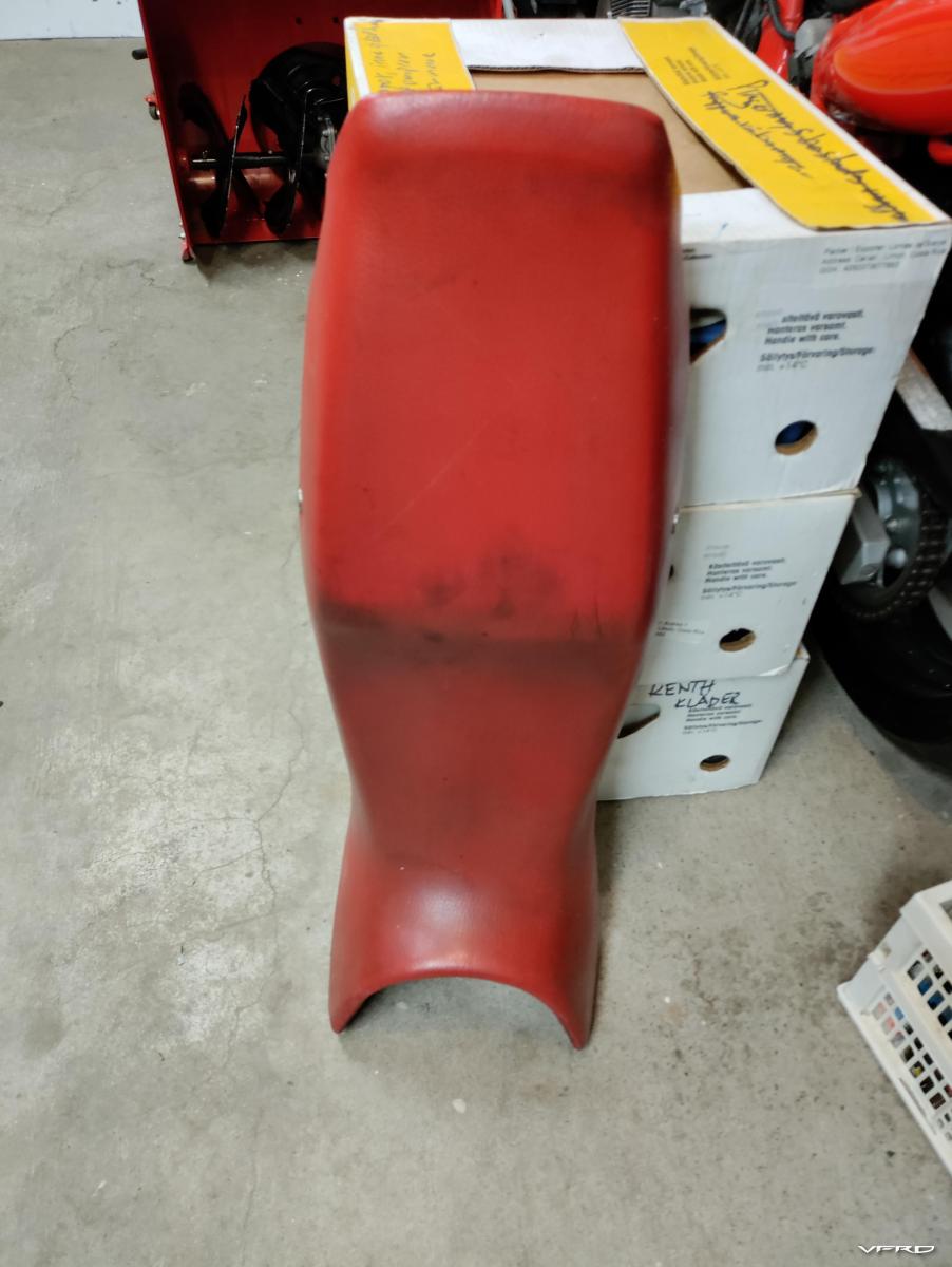

Well as you dream something uninspected happen. Found this mint tail section for reasonable money!
So orginal tail will stay 😁
