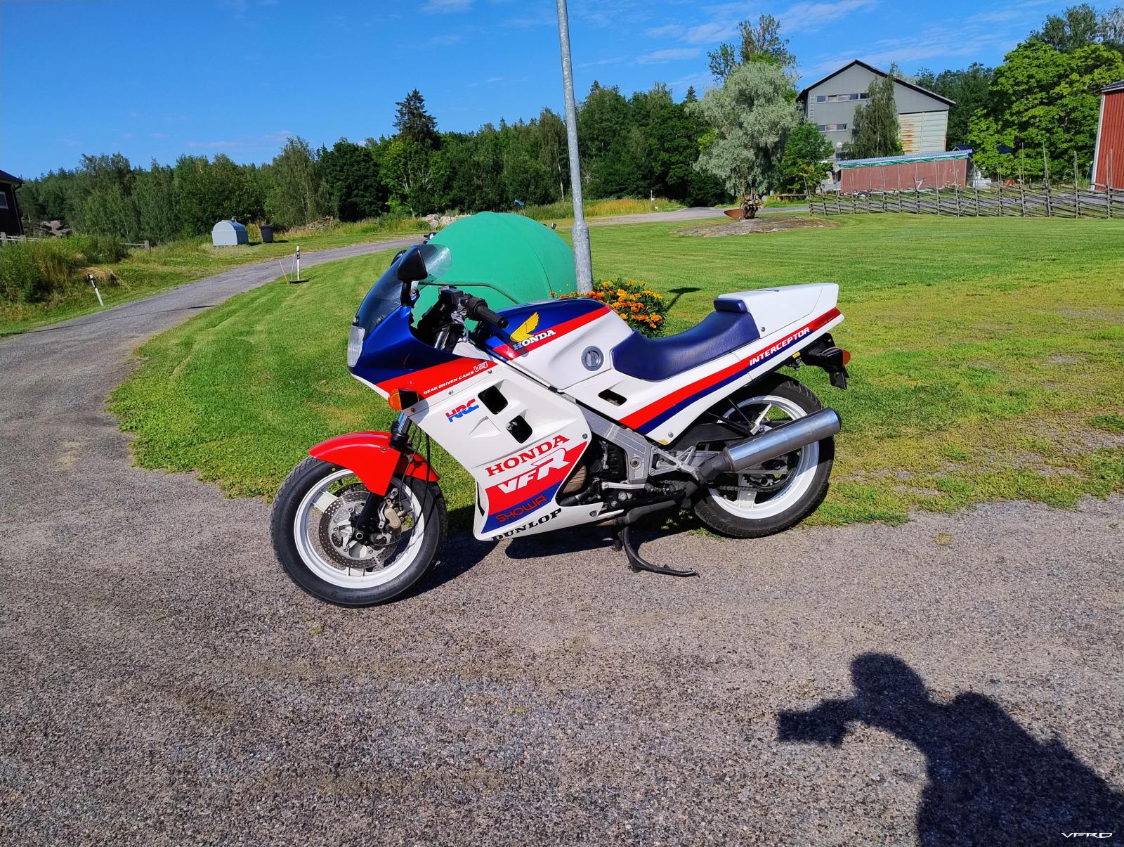

The 1986 should have a white Honda sticker on the lower part of the screen
Like in the brochure picture above
I had some Honda sticker's left on the sheet I bought for the red RC24, one is close in size
Close enough I think
Ta-da, one step closer

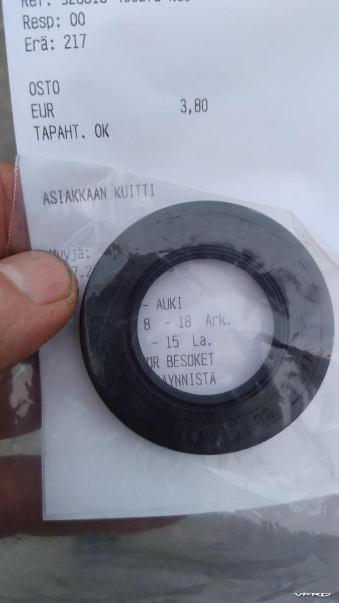

And it's amazing how big a difference in price if you get a OEM wheel seal or a identical from a Automobile parts store
large.1000049143.jpg.7f1d232fc153d904b15c009668853b9a.jpglarge.1000049131.png.bc3cfb680e434d061be69bea64324c3a.png
It's actually the brake disc side seal even picture show the sprocket side, but yes €3,80 vs €16,94! That's a huge difference!

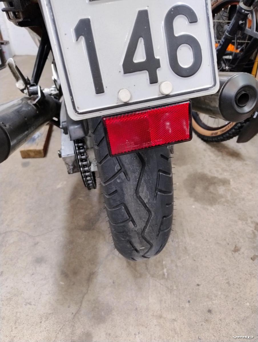

Then as no tire on the painted wheel I had to patch up the wheel that is on the RWB RC24
As mounted a rear reflector as polish the tank as plastic

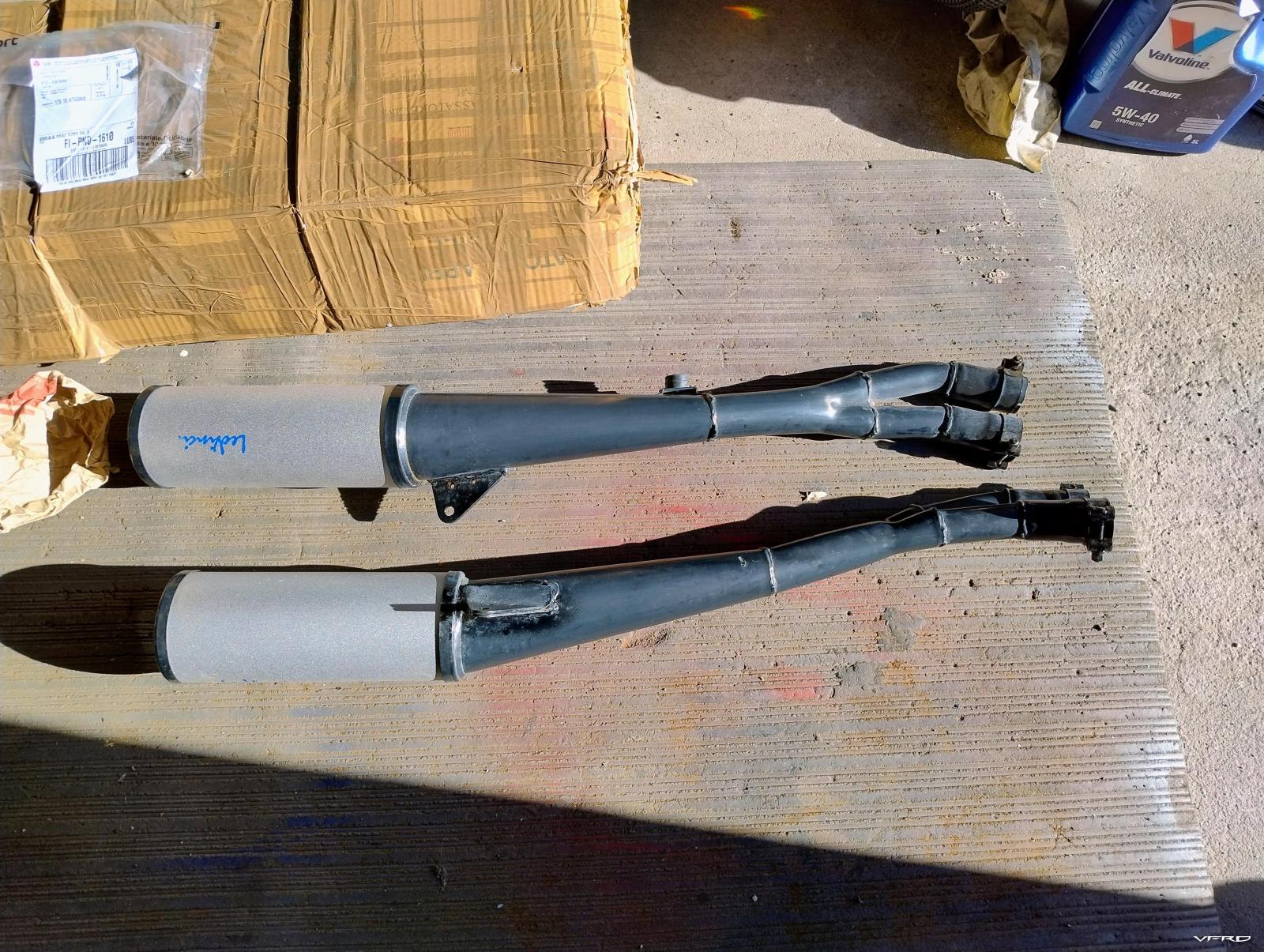

A exhaust has arrived for the red RC24

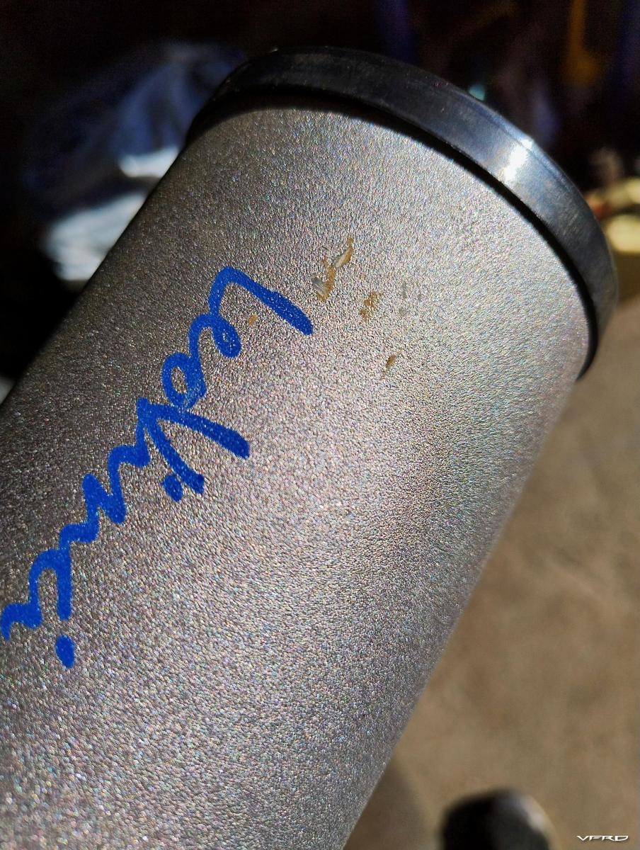

large.1000050258.jpg.dda1af3fc83ae94e79f59f590c1c2887.jpglarge.1000050261.jpg.0124f204b42175a564b3a70fddcebd6d.jpglarge.1000050263.jpg.4f26d8e577a120b4f91de5558e63b660.jpg
Old stock whit some storage damage

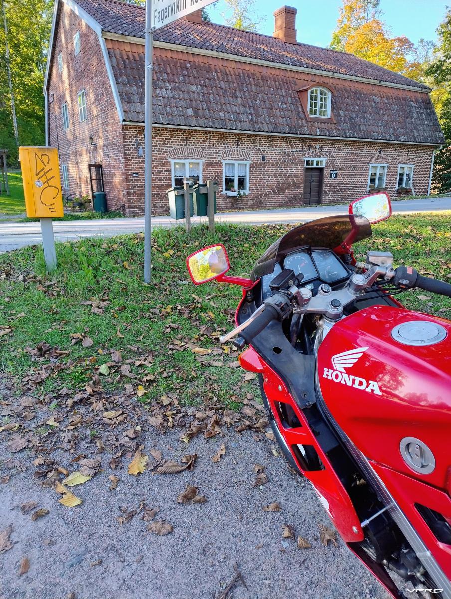

So ready for a ride.
large.IMG_20250928_154911355_AE.jpg.43f49b4dd55a74b28ca7edfab9093f5f.jpglarge.IMG_20250928_154918055_AE.jpg.e235bdb71dd4a6d9e17d1e640dc50f1b.jpg
 And what a joy to ride!
Actually if you have seen my other post's for my other motorcycle's I did a ride yesterday to local nice Cafe and the Ducati club had a fall ride stop there, and they sounded lovely that made me look at Ducati's yesterday evening 😅
Well fortune the ride today proved no Ducati needed! The RC24 whit the new silencers sounds so nice! The ride was a blast!
