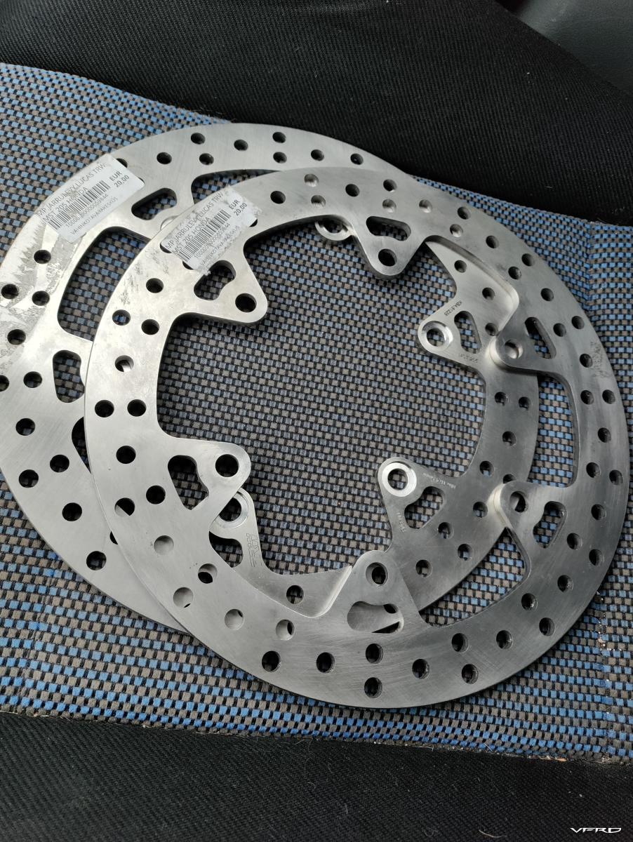

Could not resist these for 20€ a disc
New that fits RC24 as my CBR600F2 also.

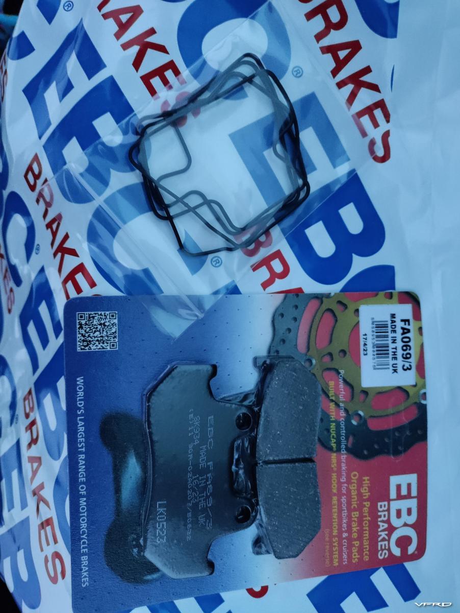

I got the carb float chamber o-rings as rear brake pads, aside that need to sort the oil leak from drain plug, leaking even new cupper washer... Then it needs a fresh front tire, and then I start to think if I would need to get a NC24 front rim same time so I don't need to change it later to other rim.

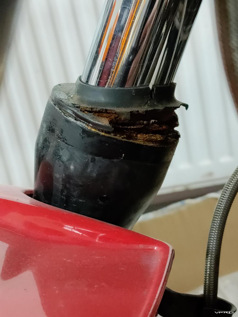

1. Fork seal dust cover
The picture say it all, was wrapped whit electric tape as bike came to me.
Can't believe it was not changed as fork's are refurbished a few years back according to former owner!

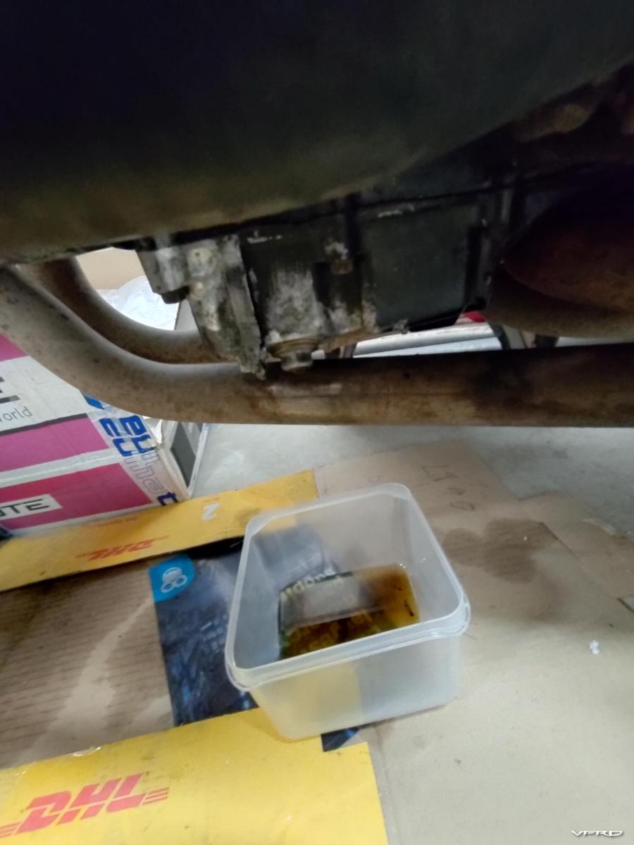

2. Leaking oil plug
This is how much it has been leaking since I changed oil after I bought the bike, not huge but still needs sorting

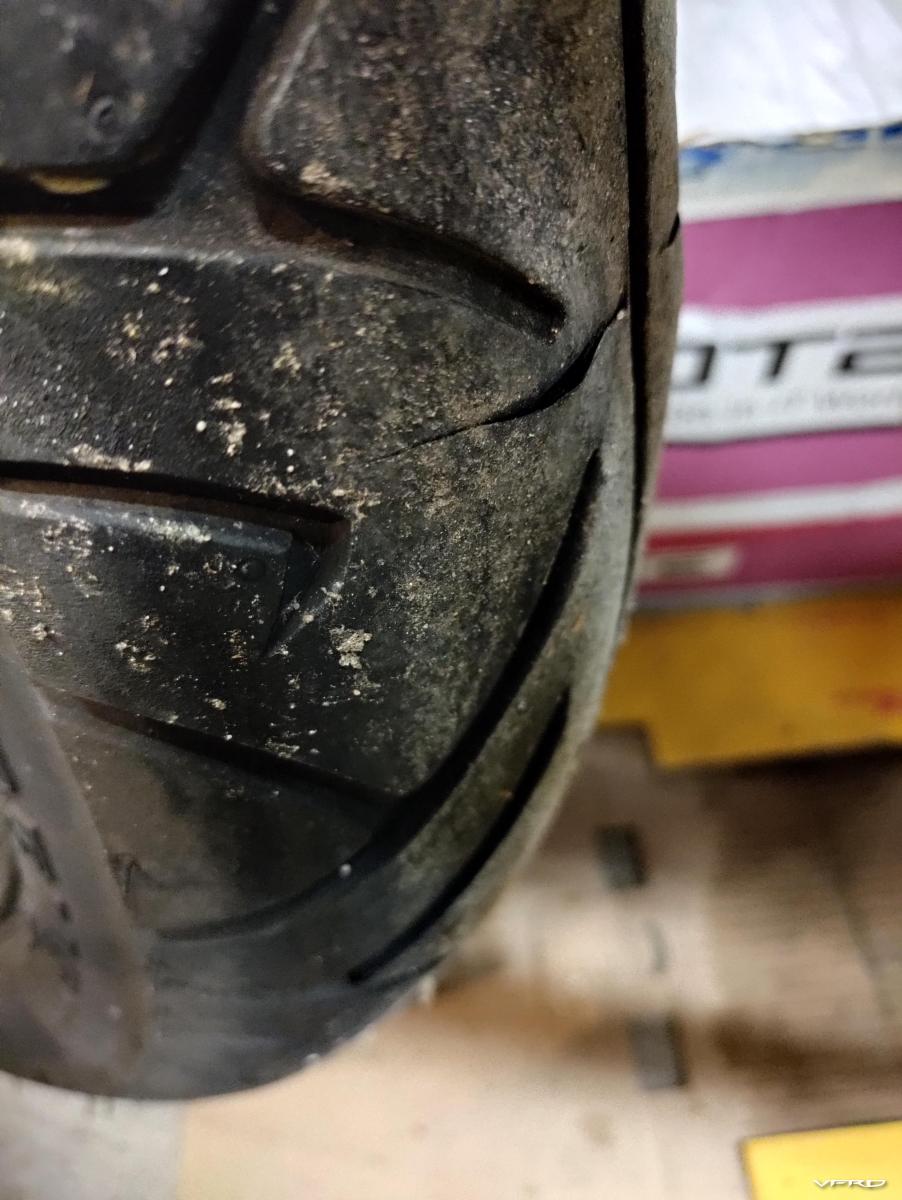

3. Front tire
The tire is not ballad, still soft rubber even DOT15, but has a deep cut over tread that is not a good thing. Fresh one needed.

Is that lower fork tube broken?  Regardless, the forks don't look like they ever been touched.
Do you think the oil pans' fatal and if so, how deep do you have to go to get that out of there?

"Refurbished a few years back" = "splitting dust seal from corrosion wrapped in electrical tape last century"
Clean the oil pan and apply some baby powder if you're not sure where it's leaking from.

😅 Yes, not a pro fork rebuild
The oil pan is leaking from oil plug

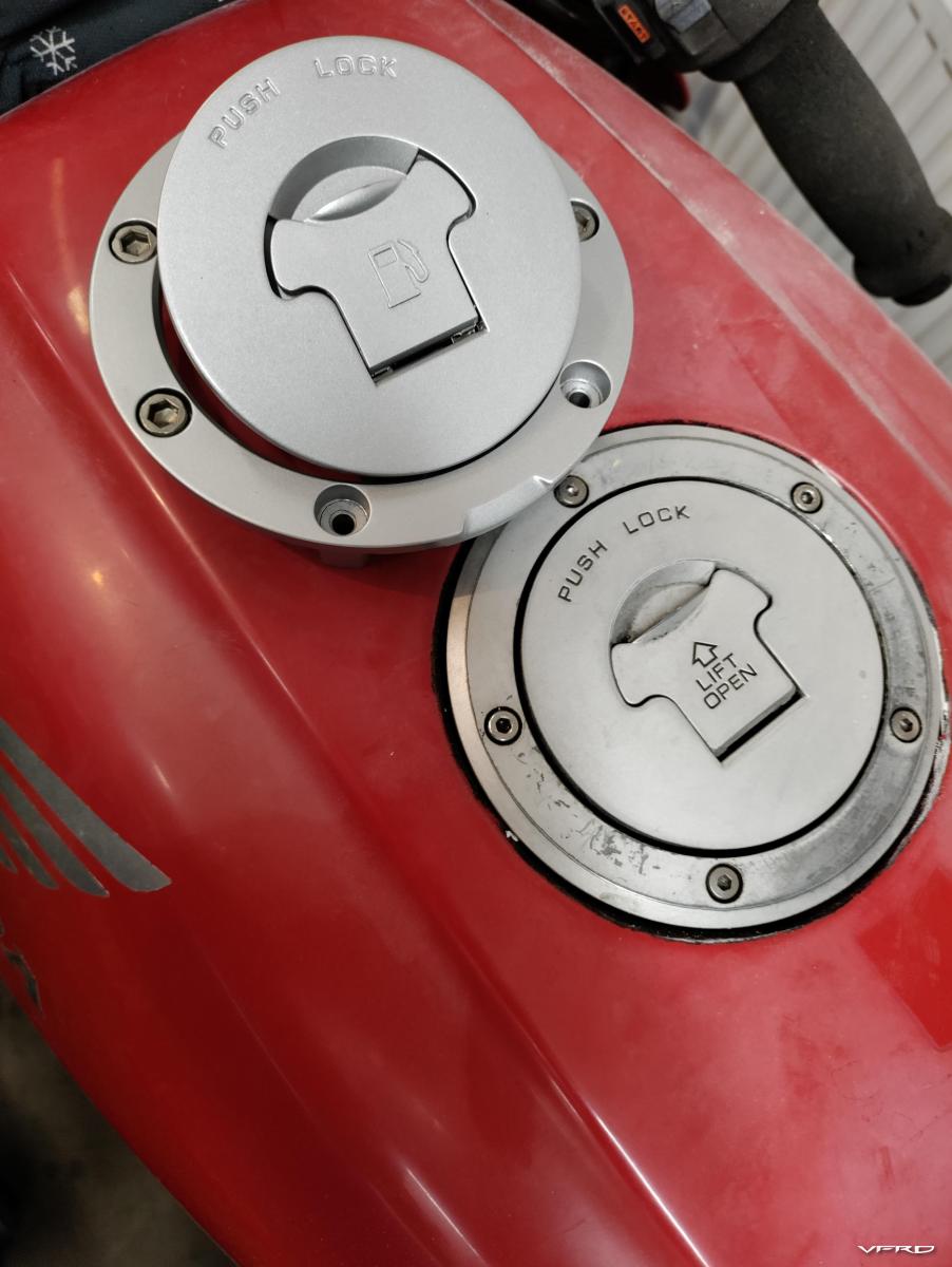

Some stuff came in mail today

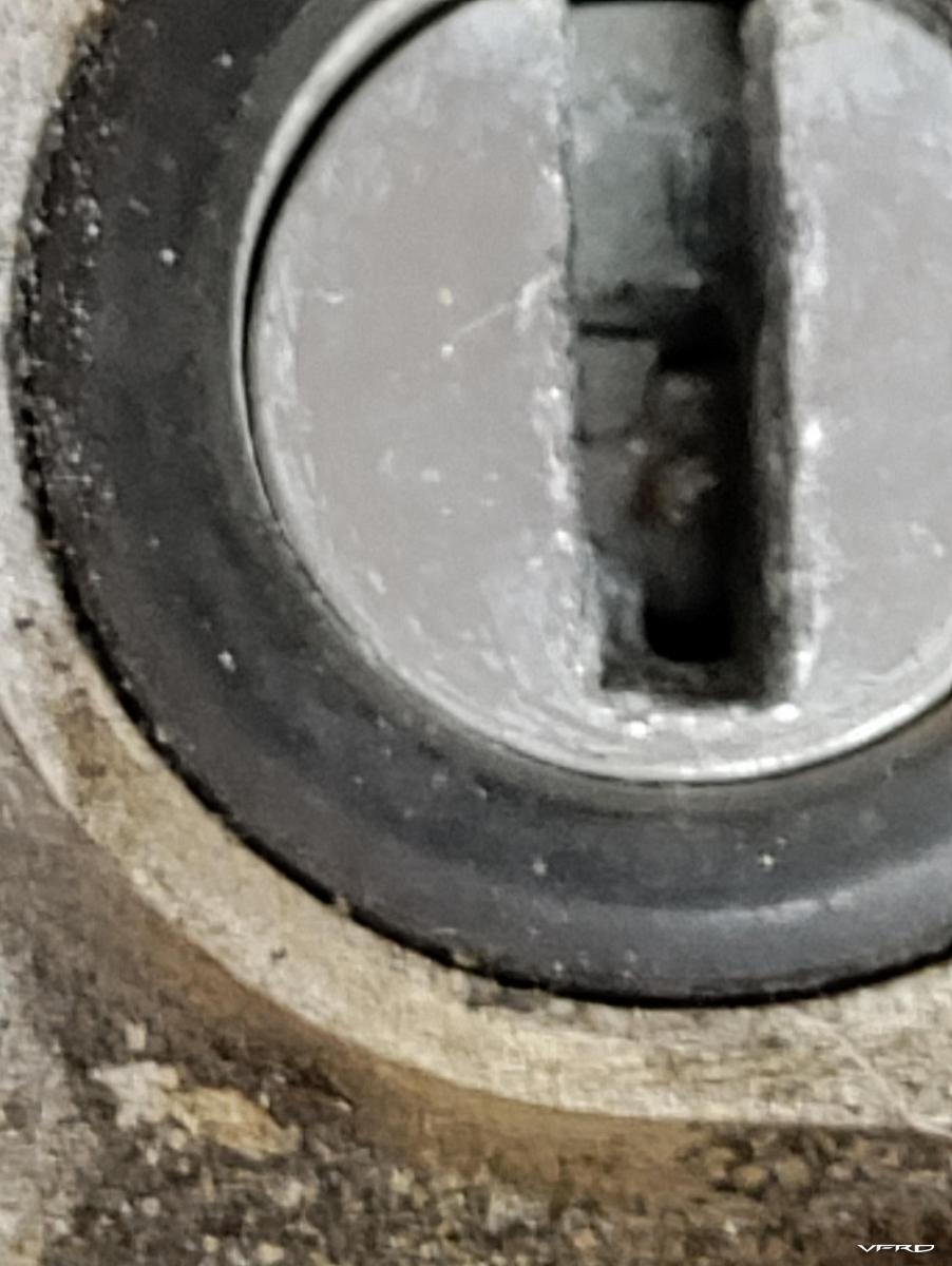

The reason I change the fuel cap is the old one is hard to open as the key is broken inside the lock
The design is slightly different but fits, need to find a few matching bolts through as different looks
So slow progress but still some
Not sure if you've done any pre-fitting, but while the bolt patterns look the same, they are actually off a little.  The RC24 is unique and slightly different than every other Honda from 1987 on.
There might be enough room to slightly elongate the holes to mount.
EDIT:  Sorry.  Re-read your post and I missed "but fits".  Carry on.
I’d still check the bolts fit, the one I bought for my 89 didn’t
I do have to check then! I actually just did put the new on top on the old and did look alike.... 🤞
