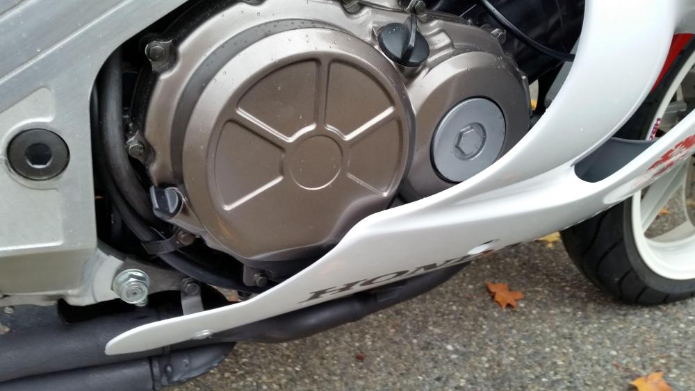

I had to take the clutch cover off of my Hawk GT after installing a new gasket the season prior.  It tore in a couple places.  I didn't touch a thing, but gave both sides a gentle wipe with some contact cleaner on a rag, and put a nice, thin even smear of Hondabond 4 around the whole cover side (cuz that was the easiest on the bench), perhaps giving a little extra attention at the breaks.  Let it dry overnight before adding oil (and not tilting it vertical) and not one leak all Summer long.
Nice. Mine ripped in multiple places and left some on one side, some on the other!
Gasket was a good 15 years old though.

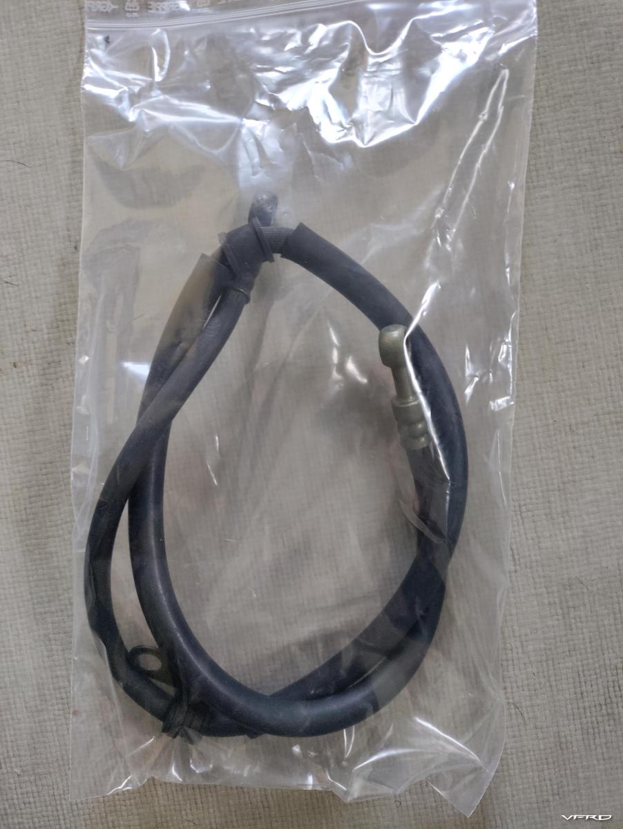

Score of a good clutch line for 10€
The one on bike not so convincing..

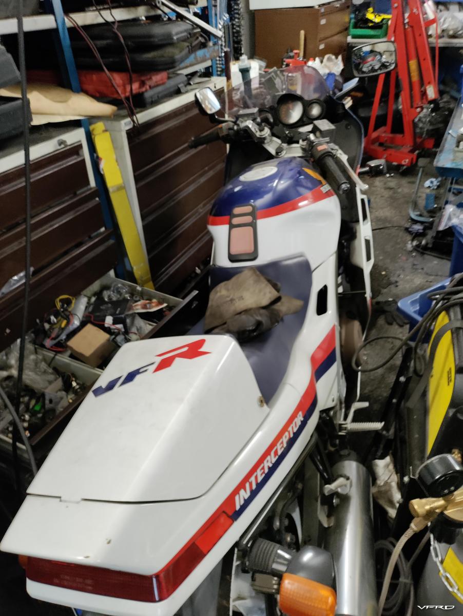

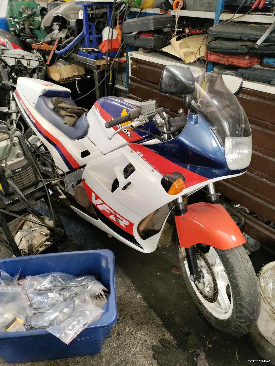

That breaker did have a lovely 1986 RC24 that thankfully is staying as a bike, owner will hold it in his collection
large.IMG_20230920_125633.jpg.642a98103724a7b20d9a6d952b5d7a14.jpglarge.IMG_20230920_125641.jpg.798276ed8a1b5f68a912dbfce2c39c8a.jpg

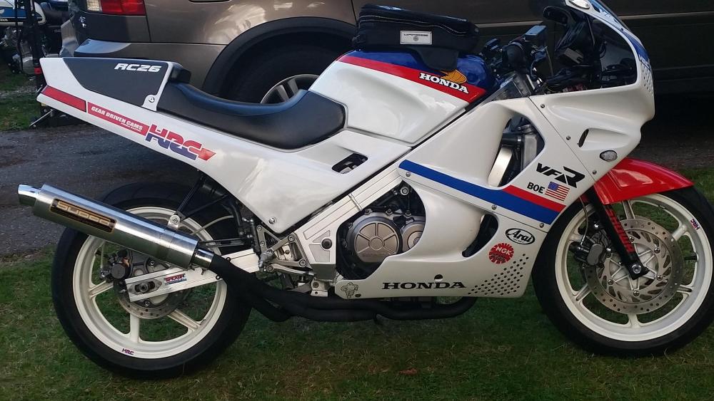

I was going to say that's a VFR700F RC26, the lack of "750" on the lower fairing is typically the giveaway...but actually both the "VFR" and the "V4 GEAR DRIVEN CAMS" on the fairing are wrong so it's almost certainly been repainted at some point and it could easily be either a 700/RC26 or a 750/RC24.  Almost impossible otherwise to know without getting up close and checking the VIN or plate.
Still my favourite colour scheme for them.
VFR700F RC26
22fsifp2hbq71.jpg?width=1024&auto=webp&s=86d4db78e667f3b84c0c114cabe485ea84fb3db0
VFR750F RC24
1986 Honda VFR 750 at Las Vegas Motorcycles 2023 as W145 - Mecum Auctions
To my untrained eyes...they look the same.
To my trained eye...they look the same.
Like he said, unless you can read the VIN or see the cc on the engine, the only visual cue on a stock bike is the  "750" graphic.
VFR700F RC26
VFR750F RC24
Can actually be it's a bike made to look like a US/Canada RWB bike, thro it has the right instrument as top triple as engine covers. Can be it's just repainted in som point because of a damage? Don't know it's vin so I can't tell

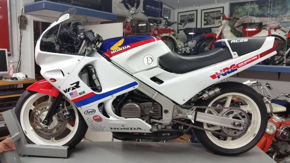

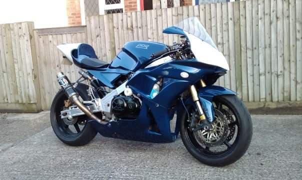

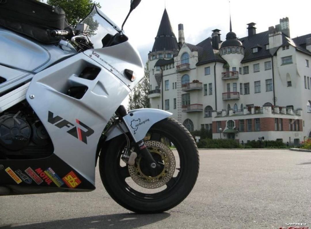

But also would like to turn it into something like one member here has done, on a 700RC26, hope ok I share a picture of it!
It's sure a sweet build!
Have to see what I go for, for starters think I just se it works ok and put some miles/kms on it as it is after I get the pulse generators as change the clutch line.
Then go thro it technically during winter.
That 'blade fairing works surprisingly well. Being picky to fit perfectly it wants the mid panels to be longer so the belly pan sits lower and the radiator vents to be more "lined up" with the actual rad but that would be an astonishingly large amount of work to pull off for what is intended as a track bike!
It could be but I believe the rounded clocks etc were only ever for the RWB scheme in the US/Canada market and they only got the "square" clocks for the VFR700F2 while everyone else just had the square clocks (and no RWB option).
It's not impossible that someone has rebuilt a non-US bike with US parts as RWB but IMO a far higher probability it's an "import" (which also makes it a higher probability it's a VFR700F RC26).
There's always decisions and compromises to be made in doing something like this.  Most importantly, the headlights need to be at the right height (low enough), and far enough forward, and still allow room for the front fender, gauges and clip ons..  Most custom attempts I see, the cowl is way too high and back and looks off.
After that making sure the sides match the the angle of the frame.  Everything else is what it is.  The rad openings are not terribly off to vent.  The lowers?  make adjustments and hope it looks decent.  Lines look good, cowl mounts are in reasonable places.
Pretty fucking hard to take Blade fairings made for a super short bike with clipons under the top clamp, and fit to an old, tall bike.
Absolutely.  It would have been a pig of a job cutting and joining multiple sets and for very little gain, particularly for a track bike where chance of damage and having to replace it is high!
The RC24 while a sports bike for its era is very different dimensionally to later sports bikes and most efforts to fit a different fairing (or seat) look really wrong.  Yours with the 'blade fairing works really quite well.

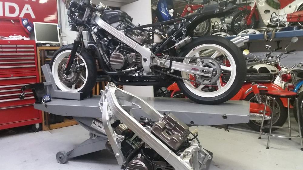

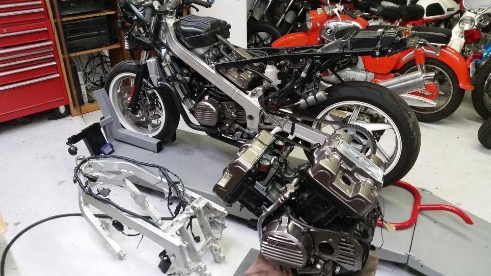

Thank you.  Started as a Track Bike.  Came out so good, I finished the build with the street equipment and then later swapped in a frame with a title.
Getting ready.
Titled bike on the lift with another engine.  It actually made the swap easier and now I have the original engine completely restored as a spare.

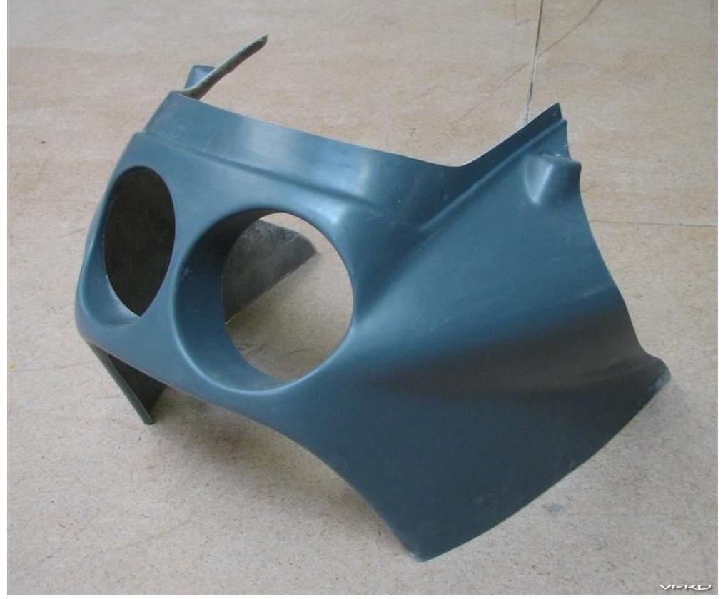

Actually a other faring whit twin headlights that could possibly fit, what I think, as the orginal bike is a bit higher is a 87-88 Yamaha FZR1000/750  faring
Also a option to get twin headlights is a top fairing that French Poly26 make but sadly the company has a reputation of not so good build quality and still quite high prices...

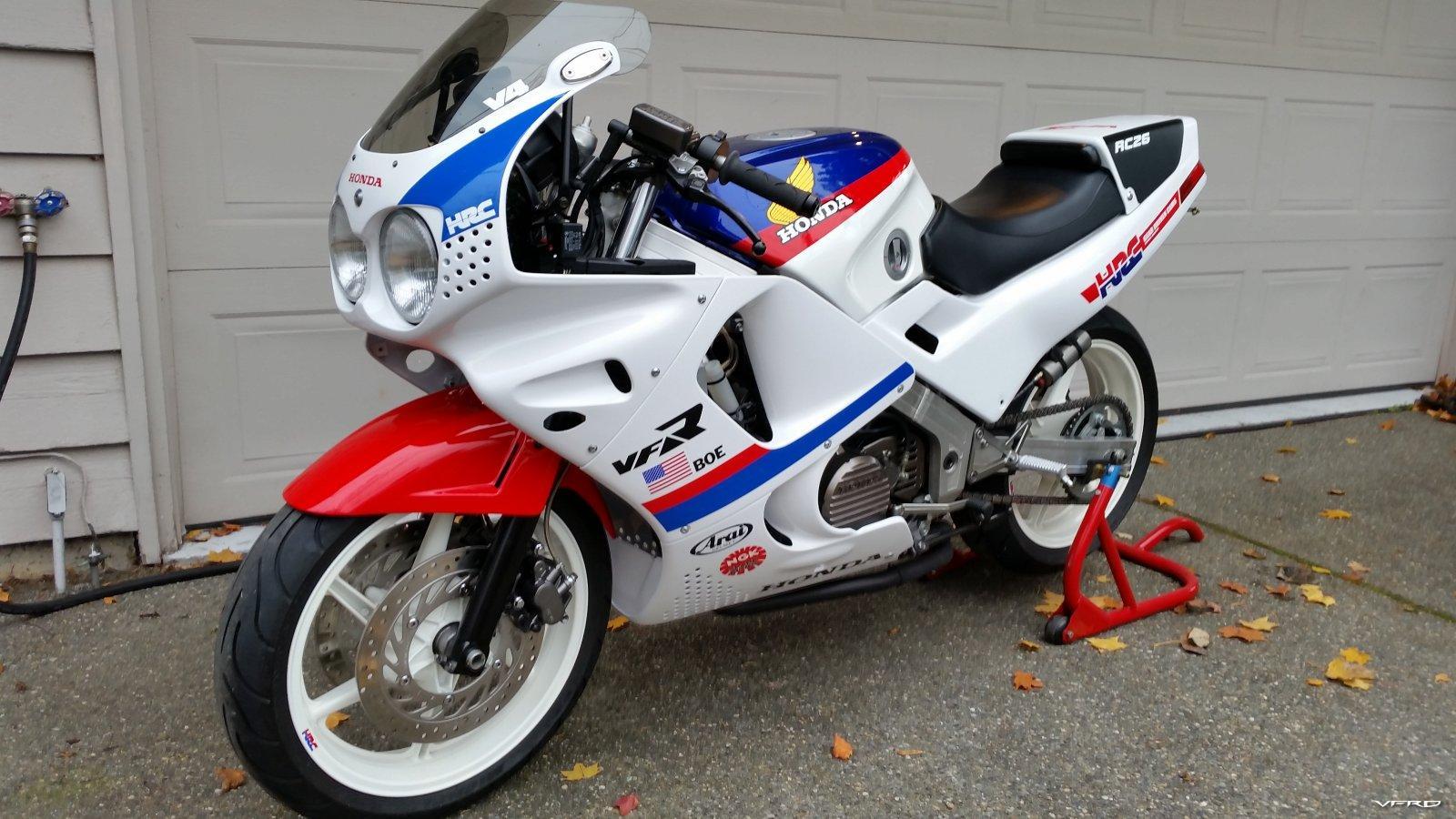

I just can't cross-pollinate like that.    The only reason I even went down the CBR900RR path is because I got the upper with OEM headlights and bracket and the L & R mids for free.
2 minutes ago, Fastdruid said:
CBR1000RR can kind of be made to fit too. Although probably not with stock bars.
Two round headlights were a requirement for an "RC" tribute.
I recall you had them around yes, not parts you get for free these days...
I know some can't think of parts from other make, I don't mind, that's probably why I have bikes from 3 different makes in my garage 🤷
The 900rr faring still look stunning through 👍
Whats the story with the radiator reservoir? Looks like it freed up a lot of space.
