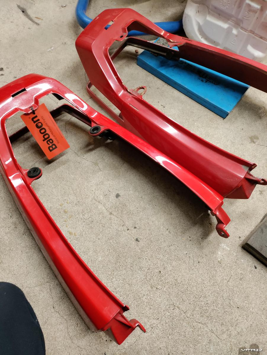

The tail section arrived today, indeed as nice as in the picture in the add
Here next to the old one
No cracks found on it, amazing!
There is a slight difference between it, it's from a 89 bike, and the 86 one, a cut for the passenger cover are not there, guess the 88-89 cover is missing this slot?
Well I guess I just take them of the passenger seat cover I have ....

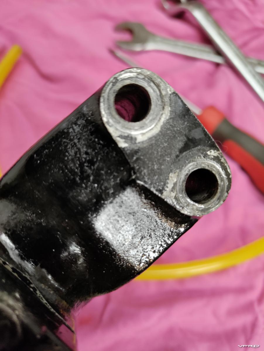

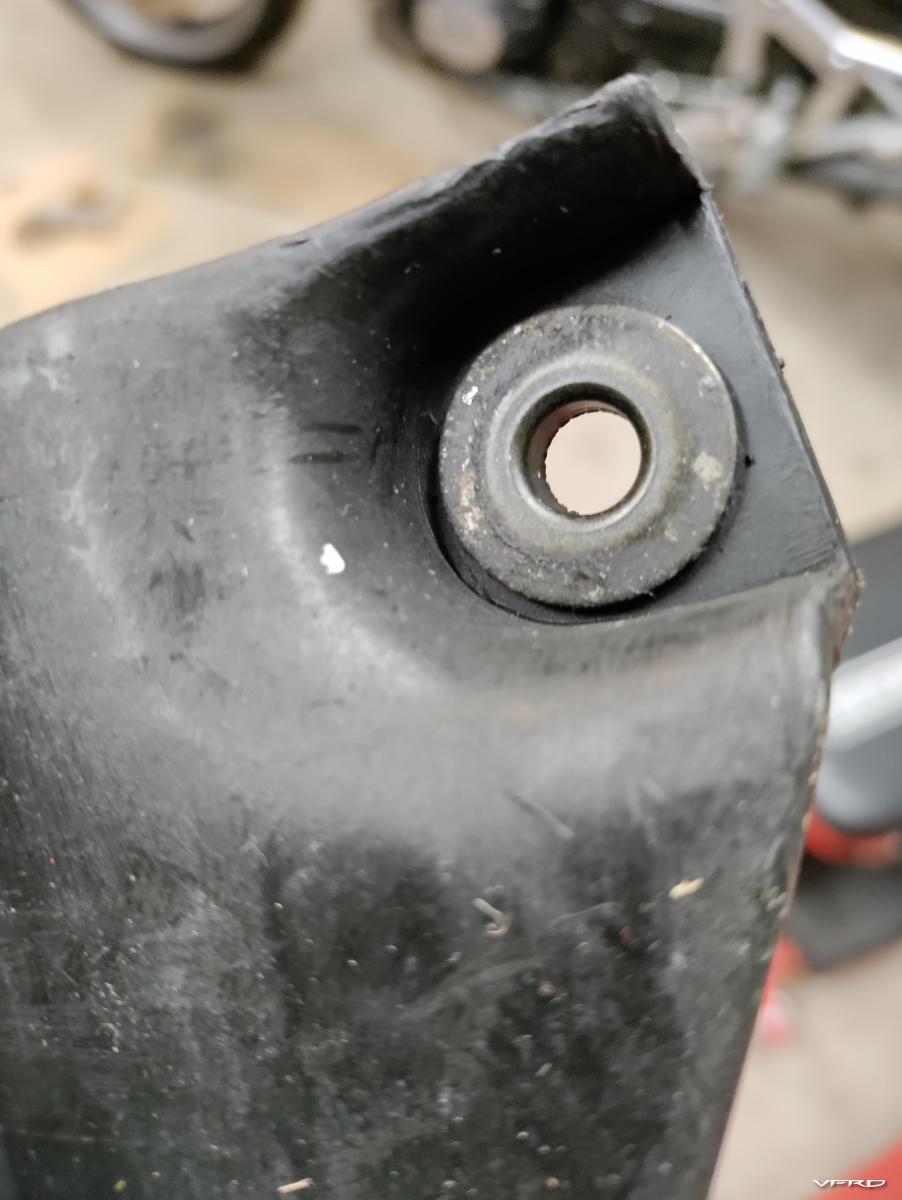

Other headlight faster is broken
As the oil cooler other attachment cracked as headlight fasteners bent
large.IMG_20240421_095224.jpg.ad09aafb5288a63c8166003577588e44.jpglarge.IMG_20240421_095032.jpg.c353e6610f1113b2c43fdb27f825471b.jpg
The headlight holders can easily be bent back nut the oil cooler faster needs a weld.

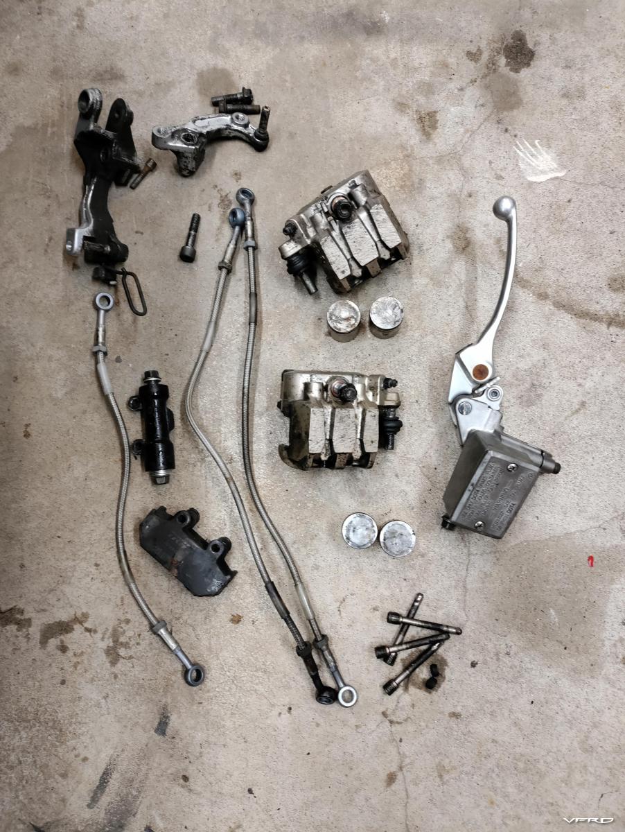

Did strip the front brake
I have the rebuild kit for the calipers. Also thinking I might take the long brake lines from the FJ for the VFR to keep it more simply whit just 2 brake lines.

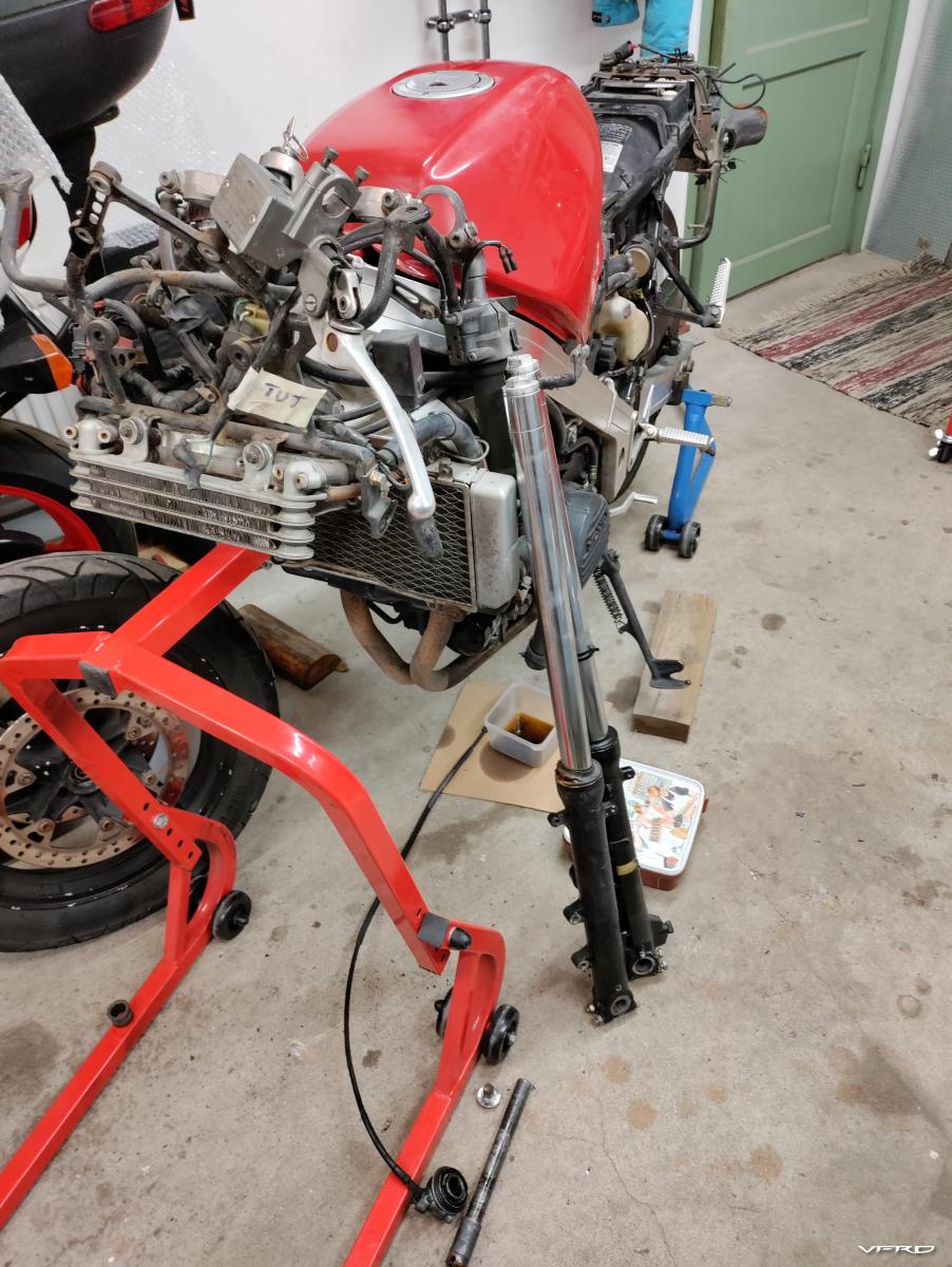

Fork legs off so next is to change the seals in them

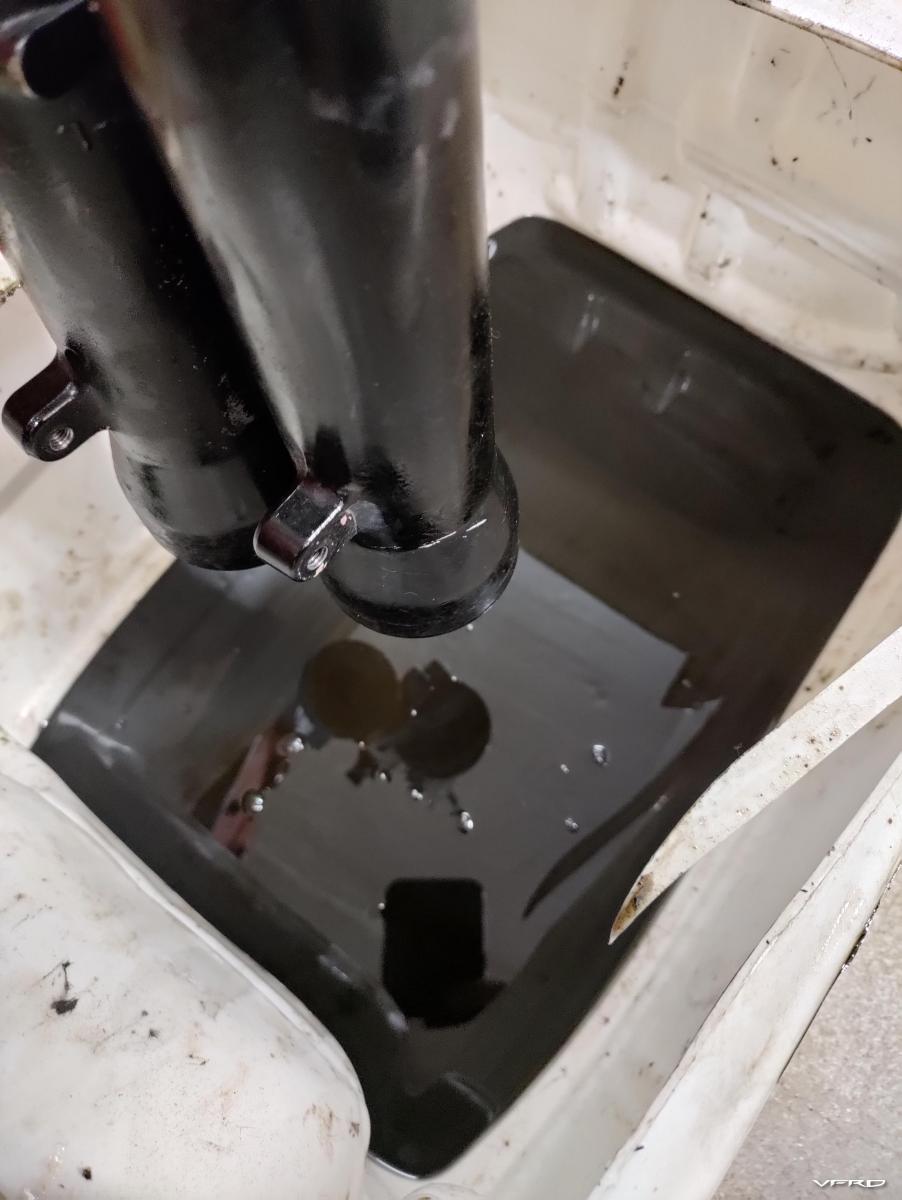

Opened up the orginal forks today,
Should have had a overhaul a few years back, I would say many years back.....
Oil just black as a night

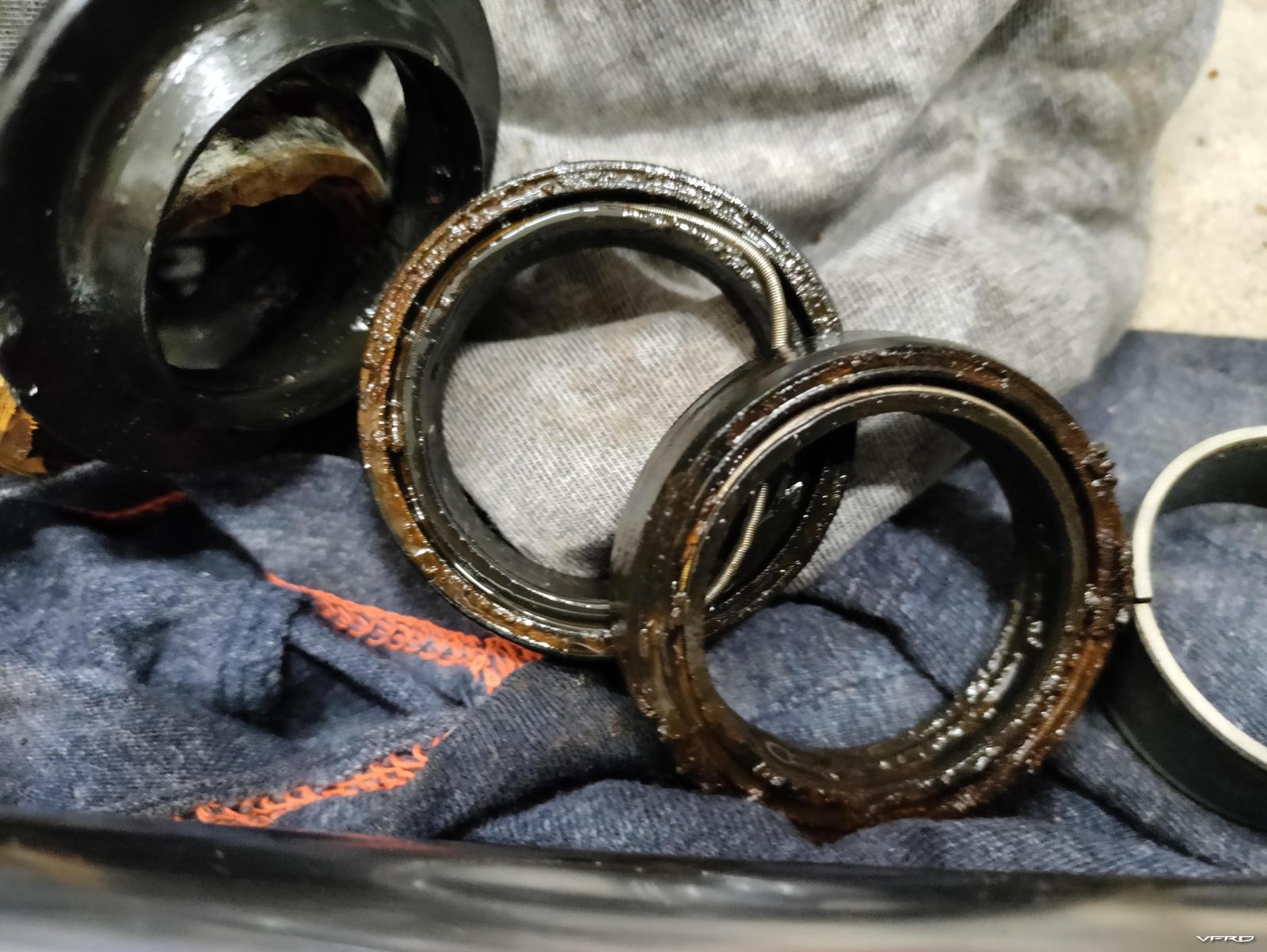

And fork seals far from fresh looking

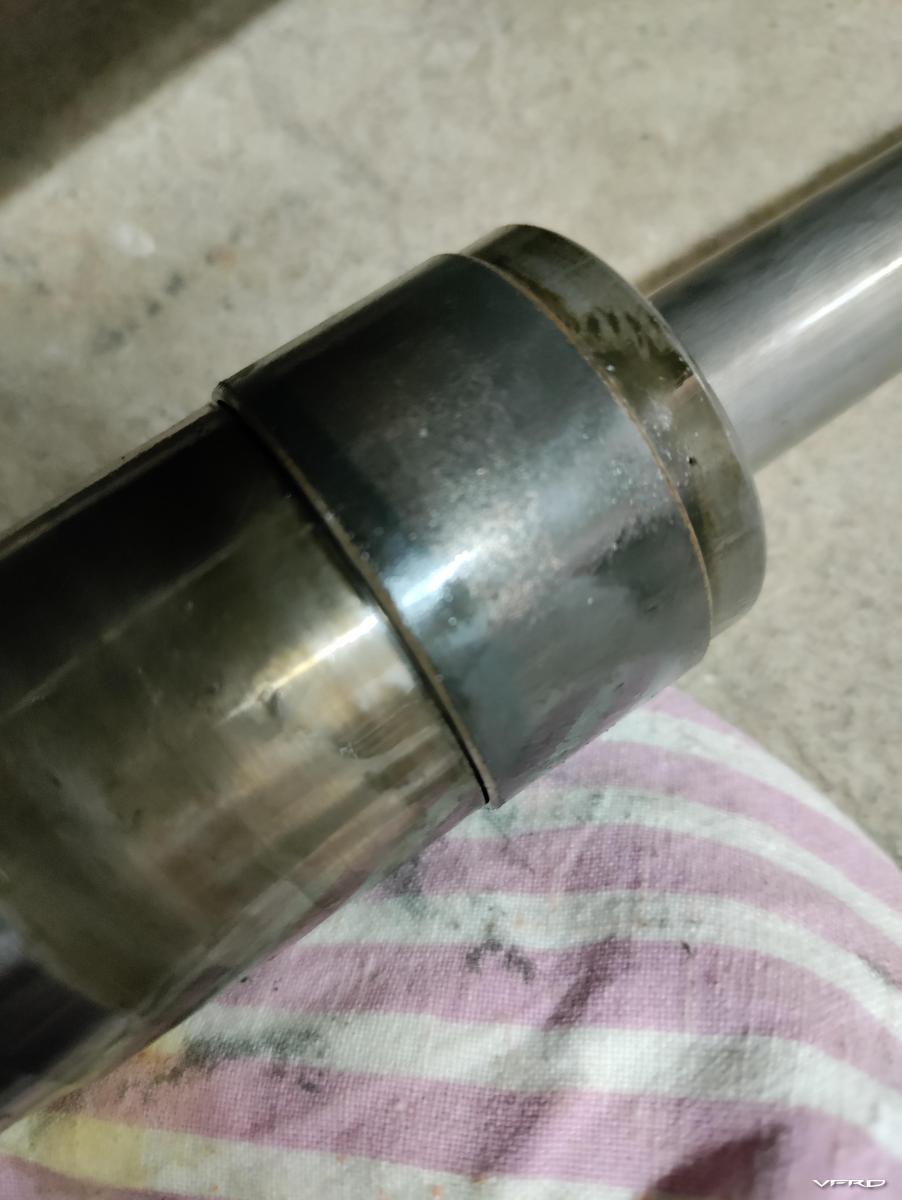

Sadly the bush sliders are past there best....

I've never seen fork oil that dark in anything!
I think, this is maple syrup,  not fork oil!

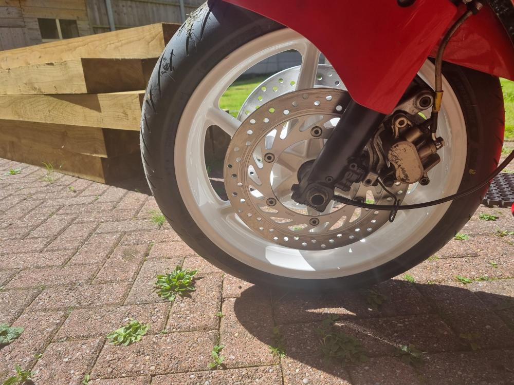

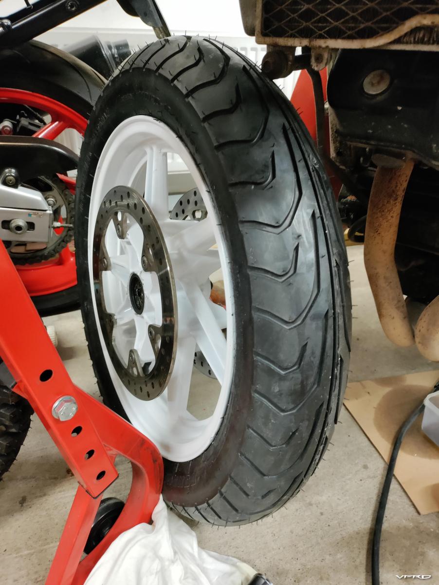

The front wheel is painted as tire mounted
keny, I don't think my US model came with the nuts installed on those posts from the factory. I never used the nuts on those two spots regardless.

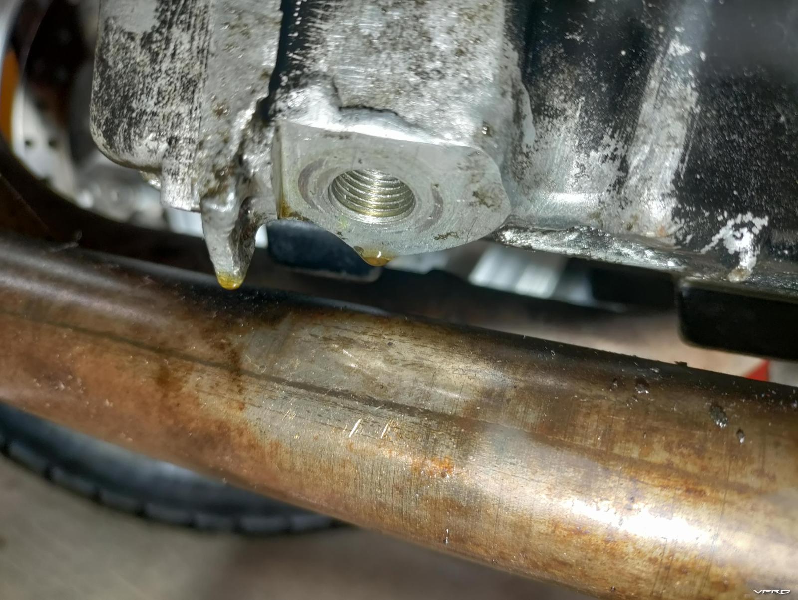

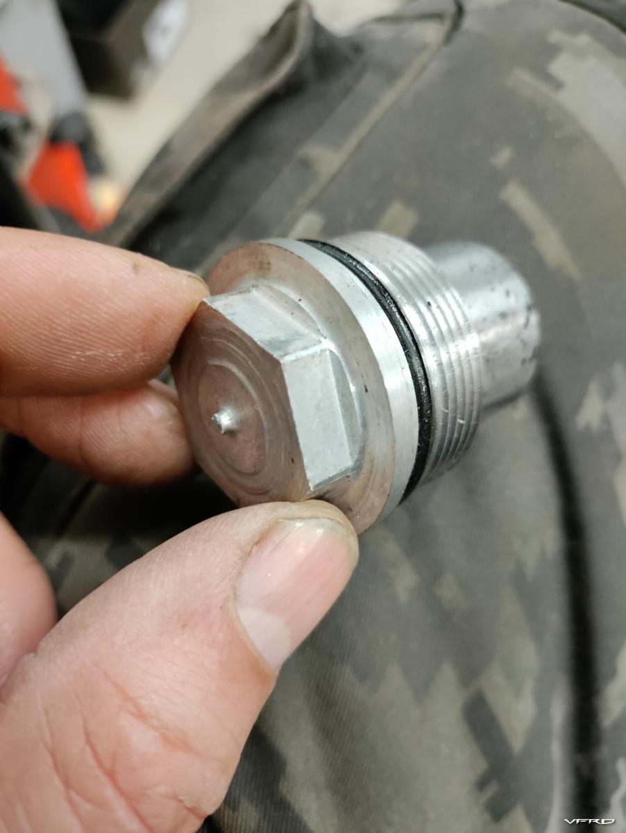

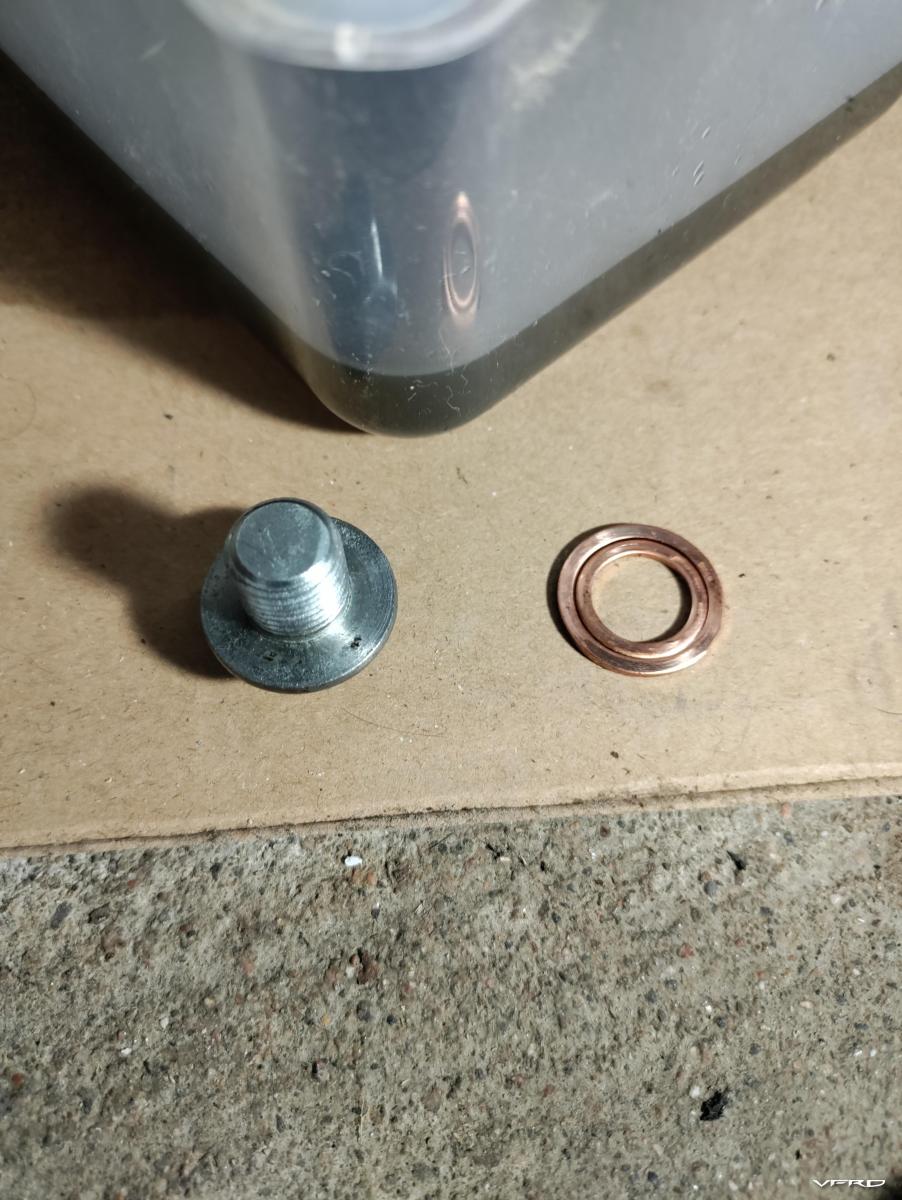

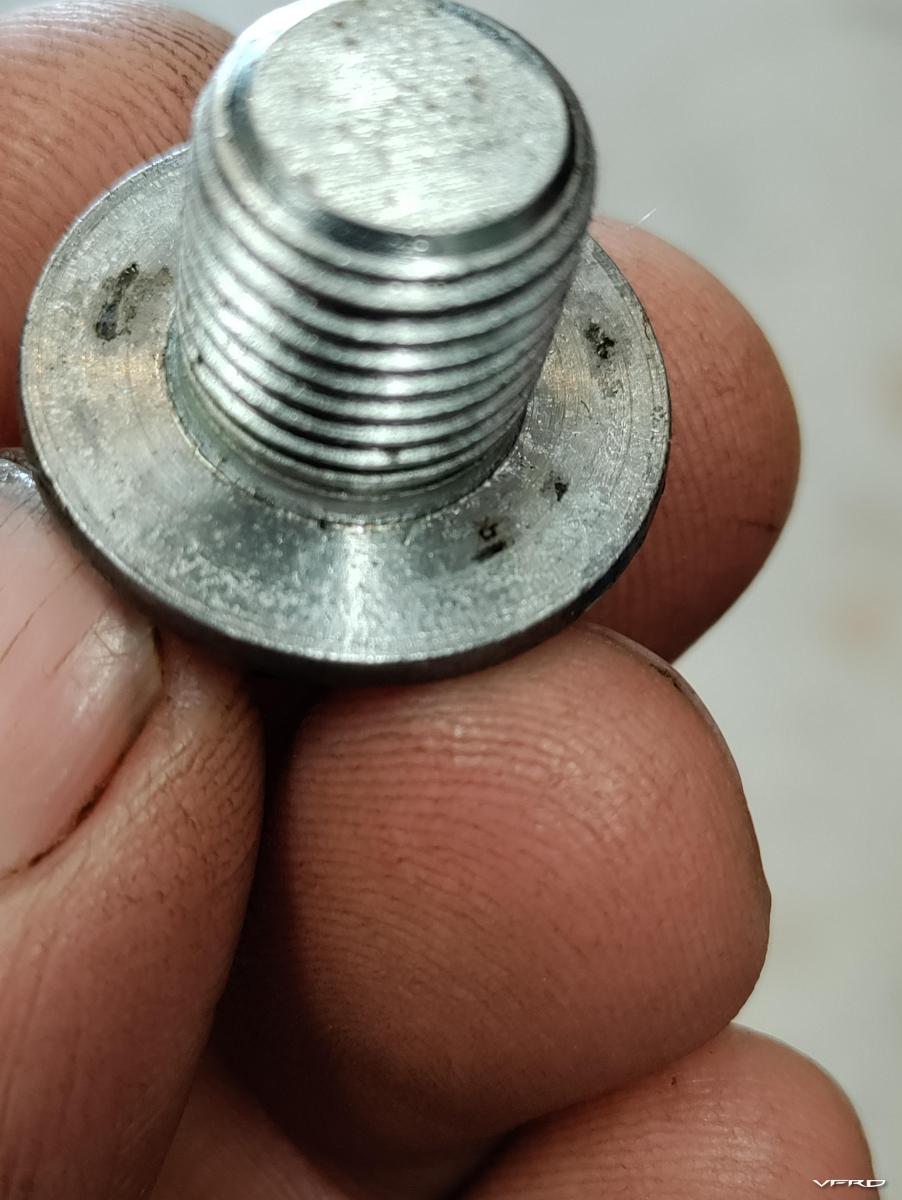

I wonder if the oil leak at drain plug is because the drain plug surface is not smooth
Is the other side smooth?
A new crush washer should be able to compensate for that, easy.
It did have a crush washer...    right?
Yes I did, a cupper one, will try a aluminum one next
Here the crush washer(s) I had
But looking at engine, the surface might net be 100% even?
If so, why 🤔
Use a new, Honda style, aluminum washer.
I don't see anything that should be a problem.
Brake calipers are cleaned
Ultrasonic cleaner is nice

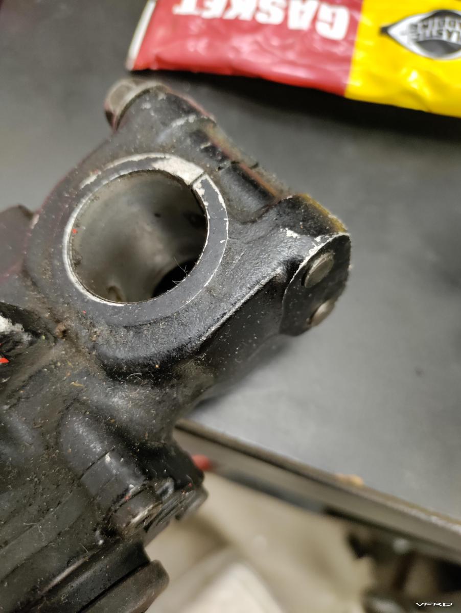

Well the anti drive was messed on the leg that was on my bike so ordered a leg lower from a breaker.
There are some differences for sure, mostly the fork clamp bolt design, the one from bike has thro bolts
Same as a 86 brochure picture
The one I got has treads in the lower and just bolts
But guess it works as good.
From a other brochure picture there is also a different system, but guess it's pre production bikes
At least what I think
I think I would prefer the nut/bolt = steel/steel securement and no steel/aluminum threads. mho
Just throwing this out there...
Are you sure you got a 37mm lower fork tube and not the 88/89 41mm?

That design of tube is 100% the way the clamp bolts are arranged on the later bikes. image.thumb.jpeg.b33035d0d9f6c119716817b3cb465fc8.jpeg
I've lost count of how many breakers treat list their parts as fitting 86-89. They're so different and while some parts fit they're not the same.
Even when they've specifically listed it as my year of bike I've ended up with the wrong part (last one was a set of bars).
I actually think they sourced the 1987/88 CBR1000F forks for the 88/89 VFRs.   They look identical (and are both 41mm damping rod forks), use the same size rotors and they have the lower unused mount for the big aero CBR front fender.
EDIT:  Yep.  Just confirmed it with parts numbers.  The lowers sliders are the same part number.  Chrome tubes are not, probably a different length

Nope, the one I got is for a 37mm, part number ML7-691 tells it's from a 1987 European market bike.
