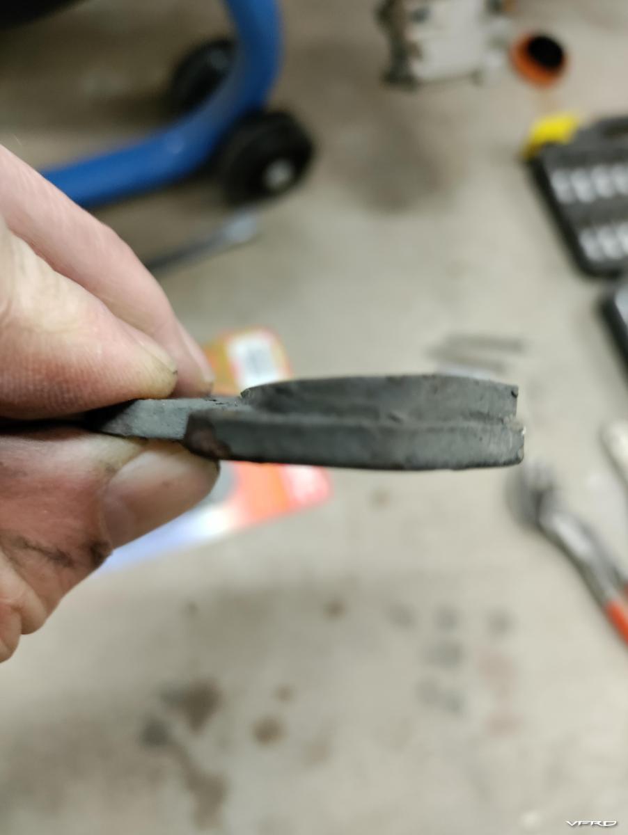

The brake pads are close to end of life as uneven worn. Hard to see in picture

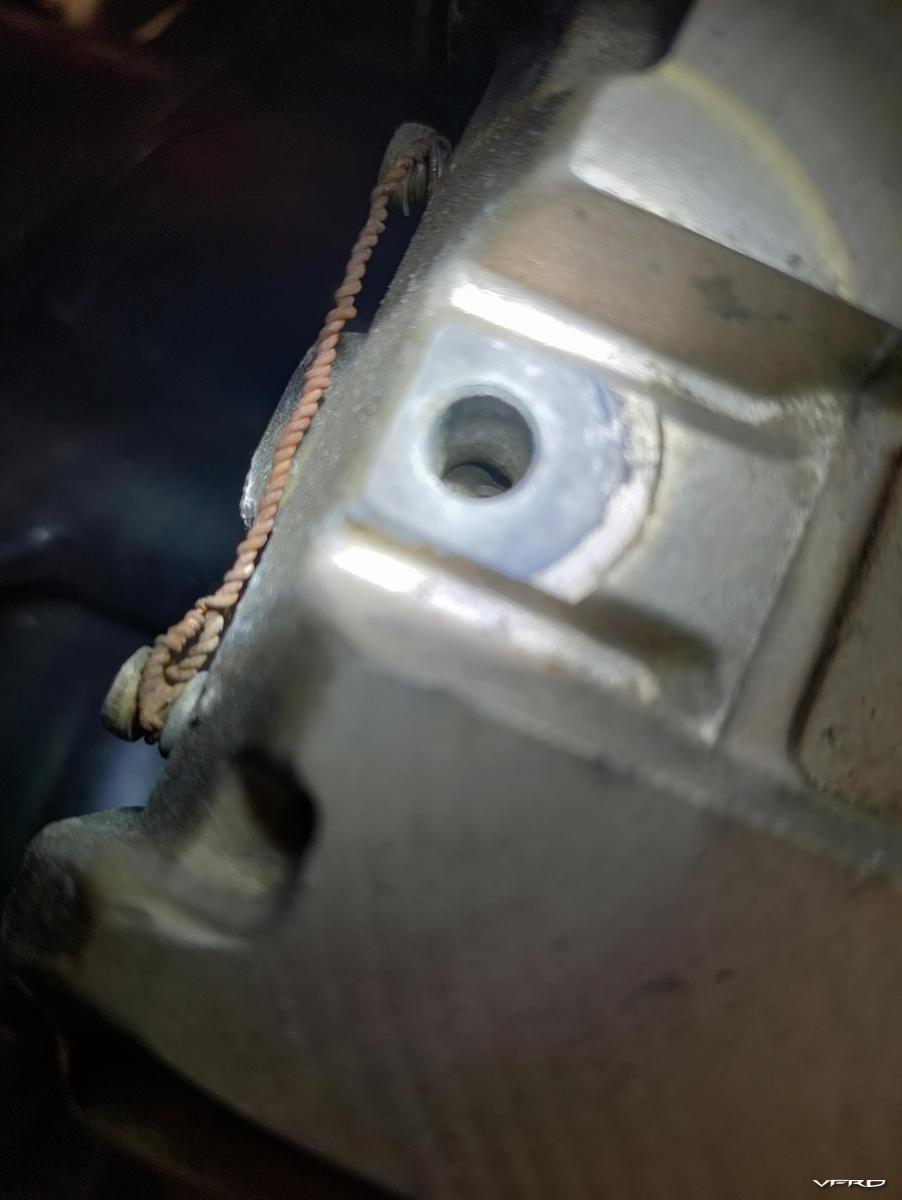

Brake disk has some wear but not bad so will use it as long the orginal wheel is in place. The locking plate for the pins holding the brake pads is missing and locked by a steel wire
Looking into the bolt hole you see why the looking plate is missing, the bolt hole for the bolt looking it has no treads left...
So treads need to be made. I should have a looking plate around, need to find it.

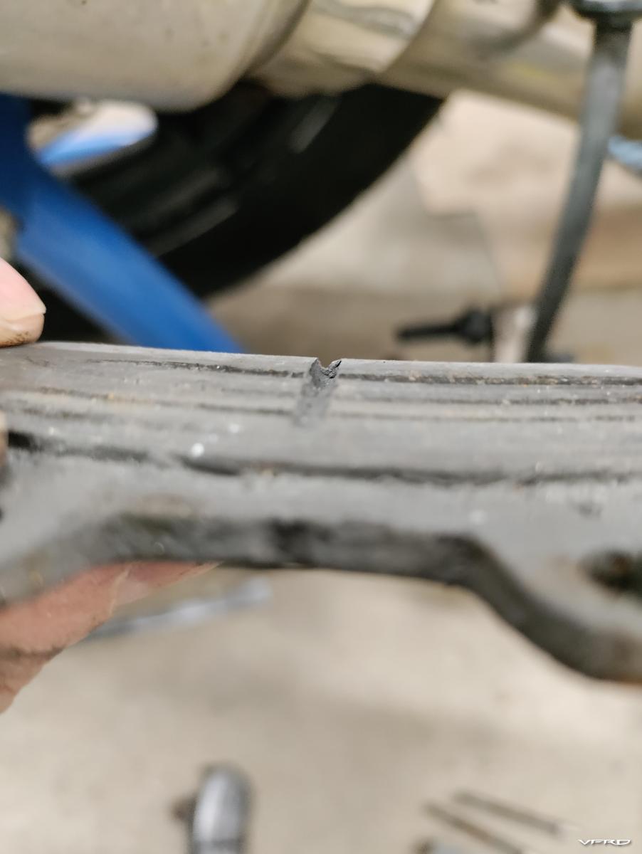

Brake pads close to end of life? Hardly...unless they're a lot thinner on the side we can't see. Clean them up with a brass brush and clean the rotors and run those suckers. New pads are only a few mm thick, so what looks like 1.5-2.0mm left is probably 1/2 to 1/3 of life left...so 10k miles?

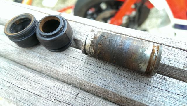

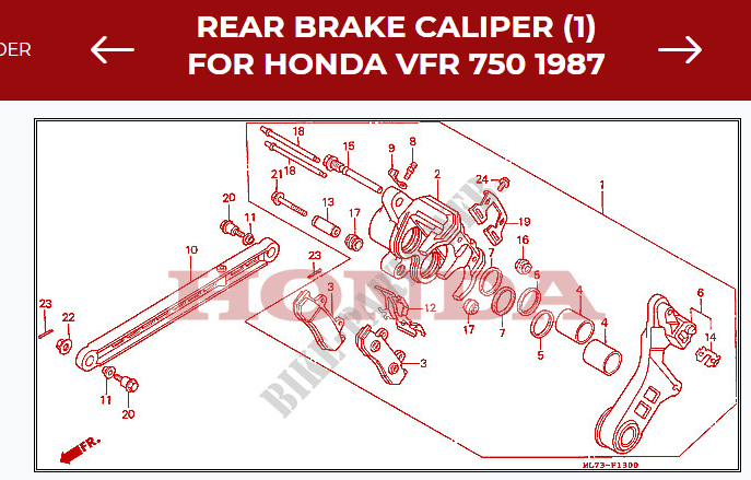

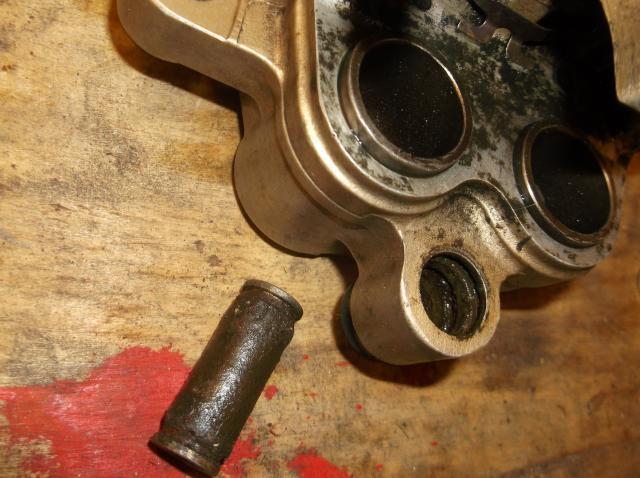

Take the calipers off and clean the pins, especially #13
Bet ya it will look like this...
the same thing appeared on a vfr i bought a few years ago, something proper maintenance would prevent.

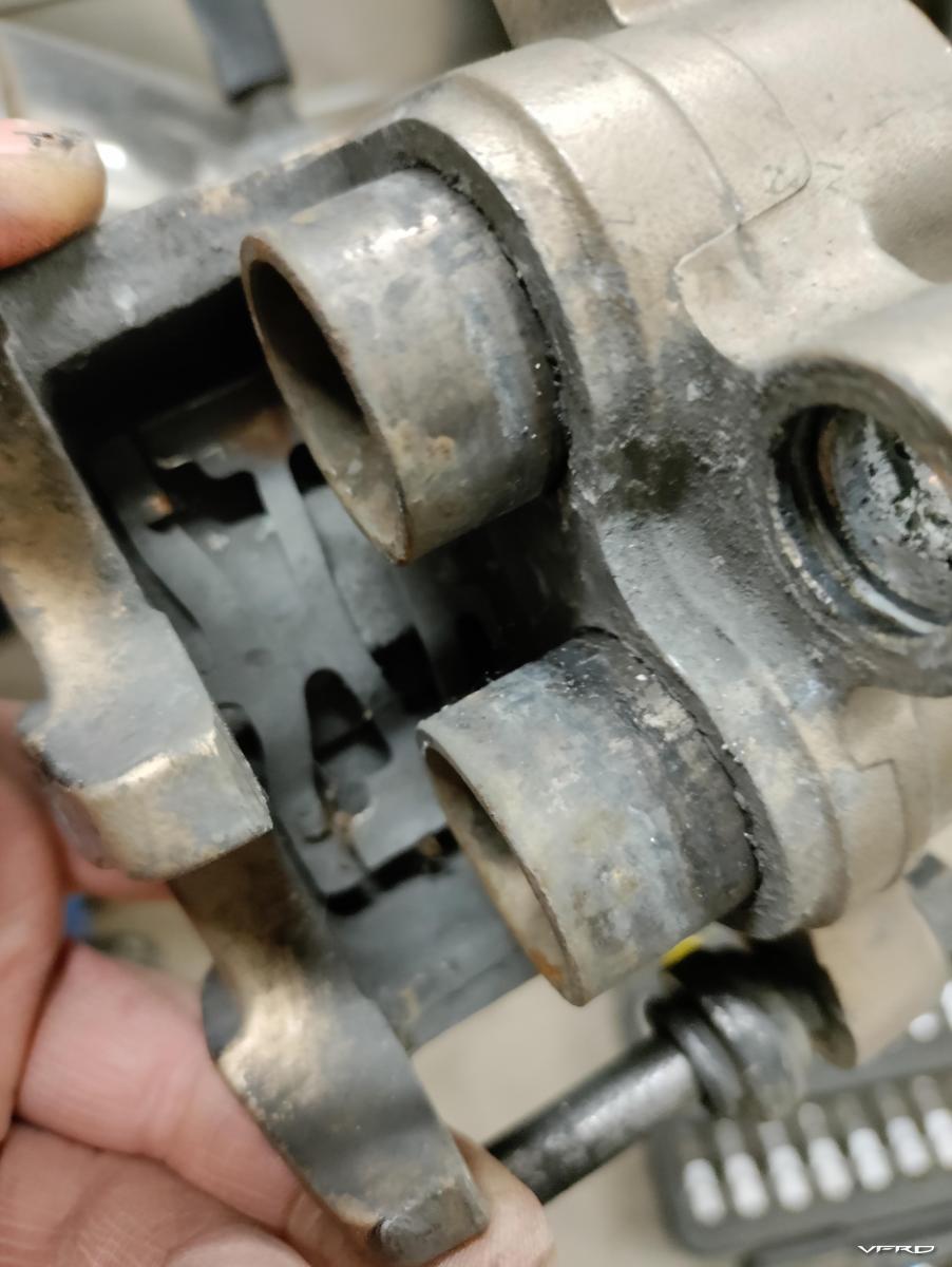

Well brake pads off now and think they are shoot
large.IMG_20240213_072011.jpg.8ce8e44dcb2a1aa07b76f20bdb34d741.jpglarge.IMG_20240213_072130.jpg.652b7a151db9a50b66bfcbb4e9073881.jpglarge.IMG_20240213_072117.jpg.8ffa21954cc960745b47aac2b1a52da9.jpglarge.IMG_20240213_072058.jpg.e70869b502db25476c796ca9d643e9d2.jpg

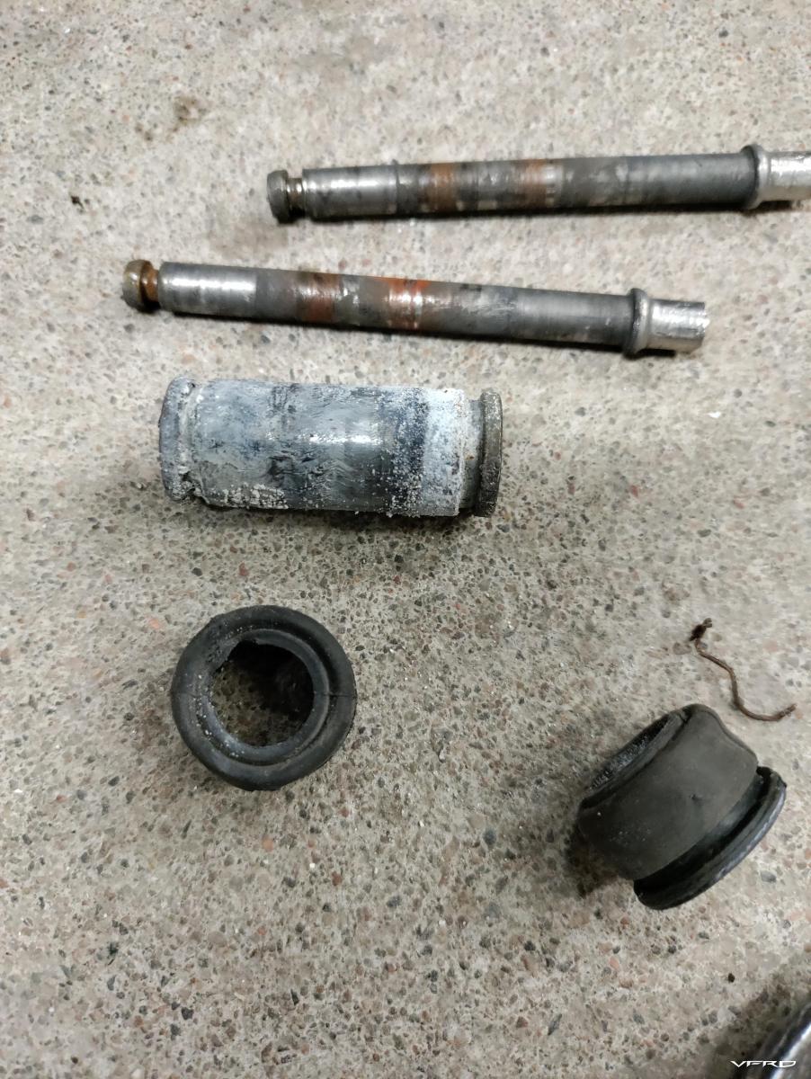

Well didn't look that bad even not good
The pistons are bearly moving, specially one of them but eventually got them out, a rebuild kit for rear caliper needed
