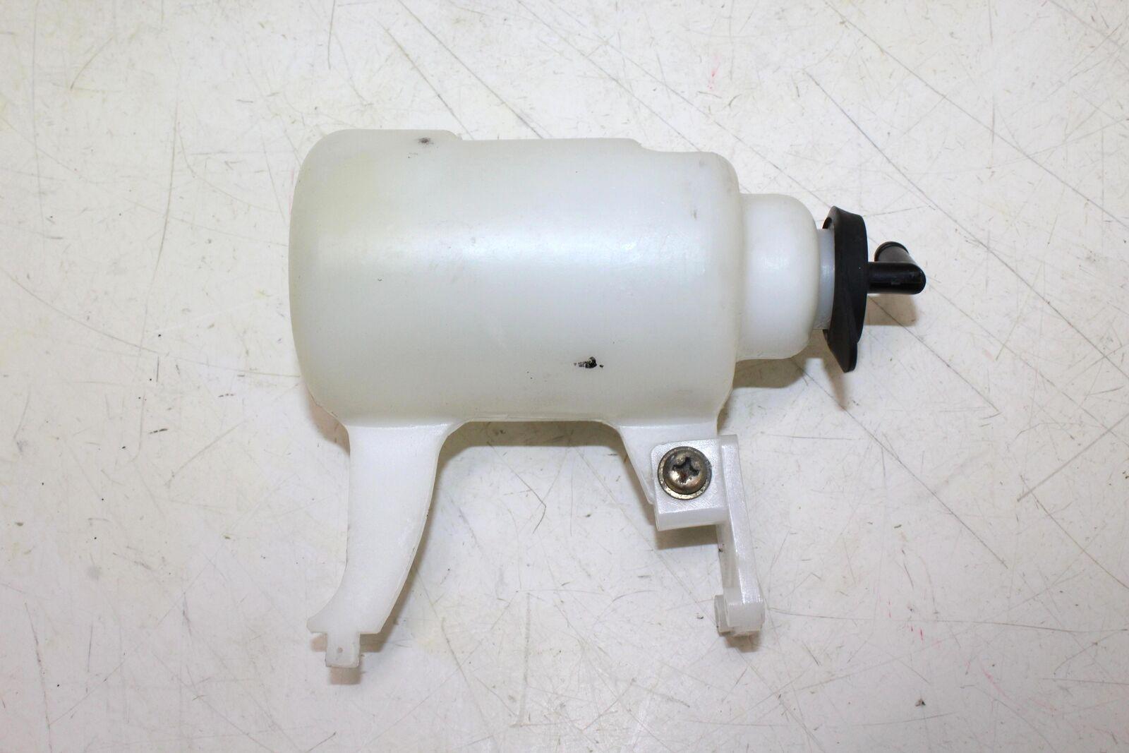

It's off of a Honda CH150 Elite scooter.  I think I was trying to declutter a bit and reduce some bulk.   Didn't think I needed a huge reservoir tank for what the bike was originally being built for.  Hasn't been an issue on the street.  Think I overflowed once, but an old radiator cap was to blame.  No problems since.
Started off as this:
I would always save them when we disassembled totalled or abandoned scooters at the Honda Shop.  Plus got a Fucke-Tonne of original Honda bolts and hardware.

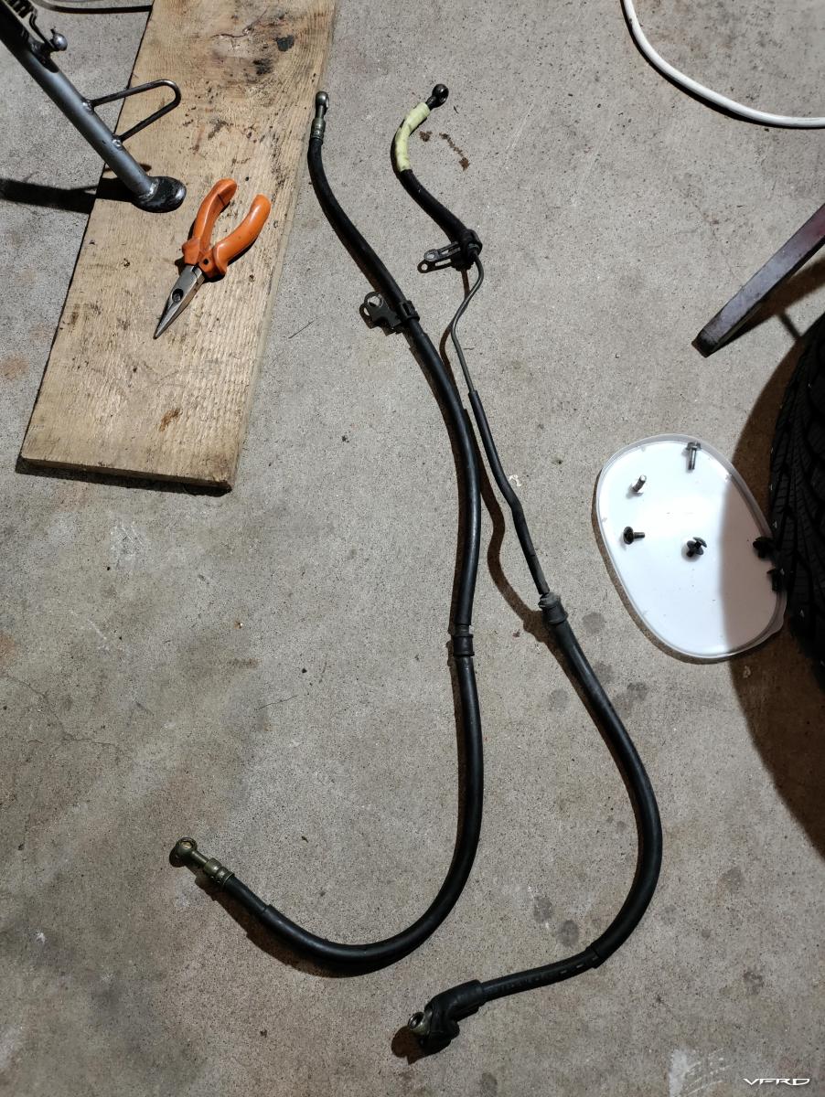

This morning did change the clutch line on the VFR, the "new" old off a 1987 bike again show how many changes there was from 86 to 87 even they look alike
86 to right 87 to left. The 86 had it partially as a steel pipe, To me the 86 actually is a bit more bling to me.
Also the lower mount has moved from faring mount to engine mount

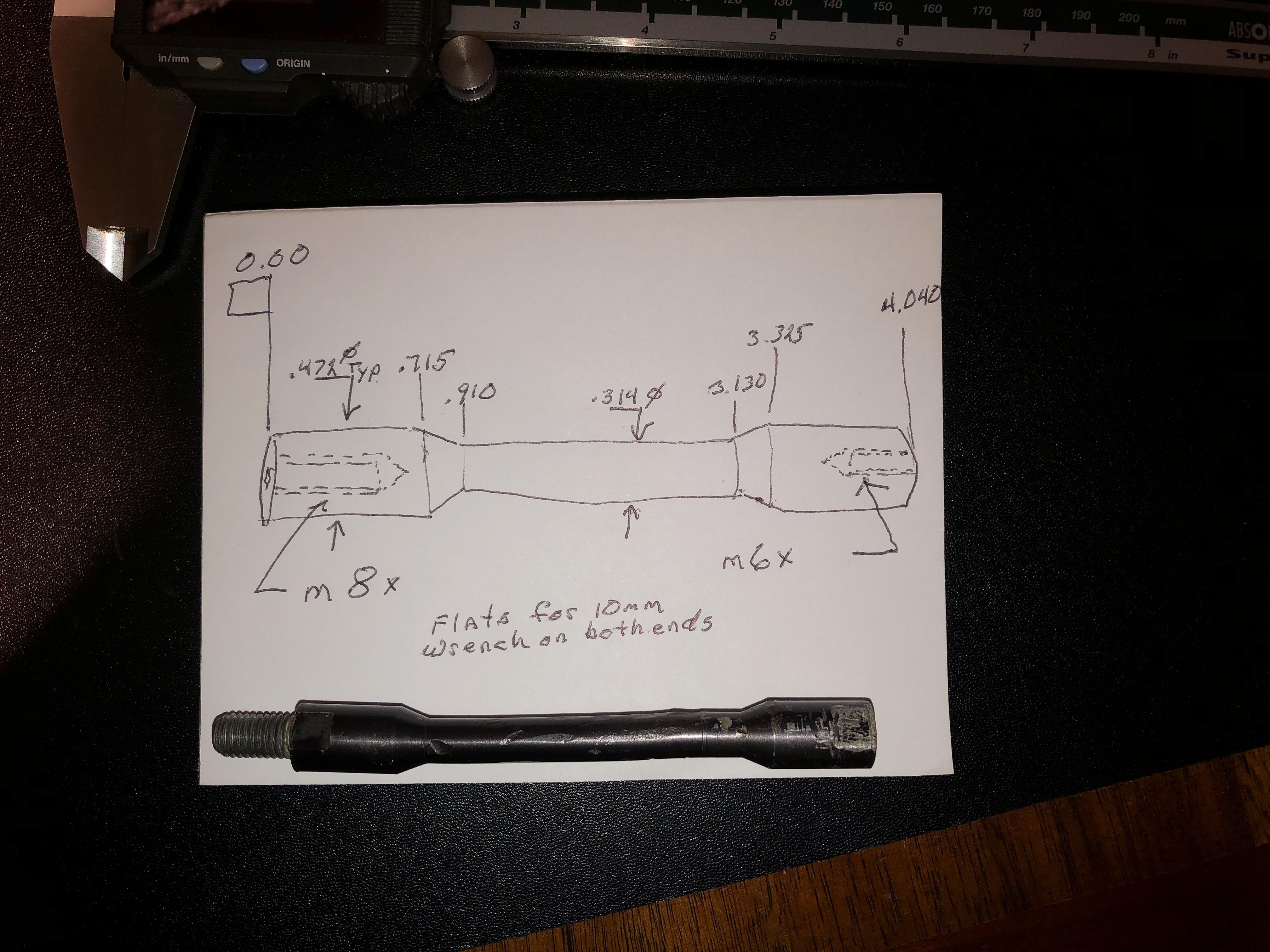

By the way what is the length of the faring mount where the 86 had the clutch line mount? I know the 86 has a cool special long bolt whit treads for fairing bolt in the end where 87 has a small bracket, I want to make a special bolt for this, now has just a straight pin whit treads in both ends....
Mine is 4.040" .  I would like to make a set for my bike, but done have access to a lathe anymore. My bike has a different looking stay on the right side that I would like to replace with a matching one.
If you need more dimensions or pics let me know.
On 9/23/2023 at 4:30 PM, tsmitty said:
Thanks!, now I just need to convert all measurements to metric to understand anything 😅
  • Haha 3
100mm length of 12mm bar turned down to 8mm in the centre... personally I wouldn't overly worry about being exact,  just do what looks right.
