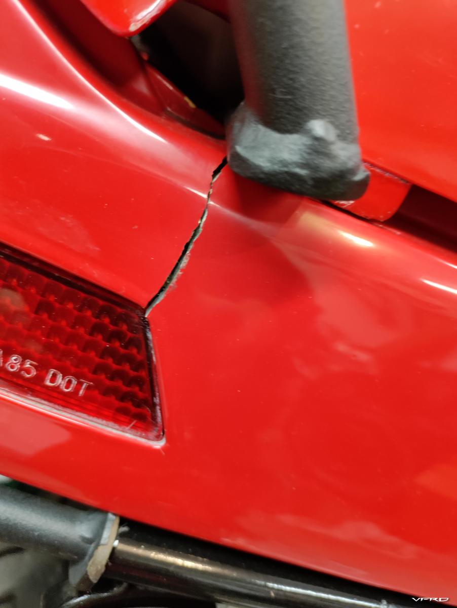

I see that my repair of the tail section has not hold on other side
I don't know if the rack is reason to that? Have to look into it.

On 10/16/2024 at 7:32 PM, keny said:
Well, the RC24 has been resting now.
I can see I have some things to do to it during winter, aside the 17" rear wheel conversation as cbr900 front fairing.
 Bit odd to break there. Normally it breaks on the bottom. I'd say maybe is rack related.
I ended up bonding my tail light to the plastic so it became one item. I'm going to have a bit of a reinforcement session when I get a chance, fix the mounts (front ones are both cracked, rear where the grab rail fixed as well)) and bond some metal around so it won't break again (short of destroying the entire thing).
Both sides had a crack at that place, did repair both sides whit plastic welding using a thin aluminum net melting it into plastic but this side didn't hold.
I agree that probably rack related, also the fastners of fairings has not the correct spacers as rubbers, some former owner has lost them.... Plans to make new spacers as a friend has a shop that makes small metal bits, so automaticaised as menual lathe's available...

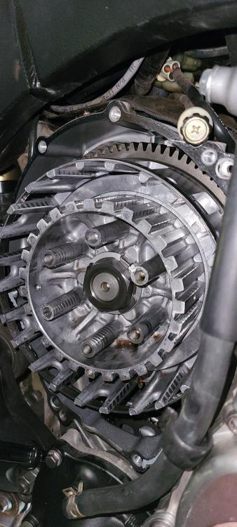

Did take clutch cover off to check the oil pump chain that former owner claimed to be very loose.
Well first, the cap's head is round so needs harder treatment to get off as needs to be replaced
Then the oil dip stick is missing the O ring
And seems I need to make a special tool to get the clutch inner off
Actually the oil pump chain doesn't seem that loose to me, they usually are a bit loose, but I will take the clutch off to check anyway. And for this clutch cover I have got a new gasket, good as in bits
The oil pump chains are loose to begin with.  To the point everyone thinks there's a problem.  There isn't.

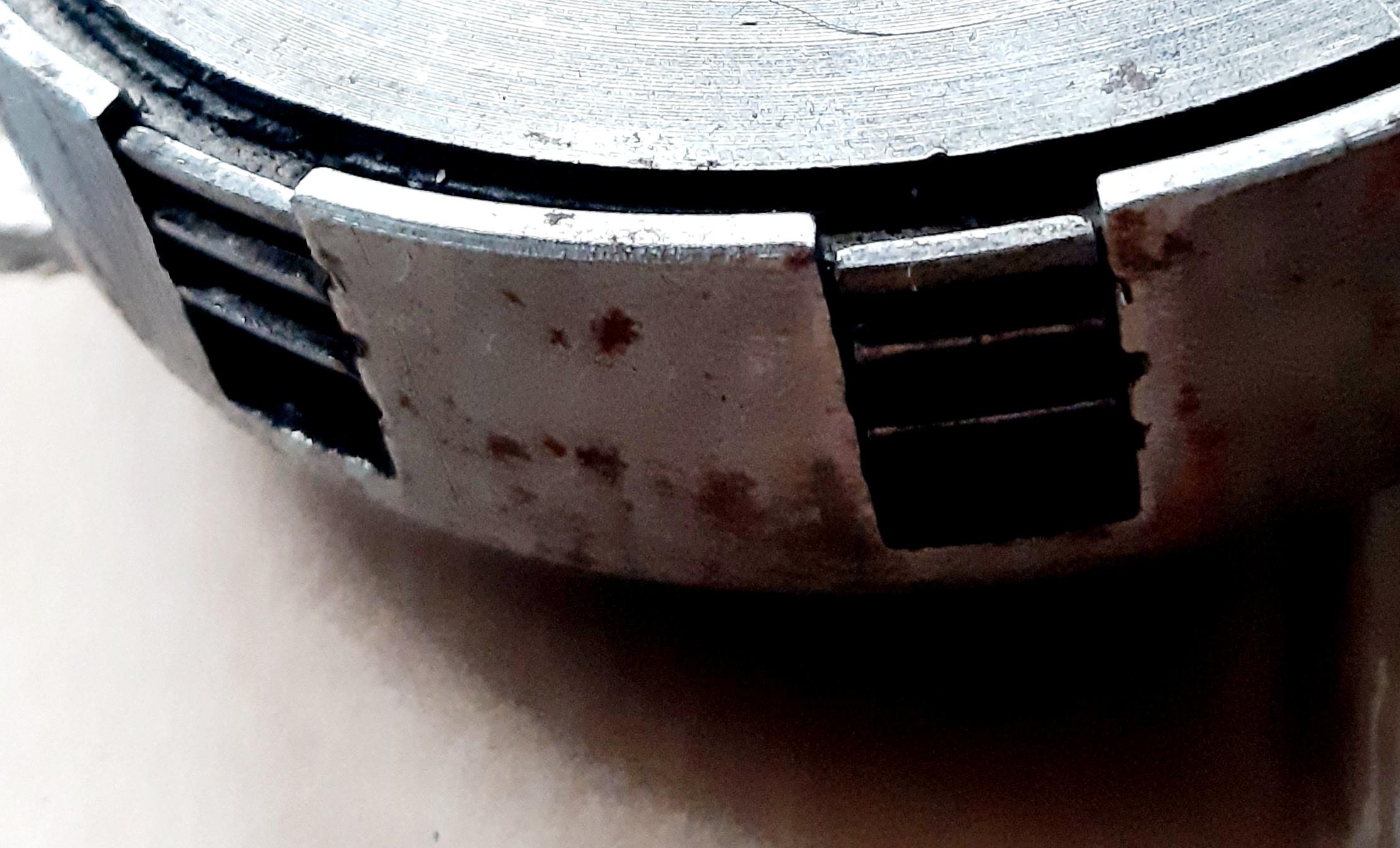

Clutch basket appears to be in good shape judging by the reflections across (what appear to be) minimal grooves in the outer basket fingers.
70 year Gilera old basket....
But truth be told, it still funtioned...
Yes, they are not too bad
But the clutch springs has made deep groves!
Now I'm wondering if it's from them the snapping noice like something slipping is coming from as you release the clutch 🤔
To state the obvious, normal wear in there is normal, but you can break off the posts. I found my similar issue from an oil analysis in one of the track bikes.
Normal wear:
Less normal! lol
