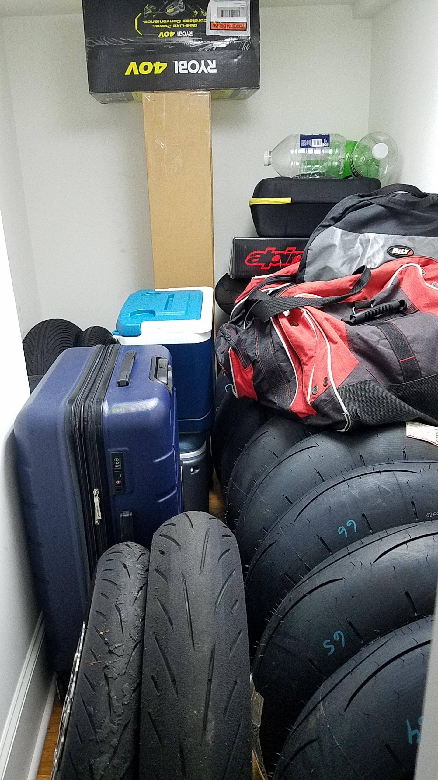

Member Contributer bmart Posted July 7, 2022 Member Contributer Posted July 7, 2022 Who is mocking my air conditioned, inside, dark, hobbit...I mean tire closet now? 1 Quote
Member Contributer Captain 80s Posted July 7, 2022 Member Contributer Posted July 7, 2022 1 hour ago, bmart said: Who is mocking my air conditioned, inside, dark, hobbit...I mean tire closet now? Awe shit, that looks kinda familiar. I put pairs into black plastic trash bags tied in a knot to stave off out-gassing too. Worth anything? i dunno, but it's a cheap extra layer of protection and keeps the smells down. 1 Quote

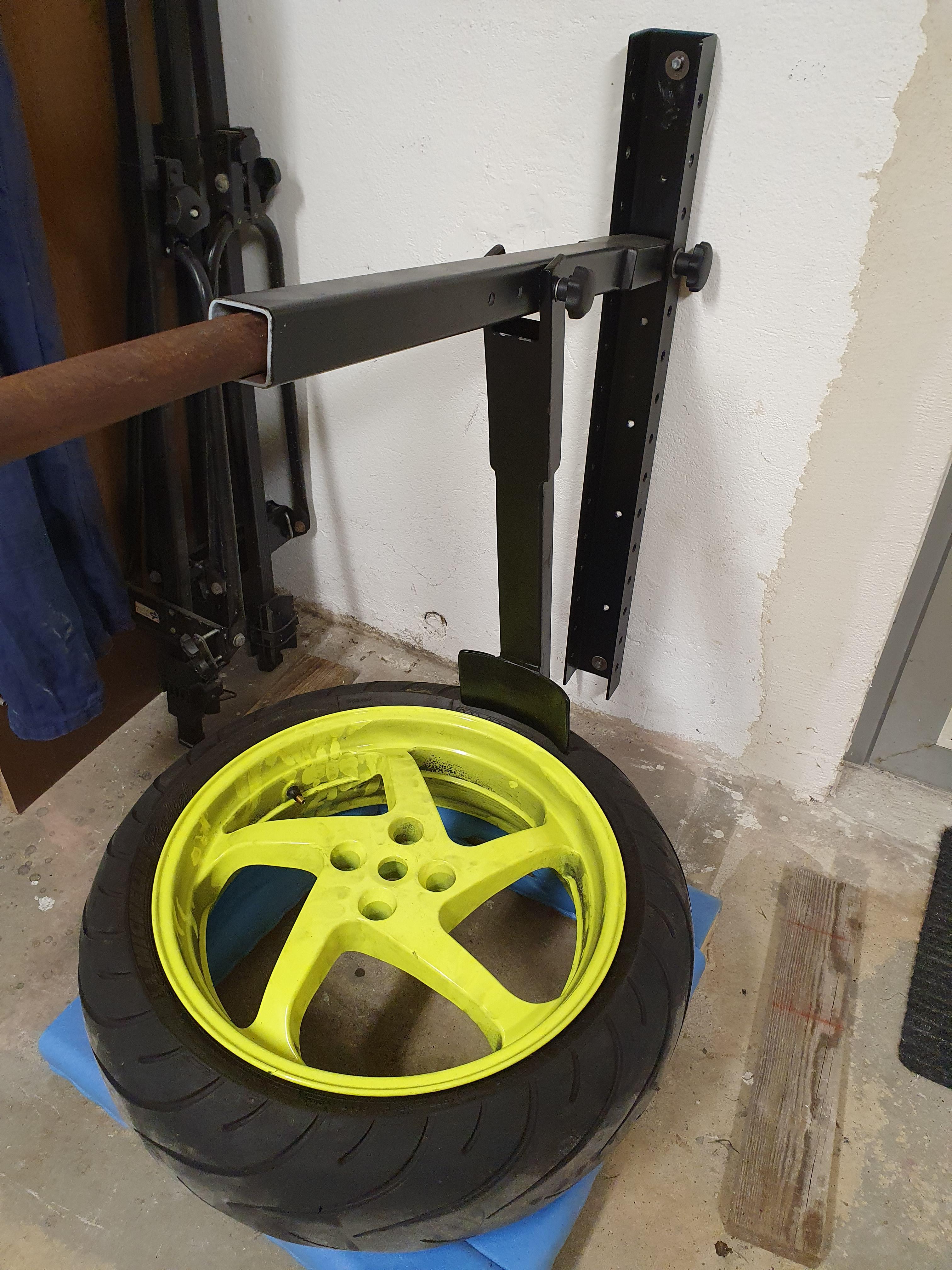

Member Contributer Bren Posted October 12, 2022 Author Member Contributer Posted October 12, 2022 3 minutes ago, Captain 80s said: I mount and balance all my own tires (with irons and rim protectors), and Michelin PP are by far the easiest tires I've ever done. They almost fall on. That's exactly what I thought and seating the bead was so easy. This was the first time changing my own tyres and I was prepared - 3 tyre irons, rim protectors, mounting paste and weights that I sprayed yellow to kind of match my wheels. Didn't scratch my rims, didn't pay dealer prices and got to build something, my bead breaker 😁 I've since added plastic tubing cut lengthways to the bottom and side edges to make sure I don't scratch anything. Happy! 1 Quote
Member Contributer Captain 80s Posted October 12, 2022 Member Contributer Posted October 12, 2022 20 minutes ago, Bren said: That's exactly what I thought and seating the bead was so easy. This was the first time changing my own tyres and I was prepared - 3 tyre irons, rim protectors, mounting paste and weights that I sprayed yellow to kind of match my wheels. Didn't scratch my rims, didn't pay dealer prices and got to build something, my bead breaker 😁 I've since added plastic tubing cut lengthways to the bottom and side edges to make sure I don't scratch anything. Happy! Hell yes. I need that bead breaker. I currently use my hydraulic press with a couple pieces of wood, which works just fine, but a little precarious. I like that because it just collapses down and isn't in the way when not being used. And as much leverage as you want with the bar of your choice. Info on it? Quote

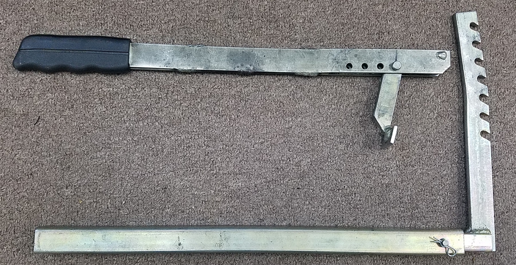

Member Contributer bmart Posted October 12, 2022 Member Contributer Posted October 12, 2022 Holy smokes! I was thinking what overkill that is for bike tires. I've been using this for decades and change/flip tires just about weekly for track events. I broke the beads on four last night in probably 2 minutes. I don't have the space for a large one anyway. Quote
