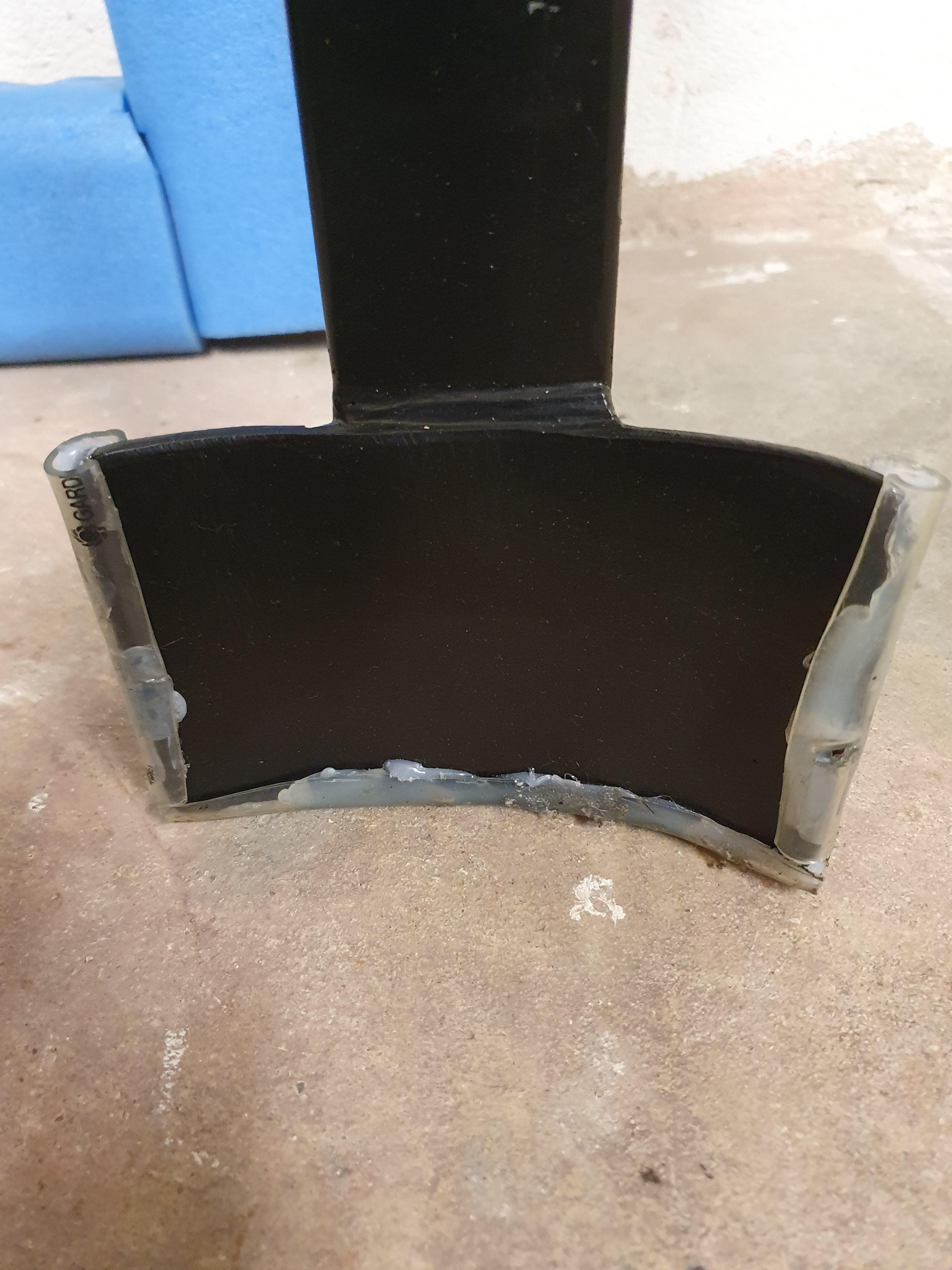

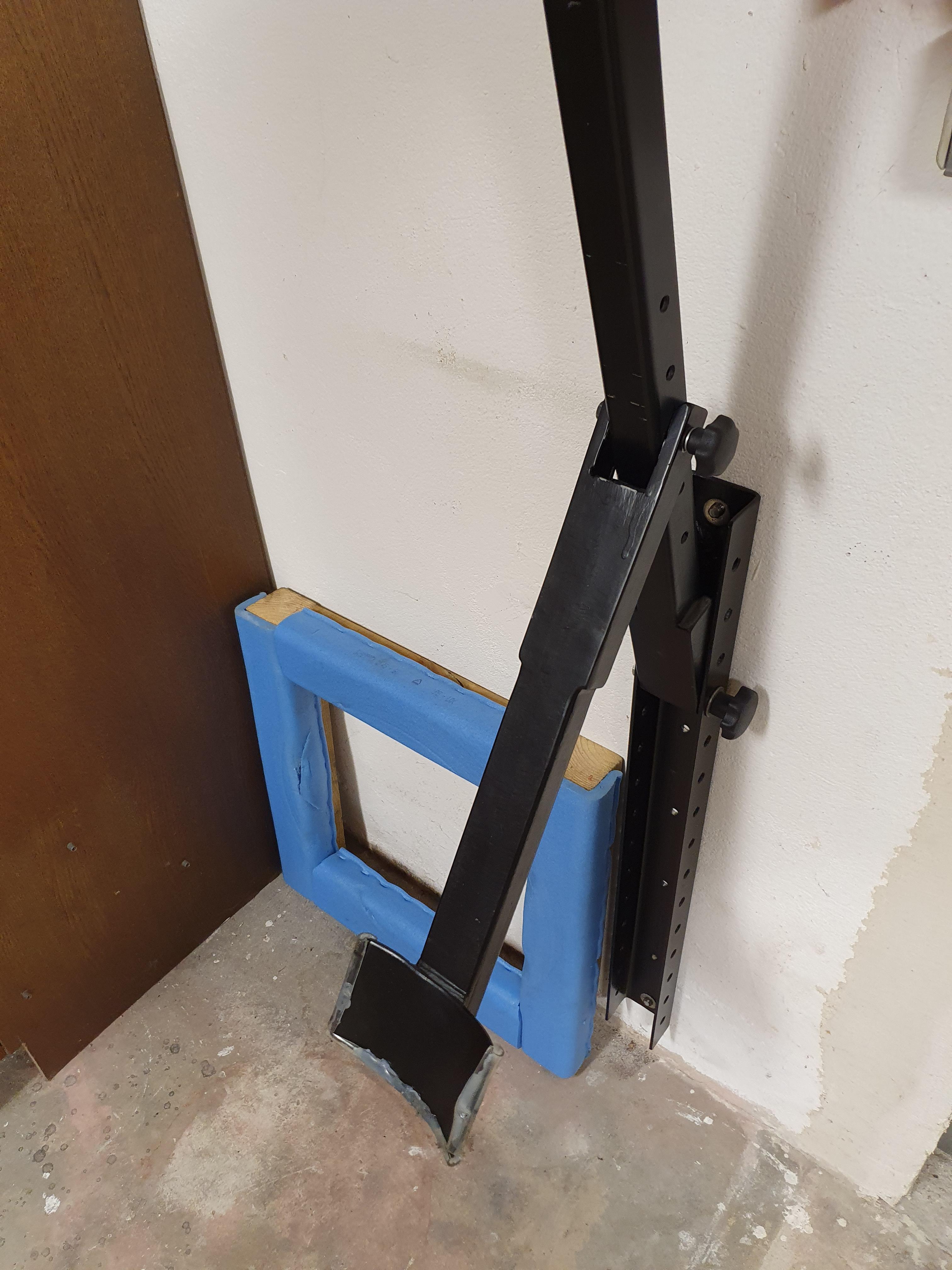

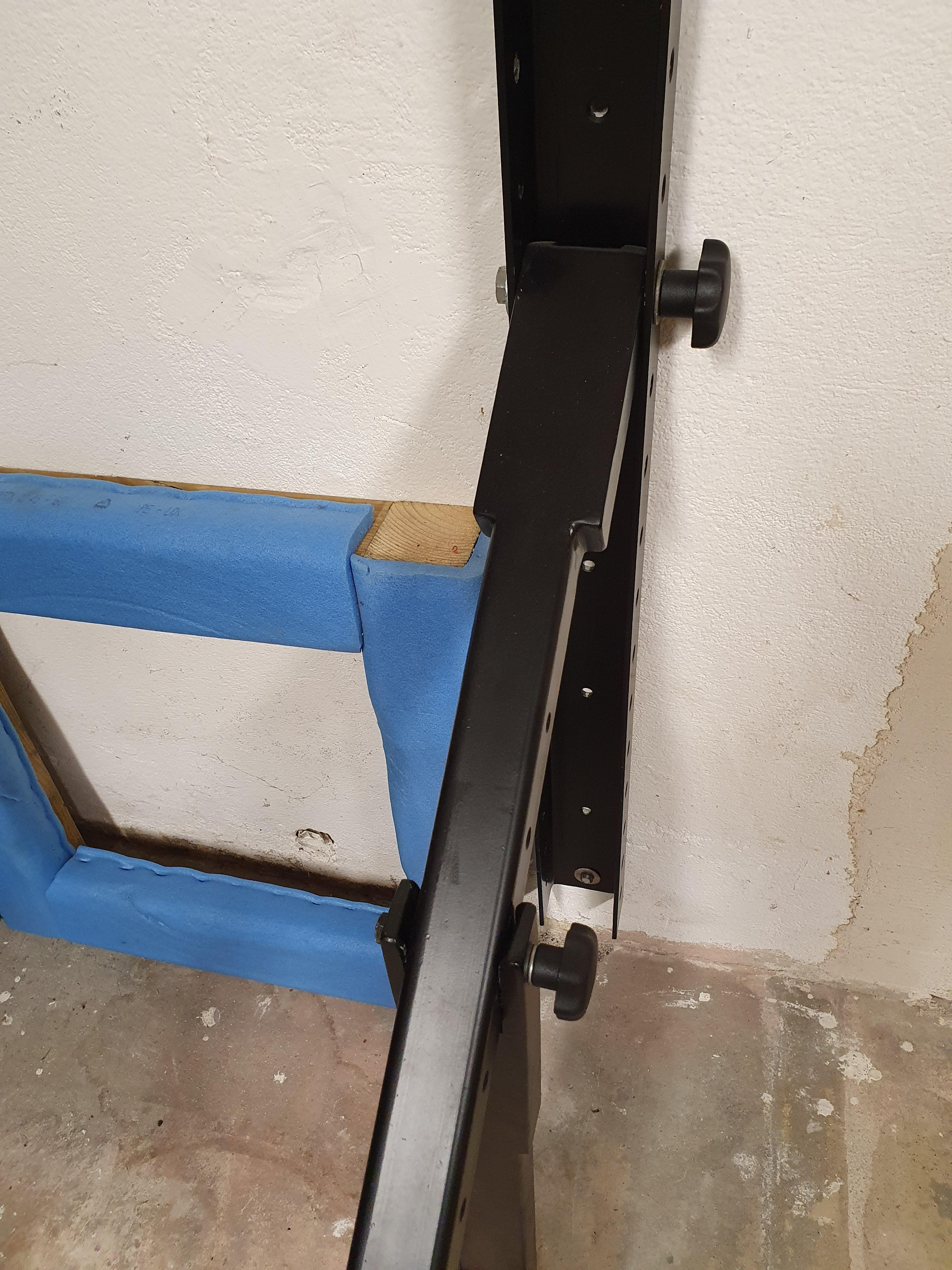

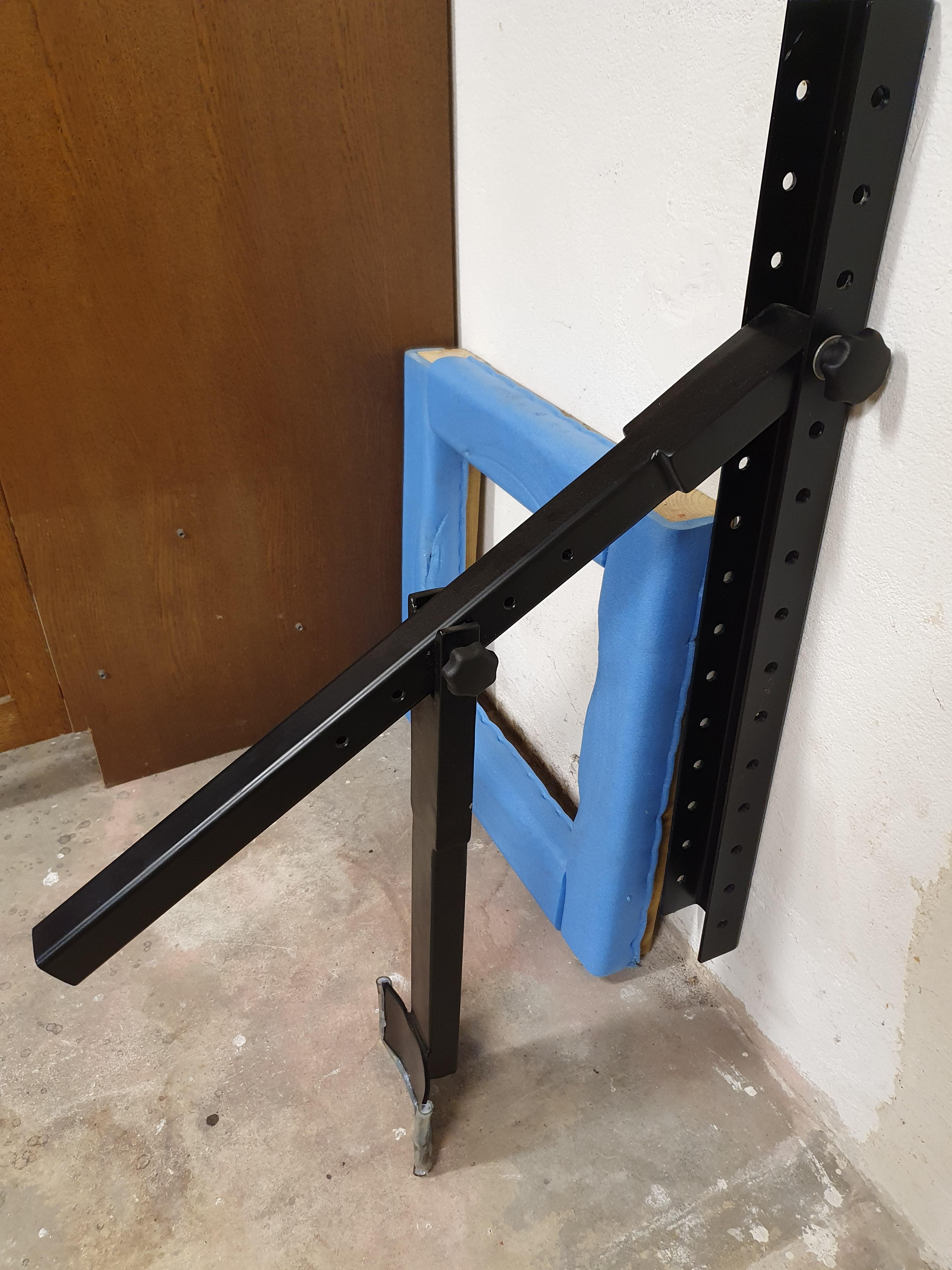

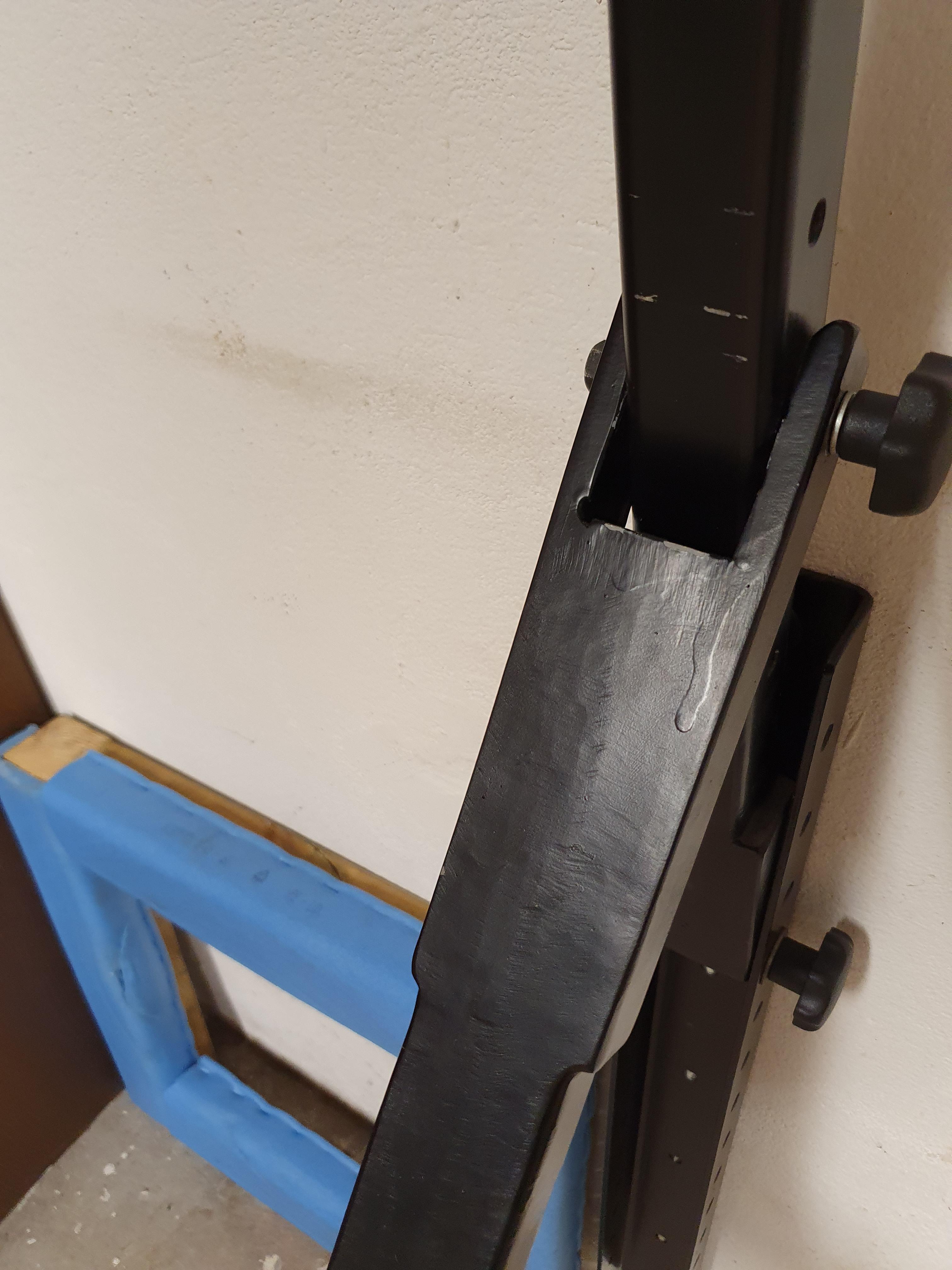

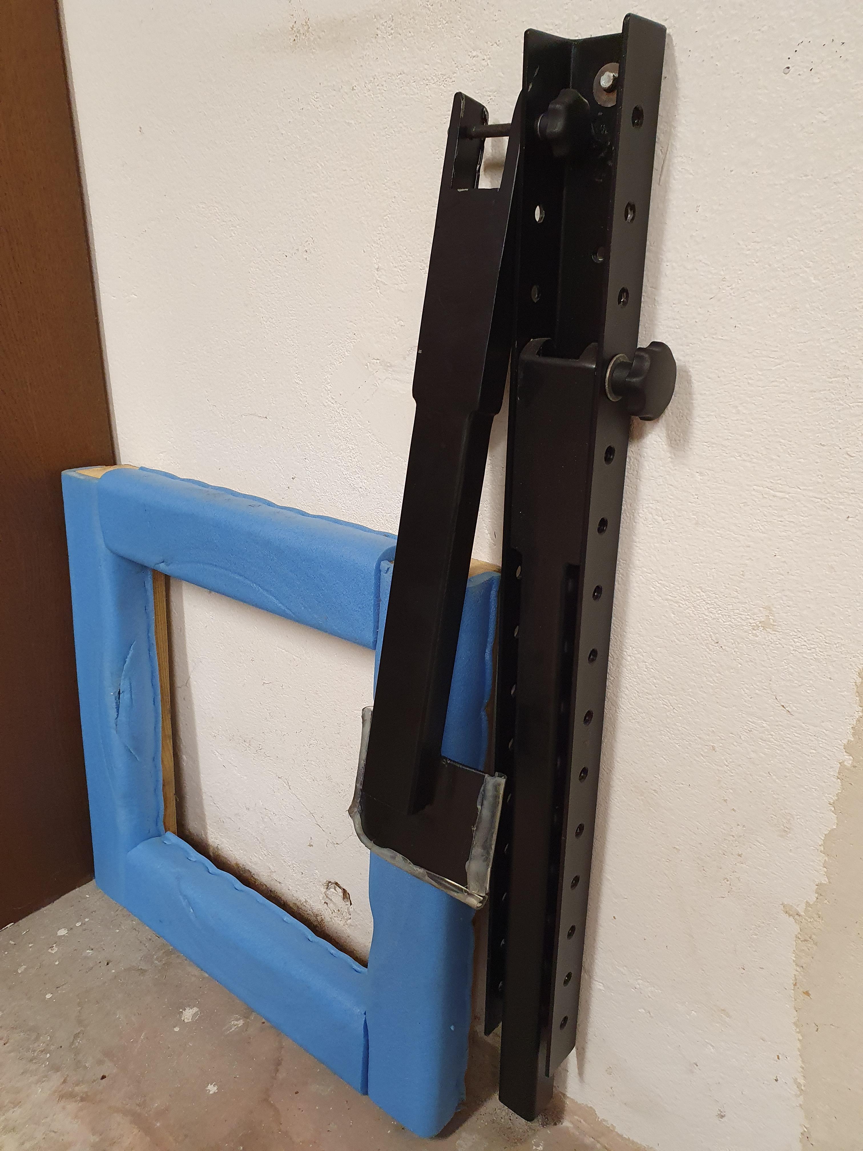

Here's some close ups of how I made it.
Bolted to the wall is a U channel with holes drilled along the side flange to position the arm wherever I want, I could have fixed it higher up but it's easy enough to move if I have to because the holes on the back are all equidistant.
The curved piece was bent with a lot of heat and is matches the radius pretty well. I welded the whole lot up, smoothed my terrible lumpy bumpy welds and gave it a spray of paint. I added some rubber tubing before using it to make sure there was no steel to rim interference going on.
The arm with the breaker part can be moved on the lever arm to suit. I have to get a proper bar to fit in there which matches the inside dimensions to make it work even better, the bar I used was round and thin walled so bent a bit and I had to keep turning it.
Lastly, folded away for next time with my hard foam covered timber frame to keep the rims off the ground and protect my discs. I use a strap around the rim and frame to stop it tipping when in use.
All in all its simple and works well for me. If anyone wants measurements or whatever let me know.
