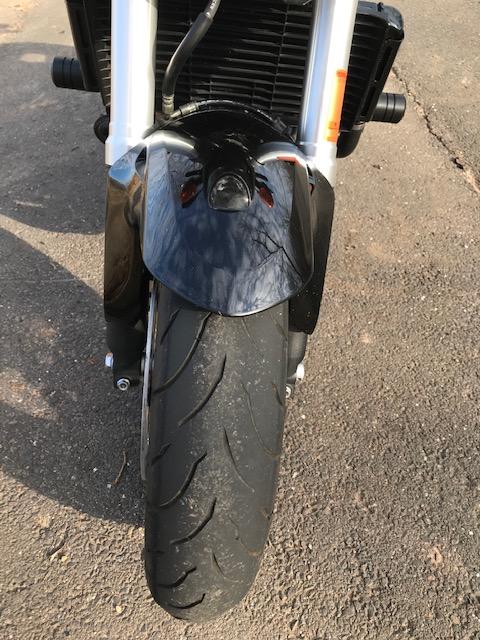

Member Contributer Skids Posted December 31, 2021 Member Contributer Share Posted December 31, 2021 ...when you commute 100 miles+ each day up the highway instead of the twisties. ☹️ Front tyre, Metzeller Roadtec 1 after around 11k miles. Link to comment Share on other sites More sharing options...
Member Contributer bmart Posted December 31, 2021 Member Contributer Share Posted December 31, 2021 That is an unusual wear pattern, especially if you're on a highway a lot. what PSI cold/hot do you run? Link to comment Share on other sites More sharing options...
Member Contributer ducnut Posted December 31, 2021 Member Contributer Share Posted December 31, 2021 22 minutes ago, bmart said: That is an unusual wear pattern, especially if you're on a highway a lot. what PSI cold/hot do you run? Not really. I’ve seen it on a lot of bikes, including my own, that spend the majority of their time straight up and down. Link to comment Share on other sites More sharing options...
Member Contributer bmart Posted December 31, 2021 Member Contributer Share Posted December 31, 2021 Do tell. The middle looks like it has the least wear, and partial lean looks like it gets major braking under lean. Also curious if that pic is on the wheel or off. I know that when we take the track front tires off, the issues look exagerated (and highlight the problem we can't see when inflated on the rim). Thanks for posting! Link to comment Share on other sites More sharing options...
Member Contributer Cogswell Posted December 31, 2021 Member Contributer Share Posted December 31, 2021 Does that result from the crown of the road surface, presuming in this case the tire would be rolling toward the camera? Link to comment Share on other sites More sharing options...
Member Contributer YoshiHNS Posted December 31, 2021 Member Contributer Share Posted December 31, 2021 You got 11k out of a tire. Replace it and enjoy some twisties before the tire gets cupped from commuting again. Maybe get a tire that has a harder rubber on those sections. Link to comment Share on other sites More sharing options...
Member Contributer bmart Posted December 31, 2021 Member Contributer Share Posted December 31, 2021 11k is amazing...but I'd never ride on tires that look like that (for safety reasons)! 😛 I get 2500-4000 out of a set and the rear is completely done by then. I remember running Metzlers back in the 80s/90s and they wore like iron. Link to comment Share on other sites More sharing options...
Member Contributer Skids Posted December 31, 2021 Author Member Contributer Share Posted December 31, 2021 So many questions: 36psi cold. Wheel off. No idea, tyre rolling away from camera. Sadly not possible, my 52 mile commute each way would be 100+ if I tried x-country twisties. 11k miles is fairly standard, even when I ride x-country. Rear does around 8k. Tyres are Metzeller Roadtec 1's. similar to PR5 and they are an all-weather tyre, perfect for British roads where you can see 4 seasons in one day. Link to comment Share on other sites More sharing options...
Member Contributer bmart Posted December 31, 2021 Member Contributer Share Posted December 31, 2021 I tried to find some pics to post but was unsuccessful. At the track (and even to some degree on the street if they're mostly agressive miles) we usually see a lot of wear at the common lean angle, front and back. When the tires come off of the wheels, the wear is really accentuated visually (front from trail braking and rear from acceleratoin out of corners. Under stress (I am mean to my motorcycle tires!), what this creates is a high point on each side of the wear area (more and less lean) where there is less traction and a thin tire tread which does not hold heat like one with more rubber. Both of these things limit traction and it sucks finding that limit. Appreciate the info! Link to comment Share on other sites More sharing options...
Member Contributer raYzerman Posted January 1, 2022 Member Contributer Share Posted January 1, 2022 Typical ridge of a dual compound tire..... I'd up the pressure to at least 38, but some of that wear may be due to the nature of the Metzeler 01. If you got 11k miles out of that, then be happy...... looks like you have more to go unless you're at the wear bars in the middle. If you want to try a single compound front, an Angel GT would suit. Link to comment Share on other sites More sharing options...

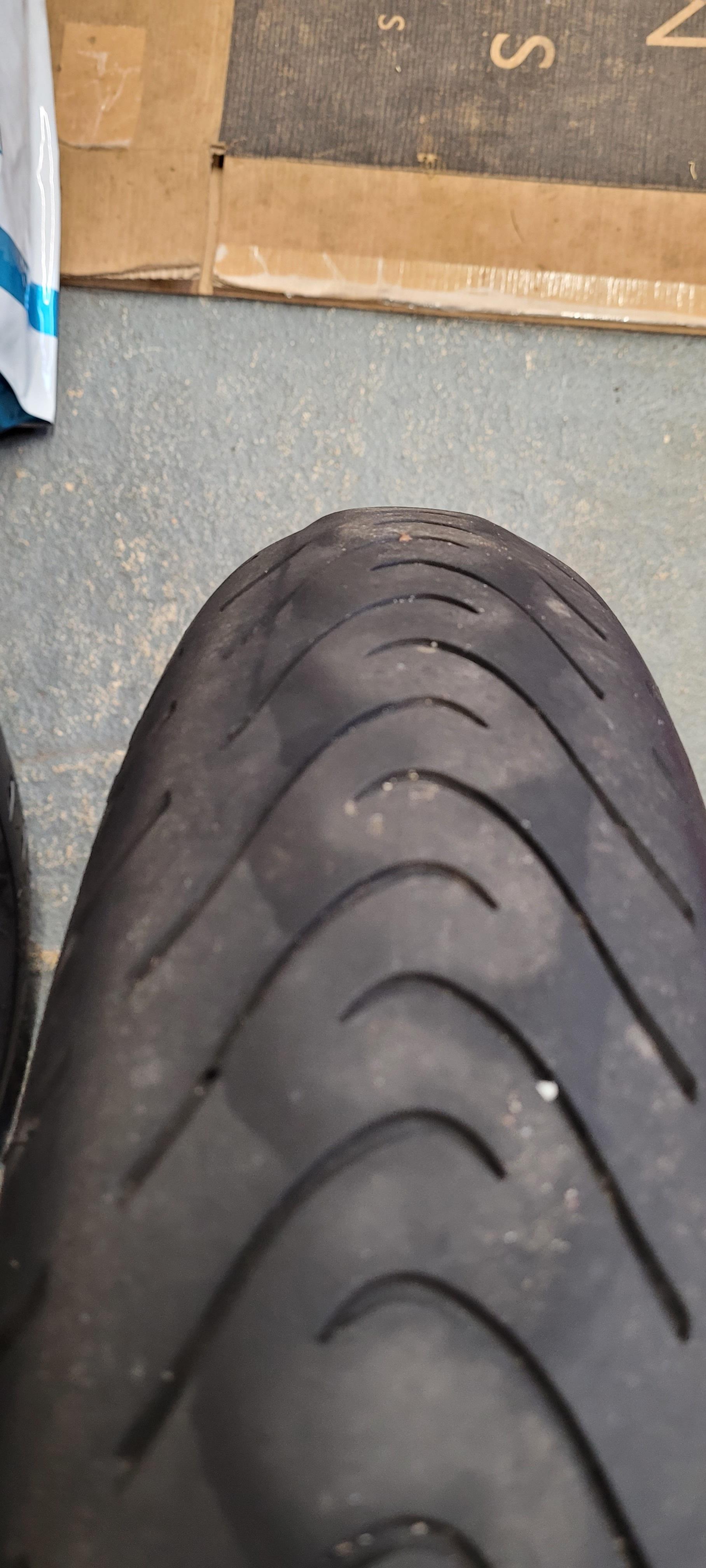

Member Contributer Skids Posted January 4, 2022 Author Member Contributer Share Posted January 4, 2022 7 hours ago, Wald said: 11k miles?! I may try these tires. I have a hard time to get more than 4k miles out of my tires (front or back) This is a picture of my front tire after 3.6k miles. No highway, just backroads. It looks like the alignment was off (and it was off by 20mm) however, the new tire shows the same wear pattern, even with corrected alignment. What tyres are they? Mine are ST-oriented and therefore longer lasting than more sports-oriented tyres but with less dry grip. If yours are sportier, that would explain the difference in mileage available. Being based in the UK, we need to cover all weathers in the same day with our tyres, so wet weather grip is just as important throughout the year. Link to comment Share on other sites More sharing options...
Member Contributer Wald Posted January 5, 2022 Member Contributer Share Posted January 5, 2022 On 1/4/2022 at 1:21 AM, Skids said: What tyres are they? Mine are ST-oriented and therefore longer lasting than more sports-oriented tyres but with less dry grip. If yours are sportier, that would explain the difference in mileage available. These are Continental Motion, a budget ST tire. It came with the bike, so I gave it a shot. Surprisingly, it sticks really well and warms up quick, even in 40 deg F weather. One really good property is, these are not sensitive to tar snakes at any temperature. As for rain, only rode in the rain few times, it was ok but I would not qualify to make a judgement. In the reviews I have seen, most riders get around 8k miles. Since I do not tour, just rip around on backroads, it may explain the rapid wear. Link to comment Share on other sites More sharing options...
Member Contributer ducnut Posted January 5, 2022 Member Contributer Share Posted January 5, 2022 1 hour ago, Wald said: These are Continental Motion, a budget ST tire. It came with the bike, so I gave it a shot. Surprisingly, it sticks really well and warms up quick, even in 40 deg F weather. One really good property is, these are not sensitive to tar snakes at any temperature. As for rain, only rode in the rain few times, it was ok but I would not qualify to make a judgement. In the reviews I have seen, most riders get around 8k miles. Since I do not tour, just rip around on backroads, it may explain the rapid wear. Interestingly, I tried a set of those on a Tiger 1050. With Traxxion Dynamics AK-20’s in the forks and a Penske, the front still cupped to heck. Link to comment Share on other sites More sharing options...
