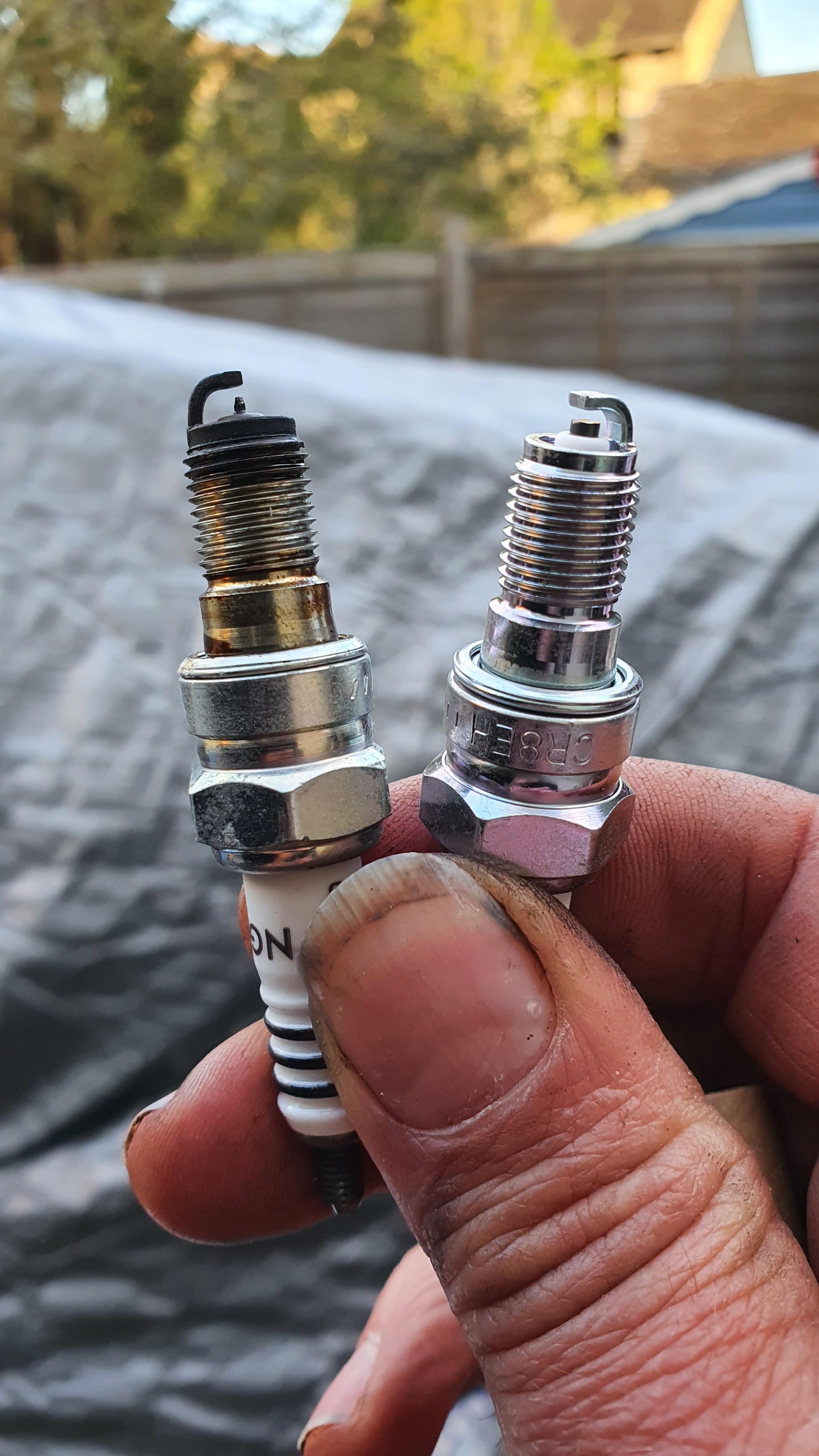

moroseduck Posted April 13, 2021 Posted April 13, 2021 Hey folks, beginner questions here but we all have to start somewhere, right? Changed my rear spark plugs today, and they were oily, and the electrode was very thin. Also some oil visible around where they screw in. The bike is (well, was) running well with no starting issues or lumpiness so should I just leave well be and check my plugs regularly, or is action needed? Secondly, with regards to the front plugs the Haynes manual says to unbolt bottom fixing of radiator and swing forwards to "improve" access. Is this a joke, there's no way I'm getting a plug out of that gap, thinking I'll have to unbolt and pull radiator fully forwards, or am I just being a chump? All help much appreciated 😁 Quote
Member Contributer Dutchy Posted April 13, 2021 Member Contributer Posted April 13, 2021 Oily doesnt mean the plugs are bad. But since you already bought new ones, you might as well fit them Check the partnumber on the plugs. My bet is the left one is an irridium one... My guess based on have bought irridiums for my VFR They should last some 25k km's... I changed them because the bike had an unknown service history when I got it and had stood idle for 4-5 years As for the front radiator, if I can, so can you... I used a wooden wedge, tapped it between radiator and engine head.... But if not comfortable with that, unbolt the lot Torque them at 12Nm. 1 1 Quote
Member Contributer DannoXYZ Posted April 13, 2021 Member Contributer Posted April 13, 2021 Yes, easiest to remove entire engine 1st. Then replacing plugs is simple. 4 Quote
moroseduck Posted April 14, 2021 Author Posted April 14, 2021 4 hours ago, Dutchy said: Oily doesnt mean the plugs are bad. But since you already bought new ones, you might as well fit them Check the partnumber on the plugs. My bet is the left one is an irridium one... My guess based on have bought irridiums for my VFR They should last some 25k km's... I changed them because the bike had an unknown service history when I got it and had stood idle for 4-5 years As for the front radiator, if I can, so can you... I used a wooden wedge, tapped it between radiator and engine head.... But if not comfortable with that, unbolt the lot Torque them at 12Nm. Iridium plugs! That makes me feel much better, never seen one before but that's obviously what they are. Follow up question then, having read that Iridium plugs are longer lasting and can offer better performance, but not necessarily with older vehicles, would I be better putting in the new copper plugs or putting back the old Iridium ones? They've probably done a couple of thousand miles at most. As far as the radiator goes, I'll give it another go and try and be a bit braver about shoving it out the way. Unless of course your answer to the above question is stick with the Iridium, in which case problem solved! Thanks for the help, much appreciated 🙂 Quote

moroseduck Posted April 14, 2021 Author Posted April 14, 2021 Some great advice and information here, thanks folks. I think at this point I'm going to stick the original iridiums back in. They look pretty and good haven't had many miles on them - I've done fewer than 3000 since 2013 when she had a major service and these were probably fitted, and it gets me around the issue of getting at the front plugs. Also, as mentioned above, the bike was running very nicely as she was. I'll keep the coppers I've got for next time, or if I run into problems. 2 Quote

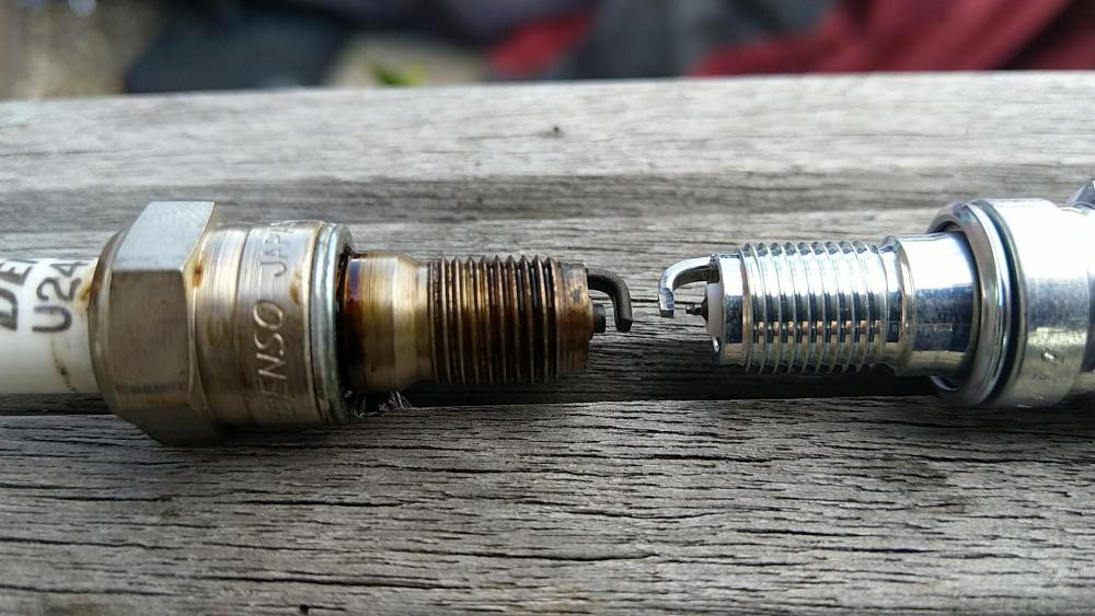

Magneto Posted April 16, 2021 Posted April 16, 2021 Since we open up and stuff, I was a victim of counterfeit Iridium plugs sold under Denso brand. Everything was made to look legit down to OEM major brand paper boxes. Bad guys went for all the trouble but adding Iridium, skinny tip was gone in no time. Buyer be aware.... Quote
Member Contributer jefferson Posted April 16, 2021 Member Contributer Posted April 16, 2021 Were those amazon purchases or from a parts store? Quote
Magneto Posted April 16, 2021 Posted April 16, 2021 HThe Online purchase before I wise up to possibility of someone counterfeiting spark plugs. Blow was also to myself not being able to tell them apart from genuine ones. Even now after I studied the issue only one telltale is bluish hue on original electrode of new plug. Of course this hue is gone after some time in service... look at my avatar picture it shows the hue. Quote
