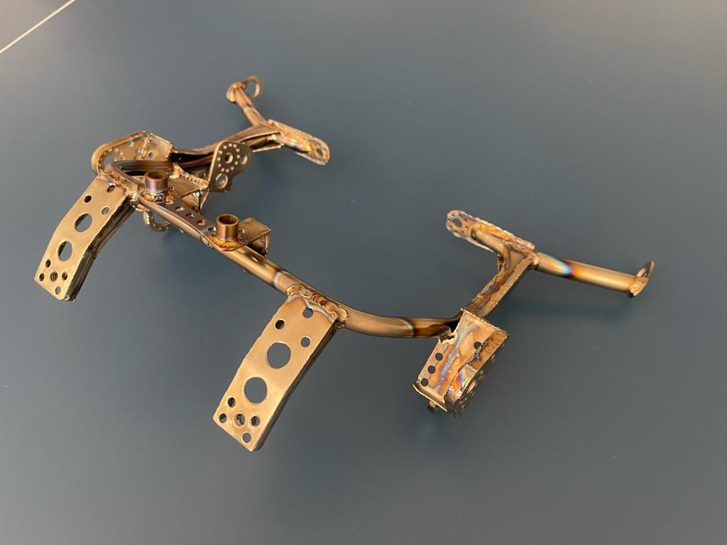

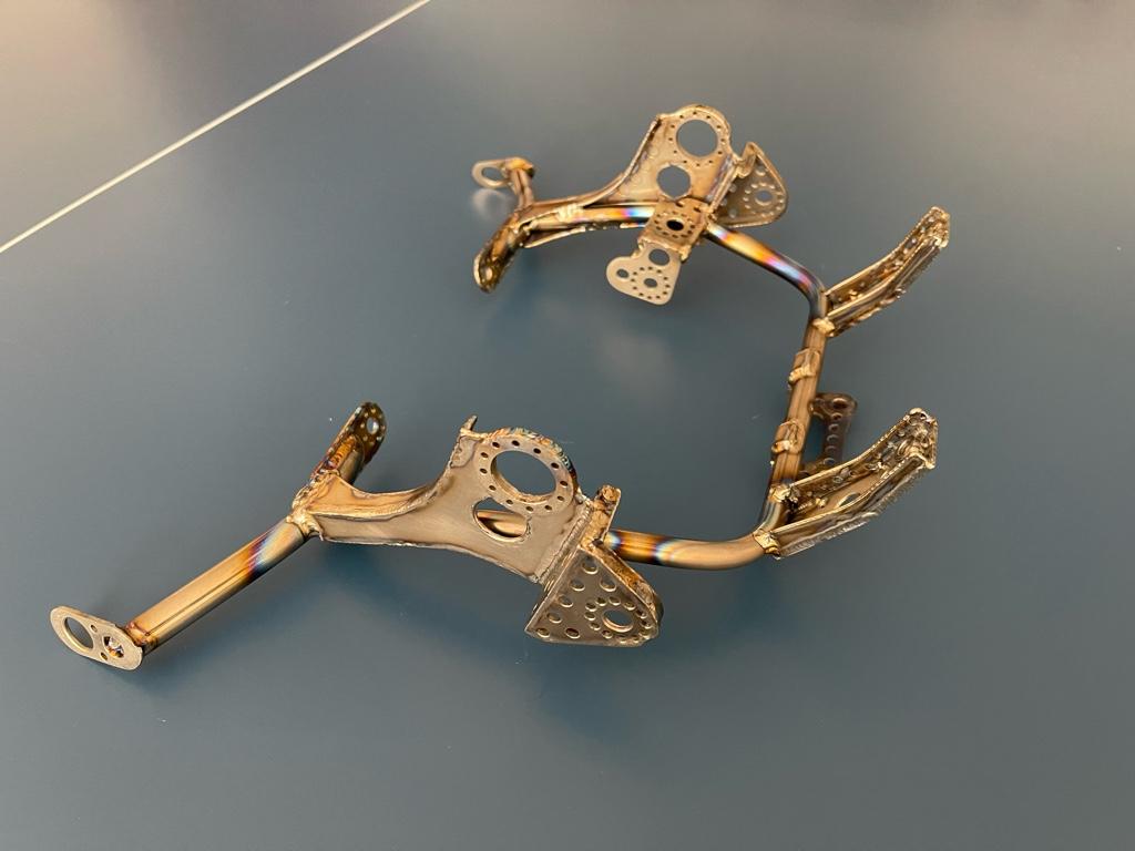

Member Contributer jefferson Posted August 5, 2022 Author Member Contributer Share Posted August 5, 2022 Pictures of the ti ZRX fairing mount. Quote Link to comment Share on other sites More sharing options...

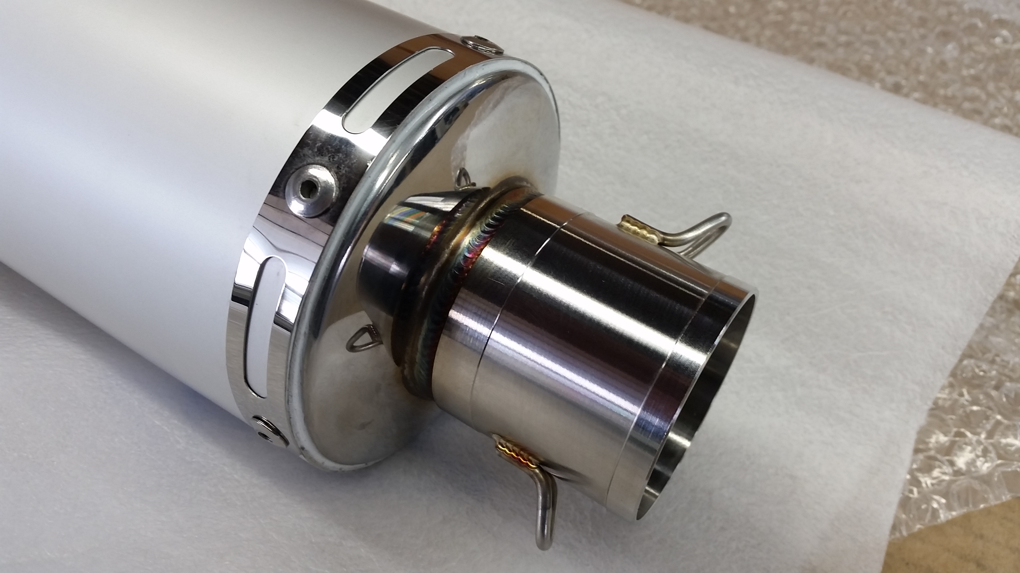

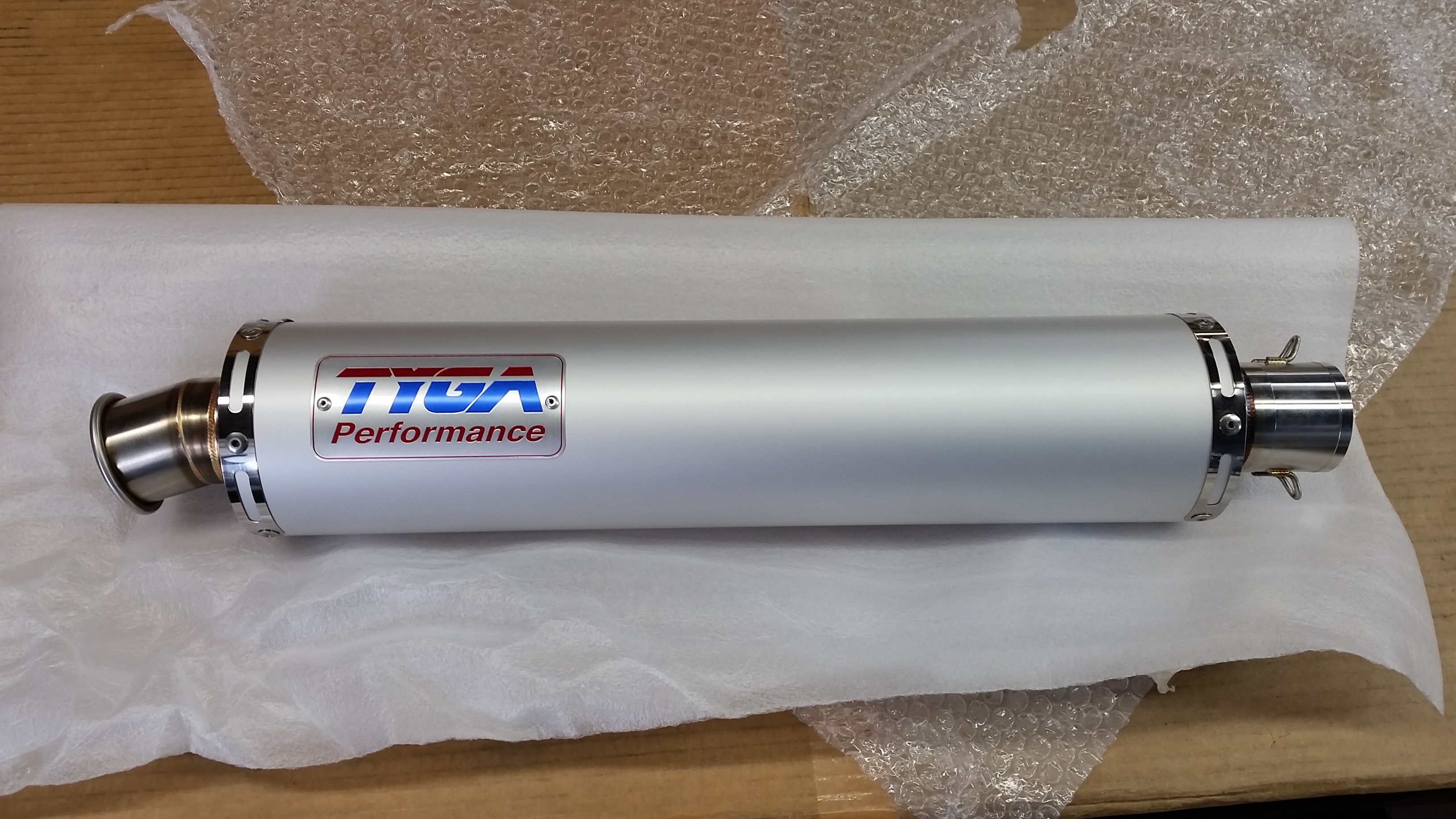

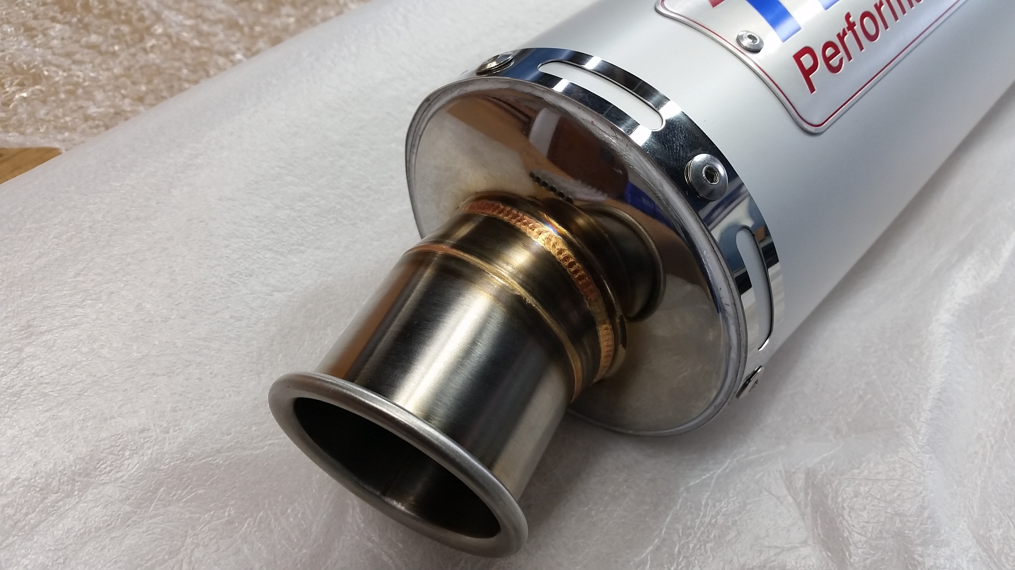

Member Contributer Tirso Posted August 5, 2022 Member Contributer Share Posted August 5, 2022 A few days ago saw that Tyga has a stainless header with RH exit that's available for 3rd gen VFR. Likely lighter than stock and better performing. Looks prettier! Tyga Header for 3rd Gen VFR I don't own any Tyga but hear they produce quality stuff. Maybe others will have first hand experince. 1 Quote Link to comment Share on other sites More sharing options...
Captain 80s Posted August 5, 2022 Share Posted August 5, 2022 55 minutes ago, Tirso said: A few days ago saw that Tyga has a stainless header with RH exit that's available for 3rd gen VFR. Likely lighter than stock and better performing. Looks prettier! Tyga Header for 3rd Gen VFR I don't own any Tyga but hear they produce quality stuff. Maybe others will have first hand experince. I don't have any first hand experience with their full systems, but I did buy a muffler for the RC26. It is well made, very pretty and sounds great. I have heard nothing but positive things about their products, and my experience agrees. A member on another forum tricked out a RVF400. He only buys and installs top shelf items and he is a repeat Tyga customer. 1 1 Quote Link to comment Share on other sites More sharing options...
Member Contributer ducnut Posted August 5, 2022 Member Contributer Share Posted August 5, 2022 Yep. Tyga is all quality stuff. Quote Link to comment Share on other sites More sharing options...
Member Contributer jefferson Posted August 5, 2022 Author Member Contributer Share Posted August 5, 2022 1 hour ago, Tirso said: A few days ago saw that Tyga has a stainless header with RH exit that's available for 3rd gen VFR. Likely lighter than stock and better performing. Looks prettier! Tyga Header for 3rd Gen VFR I don't own any Tyga but hear they produce quality stuff. Maybe others will have first hand experince. I also really like the fact that they have replacement panels to take the place of the factory panels that don't fit with their exhaust, even one in carbon. The killer for me is no center stand. There's no doubt it would be lighter and have to make more power than the collector stock system. Quote Link to comment Share on other sites More sharing options...
Member Contributer Tirso Posted August 5, 2022 Member Contributer Share Posted August 5, 2022 1 hour ago, jefferson said: I also really like the fact that they have replacement panels to take the place of the factory panels that don't fit with their exhaust, even one in carbon. The killer for me is no center stand. There's no doubt it would be lighter and have to make more power than the collector stock system. Curious to why no center stand is a deal breaker. I removed the center stand from my 5th gen, dropped about 7lbs and don't miss it. But, I have an Abba Skylift and a vintage TBR rear wheel stand modified for my Ducati hub. Tyga also sells a saucy racing step kit. You 3rd and 4th gen guys get all the cool toys. 1 Quote Link to comment Share on other sites More sharing options...

Member Contributer RC1237V Posted August 13, 2022 Member Contributer Share Posted August 13, 2022 That fairing mount is quite the piece, and the price is probably about the same as a nice 3rd gen. Aluminum is lighter than Ti and easier to work with. Neither would remain straight after a crash, so I would just have one made from aluminum. The VFR fairing mount has a ton of twists and turns, so not gonna be cheap to replicate. The rear subframe however, is very simple in comparison, and could be made from aluminum as well. While you're at the machine shop, have them make one of these for you too.... 1 Quote Link to comment Share on other sites More sharing options...
Member Contributer jefferson Posted August 14, 2022 Author Member Contributer Share Posted August 14, 2022 Looks like someone is ahead of me on that, but it's probably for one of the RC's other than the 36. Quote Link to comment Share on other sites More sharing options...
Member Contributer RC1237V Posted August 15, 2022 Member Contributer Share Posted August 15, 2022 Actually it's for an MV Agusta... might make one for my 3rd gen, so I can run the Ducati spindle, single nut, and forged wheel. 😉 Quote Link to comment Share on other sites More sharing options...
Member Contributer RC1237V Posted August 15, 2022 Member Contributer Share Posted August 15, 2022 There is also this one for the VFR400/RVF400 1 Quote Link to comment Share on other sites More sharing options...

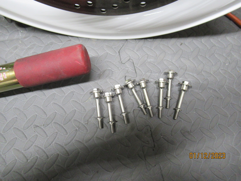

Member Contributer jefferson Posted October 11, 2022 Author Member Contributer Share Posted October 11, 2022 Got a .22 weight savings with a few more aluminum and ti bolts. I know of at least 11 more to address and then there are the bolts already in my possession that aren't on the bike due to not having it torn down enough to get to them. My total so far is 23.28 lbs lost I have the front end off the 96 and the rest of the bike sold. The front wheel is apart for aluminum spacers, hybrid ceramic bearings and new seals and the wheel had a couple of spots that needed weld built up and then smoothed out before powder coating. The weight of the wheel with rotors and all spacers was 17.03 lbs. I'll weight it again when it's time to go on and I also want to compare it to the stock 93 wheel. The lower triple is 3.22 lbs and when I get things torn apart will see how much lighter it is than the 93 triple. Battery weighs 9.72 lbs. Shorai shows a 14 amp hour battery that weighs 2.8 lbs, but the 18 amp hour battery weighs 2.3 lbs. Can't get anyone at Shorai to return my call to confirm those weights. I weighed the lug wrench as I have some plans for it and it's part of the weight of the bike unless you do away with it. It weighed .65 lbs. I also have seen ti tools to replace those in the tool kit, but just not there on those yet. I did do a couple of hundred mile ride the other day and was very pleased to log 52.8 mpg with speeds ranging from 65 to 75. Maybe it will get better the more weight I take off as it is the enemy of performance Quote Link to comment Share on other sites More sharing options...

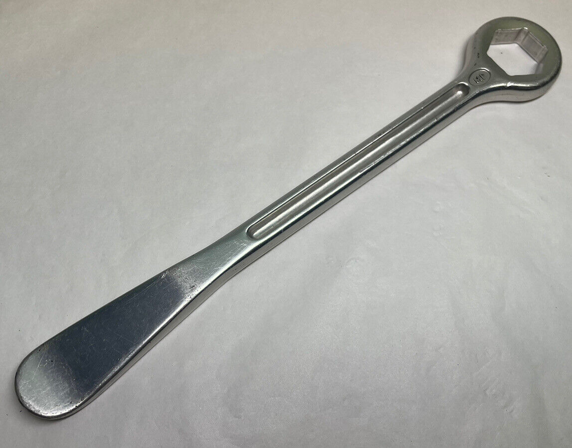

Member Contributer jefferson Posted October 19, 2022 Author Member Contributer Share Posted October 19, 2022 Got the wheel back from being welded and got everything smoothed out and looking good for powder coating. The aluminum spacers he made are .32 of a lb. lighter. Not going to figure the weight in as I will weigh the front wheel as an assembly. Need to source some hybrid ceramic bearings and get some new seals too. I guess my reply to you didn't go through RC. I already have a ti axle and nut on the bike. I like those speedwell batteries, but don't want to change all the connections. The Shorai will drop right in and hook up. For the lug wrench I'm thinking of replacing the handle with cromoly tubing since it will still slip into it's recess with that mod. Quote Link to comment Share on other sites More sharing options...
3rdgenred Posted October 20, 2022 Share Posted October 20, 2022 3 hours ago, jefferson said: ...For the lug wrench I'm thinking of replacing the handle with cromoly tubing since it will still slip into it's recess with that mod. While doing this, are you going to create a bracket to hold that tool? Quote Link to comment Share on other sites More sharing options...
Member Contributer jefferson Posted October 20, 2022 Author Member Contributer Share Posted October 20, 2022 I'm not changing anything except what the handle is made of and it will still sit in the recess that it sits in now. Quote Link to comment Share on other sites More sharing options...

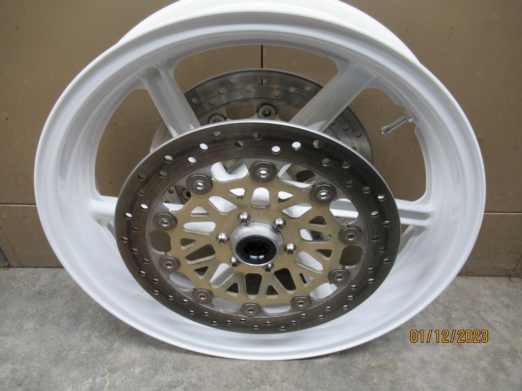

Member Contributer jefferson Posted January 13 Author Member Contributer Share Posted January 13 The front wheel is powder coated and all together with ti disc bolts, aluminum spacers, and hybrid ceramic bearings. The assy. was .35 lb. lighter than stock. Component savings should have been .46 lb. so the powder coating ending up being .1 lb. heavier. The Ti cam cover bolts have been here since my Birthday. The Ti caliper rebuild kits are somewhere awaiting the UK mail debacle to be over so they can be on their way. I was pulling the lowers off the 4th gen forks when one of the allens in the bottom stripped out so I guess it will take some careful drilling to get the head off the bolt. Always something. I also kept the tailight and rt rear turn signal off the bike and decided they would look alot better with all the lettering removed from the lenses. They really do look alot better. Now I just need a left rear signal so I can put them on the bike. I have found one, but I just can't talk myself into paying what they want for it. To me they should be around $25 and they want over double that. I'm in no hurry 1 Quote Link to comment Share on other sites More sharing options...

Member Contributer jefferson Posted January 13 Author Member Contributer Share Posted January 13 Well I got the tire mounted on the new wheel so I could then weigh the old wheel. My scale didn't go that high and showed me an error so I had to take things apart and weigh them separately. I looked at the weight of the new wheel and thought this is going to be good. Stock to stock we have 21.14lbs. versus 17.03 which is 4.11lb difference. I was shocked. Never thought there would be that much difference. Well worth doing. With the lighter components there was an additional weight savings of .35 lb. for a total of 4.46 lbs saved. The new wheel has 2 wheel weights on it also that the old wheel didn't have. I may try spinning the tire and rebalancing to get rid of those. Now to do some drilling on the fork tube bolt! Quote Link to comment Share on other sites More sharing options...
