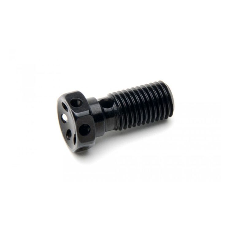

Member Contributer RC1237V Posted February 16, 2021 Member Contributer Posted February 16, 2021 Wow, I didn't know they made aluminum banjo bolts, I thought they were only steel, stainless, or Ti. 2 Quote
Member Contributer DannoXYZ Posted February 16, 2021 Member Contributer Posted February 16, 2021 Cool! Pre-drilled for safety-wire too! 🙂 Up to 6.66 lbs weight-savings now! Quote

Member Contributer jefferson Posted February 23, 2021 Author Member Contributer Posted February 23, 2021 On 2/15/2021 at 8:34 PM, RC1237V said: Wow, I didn't know they made aluminum banjo bolts, I thought they were only steel, stainless, or Ti. Spiegler is what I have on the other bikes. This one kind of intrigues me, but I can't find it in a search. Who is it that makes this one? Quote
Member Contributer RC1237V Posted February 24, 2021 Member Contributer Posted February 24, 2021 https://www.revzilla.com/motorcycle/spiegler-anodized-aluminum-banjo-bolt-for-safety-wire?sku_id=1180022 Quote
Member Contributer jefferson Posted February 24, 2021 Author Member Contributer Posted February 24, 2021 Well Spiegler didn't have those the last time I bought some. Now I don't have to worry about ordering from 2 different places. Quote
