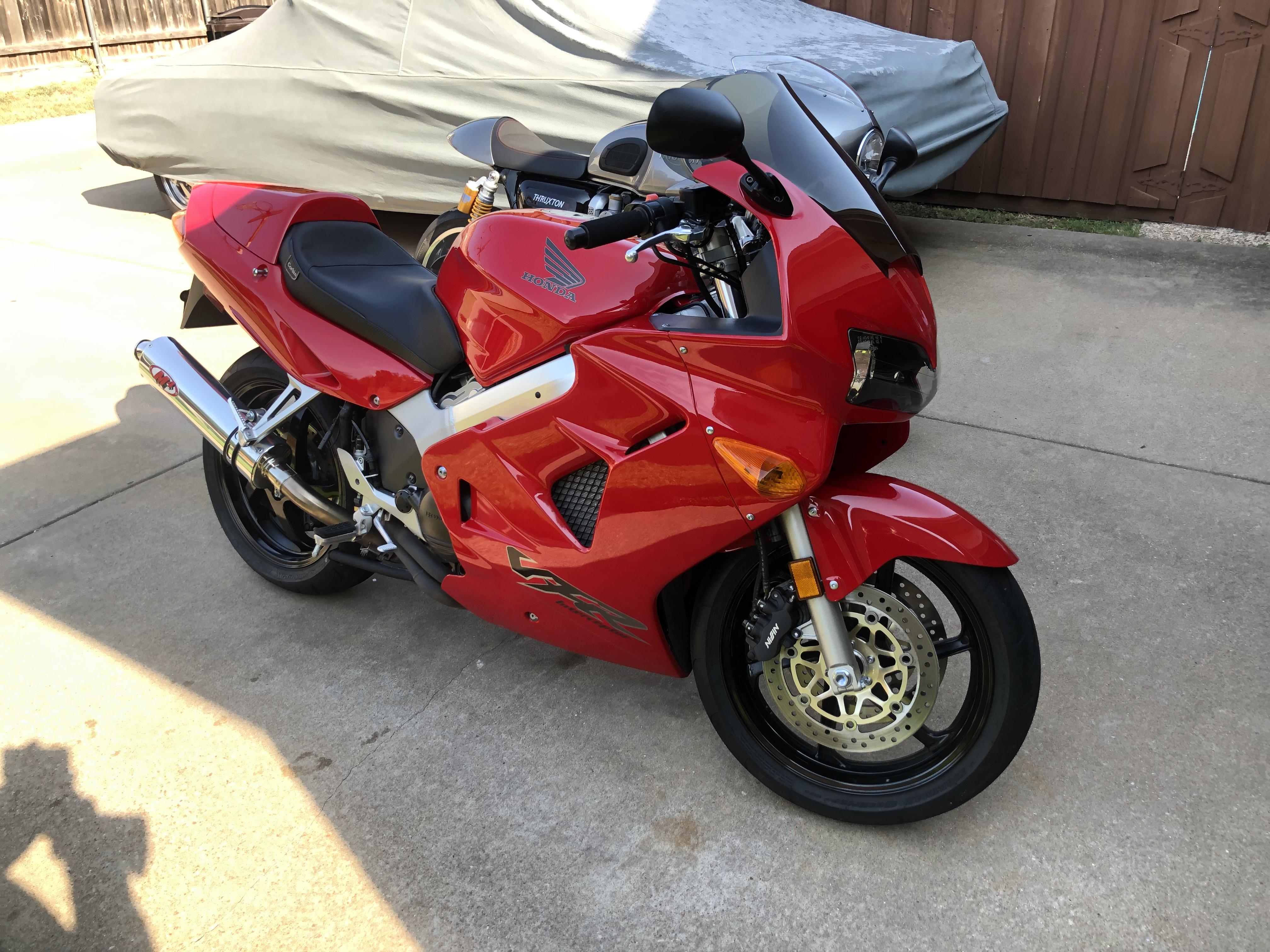

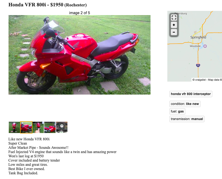

simontan Posted September 10, 2019 Author Posted September 10, 2019 Thanks again for the replies so far! Here are pics from the sale posts for the two bikes I'm looking at. First is the garage queen and second is the one with 35k miles. Garage queen has some nice add-ons like, Corbin seat, M4 pipe and windscreen, but the other one has fresh tires, chain, and sprocket along with an updated R/R unit with voltmeter. Anyone know what kind of pipe is on the second one? Also, do these bikes need a Power Commander when fitted with aftermarket pipes? The newer Triumph I have now auto adapts. Quote
GreginDenver Posted September 10, 2019 Posted September 10, 2019 wow, that '01 5th Gen is beautiful. Quote
mello dude Posted September 10, 2019 Posted September 10, 2019 Kinda drooling over the garage queen '01........ Quote
Member Contributer RDMcD Posted September 10, 2019 Member Contributer Posted September 10, 2019 Both are very nice. As said by others, don't be afraid of a little mileage. The exhaust is a Chinese danmoto I believe. Quote

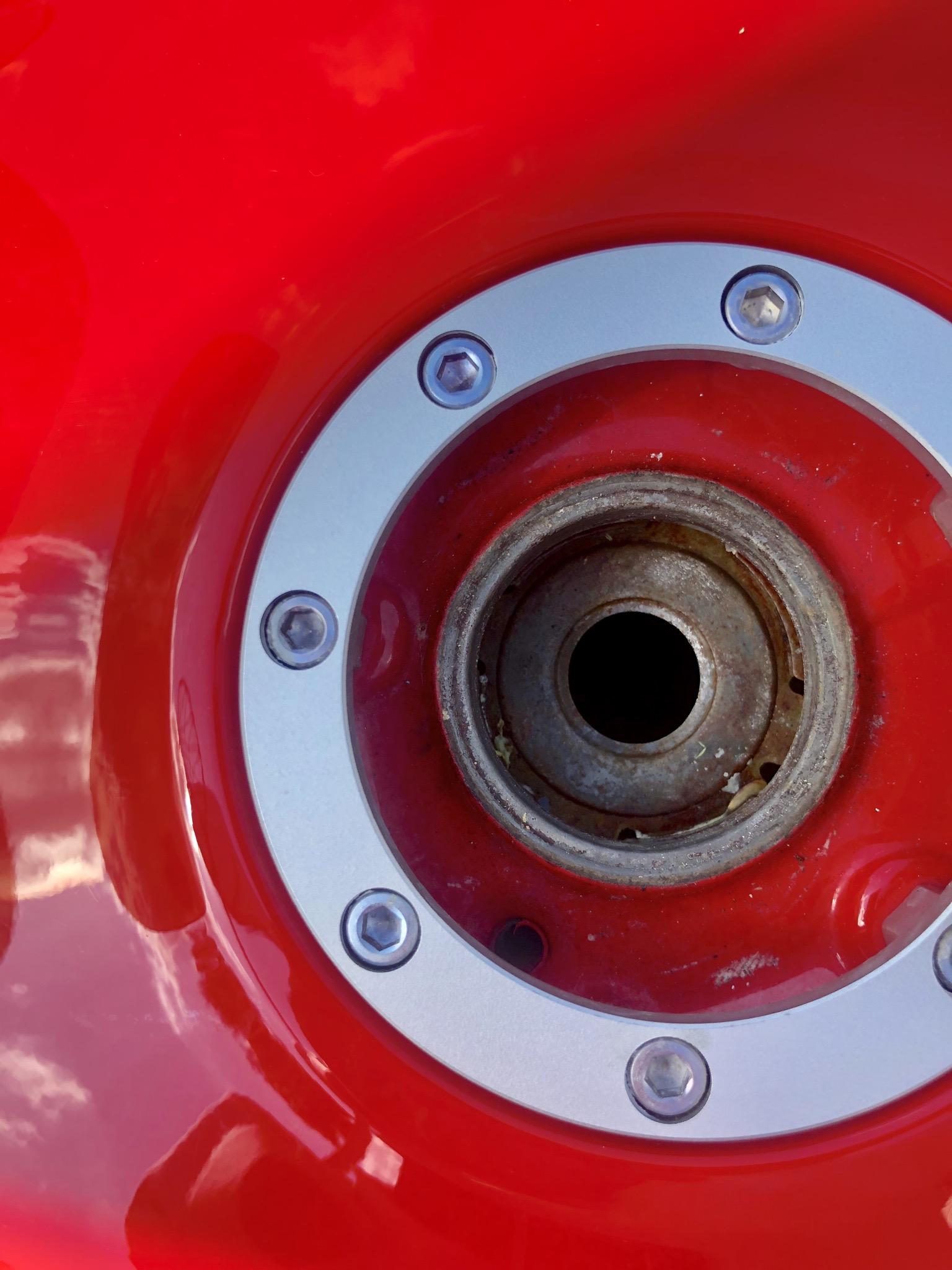

simontan Posted September 10, 2019 Author Posted September 10, 2019 So I just came back from looking at the Garage Queen and it looks like a time capsule. The plastics and even the LCD screen on the instrument panel still look new without a trace of fading or wear or scratching. Started instantly from cold and idled and revd smoothly. The front tire is original (!) and the rear is about 8 years old. No signs of dry rot or cracking at all but I guess they have to go at that age. The concerning thing though is the gas tank looks like this under the cap. Tried to shine my smartphone flashlight inside and didn’t see any rust inside the tank just around the rim right under the cap as seen in the pic. How serious is this? Quote
Member Contributer Cogswell Posted September 10, 2019 Member Contributer Posted September 10, 2019 I've seen another 5G with the constricted tank opening like that one - on my 99 the opening is the same size as where the cap seals, so it's much easier to see inside. There must have been 2 variants made depending on what market they went to or possibly that changed somewhere in the production run - who knows. The visible rust seems minor - but it does point to the possibility that more lurks inside - the question is how much. Probably the only way to know would be to use a camera and with the tank empty look directly inside. Harbor Freight sells one for about $80. I would at least use that as a negotiating point. If you have to remove (and possibly replace) the fuel pump / filter to clean and seal the tank it will run in to some money. If the price is good enough you're getting an otherwise minty bike that if required it may be worth putting some more cash in it. Also consider that might be a DIY project - I've not seen a shop that would undertake that project on a 20 year old machine but it could be out there. YMMV. BTW - how does the brake and clutch fluid look? Quote
Member Contributer stuartb3502 Posted September 14, 2019 Member Contributer Posted September 14, 2019 I’ve just de-rusted my tank so if you want to anything about that, drop me a line. Go along at least with a flashlight which will give you a chance of seeing inside. Ask how they stored the bike. Knowing what I know now, just putting it away long term with fuel in is not the right answer. Not saying you should walk away, but worth knowing that a low miles underused bike is not necessarily a zero issues bike. Other points have been mentioned. The only bits which would be likely to wear out by just sitting will be rubber. So you #might# end up having to replace seals in brakes and clutch (as well as tyres as a precaution), but these are not a big deal. You can only work out if it’s worth paying a big premium for such a low miles bike. If you keep it as low miles, great condition it should hold value reasonably well. If you use it without maintaining it as a garage queen, it will lose more money IMHO than the 35k bike. Stuart 1 Quote
