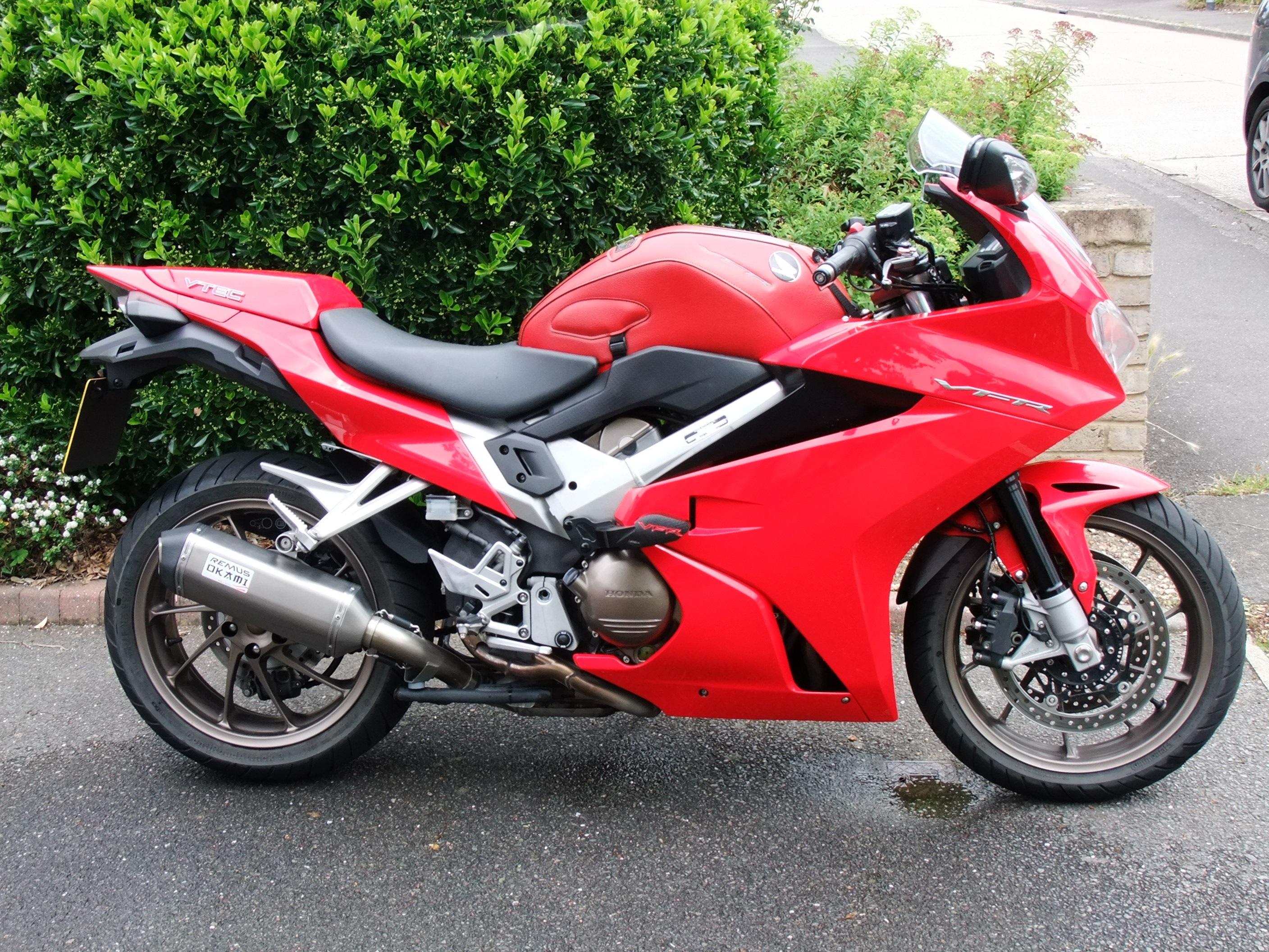

fatshoutybloke Posted June 26, 2019 Posted June 26, 2019 Put back all the brake line brackets and bits I've taken off, de-rusted and resprayed black, then washed it. Looking OK for nearly 5 years old. 3 Quote

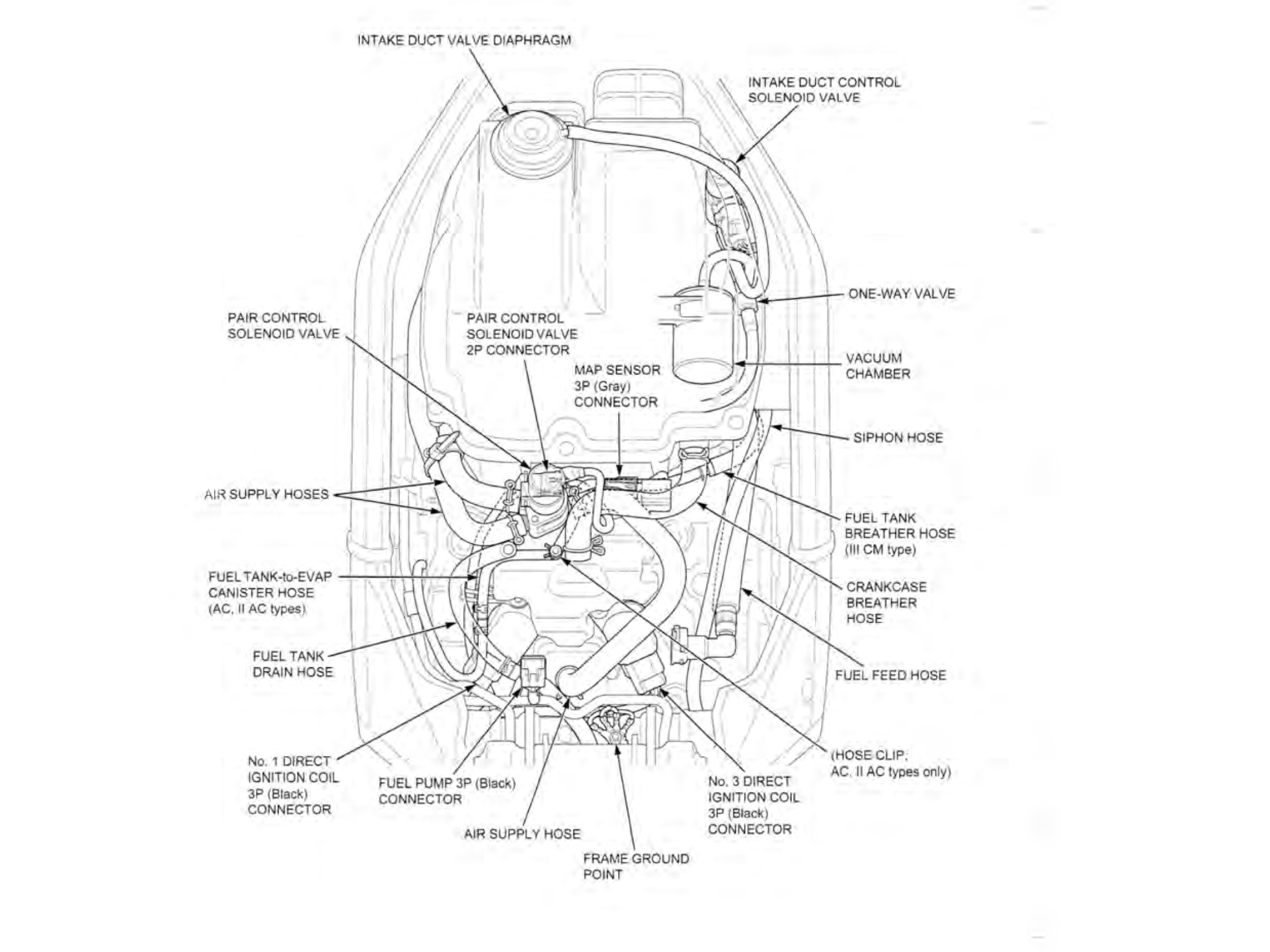

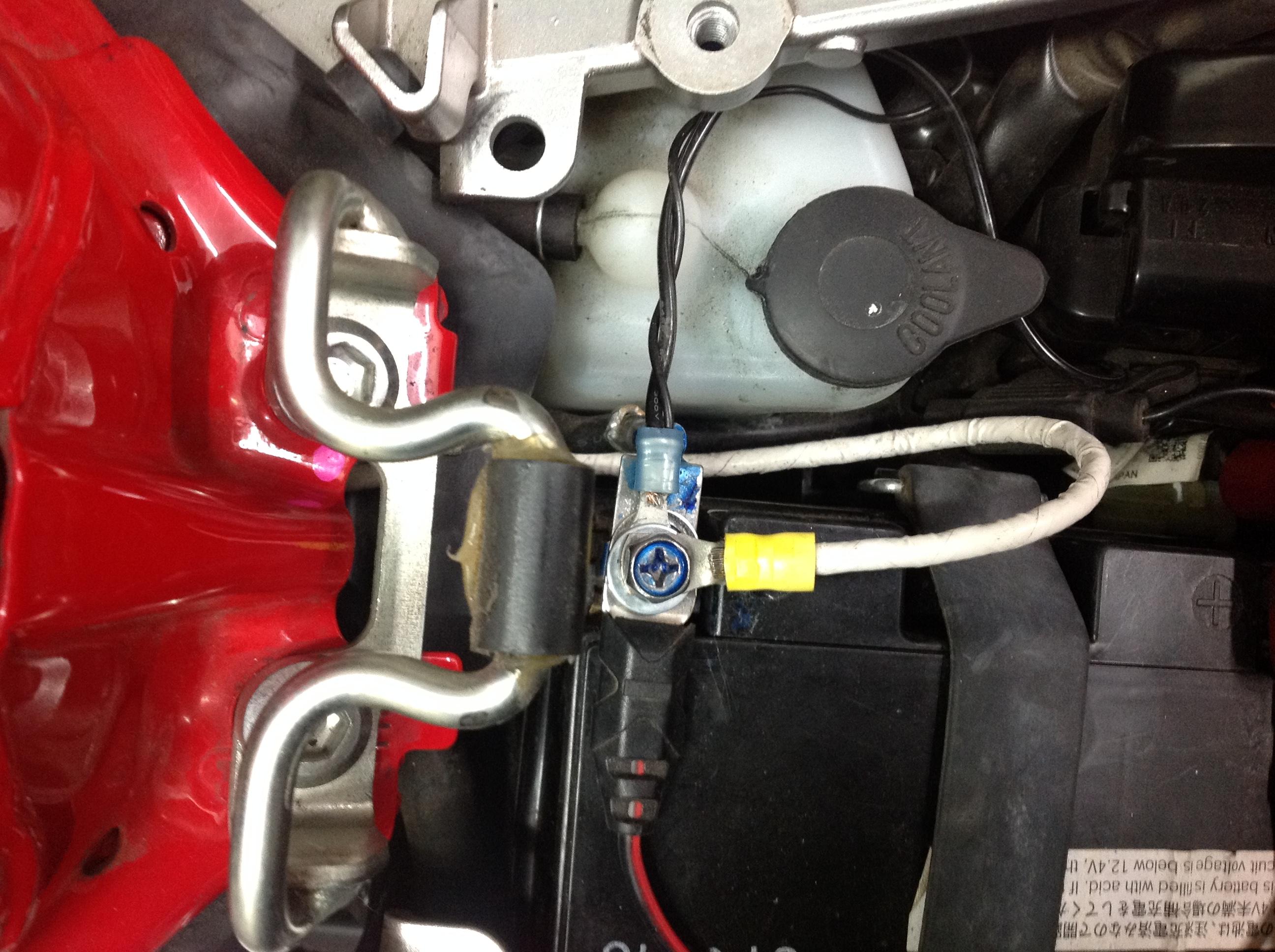

Member Contributer Grum Posted July 13, 2019 Member Contributer Posted July 13, 2019 Due to the cold and crappy weather, had the urge to tinker with the bike. Added a beefy Ground bonding wire, see white wire with yellow lug. Decided to grab a short length of aircraft spec 10gauge wire I had floating around, and install a good bonding cable from the EFI, ECM and stuff Ground point (on the Frame Ground Point just under the rear of the tank - see attached drawing) to the Negative battery terminal. Bad Grounds on bike frames have in the past caused strange things to happen(not with my own bike fortunately) just wanted to avoid that situation ever happening for good. Well, at least it kept me occupied and off the streets for an hour or so Cheers. 2 Quote
