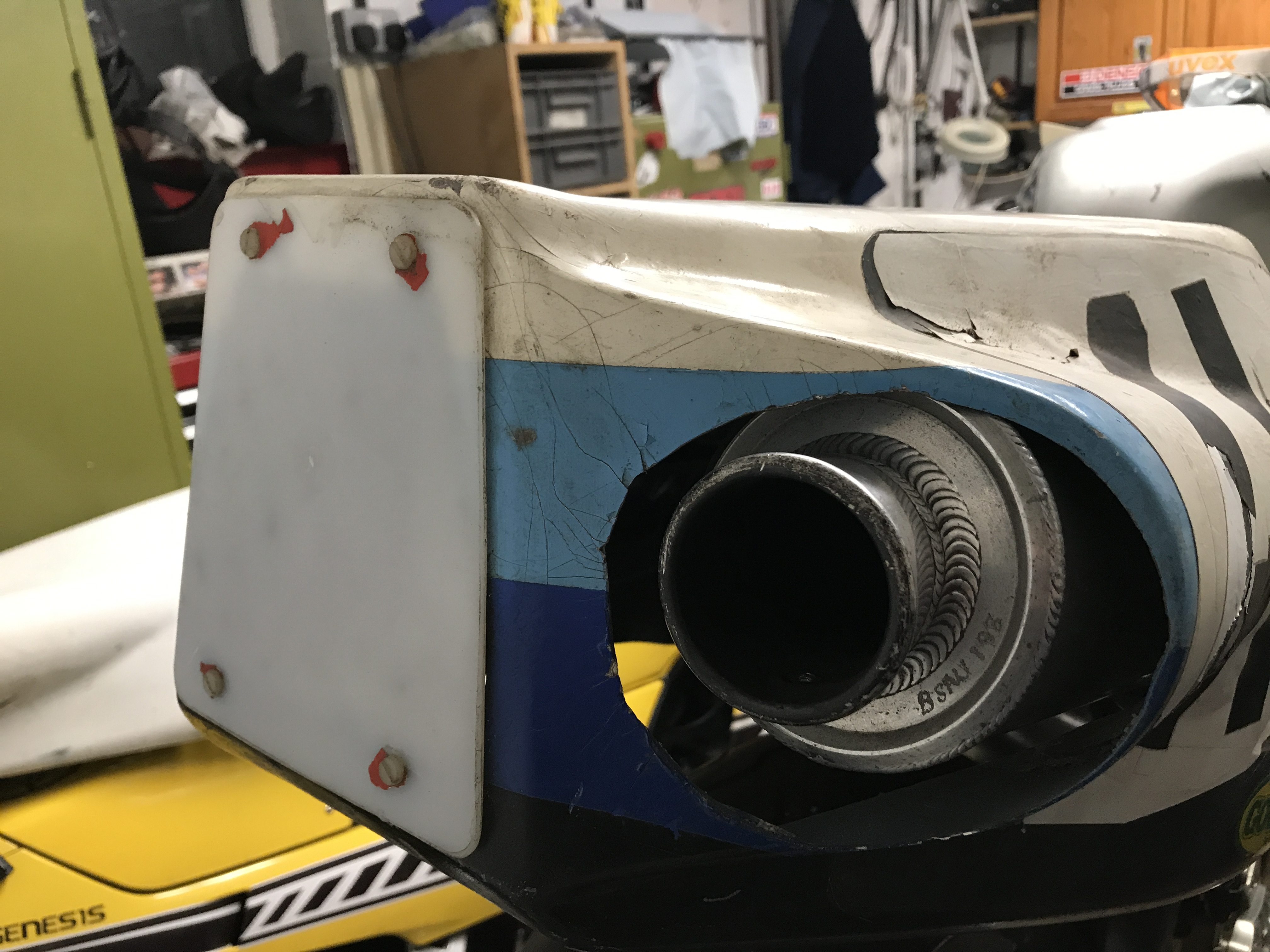

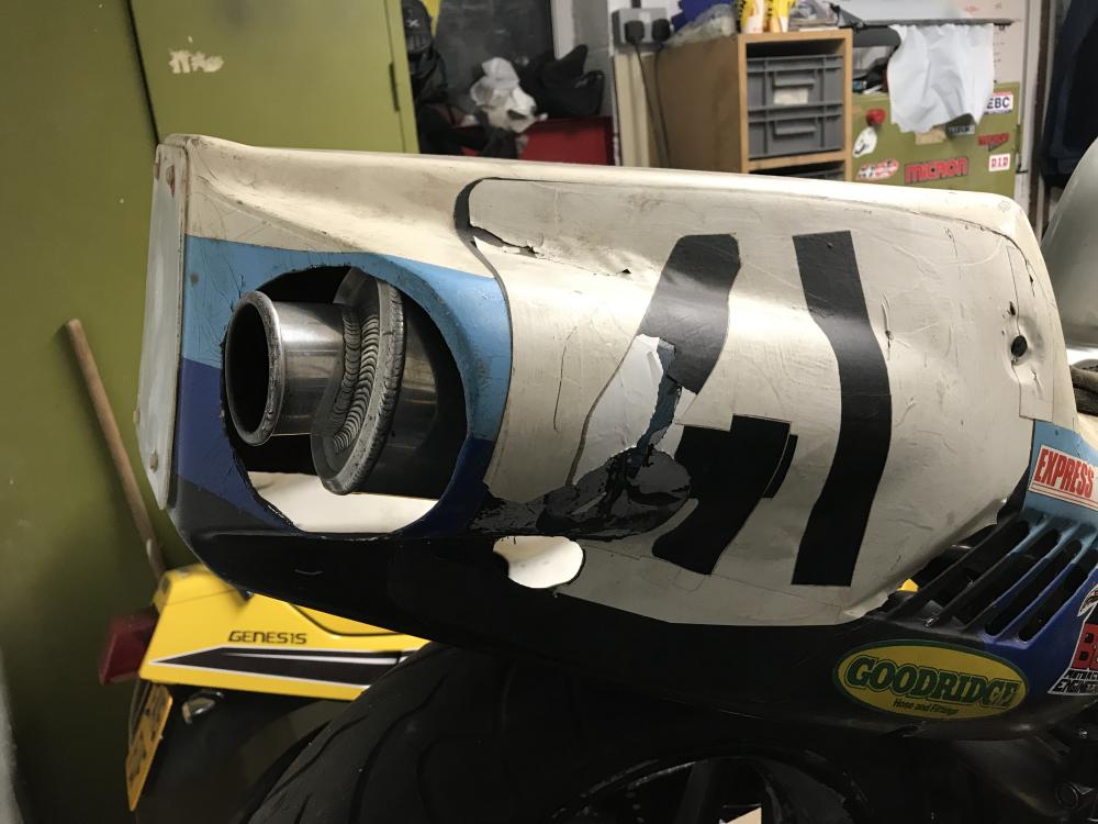

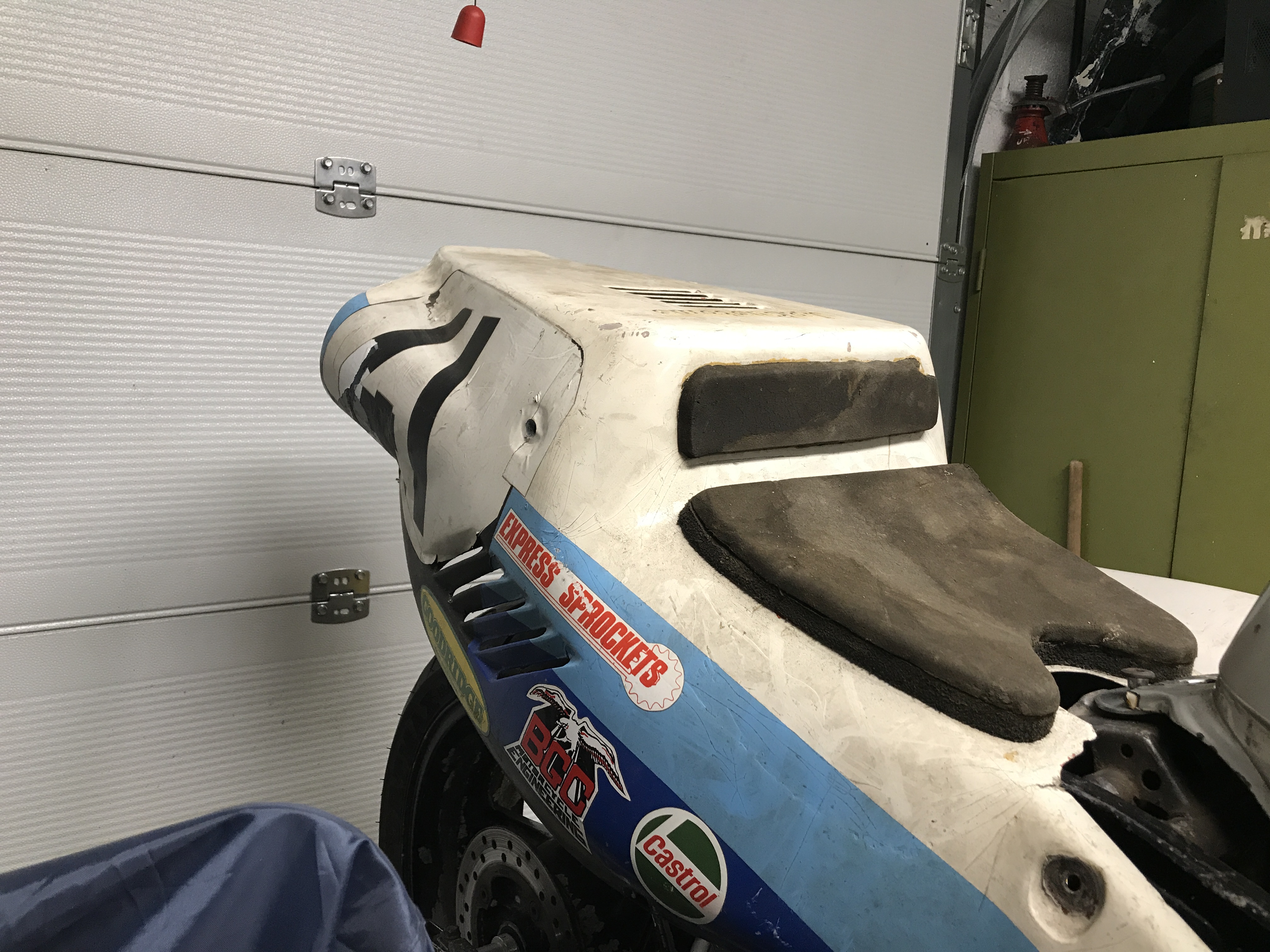

trooper1999 Posted November 20, 2017 Author Posted November 20, 2017 Just a few photos of the seat placed onto the rear of the bike 2 Quote

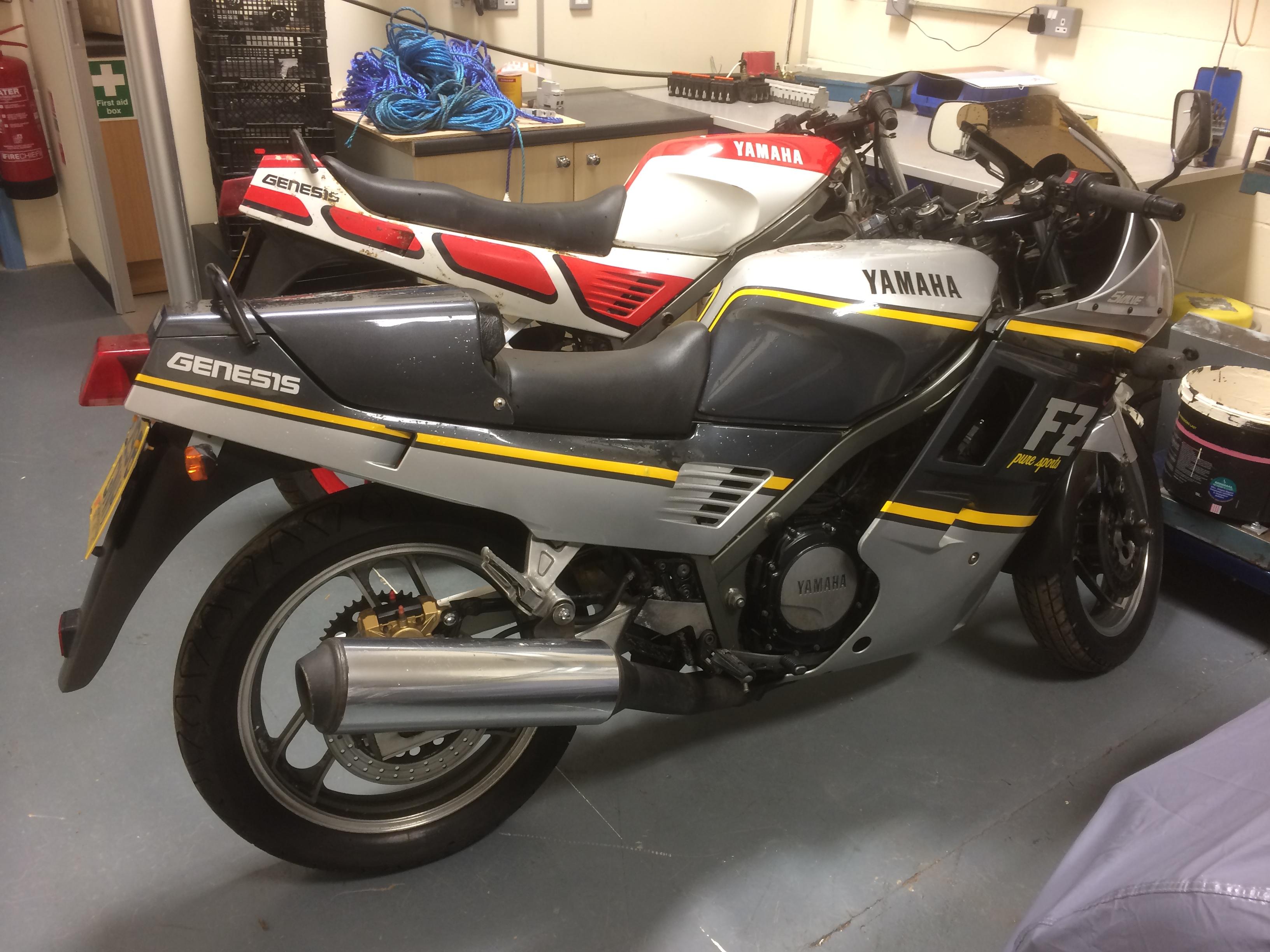

timmythecop Posted November 20, 2017 Posted November 20, 2017 did I spot an FZ750 in bumblebee paint? Quote
trooper1999 Posted November 21, 2017 Author Posted November 21, 2017 Yes for my sins I have these in the garage 1 Quote
keny Posted November 21, 2017 Posted November 21, 2017 56 minutes ago, trooper1999 said: Yes for my sins I have these in the garage No sin to have a few FZ´s arround, I would like one to! Great looking bikes I think! Quote
trooper1999 Posted November 22, 2017 Author Posted November 22, 2017 After A little bit of digging I think I know where my "new" seat started life, i was on Howard Lees Racing RS850 in 1985 see this link http://www.howardleesracing.co.uk/index_files/Page623.htm Quote
Member Contributer Captain 80s Posted November 22, 2017 Member Contributer Posted November 22, 2017 Sure looks like it. Bolt pattern for taillight (LED!!!) matches. So cool!!!!! Quote

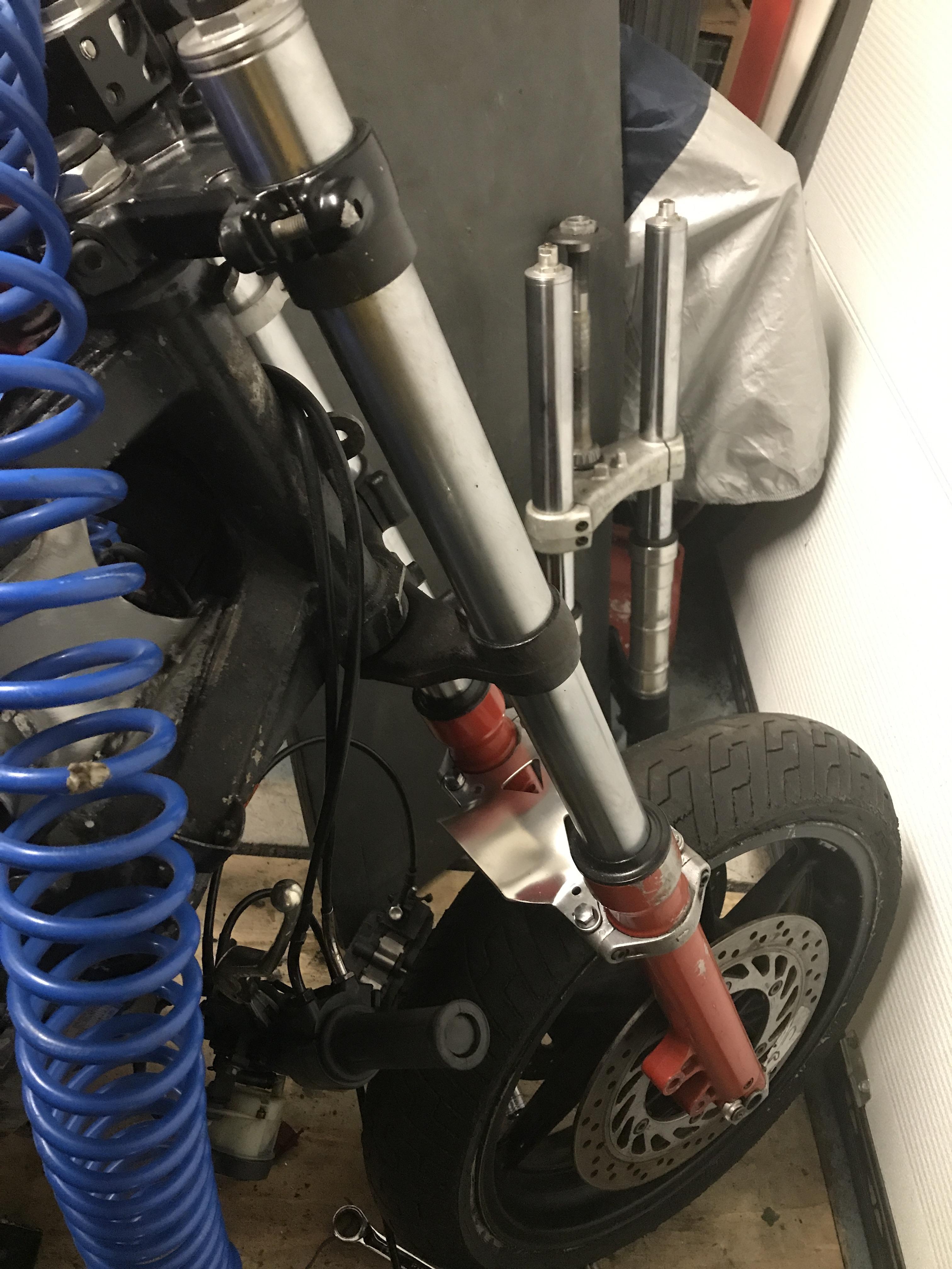

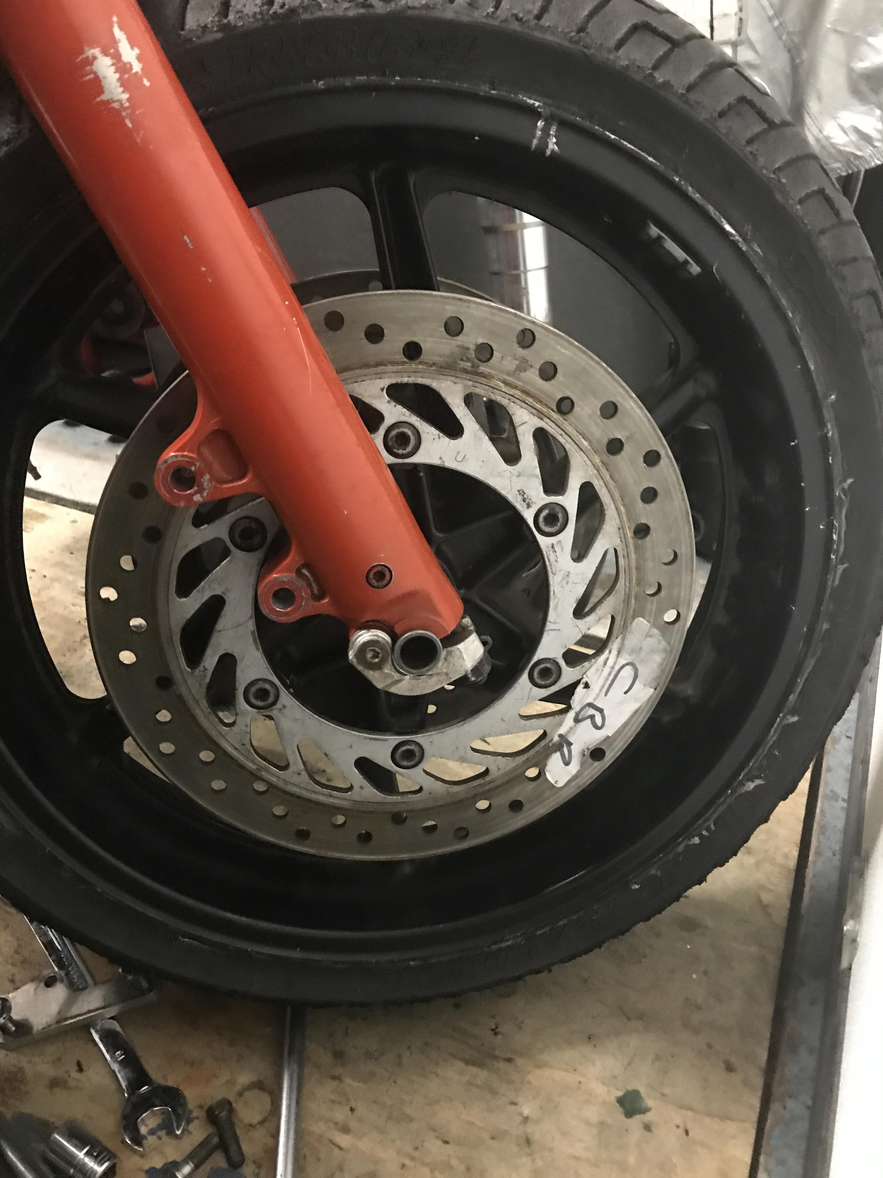

trooper1999 Posted December 4, 2017 Author Posted December 4, 2017 I think I've been bad, I have just bid and won these on evil bay, it will involve JUST a little more work to swap the complete front end AGAIN But they will look a lot better and more in keeping with the time line, so all the work to make the longer steering stem and caliper bracket is now not needed and I will have to make the lot again, hopefully the steering stem will be OK but just got to wait until they are shipped from the USA. 1 Quote
Member Contributer Captain 80s Posted December 5, 2017 Member Contributer Posted December 5, 2017 It will be a bolt-on for the VF750 frame and the steering stops look nearly identical, both on the frames and lower clamps. So, same calipers you had, with some new custom brackets? Gold Valve Cartridge Emulators and eliminate the TRAC? Quote

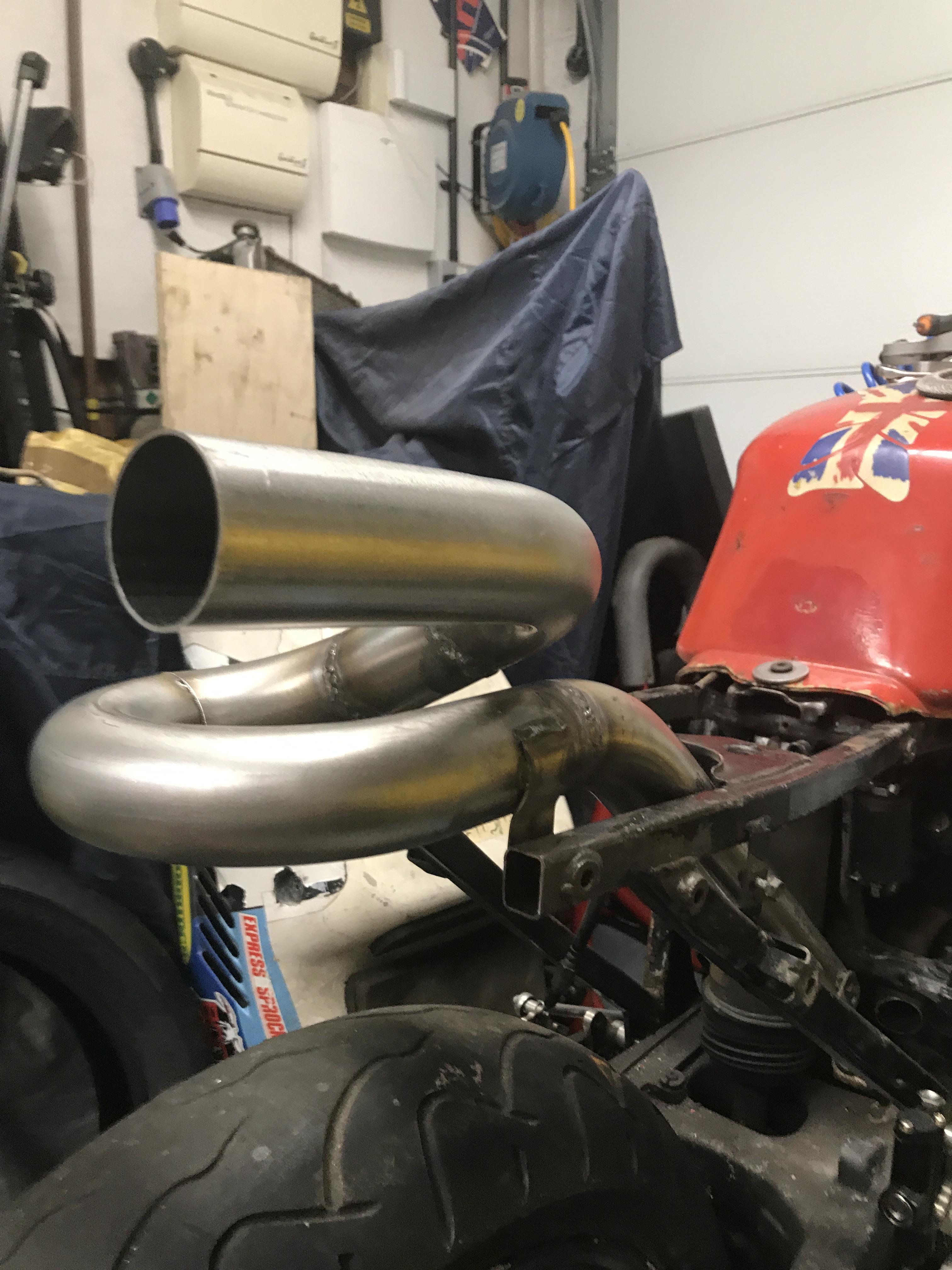

trooper1999 Posted January 18, 2018 Author Posted January 18, 2018 I've not had much chance to get anything done for weeks (works keeps getting in the way, oh the joys of being self employed) Just a quick update then, I've managed to get the VF1000R fork and yokes in, along with the wheel and spacers made to get the wheel centered, I need to sort out the clip on's, and make the new brake adaptors. I've started to try and teach myself TIG welding and have made a start on the rear exhaust, I need the pig tail in it to gain the length, I've just ran out of argon so that's my next job, get more argon. I'll try and get some more done and more posted. Quote

trooper1999 Posted January 19, 2018 Author Posted January 19, 2018 Sorry nothing as high tech as a band saw only an old fashioned hacksaw with a fine toothed blade in it, and a little bit of filing after to get the edges to meet better, I'm off work today, with everybody else at work I can play most of the day so am getting on with the rear exhaust, I'll post a couple of pics later, writing this with a cuppa tea in my hand. who said men can't multi task? Quote
Member Contributer JZH Posted January 20, 2018 Member Contributer Posted January 20, 2018 Gotcha, I was just noticing the little gaps, same as I always got from hand-sawing, which in theory make welding more difficult. But it's good to see that you can compensate for this by spending a bit more time on the filing. In any case, you're doing well! Ciao, Quote

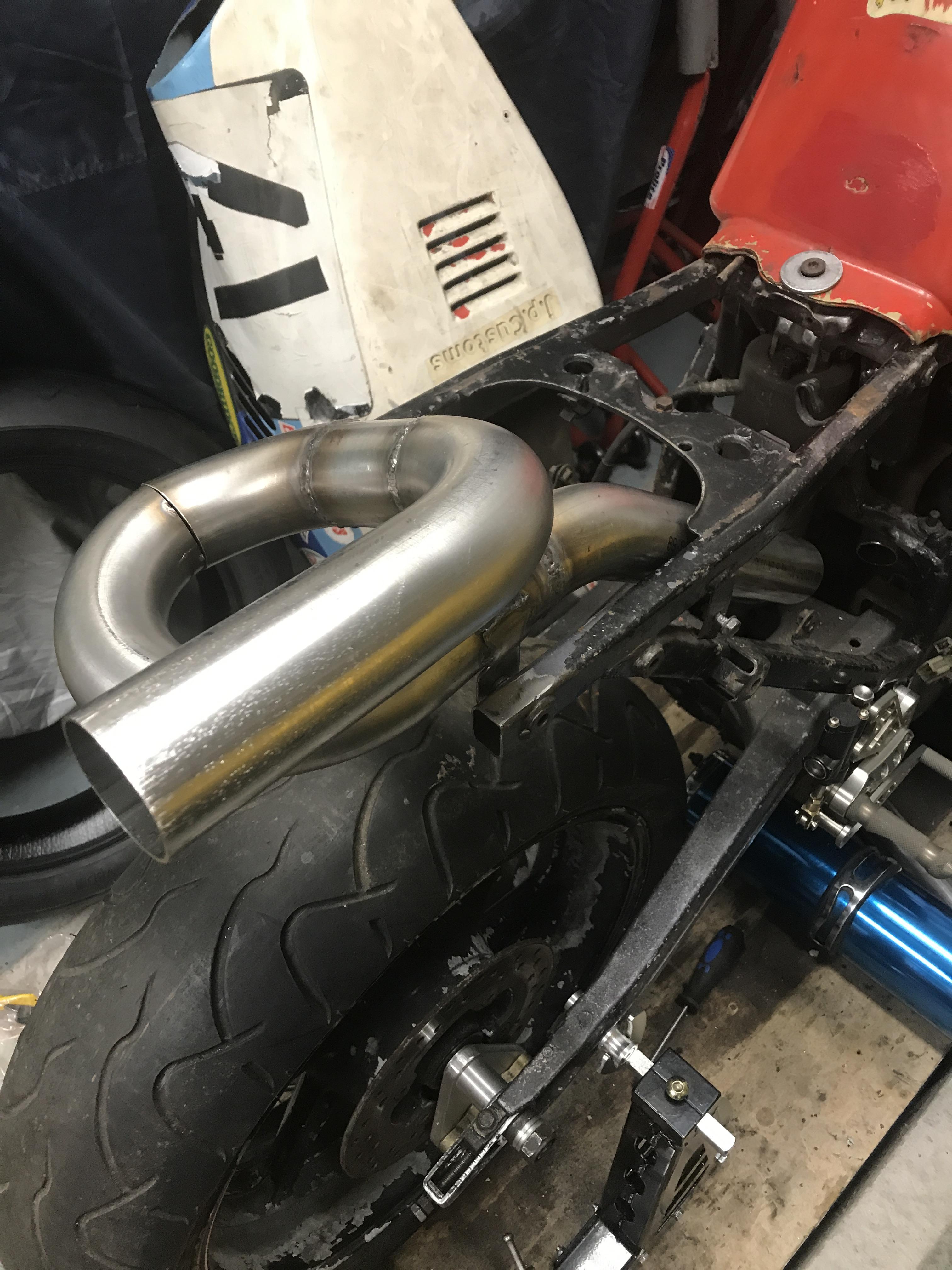

trooper1999 Posted January 25, 2018 Author Posted January 25, 2018 Thanks for that info I'll have to have a good look at RC30 sprockets when I'm ready, I've had quite a good but frustrating week with the Tig welding, some of my welds are ok but some will need tidying up, I've been having trouble welding the rear 2 into 1 joint piece so I've given in and it's gone off to the professionals, started on the front now, I've got one side made up with only slight modification from the standard, I will start on the other hopefully tomorrow and try and get them both into the 2 into 1 collector. I'm just ordering more bends now but it looks like they won't be here until mid next week. I've been looking at silencers and have found these on evilbay has anybody had any dealings with them. https://www.ebay.co.uk/itm/LEXTEK-GP1-Matt-Stainless-Steel-GP-Stubby-EXHAUST-Silencer-51mm-Slip-On-End-Can/152273850553?ssPageName=STRK%3AMEBIDX%3AIT&_trksid=p2060353.m1438.l2649 Quote
