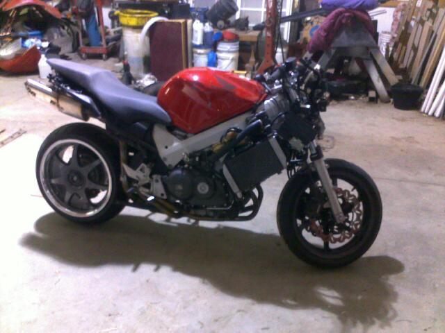

Guest devilsyam Posted February 14, 2012 Posted February 14, 2012 hi yep first post and jumping rite in feet first found this via google this is wot i'm upto cb1000r arm vfr 800 wheels (but in to a yamaha sorry) cb1000 arm 255mm across the axle welded a lower link point on here fitted with the vfr wheel would love to try the car wheel options this wheel has a offset of 49 and a 4 x 100 4 stud spacing any help would be appriciated Quote

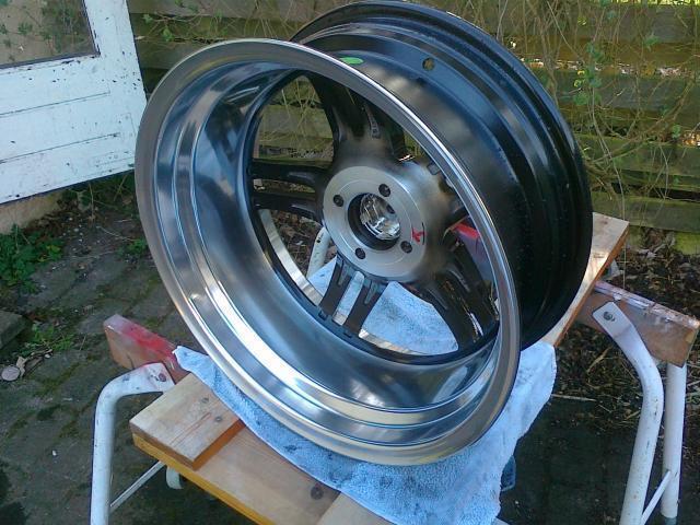

CatiePotatie Posted April 21, 2012 Posted April 21, 2012 This looks like such a brilliant idea that I wanna give it a crack too.. As my overall colour is still blue I was thinking a white WRC style rim (think Subaru Impreza) would suit nice. Somethin like this: Also I was a bit concerned about the bead profile as most car rims are asymmetrical but it seems that any standard JJ style rim (has a safety bead on both sides instead of just one) would be safe enough. Now just the problem of finding a wheel like this that doesn't involve buying 4 of them Quote

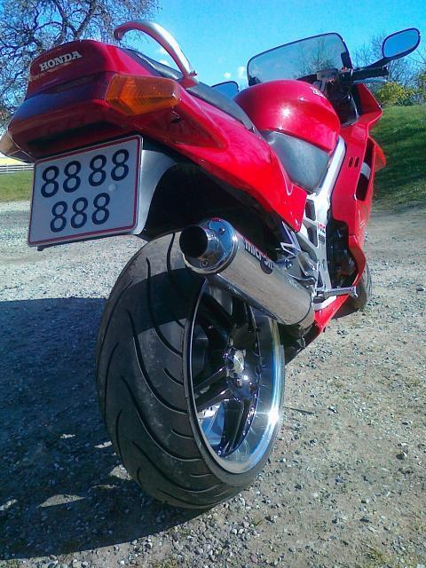

NakedViffer Posted May 8, 2012 Posted May 8, 2012 Good job man, that beautiful. You end up with the 200 series roadsmart? Hows the handling? Quote
Helweg Posted May 8, 2012 Posted May 8, 2012 (edited) not 200 it's a Mic pilot road 190 fits great and good handling cant feel any difference I used to ride similar tyre on my 5,5 inch - but this looks much better but I think I'll go for a 200 or maybe a 210 next Edited May 8, 2012 by Helweg Denmark Quote
