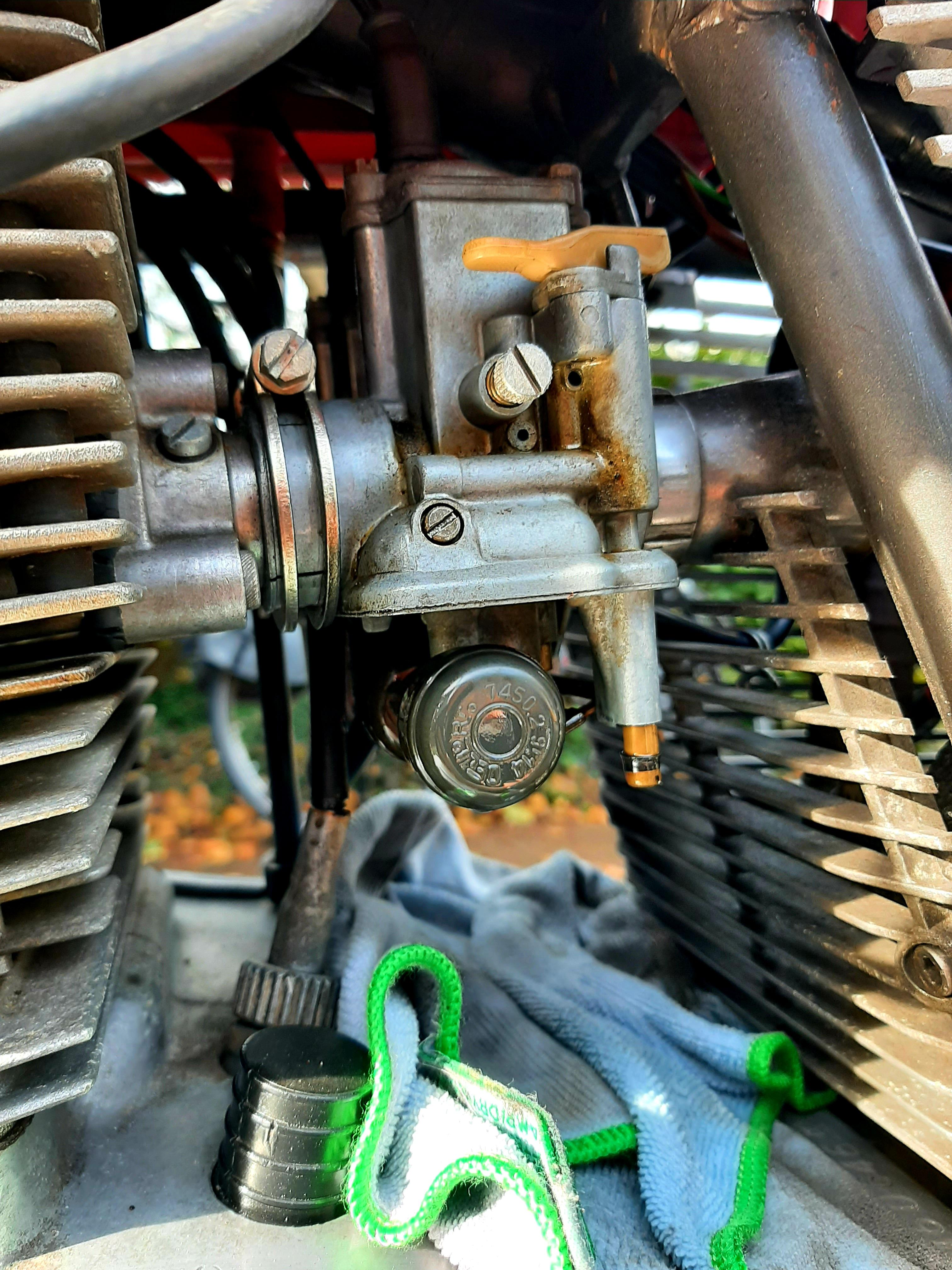

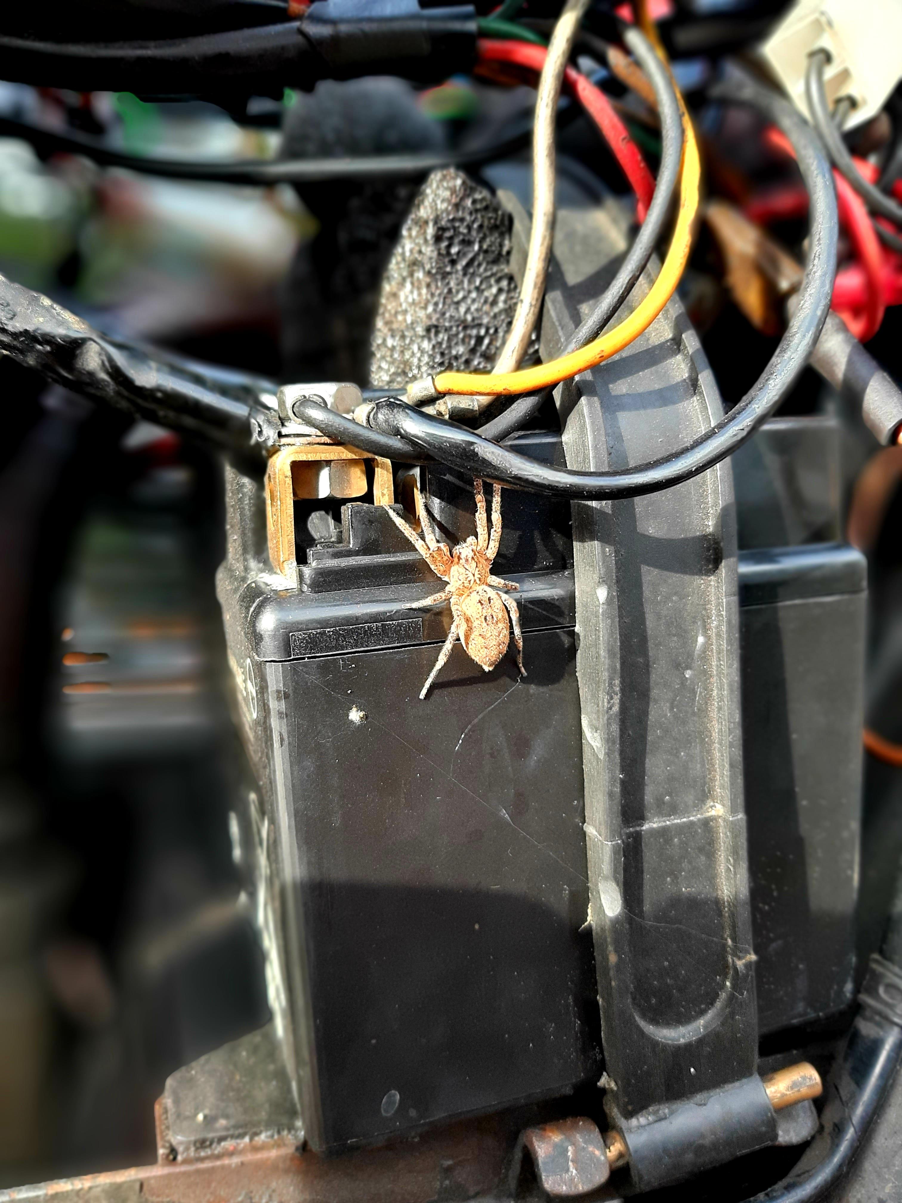

Member Contributer Dutchy Posted October 29, 2023 Member Contributer Posted October 29, 2023 Winterization time has come for the MV.... Drained the carbs, that's all No squatters allowed... 🙂 1 Quote
