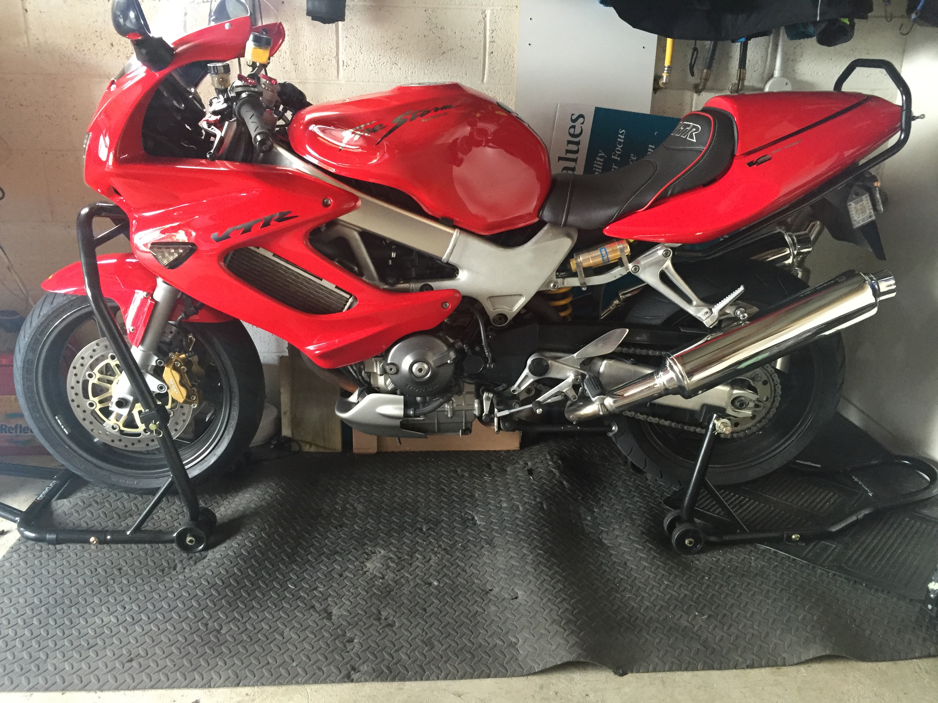

Member Contributer Terry Posted February 5, 2021 Member Contributer Posted February 5, 2021 Easy enough to jack up the 800 on the headers, but I do wonder about the load that places on the exhaust gaskets as one of mine developed a leak. Personally I love the head lift stands (like the one in my VTR photo), very easy to use and great for front end work UNLESS you need to work on the steering head. https://www.torpedo7.co.nz/products/T7S7LNNFH/title/torpedo7-motorcycle-front-head-lift-stand 1 Quote

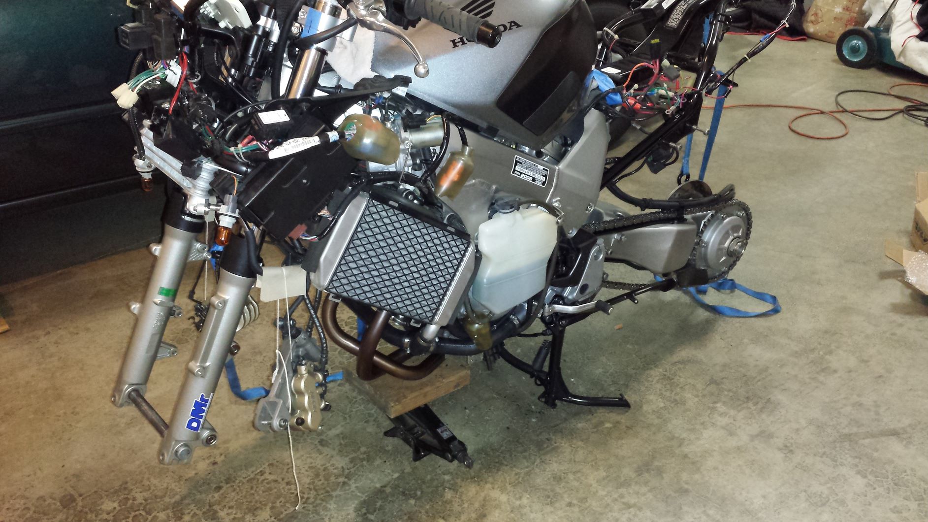

Member Contributer Cogswell Posted February 5, 2021 Member Contributer Posted February 5, 2021 Or, do a combo of a jack under the headers (I use a small piece of plywood to distribute the load to both tubes and to make sure there's plenty of surface area so the jack won't slip off) and some weight on the back seat. A sandbag would work well for that or another solution I saw was to run an appropriate size pipe through the rear axle and then stack barbell weights on it. What works well for a jack is from a sedan that has a scissor jack. With the weight on the back the jack won't have to do much if any work to raise the front up. When I had my forks out for service mine sat like that for a month with no problem. Just be sure to loosen the bolts up prior to jacking it up. But, stands remain the best way if you want to make the investment. 1 Quote
MarcOtt Posted February 5, 2021 Posted February 5, 2021 I have jacked the front by the wood or rubber block jacked under the exhaust pipes, no problem while bike is on the center stand. 1 Quote
Member Contributer Cogswell Posted February 5, 2021 Member Contributer Posted February 5, 2021 This is how it looked while I was reinstalling the forks. It clearly shows the headers supporting the front and how I positioned the jack. The stability was fine. I would not though recommend doing any heavy duty tightening of fasteners in this state. If you leave the rear wheel on (I couldn't here because the shock was out) you can lift the front with the jack until the rear wheel just contacts the floor (do not overdo as you'll end up picking it up off its side), and then with 3 points of contact it's surprisingly stable. 3 Quote

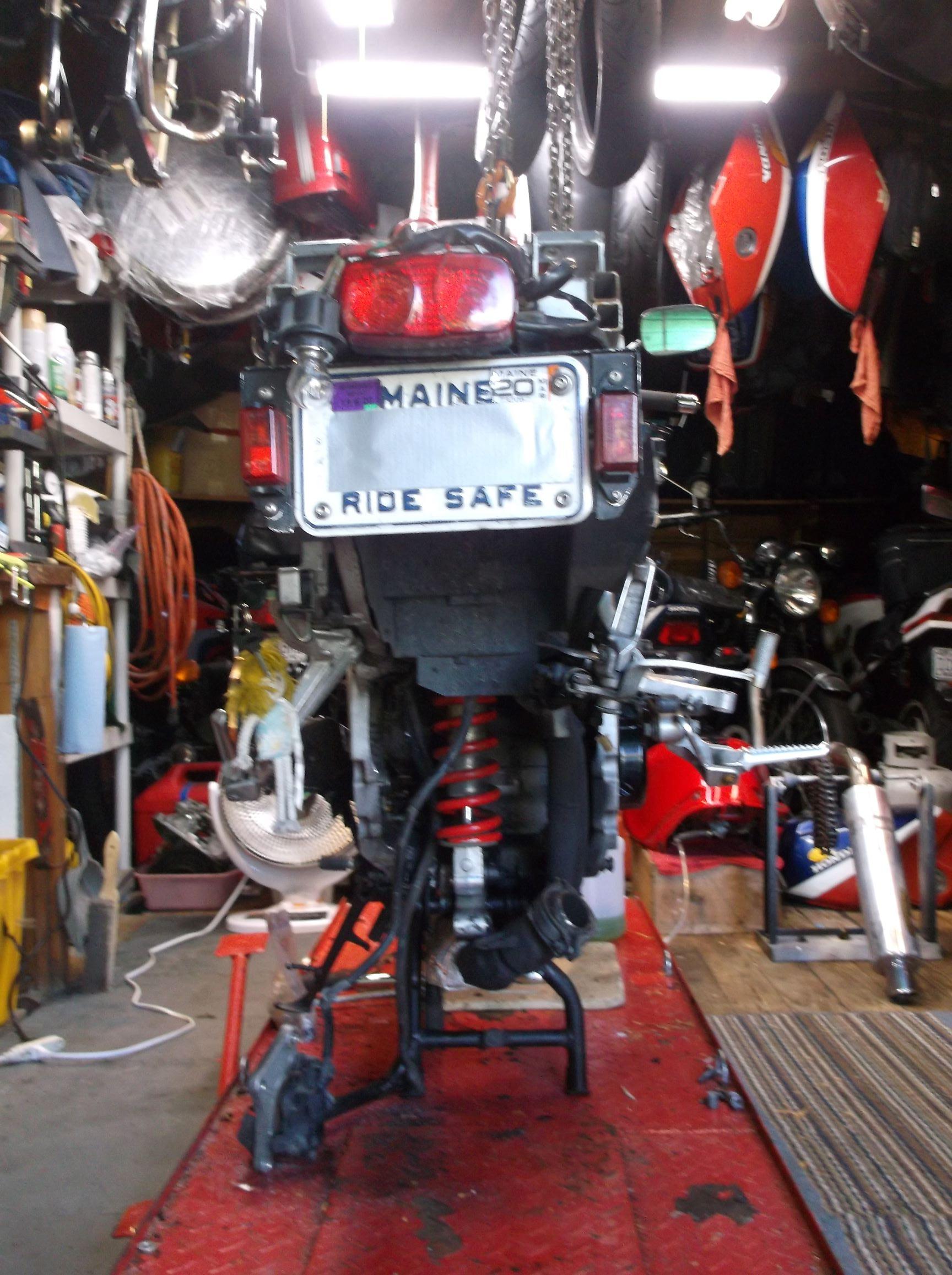

Member Contributer FromMaine Posted February 5, 2021 Member Contributer Posted February 5, 2021 If you have a hard point above, like a good stout joist or carrying beam, you can throw a strop under your triple trees and use a chain hoist. Any doubts about the joist, throw a piece of 4 X 4 over 3-4 of them and center the bike underneath. Notice the center stand is taking some of the weight Back when I used a hydraulic motorcycle jack, I used to throw a couple of ratchet straps over a joist and jack the bike up then take just a little weight on the straps as a safety in case I got a little over eager with the socket set. Spread them a bit on the joist so you get a good angle and use the triple tree as a lift point with a strop. You can use any kind of jack you want really, but use good real ratchet straps instead of those pull through ones with no real brake. First pic is this past Spring, had the front off to swap the tire and the rear swingarm off to service bearings, bushings, shock etc. Second pic is the type of jack I used, but the bike still was a bit bouncy, hence the straps. Good luck Quote
