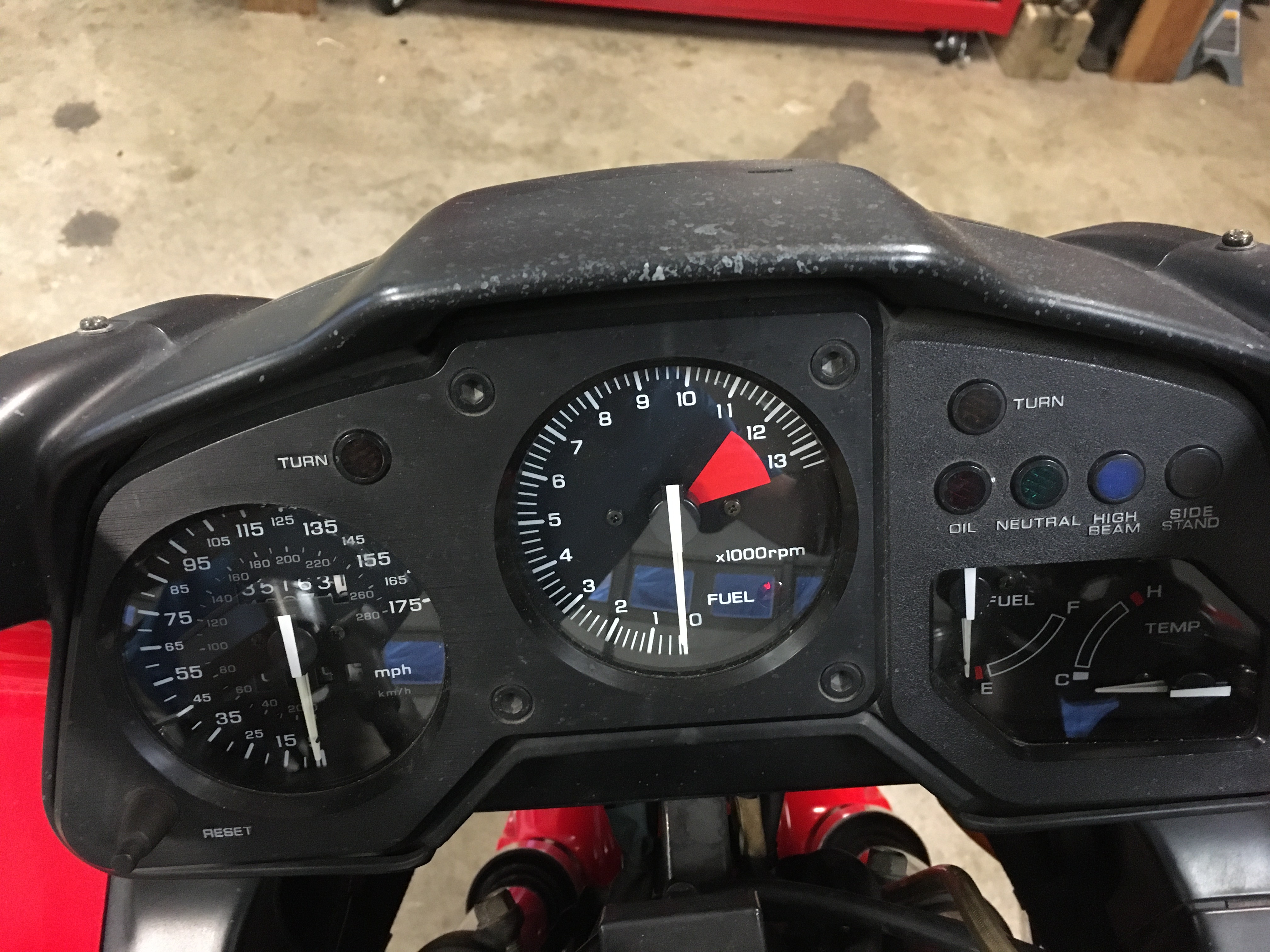

Here is why I had to paint dash surround bits.  I don't mind old looking, but this is damage so had to freshen it up.

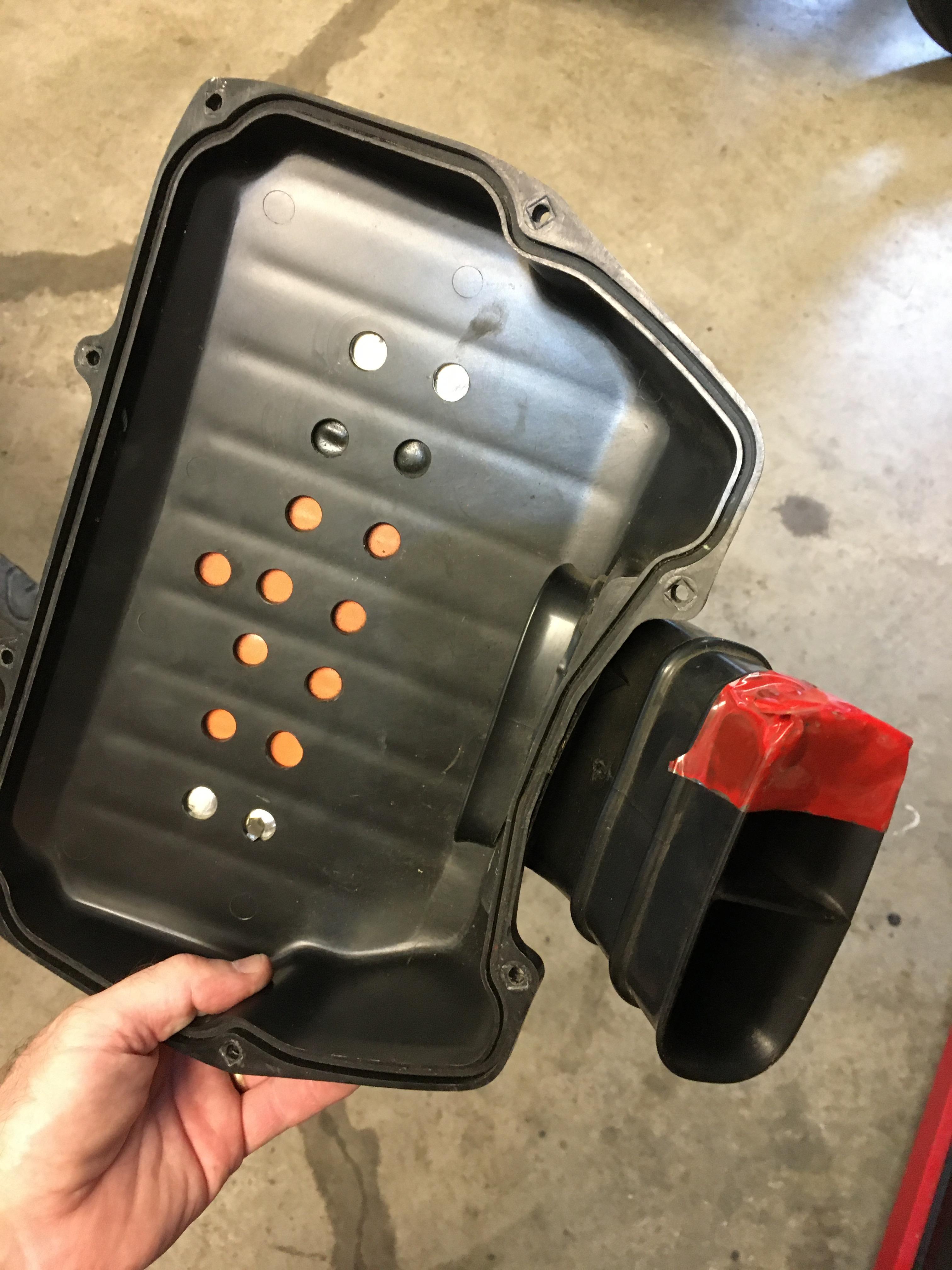

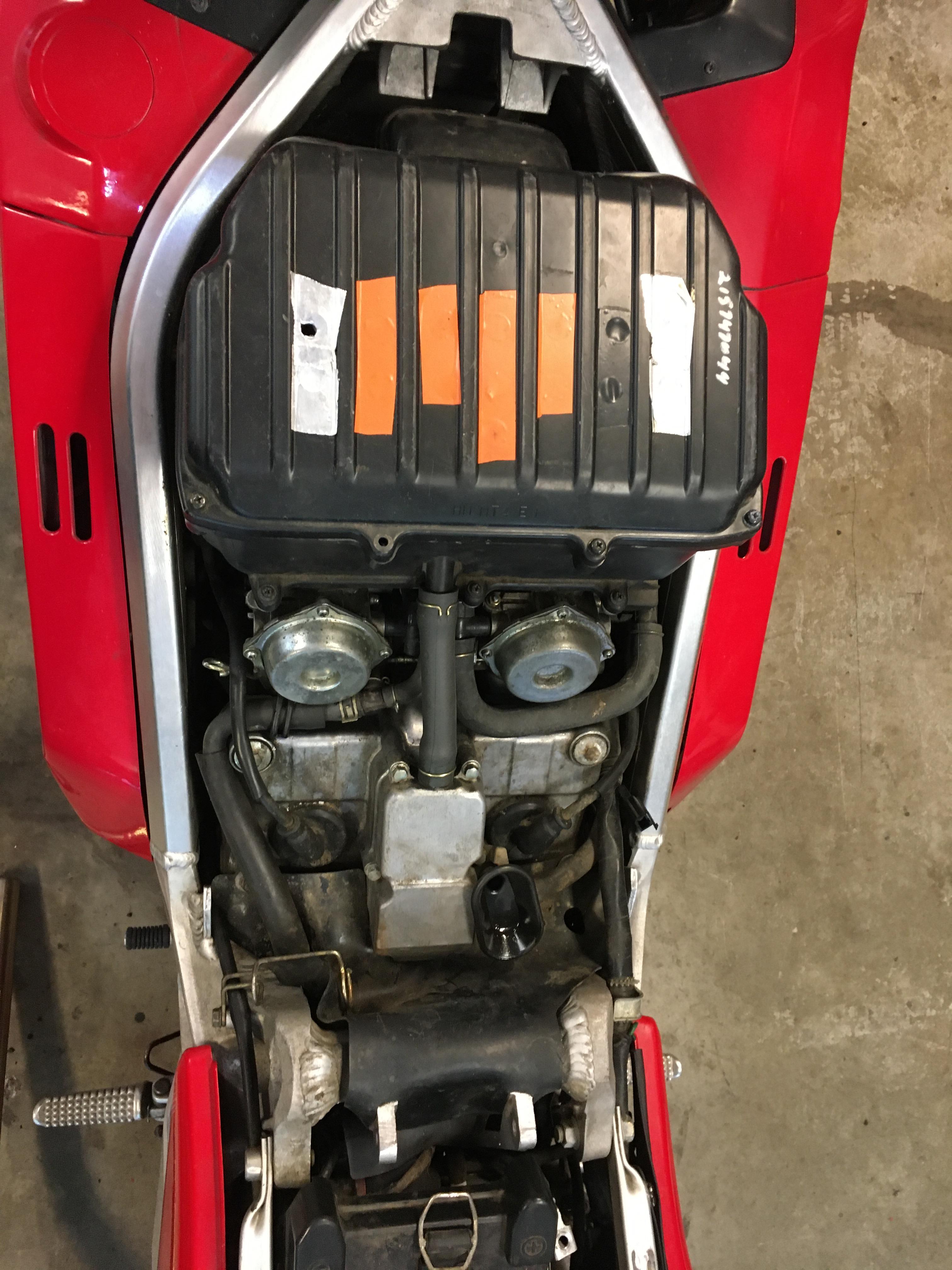

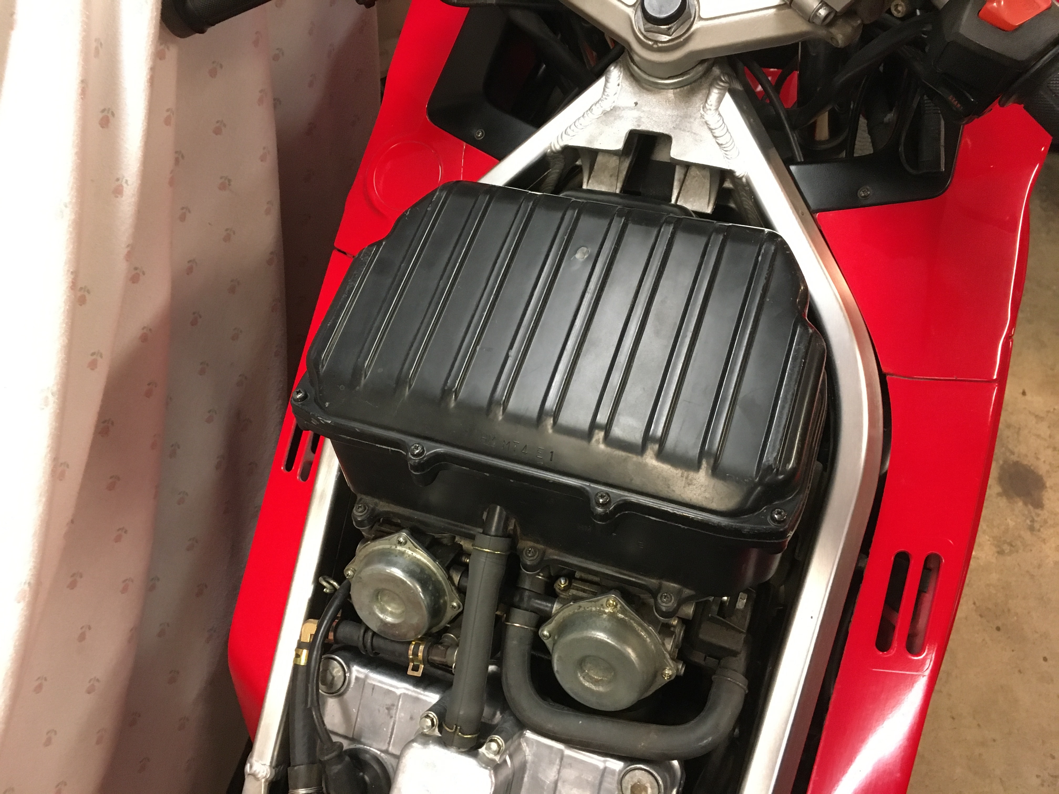

Not that attractive and half-ass functional, my plan was to tape it up properly and make do. Well @RC1237V saw that and was like I can help this person, so without my asking RC1237V offered to send me an airbox lid that did NOT have 15 holes drilled it....we would swap and I would send him the holy one.  His thoughts was since my bike was mostly stock and was likely going to remain that way it deserves a nice factory piece.  What a great way of thinking and I was like heck yea, thank you.  Now I have this:
I did finally figure out what the holes in the lid are for.....they are to hold spanners 🙂

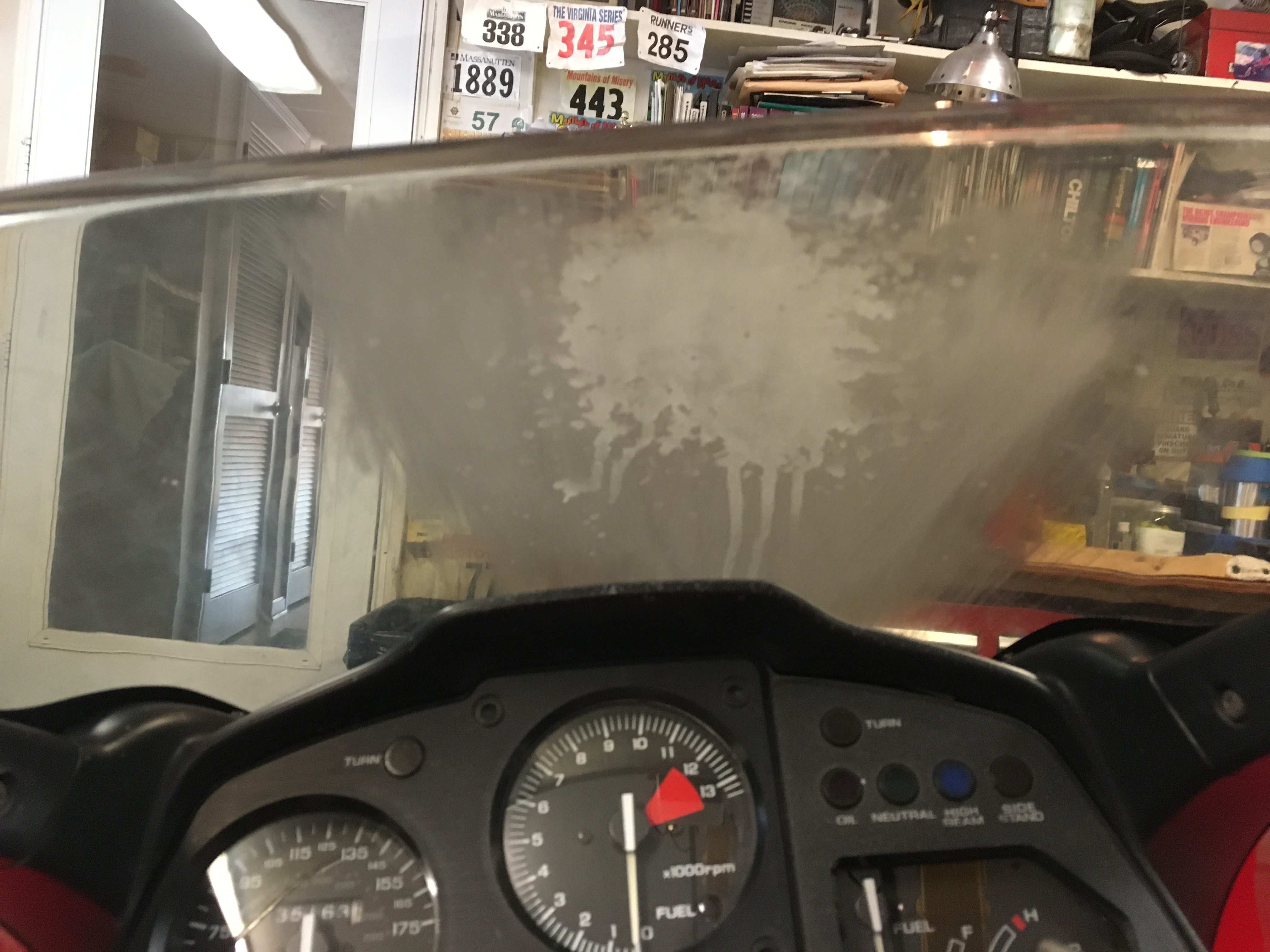

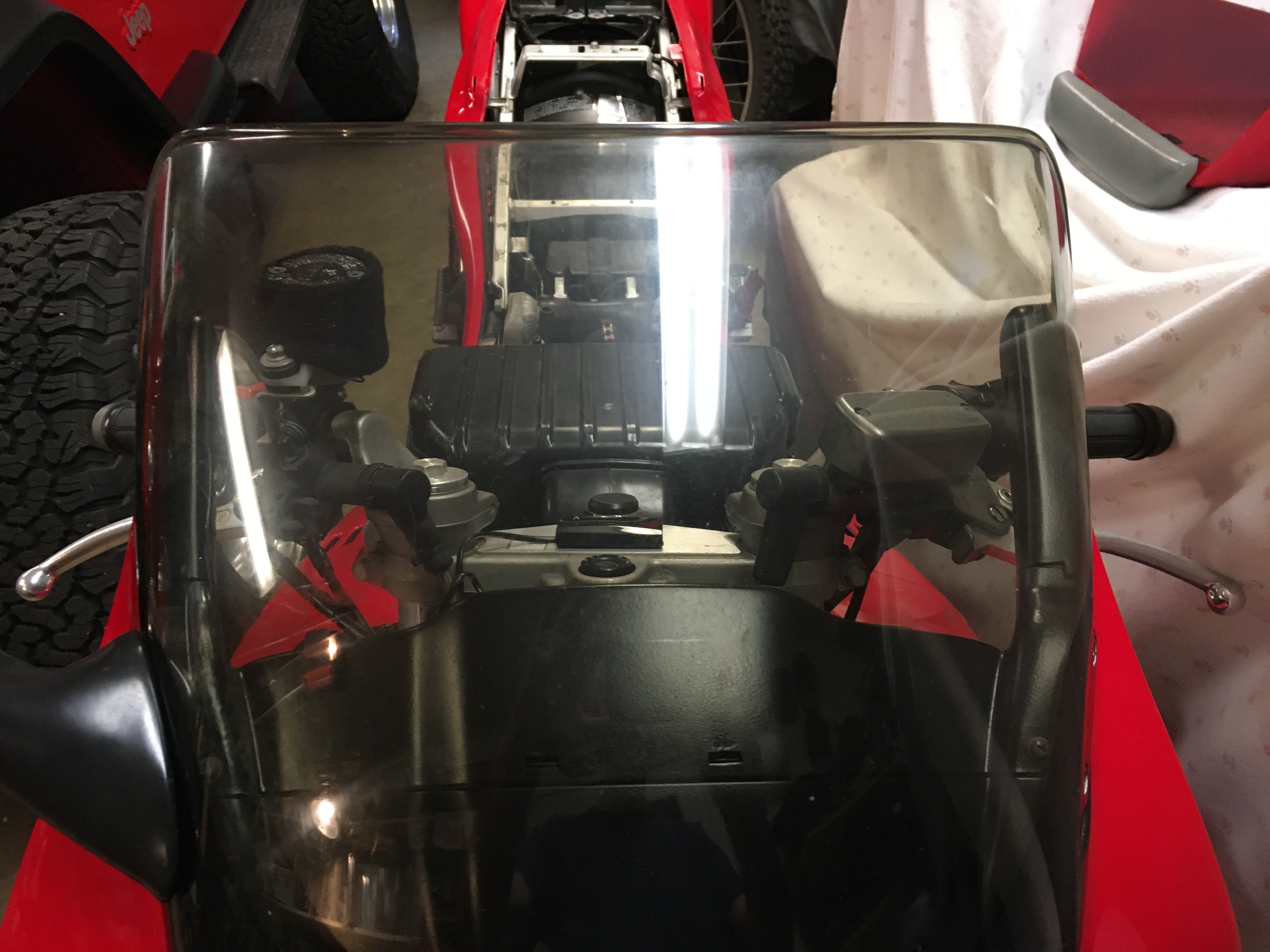

The key piece I was missing though for this bike was a windshield, you see mine looked like this:
That stain is on the inside.  While I had the screen off fixing things I tried wet sanding with some 600 grit and it did not even touch it, that is when I gave up.  Then I remembered that RC1237V had one or two bikes that were being converted to naked street fighters and that he mentioned somewhere about having extra parts.  I reached out and we came up with a great deal on a windscreen, heck he even threw in some dash surround parts for free which was really nice.  I think this is much better:

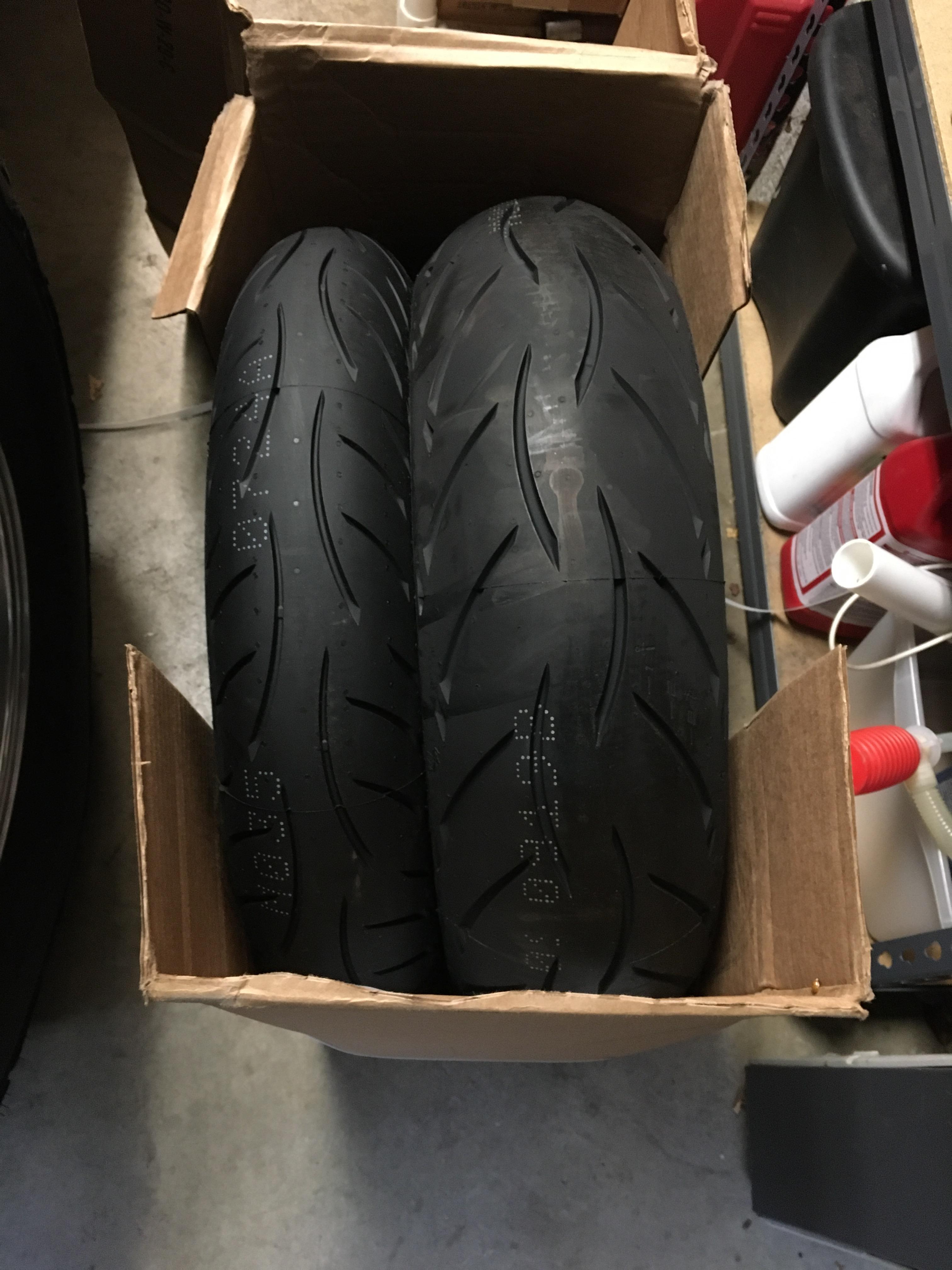

Then it will be time to replace the 12 year old tires with these Metzlers that I found at a great price ($205 shipped).  I will post up when I do.  I have a home made bead breaker that has served me well for years.  For  mounting the new tires on the rims I have found the zip tie method to work amazingly well.

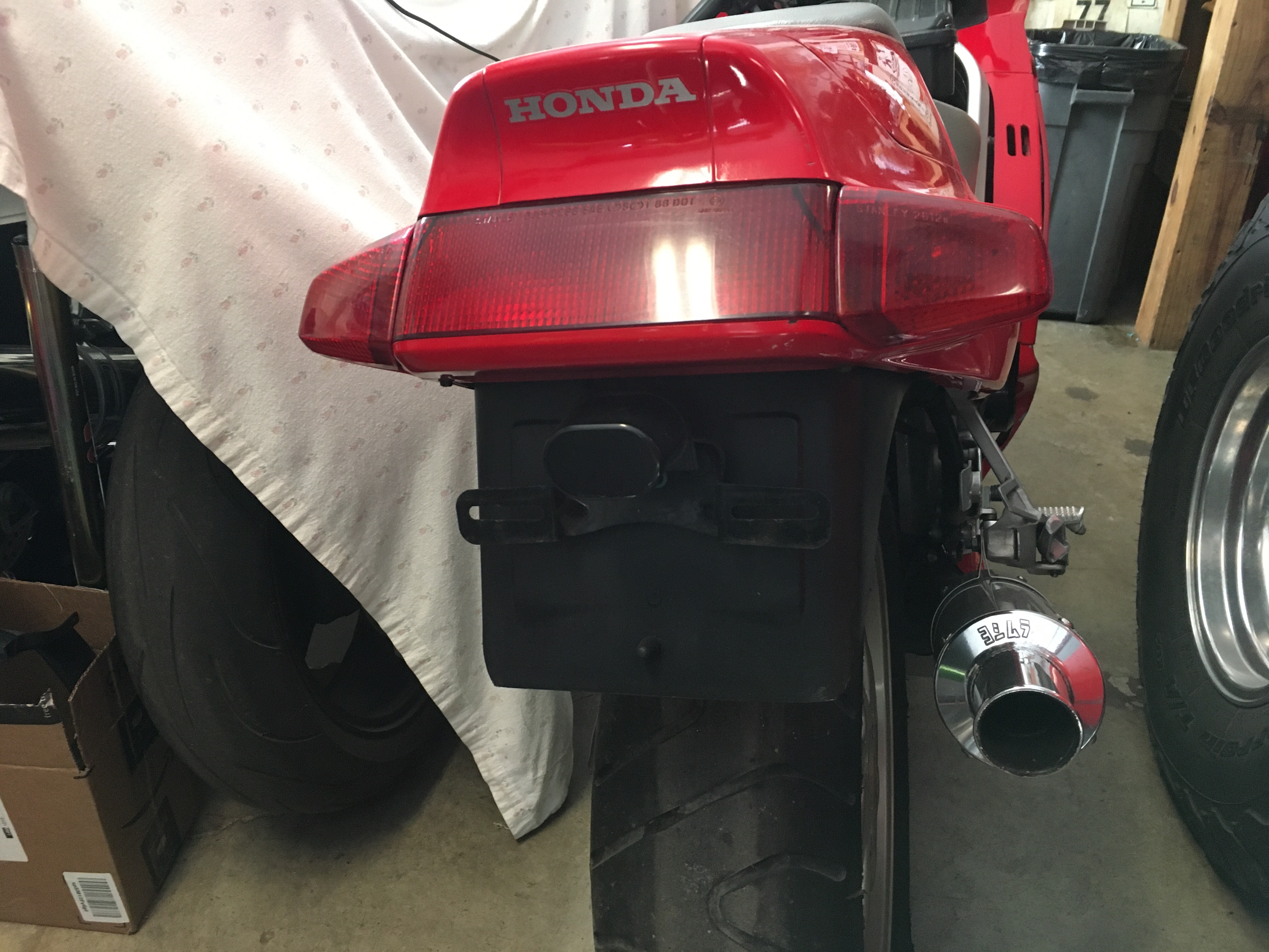

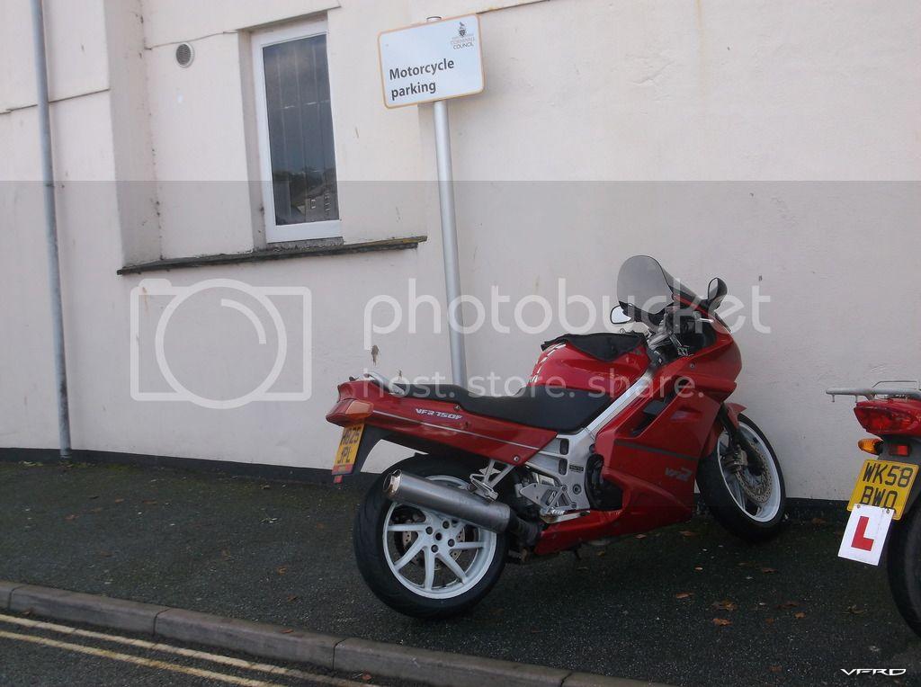

Rear turn signals are not required to be amber.  Just think of all of the vehicles (including new Harleys) with just red taillights that also function as the signals.  What is illegal, is to wire rear amber signals as running lights, but I have never heard of any motorcyclist getting grief for it.
I believe Honda added the "extra" signals because the DOT requirements of how far apart they needed to be were ridiculous at the time.   God, some of those rear turn signal stays were LONG in the 80s and early 90s.
I was in Germany in the early 90s and bought a set of amber VFR lenses to bring back with me.  I sold those same lenses 3 times for well over $100, as they kept coming back on trade-ins.  Then I would swap in some red ones, and re-sell.  😉
Then in 1994 those signals were integrated in amber on the VFR.  The gig was up.
12 minutes ago, Captain 80s said:
Rear turn signals are not required to be amber.  Just think of all of the vehicles with just red taillights that also function as the signals.
That would be good.
I was wondering if the red lenses are US spec and the amber ones Euro?  I have seen pics of both.  I wouldn't mine a set of the amber ones.
5 hours ago, mtnpat said:
That would be good.
It would appear so. My 91 I had in England a few years back had amber lenses, and as Capt. 80's pointed out so did the German bikes.
The 94 - 97 VFR lenses are the the exact same lens as 90-93 , but amber.
Indicators must flash orange over here.
Yes, you may fit white lenses/housings, as long as the bulb itself is orange...

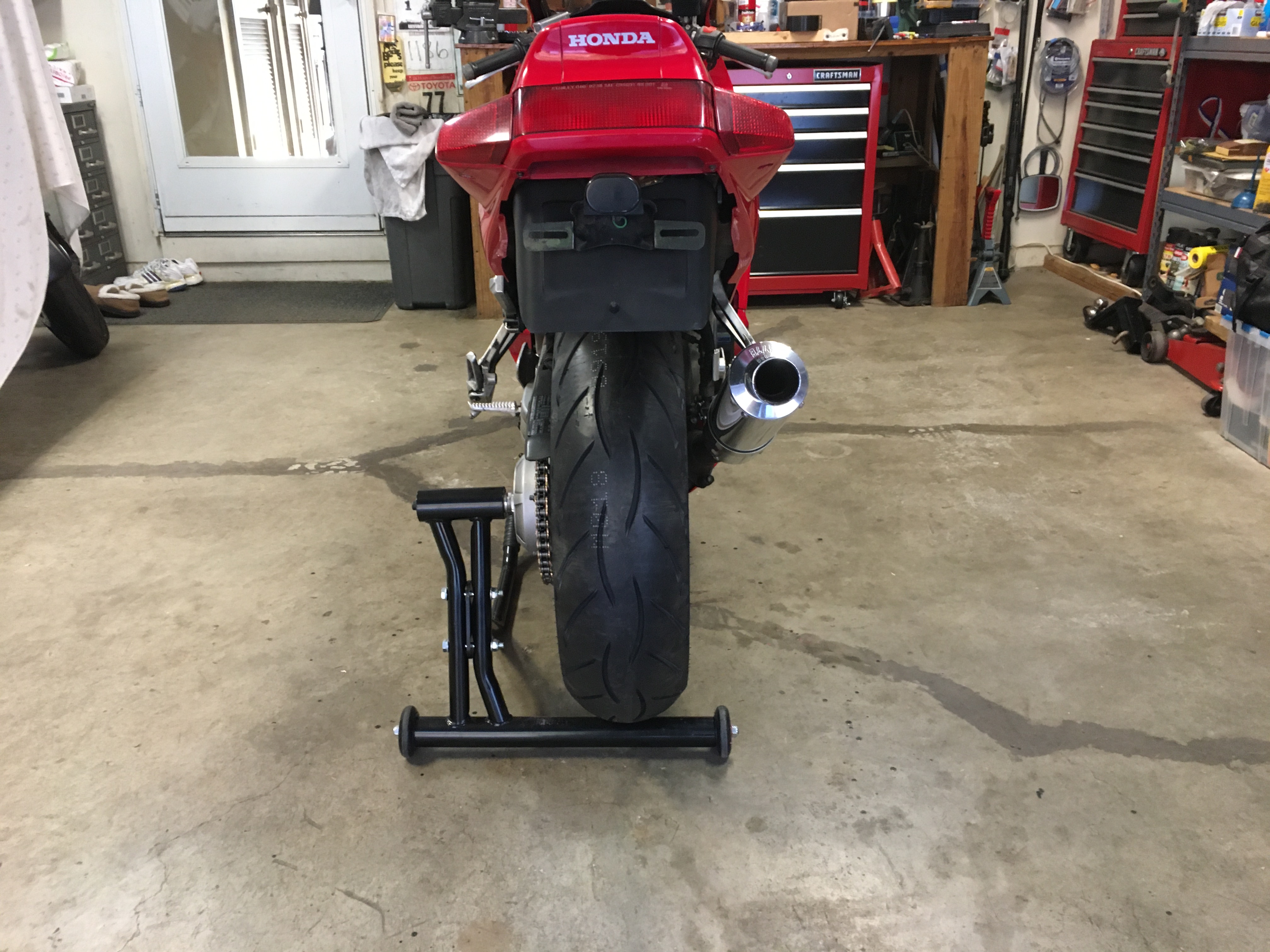

Here is a shot in the garage while I was still working on it.  I went with a stock 170/60-17 rear tire and am glad I did, I think it looked stupid with the 180/55-17 it had on it.  You are a 750...be proud of what you are! No need to go all American Chopper on these bikes.  Just my opinion.

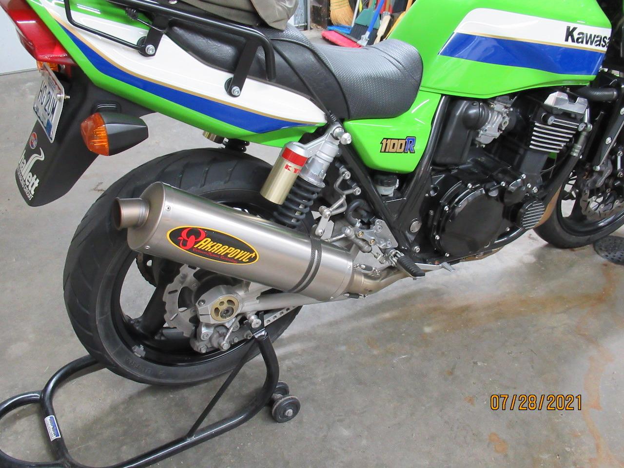

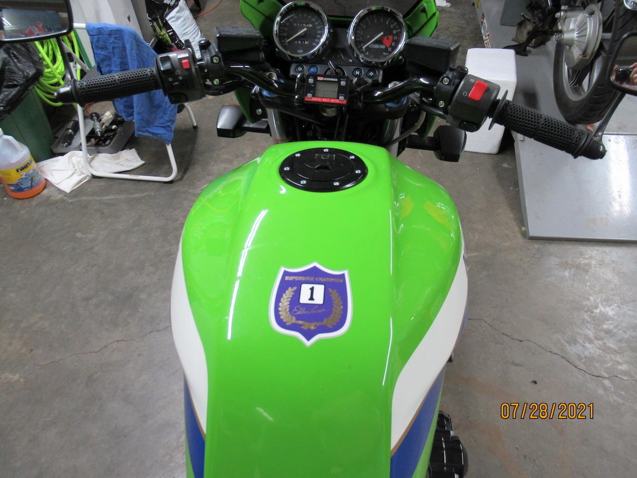

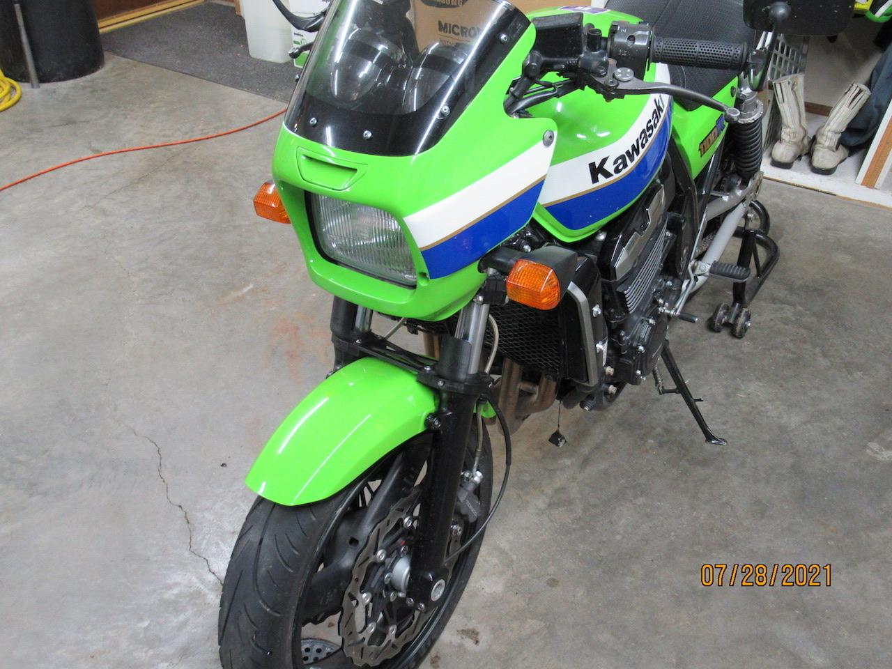

I finally got around to taking pictures of the ZRX and thanks to Danno I know how to load them now. You mentioned you wanted to see the bike so here goes.
Well 2 of them don't want to seem to resize so I guess this is it.
