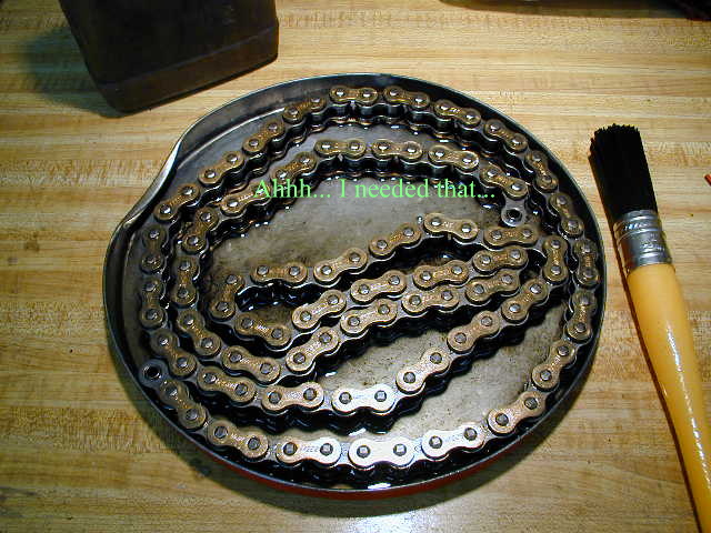

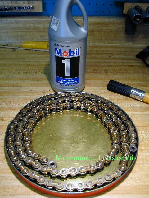

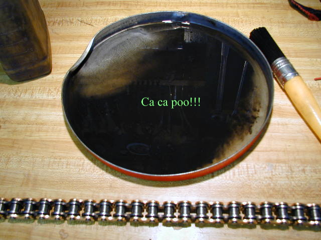

This is what I do to maintain the chain.  let me know if anybody has a better system.
Remove the master link.  I use a clip master link since the chain comes off on a fairly regular basis.  I have never had a clipped master link fail but it is very important to be sure the clip is solidly in the pin notch, rounded end facing rotation.
Once the master link is off, I usually hook an old chain onto chain to be cleaned.  Then thread the old chain thru the counter sprocket about 1/3 way.  Let it hang in place.  When the time comes you will hook up to the old chain in place and thread the cleaned chain through the counter sprocket.
Once I get the chain out, I put it coiled up in a pan for cleaning with kerosene.  I don't have a parts cleaner so this works.  Kerosene will not damage the x seals and is a lubricant in its own way. I spin the rollers to make sure solvent is washing out the roller to pin area.  I do this cleaning 2 or 3 times depending how dirty it is.  When I am done with cleaning, I air out the solvent,
Now the coiled up chain goes into the pan with engine oil.  Spin the rollers to make sure the roller/pin area is saturated.
I use a S hook and hang the chain off my garage door rail over night.  Wipe it down after it is done dripping and reinstall.
Total time for removal, cleaning, oiling, and reinstall is about 40 minutes.
With this method, I have never had a chain stretch problem.  Always is a roller wearing out and getting 1 -1.5 mm play is what takes the chain out of service.  My current chain is not showing significant amount of wear yet.  I am thinking it will probably make it 30,000.
