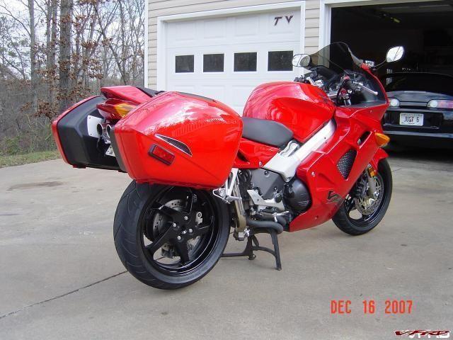

Member Contributer Cogswell Posted March 3, 2020 Member Contributer Posted March 3, 2020 I did see a photo once of a red 5th gen that had matching color 6th gen bags adapted to it. Looked factory - really nice. Reply here if you'd like to see it and I'll see if I can find it. Quote
JimMoore Posted March 3, 2020 Author Posted March 3, 2020 8 hours ago, Cogswell said: I did see a photo once of a red 5th gen that had matching color 6th gen bags adapted to it. Looked factory - really nice. Reply here if you'd like to see it and I'll see if I can find it. Thanks. That would be great. I was looking at a 6th Gen yesterday. I liked the fact that the undertail exhaust left room for bags. Quote

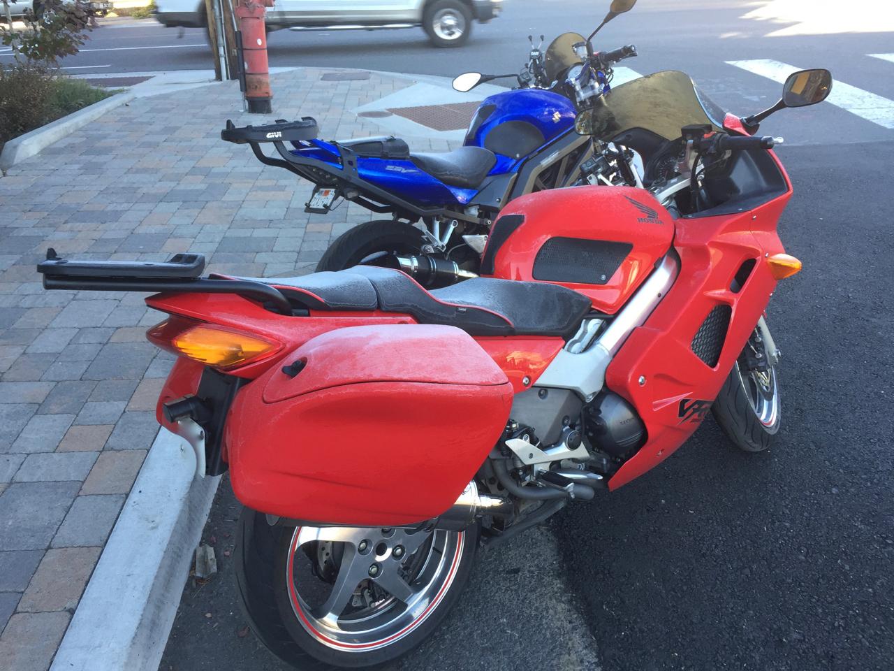

Member Contributer Dutchy Posted March 3, 2020 Member Contributer Posted March 3, 2020 With a little fabrication, a 6th gen rack can be made to fit. You will have to make some allowance for the exhaust... No, that is not a twin exhaust; it is the container for my tent poles.... Quote

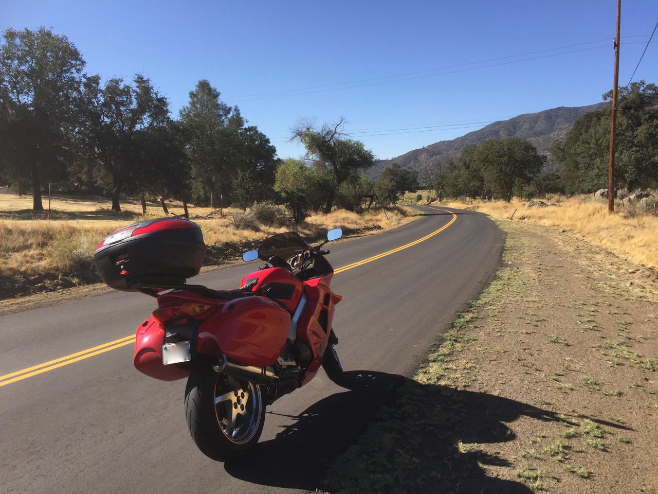

Member Contributer vfrcapn Posted March 3, 2020 Member Contributer Posted March 3, 2020 You can get the Givi mounts on the 5th gen even with a high mount exhaust. 1 Quote
Member Contributer raYzerman Posted March 3, 2020 Member Contributer Posted March 3, 2020 Good to know..... I'd be more inclined to put on Givi V36/37 or maybe Shad. Try Kappa racks, Givi's with a discount. Quote

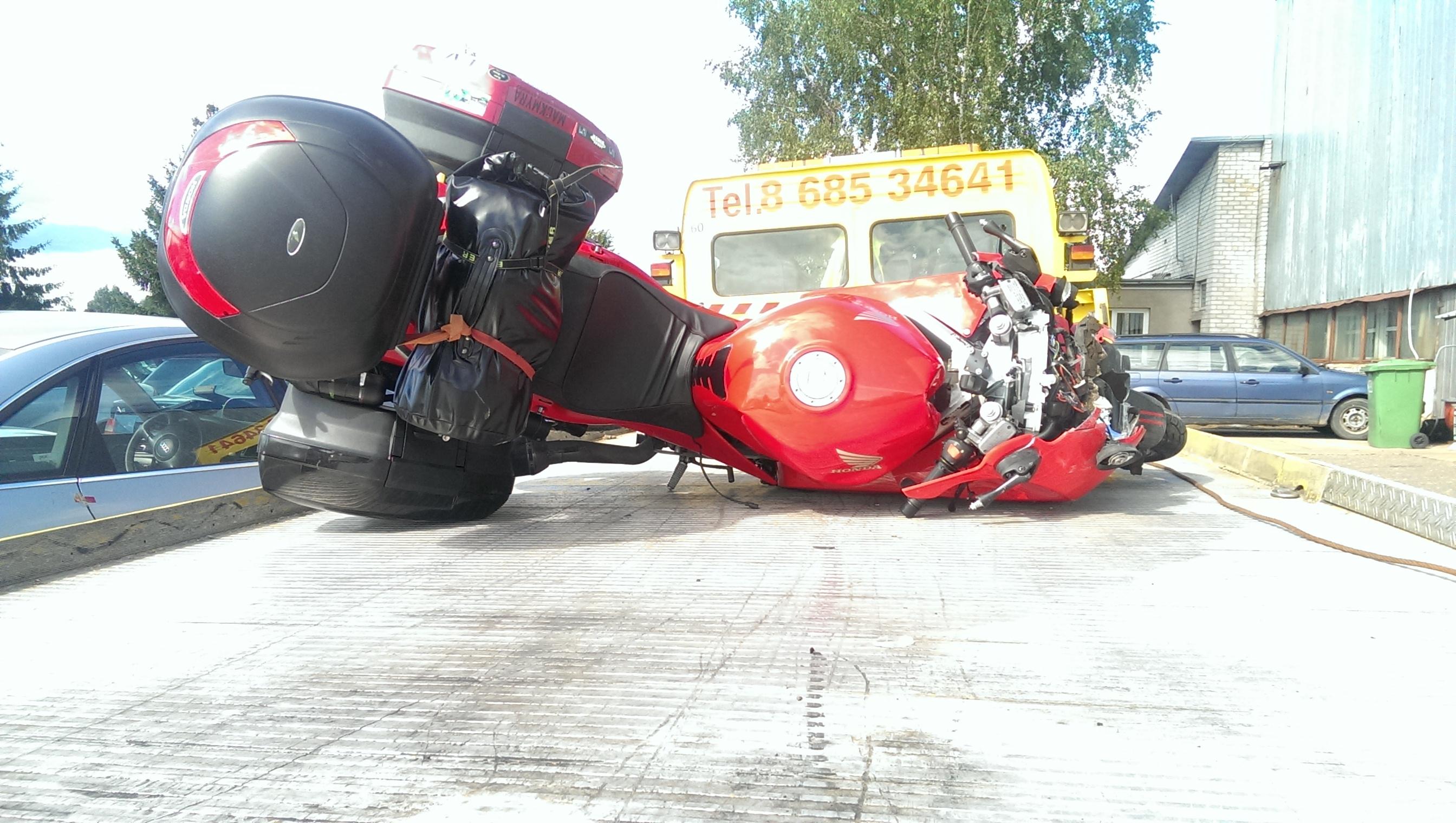

Member Contributer MaxSwell Posted March 5, 2020 Member Contributer Posted March 5, 2020 I have had several fifth gens and all have had a Givi rack and bags. I've had two sets of Givi V41 liter hard side cases and still use my second pair. One of my fifth gens came with 34 liter side bags. I use them in combination, usually the 41's as side cases and a 34 as a top case. If I anticipate less cargo I can use the two 34's as side cases. My second set came about when I found a Givi dealer in Italy had a complete set, including the mounting racks, on sale for a great price (can't remember the exact cost but it was about one-half off. They did take about five weeks to arrive. I think they shipped from Italy by row boat. 🙂 And I can vouch for the Givi hard bags durability: they survived a 65-mph freeway deer crash with out opening. Just a good deal of scratched on the outside. Quote

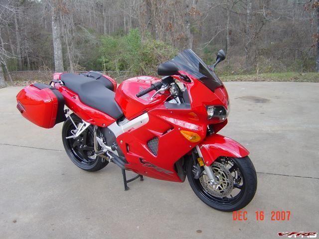

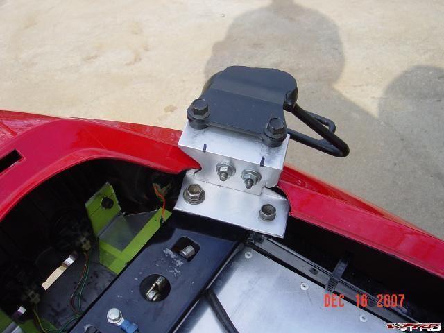

Member Contributer Cogswell Posted March 6, 2020 Member Contributer Posted March 6, 2020 1 hour ago, mello dude said: Would like to see that myself.... Here 'ya go! The mounts looks to be stock 6th gen adapted to fit. There are some more detail shots of that if someone wants them. However, note the Wolfe exhaust . . . that too has been replicated so still possible for a committed owner. It would be interesting to know if this could be done with a low mount exhaust. I really dig this setup. 1 Quote
Member Contributer Dutchy Posted March 6, 2020 Member Contributer Posted March 6, 2020 Neatly done, but our "finest" would pull you over pronto as the licence plate is obscured. Hard to see how/if he supported that section..... If it is just the struts at angle towards the passenger pegs and the (aluminum?) brackets at the top, I would not fully load the bags and ride WOT...... Quote
Member Contributer vfrcapn Posted March 6, 2020 Member Contributer Posted March 6, 2020 Givi has lots of options, but I do like that 6th gen set up. 2 Quote
eyrwbvfr Posted March 6, 2020 Posted March 6, 2020 5 hours ago, Dutchy said: Neatly done, but our "finest" would pull you over pronto as the licence plate is obscured. Hard to see how/if he supported that section..... If it is just the struts at angle towards the passenger pegs and the (aluminum?) brackets at the top, I would not fully load the bags and ride WOT...... The Givi bracket also has that rear strut bar across the back. I am dropping my plate mount to have it more visible. Quote
Member Contributer Dutchy Posted March 6, 2020 Member Contributer Posted March 6, 2020 The OEM setup has a solid metal bracket running from the rear subframe down to the back/inside of the licence plate holder. Here a metal plate is affixed that connects to the rear struts. I modified that to fit the rear subframe of a 4th gen. This made it very very solid.. Despite colliding into an oncoming car that turned left infront of me, noting snapped or bent... Quote
Member Contributer Cogswell Posted March 6, 2020 Member Contributer Posted March 6, 2020 Full disclosure - that is not my bike. The mounts do pick up all the mounting points on the 6th gen brackets (though the lower one from a different angle), so my intuition sez it should be solid - at least as much so as on 7th and 8th gens, but hard telling without seeing it person. Good point on the plate - could probably be overcome by fabbing a bracket similar to the 6th gen setup to allow for exterior mounting of the plate. Quote
mello dude Posted March 7, 2020 Posted March 7, 2020 20 hours ago, Cogswell said: Here 'ya go! The mounts looks to be stock 6th gen adapted to fit. There are some more detail shots of that if someone wants them. However, note the Wolfe exhaust . . . that too has been replicated so still possible for a committed owner. It would be interesting to know if this could be done with a low mount exhaust. I really dig this setup. That adapter bracket doesn't look like it's all that hard to fab, Hmmm.... Would figure something else for the bracket around the license plate... 1 Quote
Member Contributer Cogswell Posted March 7, 2020 Member Contributer Posted March 7, 2020 The lower mount is attached to the footrest hanger by a rod, prob ok front to rear, but maybe not so much laterally. On the 6th it attaches directly to the hanger, so is solid. Maybe something fab'd that drops straight down from the rear sub frame would anchor it more securly as well as be more or less out of sight. 1 Quote
Member Contributer MBrane Posted March 7, 2020 Member Contributer Posted March 7, 2020 2 pieces of 1" tubing bent at 90° angle cut, and welded to 3/4" angle bolted to grab handle mounts. Simple, easy, and clean. 1 Quote
Member Contributer JZH Posted March 8, 2020 Member Contributer Posted March 8, 2020 On 3/7/2020 at 12:08 AM, mello dude said: That adapter bracket doesn't look like it's all that hard to fab, Hmmm.... Would figure something else for the bracket around the license plate... No, but it also looks like it won't last a season of riding. I've had steel luggage brackets that cracked and had to be re-welded en route, and those look like simple alloy angle. GiVi itself had to re-design their (steel) VFR800Fi brackets because their earlier design just couldn't take the punishment. Let's just say that doesn't look "over-engineered" to me! Ciao, JZH Quote
mello dude Posted March 8, 2020 Posted March 8, 2020 1 hour ago, JZH said: No, but it also looks like it won't last a season of riding. I've had steel luggage brackets that cracked and had to be re-welded en route, and those look like simple alloy angle. GiVi itself had to re-design their (steel) VFR800Fi brackets because their earlier design just couldn't take the punishment. Let's just say that doesn't look "over-engineered" to me! Ciao, JZH Thanks for the tip. Guess I would have to put my engineer hat on and do some "over-enginering". Quote
Member Contributer MaxSwell Posted March 10, 2020 Member Contributer Posted March 10, 2020 On 3/6/2020 at 8:41 AM, Dutchy said: The OEM setup has a solid metal bracket running from the rear subframe down to the back/inside of the licence plate holder. Here a metal plate is affixed that connects to the rear struts. I modified that to fit the rear subframe of a 4th gen. This made it very very solid.. Despite colliding into an oncoming car that turned left infront of me, noting snapped or bent... I do have it on good authority (repeated personal experience) that hard bags make great frame sliders. (blush) Quote
