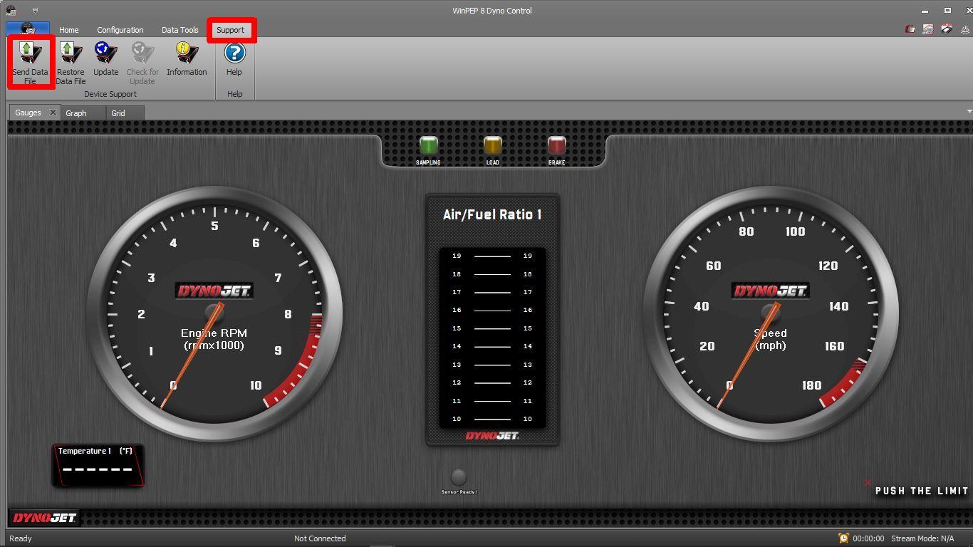

Member Contributer sfdownhill Posted February 9, 2020 Member Contributer Posted February 9, 2020 Dynojet now provides a patch that enables Power Commander V [PCV] to work with 2000-2001 5th gen VFRs! It's true! At least Dynojet says it's true. Dynojet is the company that manufactures Power Commander and has provided the file along with instructions for downloading it to a PCV. We haven't put it to the test yet, but are eagerly looking forward to doing so. Thanks to VFRD member Rob916 for poking us with a stick about this topic and getting us to post this info. We also posted this information on the 'New Performance Header" thread, but thought it worth reposting here in the 5th gen forum in case it can be of use to anyone not watching the header thread. Some may recall that a number of owners of 2000-2001 5th gen VFRs have tried Power Commander V on their motorcycles and found that with PCV, their engines ran very poorly, exhibiting rough, erratic power output and misfires. 1998-1999 VFRs seem impervious and are able to use PCV with no problems. Now, in theory at least, there is a theoretical solution. Last week Jozef Tomasovich helped connect us with Dusty Schaller at Dynojet [Some might recall that Jozef is the dyno tech at Attack Performance where we did all the dyno testing/tuning of the new performance headers]. Dusty is the product manager of Power Commander and sent the attached file along with these instructions: "You need to update the PCV to this datafile [the file attached below]. The only way to do this currently is with Power Core software using Dyno control. Open Dyno control and go to Support – Send data file. To get Power core go here - https://www.dynojet.com/downloads/power-vision-3/ Scroll down to Software" Here is the file: B16-005.02.ddat 134.02 kB · 0 downloads If anyone gets a chance to try this before we run it on our 2001 5 gen test bike, please post your procedure and results here as soon as possible. Quote

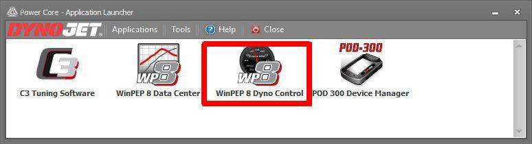

Member Contributer Duc2V4 Posted February 9, 2020 Member Contributer Posted February 9, 2020 59 minutes ago, JZH said: It looks like you need to hook up the PCV to a DynoJet Dyno to install the patch? It would be nice if this is a true solution! Ciao, JZH From the email instructions that I read, it appears that there is a software you run on your PC to install the file. Quote

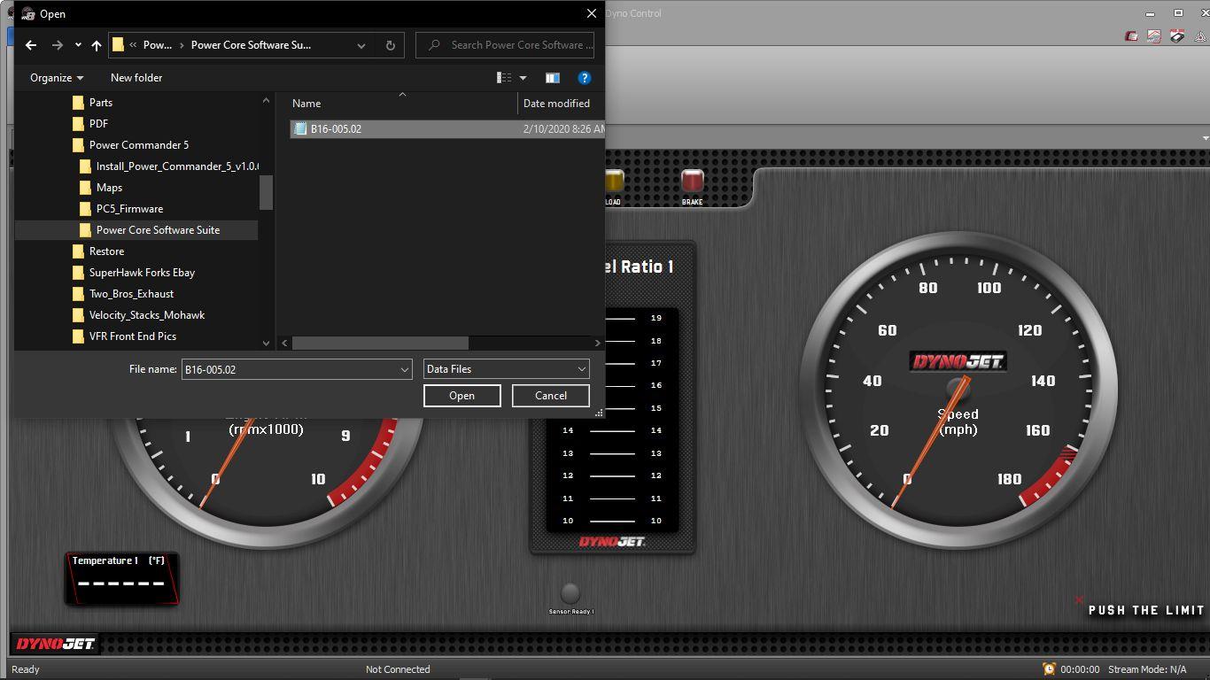

Member Contributer sfdownhill Posted February 9, 2020 Author Member Contributer Posted February 9, 2020 1 hour ago, JZH said: It looks like you need to hook up the PCV to a DynoJet Dyno to install the patch? It would be nice if this is a true solution! Good question JZH and good observation Duc2V4. You guys prompted me to take Dusty's instructions out for a test spin. The software is indeed intended to act as interface between a technician and a Dynojet dyno, but the program was free to download and came in a 123.88mb zip file. Power Core version 2.1.1 loaded easily onto my PC and includes four applications for operating and using a dyno for tuning. The Dyno Control app within the Power Core suite opened and under the support tab, the app was indeed ready to 'send data file', but I don't have a Power Commander V here to test the procedure. So the software and process are available, free, and viable, but we'll need someone with a 2000-2001 5th gen that has a PCV installed to verify that the patch file actually saves the day. Quote

Member Contributer JZH Posted February 15, 2020 Member Contributer Posted February 15, 2020 On 2/9/2020 at 4:20 PM, sfdownhill said: Good question JZH and good observation Duc2V4. You guys prompted me to take Dusty's instructions out for a test spin. The software is indeed intended to act as interface between a technician and a Dynojet dyno, but the program was free to download and came in a 123.88mb zip file. Power Core version 2.1.1 loaded easily onto my PC and includes four applications for operating and using a dyno for tuning. The Dyno Control app within the Power Core suite opened and under the support tab, the app was indeed ready to 'send data file', but I don't have a Power Commander V here to test the procedure. So the software and process are available, free, and viable, but we'll need someone with a 2000-2001 5th gen that has a PCV installed to verify that the patch file actually saves the day. I have the Power Core software running on my computer, but my PCV unit is not recognised by the Dyno Control app. The C3 Tuning app (part of the Power Core suite) does recognise it, so I believe the problem is that the Dyno Control app only looks for Dyno modules, not PCVs. So, unless I'm doing something wrong, I think we still need to work with a friendly DynoJet dyno operator and a PCV owner, to see if the patch actually works. Ciao, JZH 1 Quote
Member Contributer sfdownhill Posted February 15, 2020 Author Member Contributer Posted February 15, 2020 1 hour ago, JZH said: So, unless I'm doing something wrong, I think we still need to work with a friendly DynoJet dyno operator and a PCV owner, to see if the patch actually works. Sounds about right. Quote
Member Contributer Tirso Posted February 21, 2020 Member Contributer Posted February 21, 2020 The patch worked on my '99*. installation is easy and can be done with Windows computer. I called Dynojet and worked with Danny Boardman Powersports Technician You'll need: 1) PC5 to update connected to computer, motorbike off 2) The file (B16-005.02.ddat) downloaded on the computer you will use to update the PC5 3) Dynojet Power Core installed on the computer you will use to update the PC5 4) After install, start Dynojet Power Core 5) At "Power Core Application-Launcher" Select "WinPEP 8 Dyno Control" 6) At "WinPEP 8 Dyno Control" window, select the "Support" tab then "Send Data File" button 7) A pop up window will appear asking for location of "B16-005.02.ddat" '8) Select the .ddat file, press the "Open" button and start update 9) After the update, close all Power Core applications, important as you can not continue to next step if any Power Core applications are open 10) Open "Power Commander V Software" and load your PC5 with a zero map or any map of your choice 11) Go for a ride I suggest checking starter valves. I set mine a few weeks ago after "Wade Header" install and once home after update, I found 3 and 4 were significantly off while 1 and 2 were spot on. Idle increased from 1,200 rpm to 1,300 rpm * My '99 was originally a Calif bike with California ECU 38770-MBG-771 and California cams. In Oct '19 with 11.8k miles, converted to EU ECU 38770-MBG-003 and 49 state cams. I ran the '99 in this configuration with stock header and Staintune without issue. In Jan '20 I replaced the stock header with the "Wade Header", again no issue. In Feb '20 I installed PC5 (SKU 16-005) and had issues similar to SFDownhill's when he had his '01 initially Dyno'd with prototype headers at Attack. (see below) After the update, I loaded the PC5 with a zero map and went for a ride. A few hard pulls by the Richmond Shipyards convinced me all was well. I changed the zero map to the Attack map provided by sfdownhill and my VFR was transformed. New 5th/6th/8th gen performance header now in production in USA New 5th/6th/8th gen performance header now in production in USA 4 3 Quote
