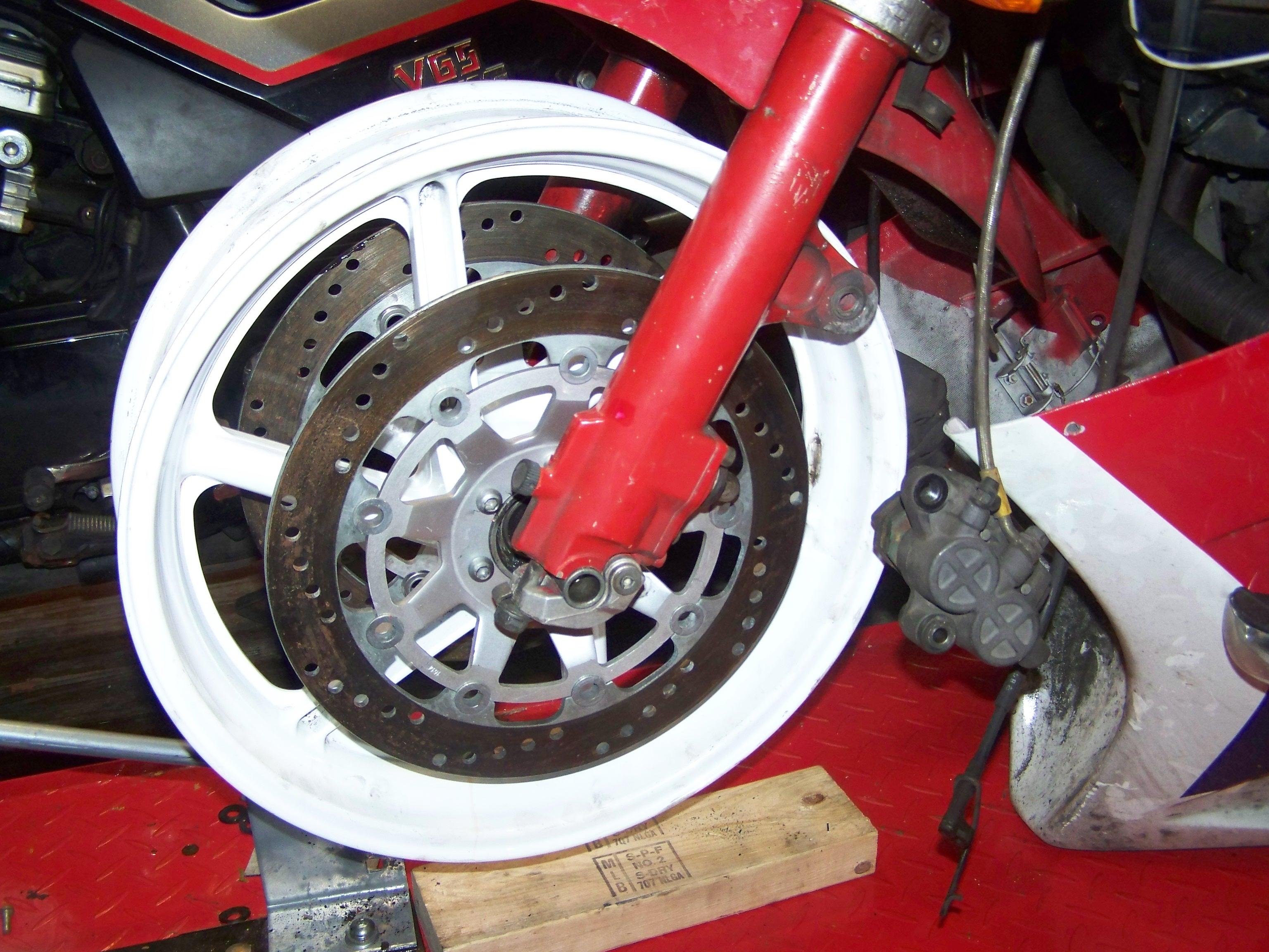

Member Contributer Captain 80s Posted September 17, 2019 Member Contributer Posted September 17, 2019 5.5" X 17 Rear. 3.5 X 17 Front. 4 Quote
Member Contributer Captain 80s Posted December 26, 2019 Author Member Contributer Posted December 26, 2019 Trying to make some progress. Swapping in the new shock that can provide the needed ride height. I have a couple fuel filters arriving tomorrow... look at that tasty 'orange' unit hanging there. When the fuel filter is in the center of the bike it probably doesn't get the love it should. Here's the shock progression: Stock (400mm) / CBR600F2 DMr conversion with Hyperco spring (about 407mm) / YSS 405 set at about 412mm (it's technically a +/-5mm shock but I added a couple mm, there's plenty of clevis rod engaged in the shock and it's right at the limit mark, could probably add a few mm if needed no prob). The DMr shock will go in my 8K mile 1986 VF1000R (perfect.. couple mm longer than stock) and I'll wrap up the stock shock. I'll keep the dampening adjustment cable and air hose mocked up for a stock appearance. 1 Quote
Member Contributer Captain 80s Posted December 27, 2019 Author Member Contributer Posted December 27, 2019 Shock installed with the stock wheels while I finish ($) the forks, rims, spacers and buy tires. I have an extra set of low mileage 1000F forks that I'm going thru so I can just swap out when the wheels are done. Gold Valves and RT springs with the cross over eliminated so they can be slid up in the triples like these. These forks will probably end up on a VF750F for a 41mm upgrade. 2 1 Quote

Member Contributer Captain 80s Posted January 2, 2020 Author Member Contributer Posted January 2, 2020 On 12/31/2019 at 6:14 PM, FromMaine said: That is a really nice job, and it opens up a world of rubber choices now. IMO, getting modern rubber on these old bikes is the single best mod you can do. That was the motivation. And just to do something different. The wheels also allow utilizing the same rotors (actually CBR600F2) and calipers and helps keep the scope of the swap smaller (especially on the rear). The 5.5 rear is tight and forces me into a 170, but I really didn't want to do another F2/3 swap, especially in white. Ugh... the RC26 wheels are getting a matte black treatment just because those stupid (awesome) wheels are a bitch to keep clean. 1 Quote
