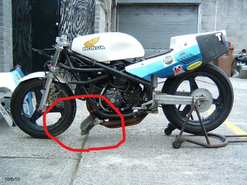

Just note that the RC30 sprockets are narrower than the modern VFR sprockets (not sure about your model), for 525 chains rather than 530 (apparently also called "chain 50" sometimes).  And there may be other OEM sprockets out there (that's my graphic, btw); those were just the ones I found in the JT sprockets catalog, I think.
Ciao,

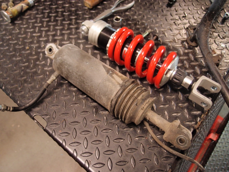

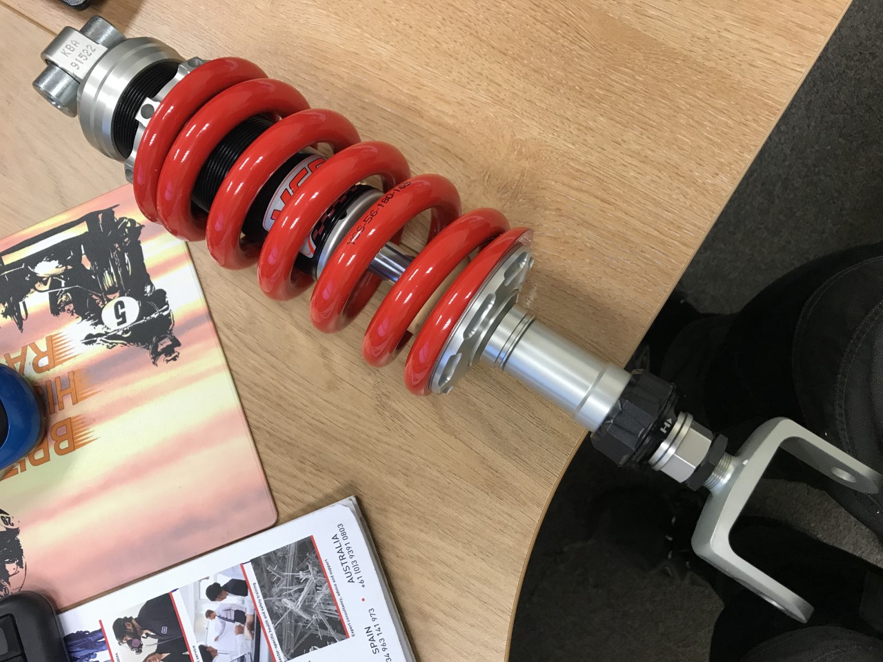

Nice one!  bought one for my VF500F2 couple of years ago
How have you found the YSS shock, I've not had much dealings with them, but they have good reports.
I've been very pleased with it (put in RaceTech srintgs and emulators upfront).

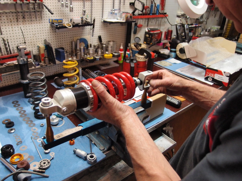

I dealt with a man who is an highly regarded suspension guru and works as a consultant for YSS too, visiting the factory in Thailand regularly.  The OEM unit is thoroughly shagged...
He had the compoments inhouse so he built mine. But I am confident that what comes from the factory is as good as.
The other brands (he sells those as well) like Hyperpro, Wilbers (I had one on redslut) were dearer for what I perceive as no better quality.

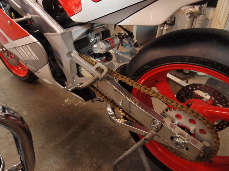

setting the shock's height
Another YSS (his bike)
and upfront for good measure.

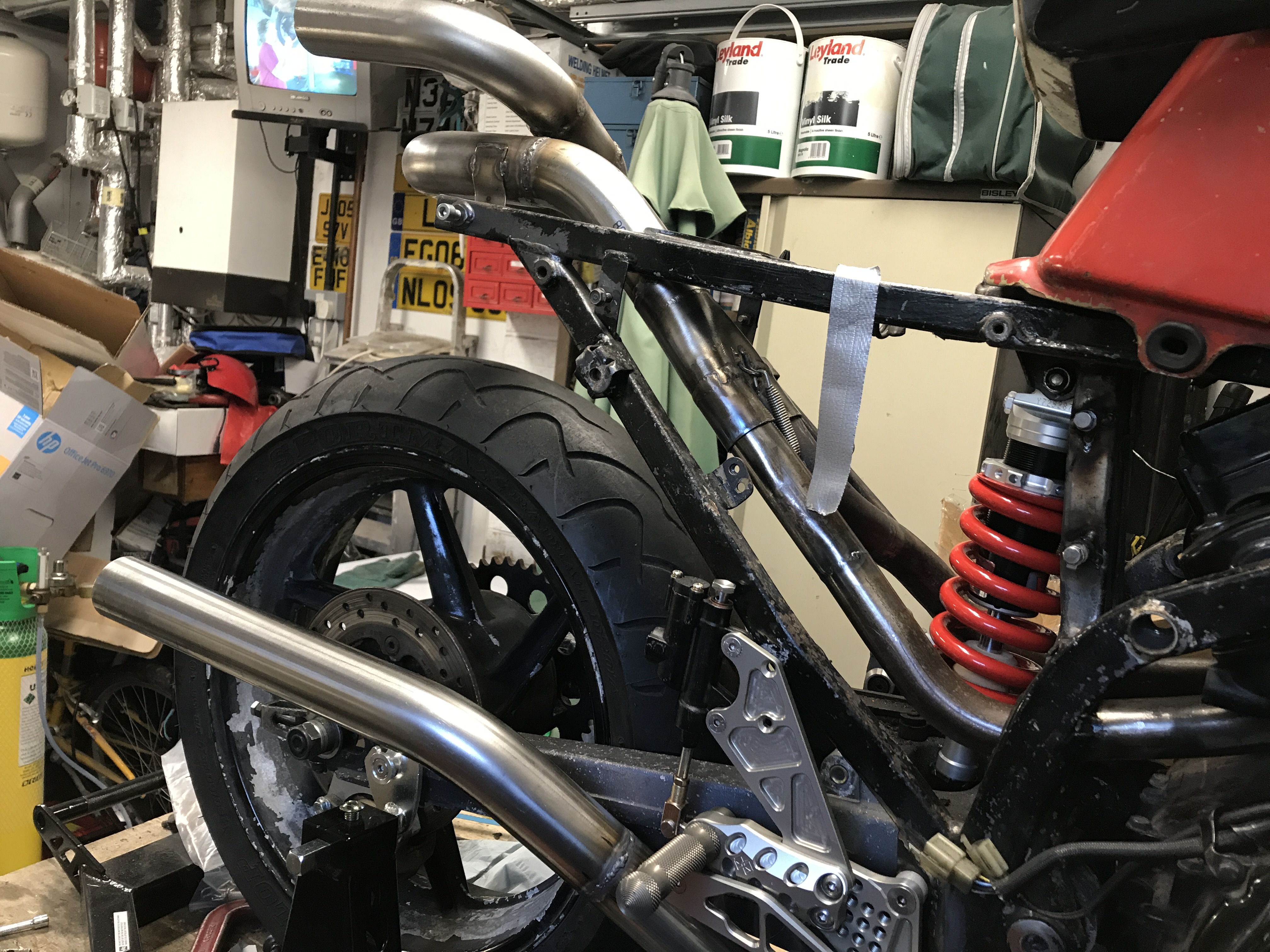

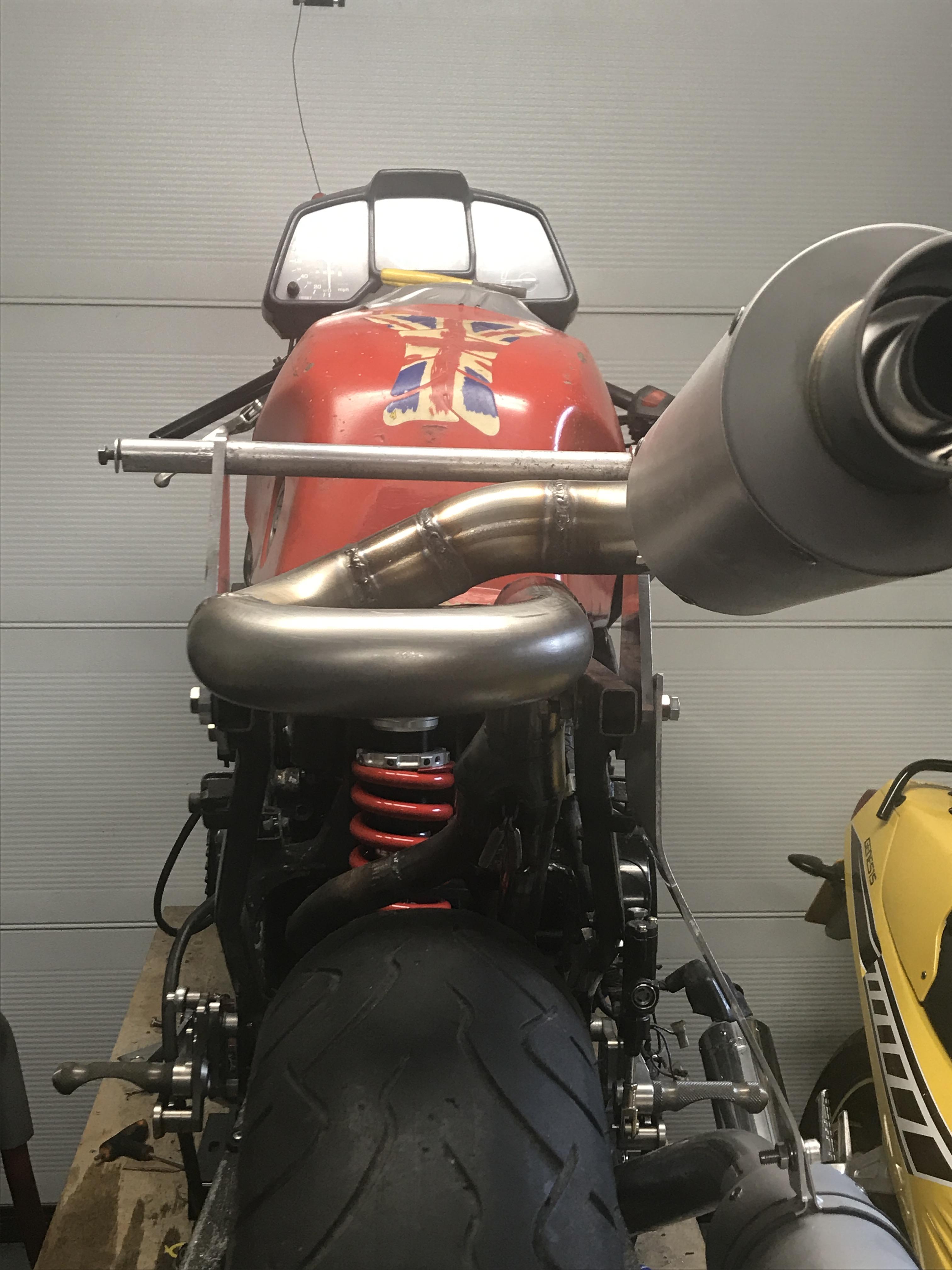

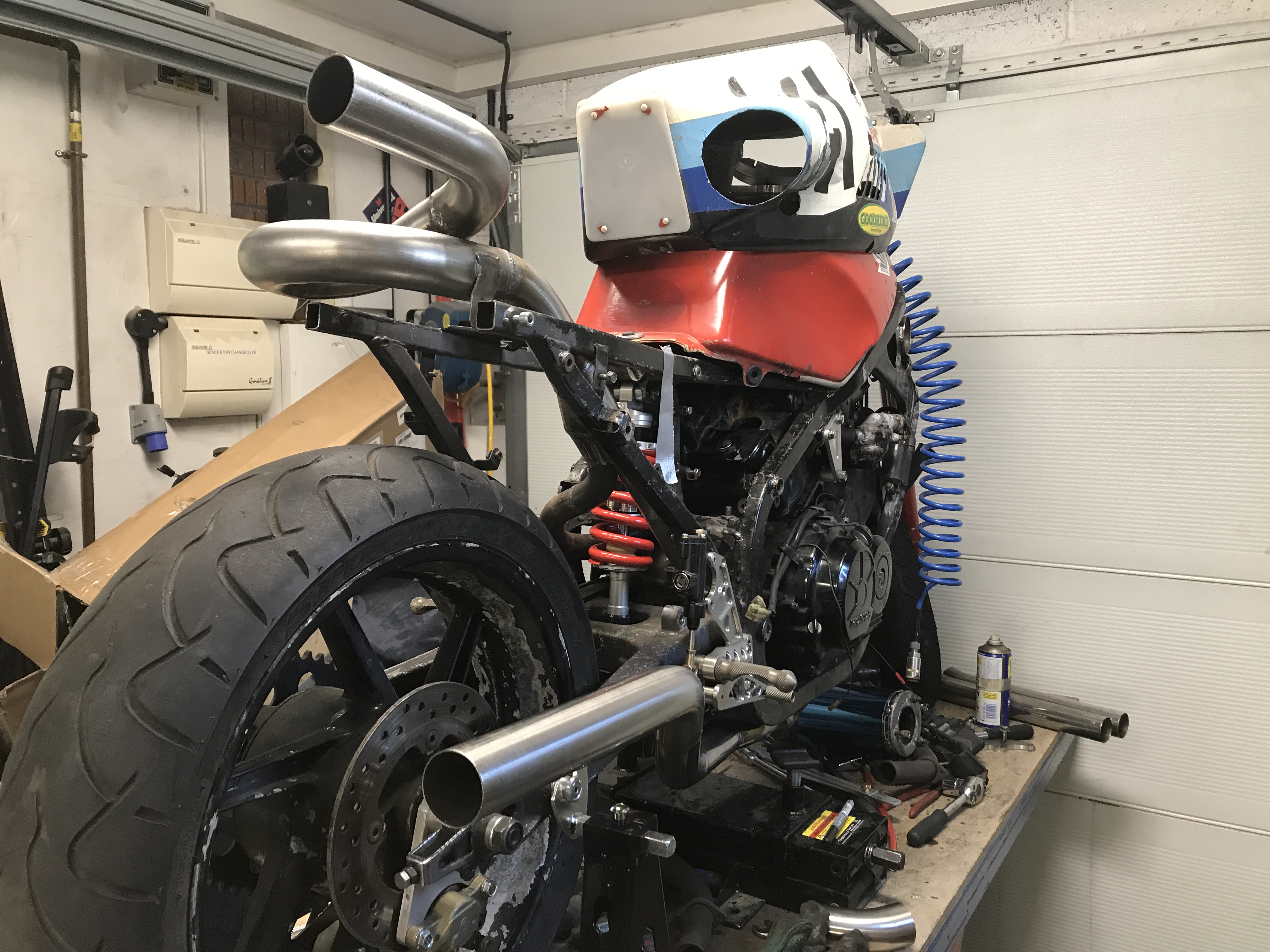

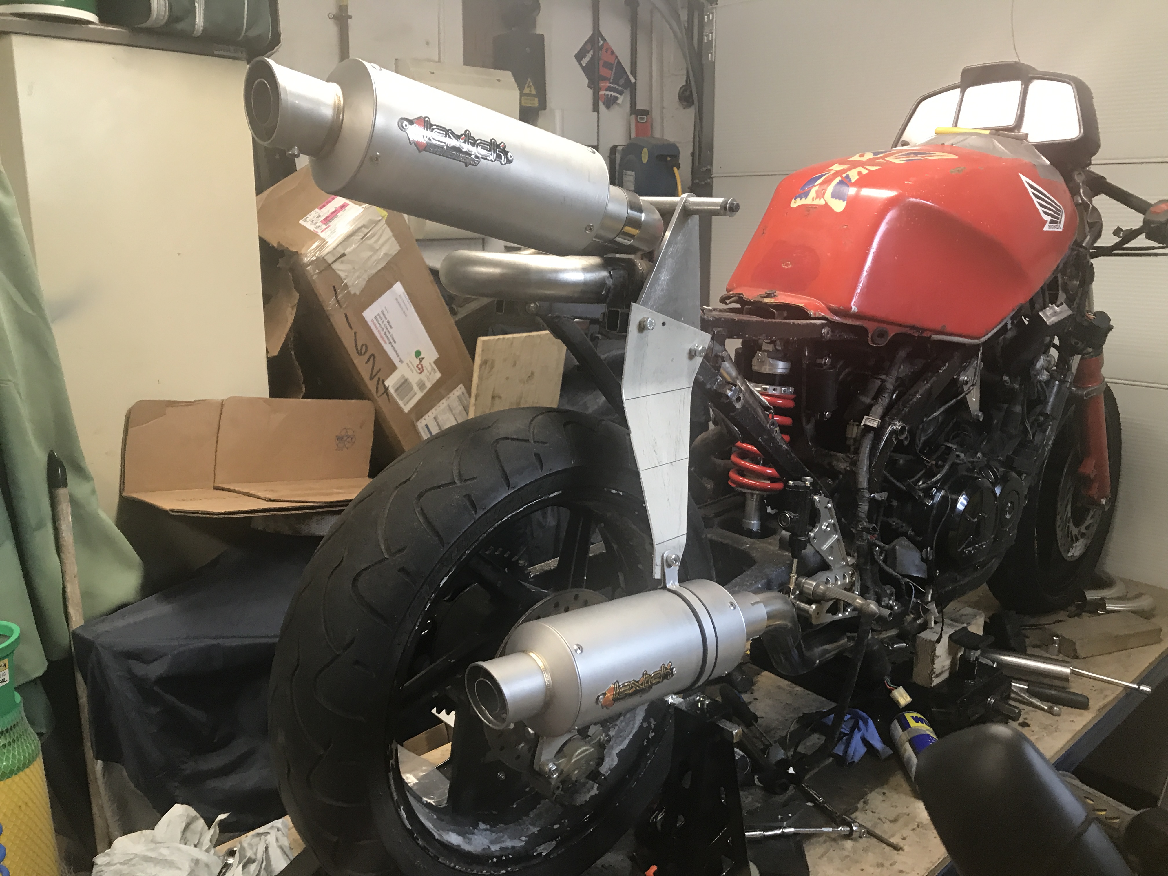

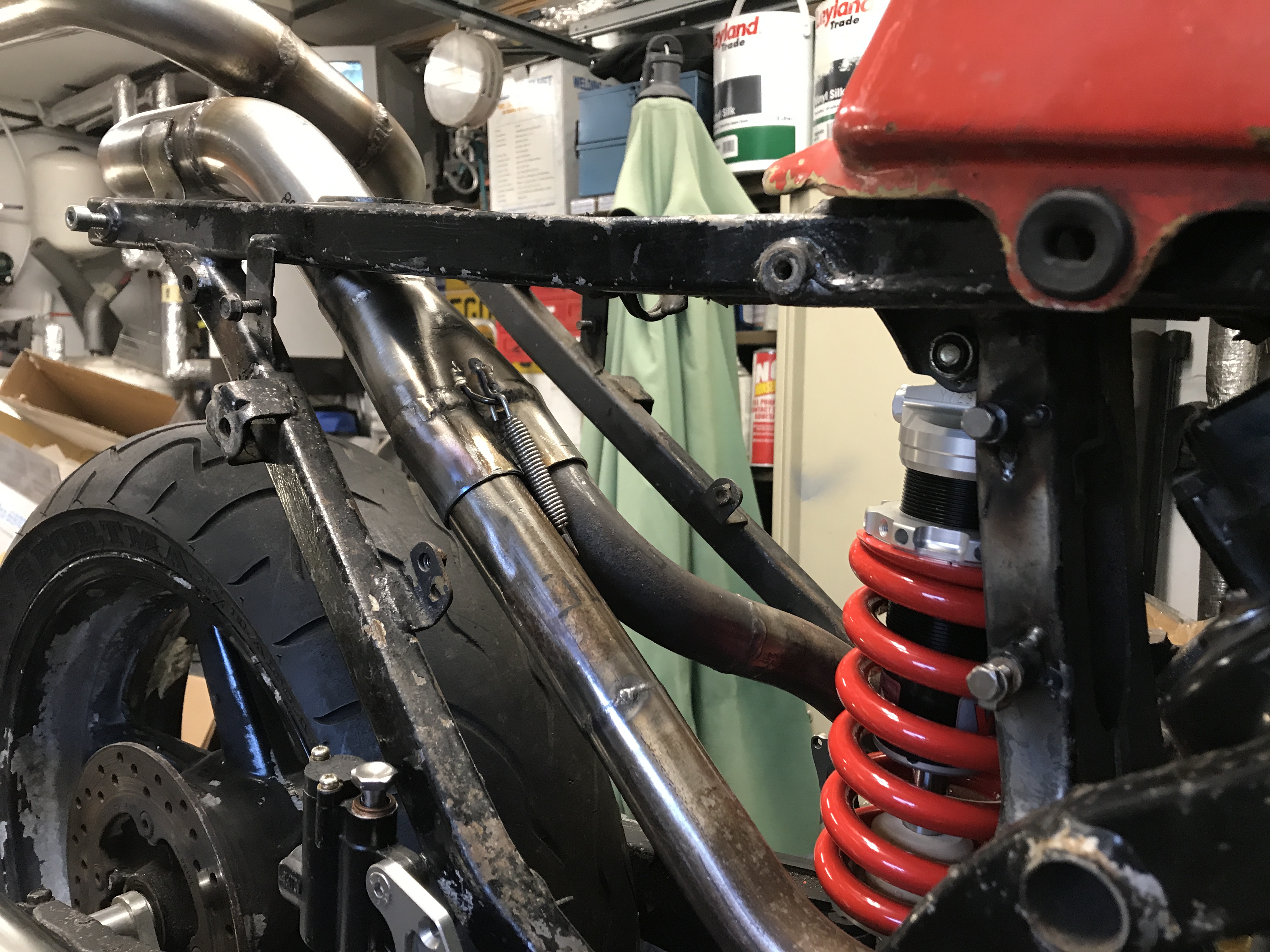

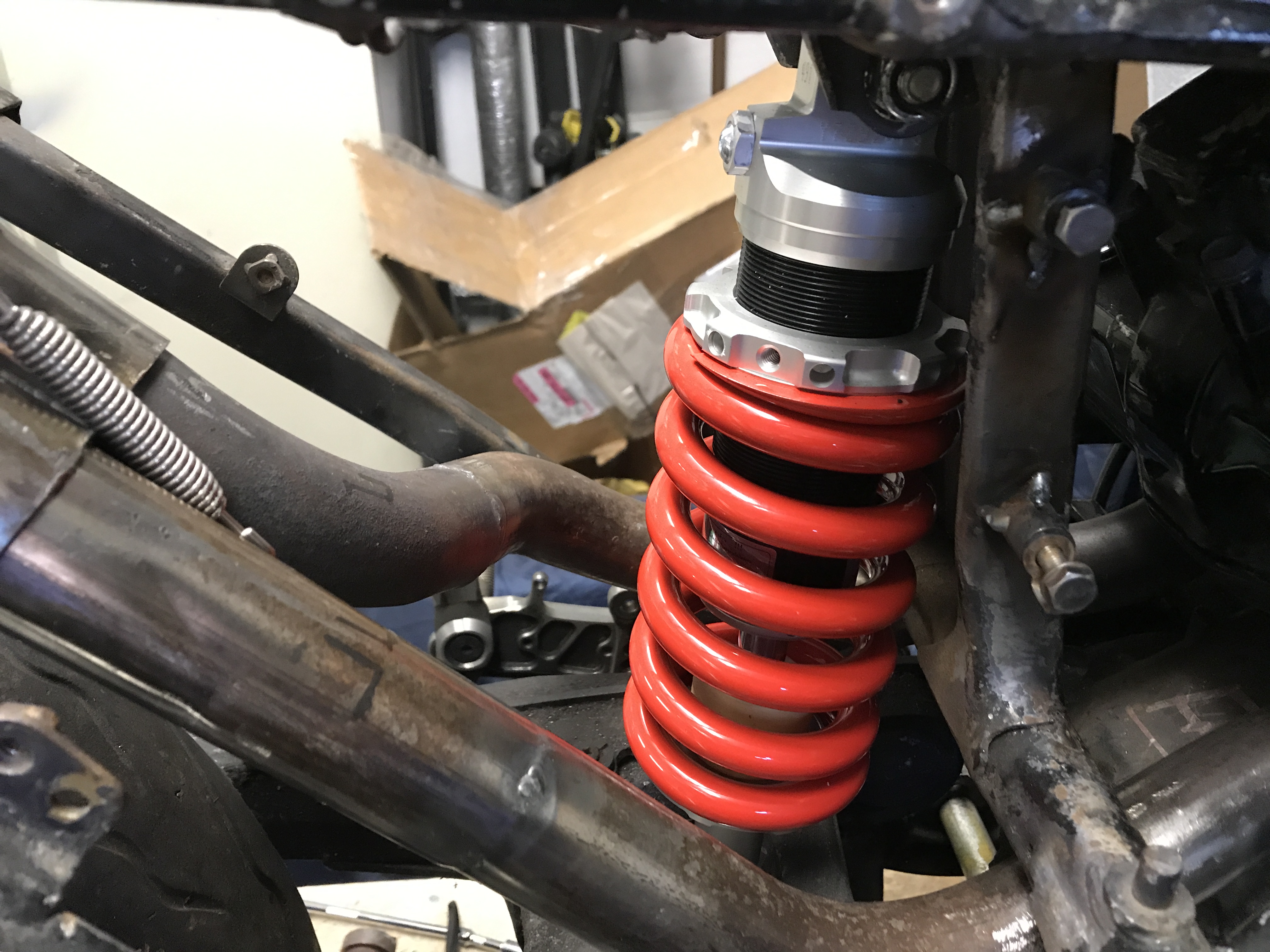

I think I'm starting to make some progress with the exhaust, I've had a good afternoon. the upper one just needs some spring hooks welding on and the lower needs the left header altering and then on to the silencers.
IMG_1855.thumb.JPG.5c363d3f0341083d3b334ded42e0c51a.JPGIMG_1859.thumb.JPG.5f07a04ba9a7d4ba148d5ad1ddb503b5.JPGIMG_1854.thumb.JPG.9323253a732ccd5fa2caddf05f0d08da.JPG
A little look at the new shock with the exhaust wrapped round itIMG_1857.thumb.JPG.1bfd77368b219511b2eaa8ce3248a754.JPGIMG_1856.thumb.JPG.2d8c4fd3b8f0279b76e9d6f4b769adc4.JPG

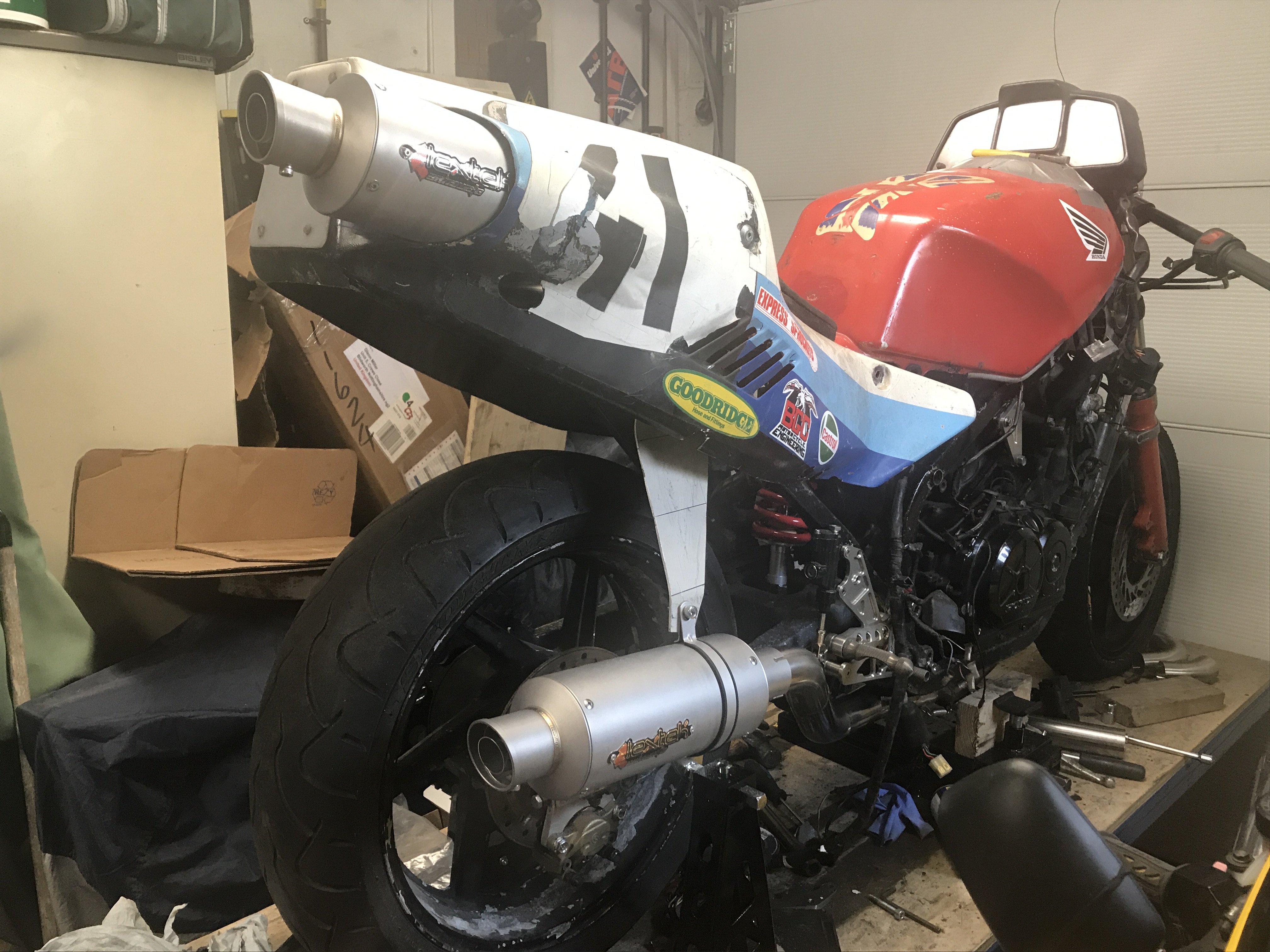

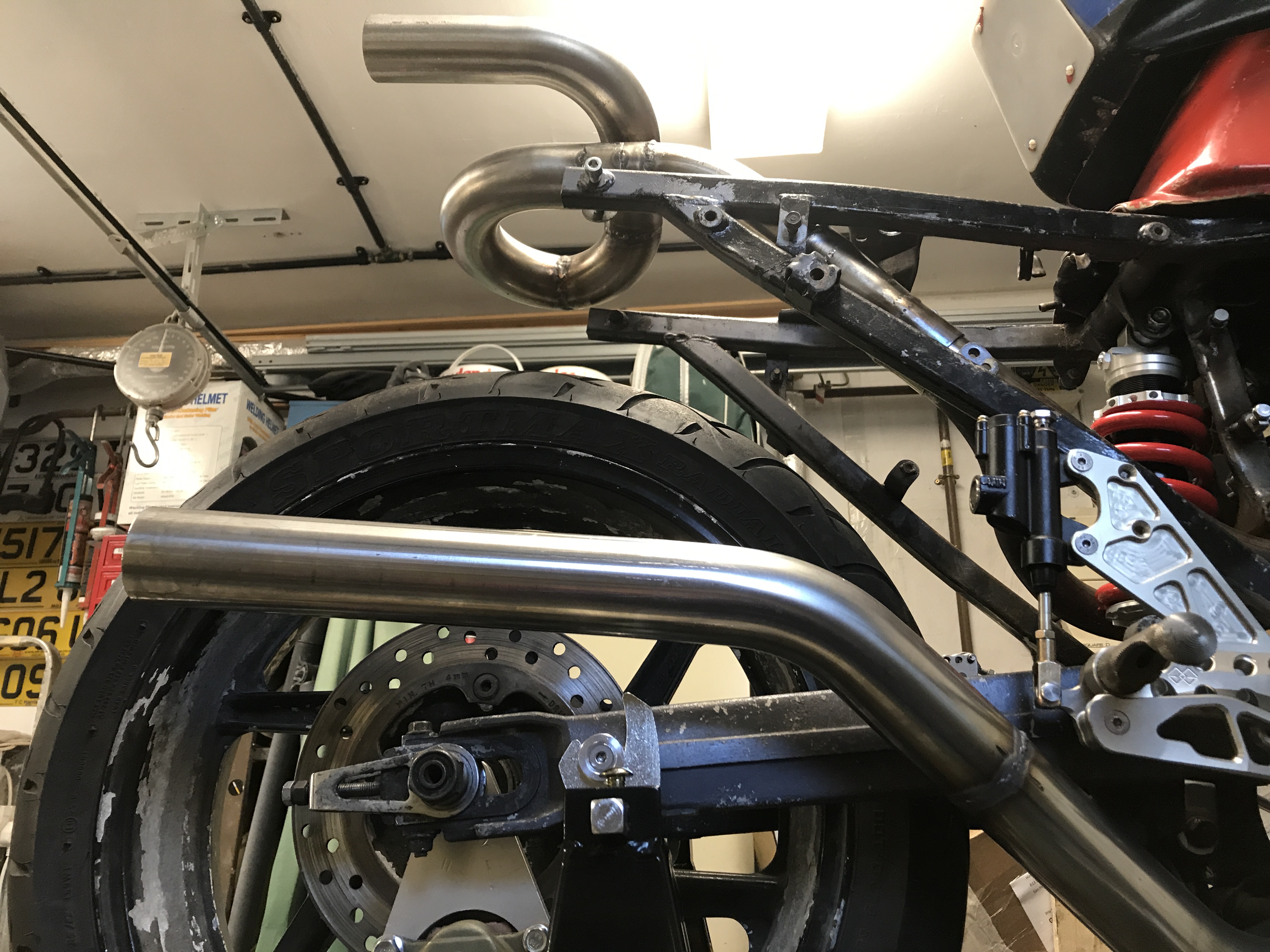

Finally managed to get a little work done on the RS today, made a ruff cut out for the lower silencer bracket, seat mount made just got to make a couple of lugs for the front of the seat.
Started on the rear caliper torque arm  (more parts ordered). I've attached a couple of photos with and without the seat fitted.
IMG_1867.thumb.JPG.daaf450118a249c9b5824a820218b9c3.JPGIMG_1866.thumb.JPG.dd5b31722a80814c203c988f8f615ce6.JPGIMG_1868.thumb.JPG.df7ed7f21a00748156a1999408ed44b1.JPG

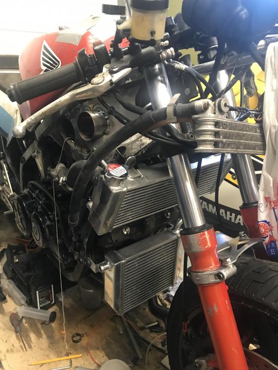

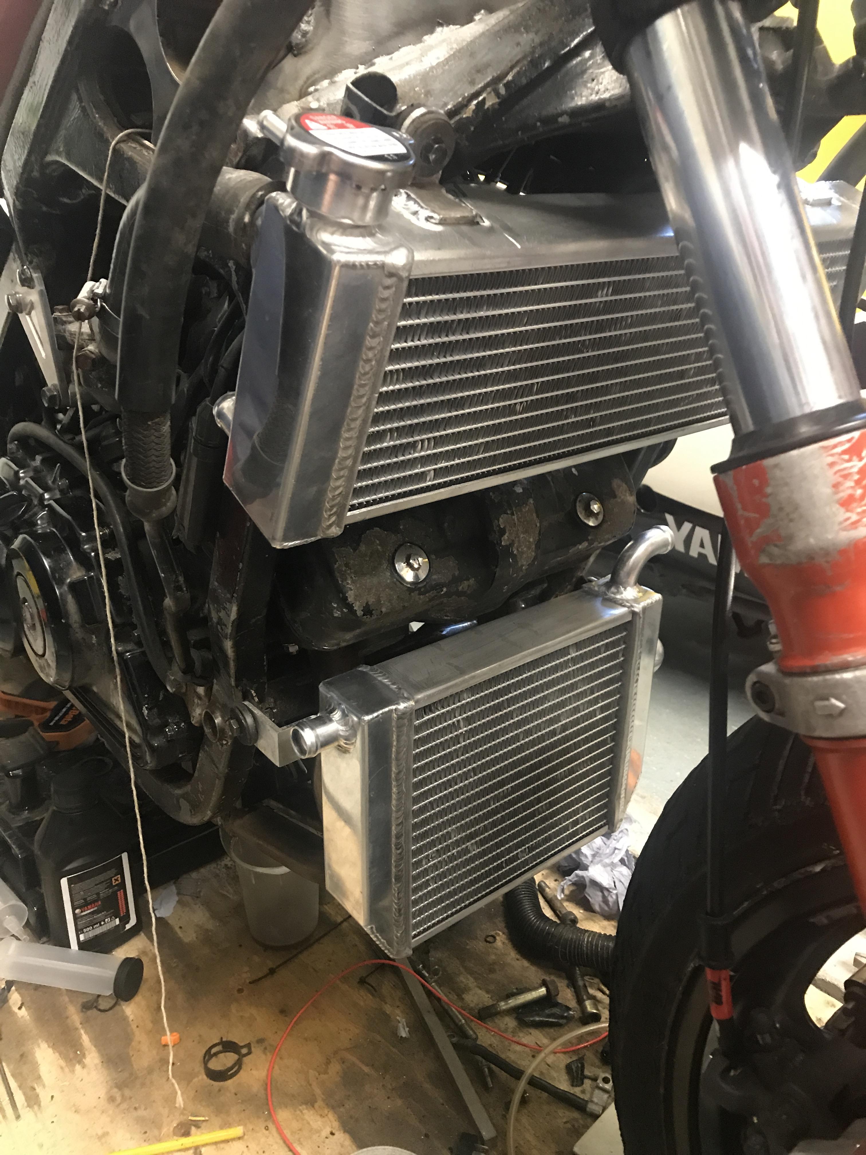

Just a little update, Friday was my day off so had a couple of hours on the RS, after a few false starts ( sorting oil leaks out that the engine didn't have last time it ran) & with a home made fuel tank we had some life, it ran for a while but I couldn't run it too long as I didn't have the radiators fitted, just got them back today from having the mounting brackets altered so just a test fitting. I have been on with altering the wiring loom mounting ECU fuse box, starter solenoid and trying to find where to put the battery etc.
just a few photo's

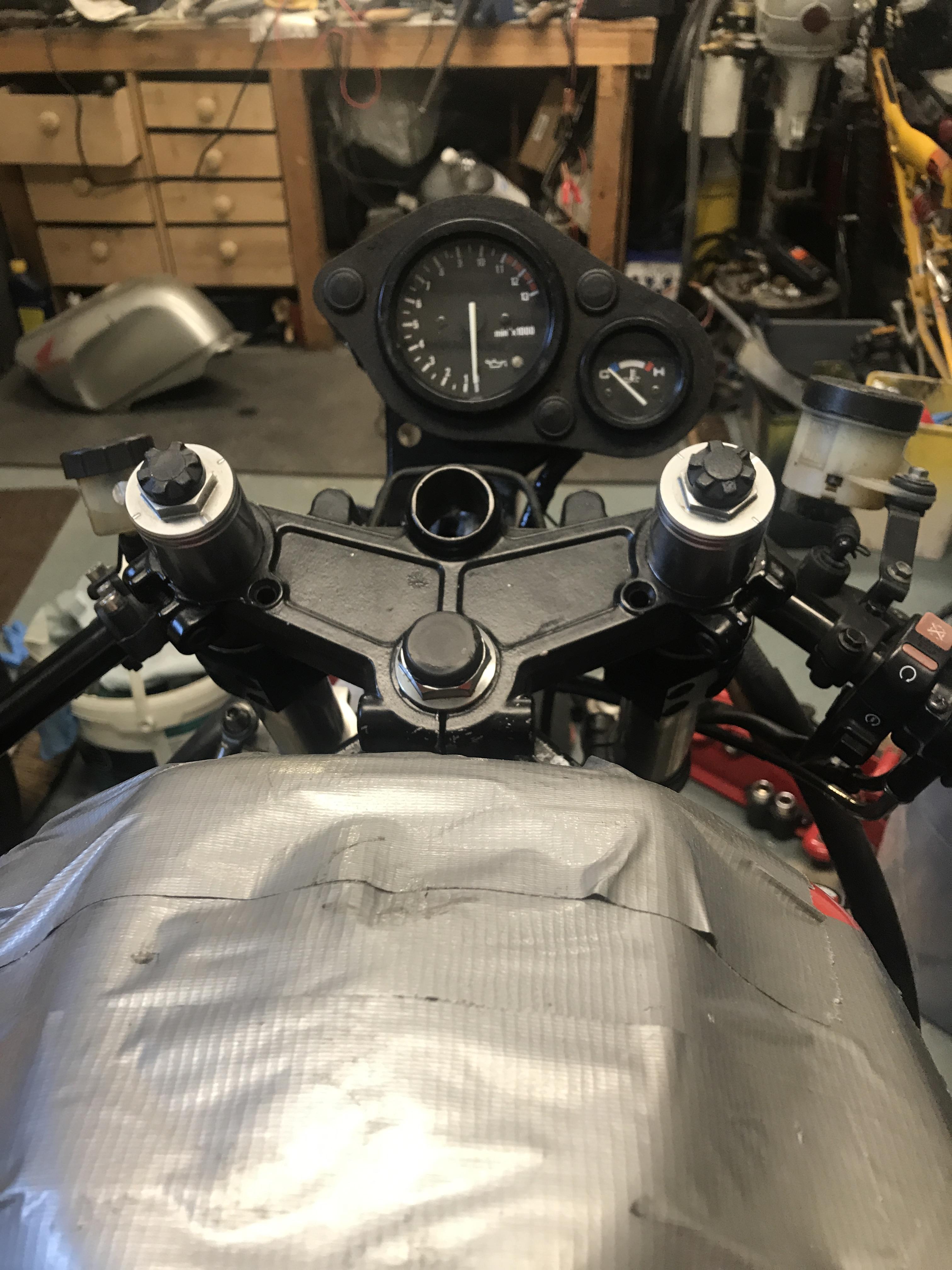

 IMG_2025.thumb.JPG.200b480e078e5577fe24704bbc11f83d.JPGHonda 125 ? clocks with RC24 internals, CBR switch gear.
VFR400 (NC30) radiators with mounting brackets altered, one of the next jobs is the oil cooler, either re mount the standard or sort new one, it should look like this though.

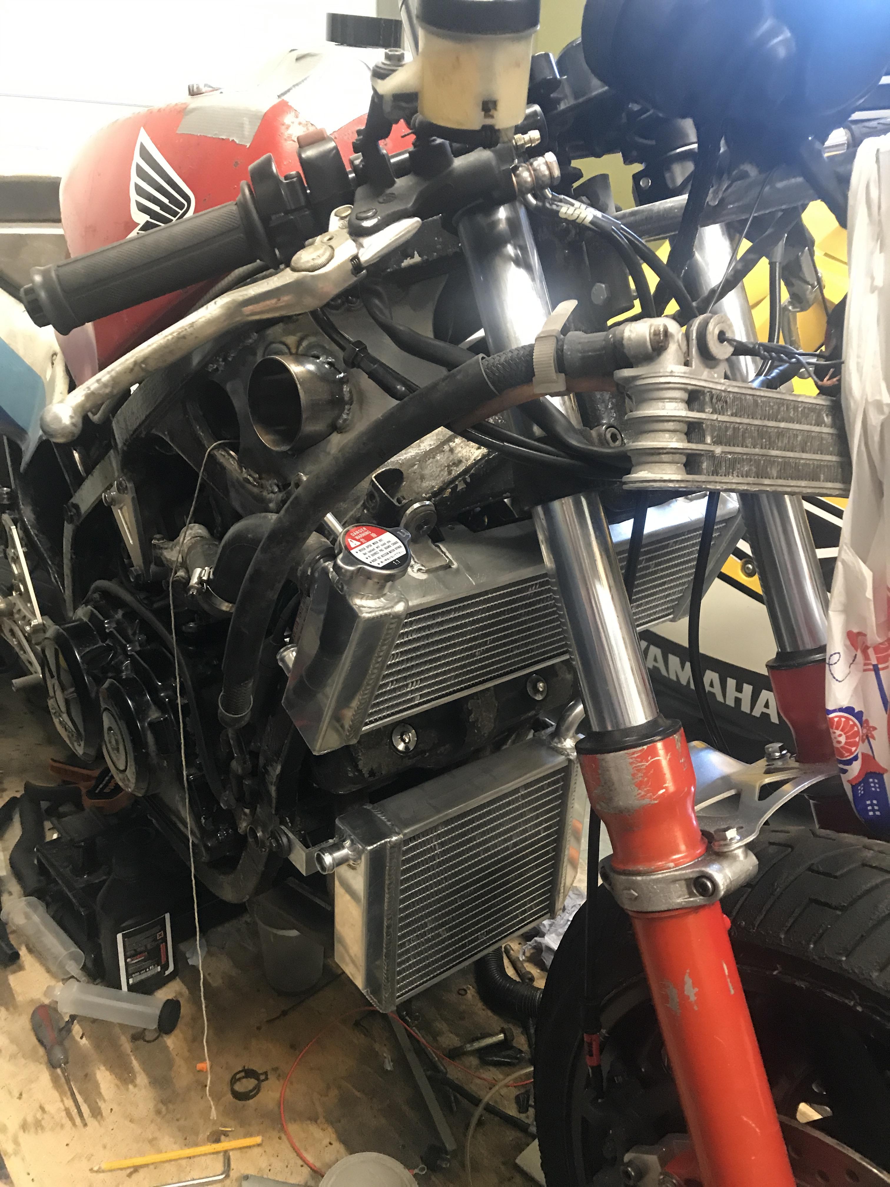

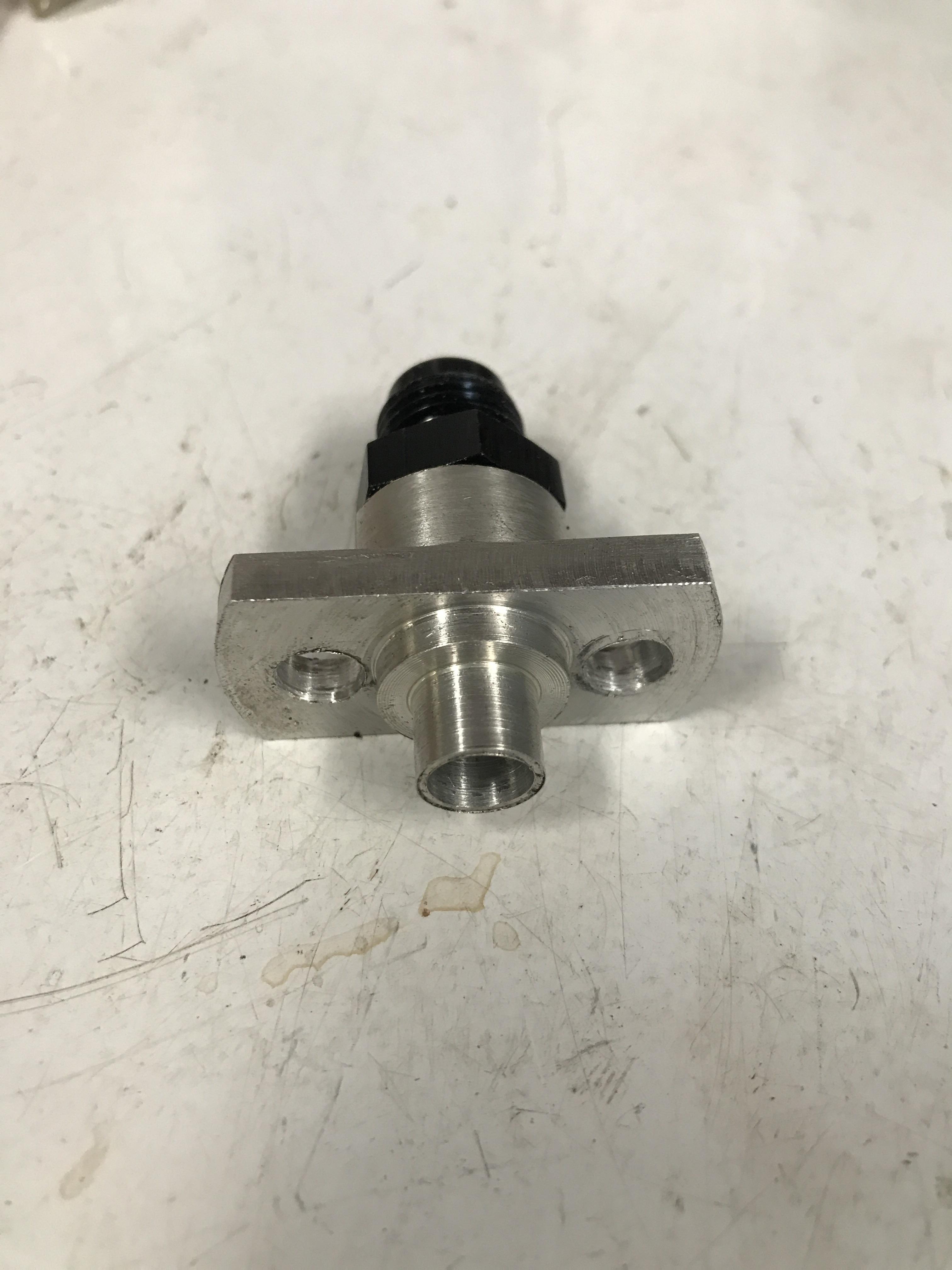

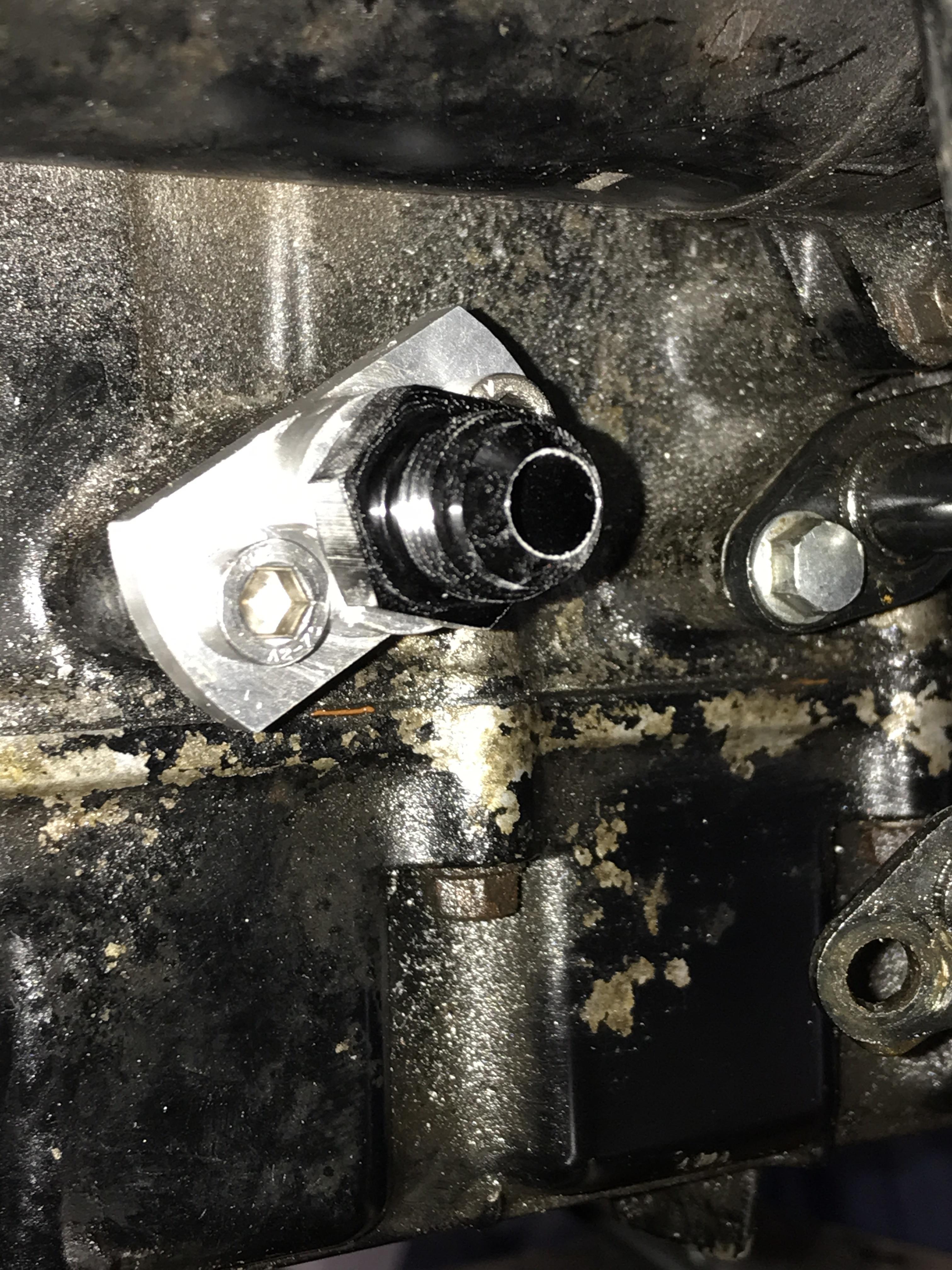

I've been busy today I've made some oil cooler take off adaptors and am fitting a cooler
