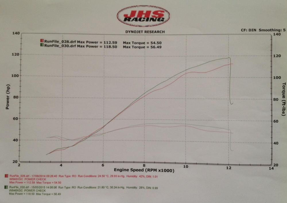

Member Contributer sfdownhill Posted May 1, 2018 Member Contributer Posted May 1, 2018 Hell, I'm in little plastic Honda pouches myself, at this point of the wild goose egg treasure hunt for VFR headers. I just searched for Mohawk's build to see if he did 'before Two Brothers headers vs after Two Brothers headers' dyno runs. I found the 34 page long thread calledPotential Re-Release Of Two Brothers Racing Vfr800 Headers where way back in 2014 Duc2V4, you [Rush2112], CandyRed, HighsideNZ, mello dude, Mohawk, voided76, Veefer800canuck, MadScientist, VFRcapn, KevCarver - basically everyone who's anyone on vfrd - was participating in a header thread. Fascinating header history. Quote

Member Contributer Mohawk Posted May 1, 2018 Member Contributer Posted May 1, 2018 6 hours ago, sfdownhill said: I wonder what type of crush or flat gaskets were originally supplied with the Two Brothers headers? Rush, thanks for the ST gasket suggestion - I'm curious how that works. Have you used ST gaskets on a VFR before? None supplied. I used GSXR750 ones as they open the port fully & seal better on the TBR Headers wider pipe, with less lip so it still fits the header port. The GSXR washers are the same size squashed as the VFR ones not-squashed. The TBR headers added 8hp all other mods were left the same, just added the pipes & manually adjusted the fueling using a wideband sensor & gauge plus my memory whilst riding to tweak it before the dyno run. Plus I was looking at a Ladybird RC45 HRC copy in Ti from Japan, but when I checked the pipework its the same ID/OD as the TBR, so apart from being 2x 2-1 compared to the TBR being 2-2-1 its about the same the. the HRC would be best for ultimate power, but the TBR is pretty close & the RC45 left exist will NOT fit without some monification. YMMV. Quote

CandyRedRC46 Posted May 1, 2018 Posted May 1, 2018 8 hours ago, sfdownhill said: Hell, I'm in little plastic Honda pouches myself, at this point of the wild goose egg treasure hunt for VFR headers. I just searched for Mohawk's build to see if he did 'before Two Brothers headers vs after Two Brothers headers' dyno runs. I found the 34 page long thread calledPotential Re-Release Of Two Brothers Racing Vfr800 Headers where way back in 2014 Duc2V4, you [Rush2112], CandyRed, HighsideNZ, mello dude, Mohawk, voided76, Veefer800canuck, MadScientist, VFRcapn, KevCarver - basically everyone who's anyone on vfrd - was participating in a header thread. Fascinating header history. Mohawk's motad vs two brothers header dyno. Quote
