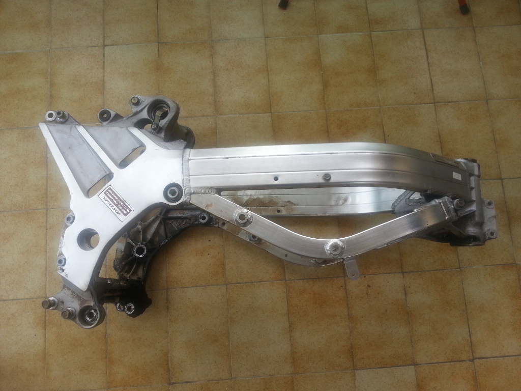

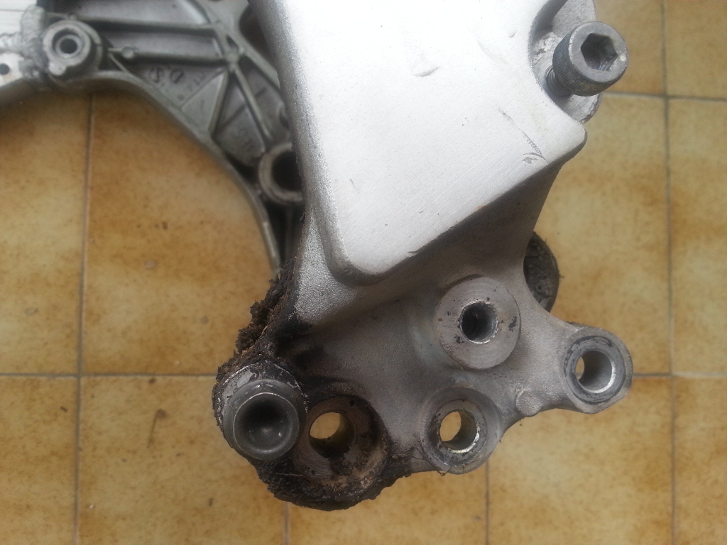

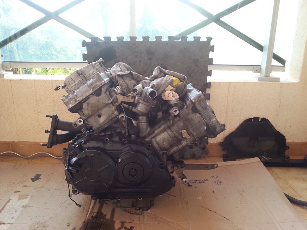

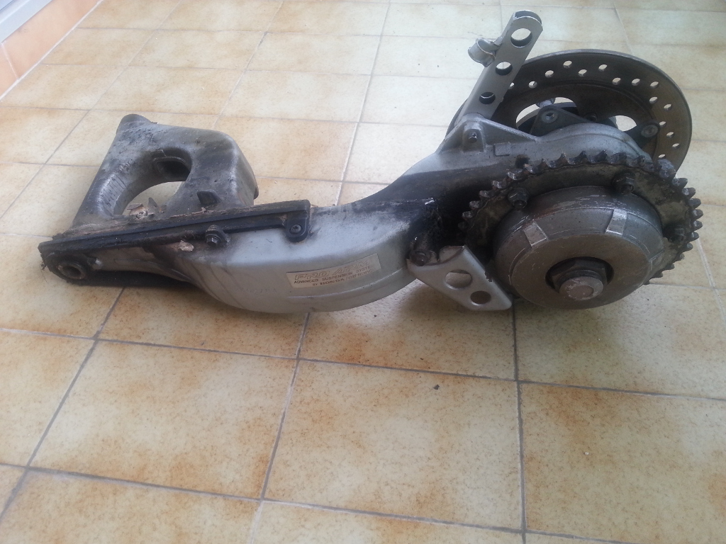

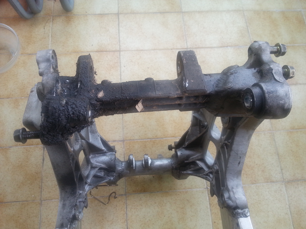

bdouvill Posted December 25, 2015 Author Posted December 25, 2015 (edited) Thanks for your answers about the front axle, this was pretty straightforward indeed 😉 And now, some pics as promised. 1st: frame arrived on my balcony, engine felt a little bit lonely 😉 As you can see, still some mud on it but mainly grease from the chain and I suspect still a little bit of water inside. My plan is to remove most of the grease/dirt then probably "carwash" it, then let all water get out... Also, I kill a thread when removing the side stand. Not sure the 2 remaining bolt are enough with the weight of this beast... The swingarm needs some cleaning too. Don't have 46 mm socket yet. Will see the internal later. On front end, I have both front wheel bearing toasted. Rust does not come from the few days in water but from the 20+ years of usage. Front tyre is also dead, almost flat on the left side: I did not plan on changing the front tyre before I am able to crack the engine, but I will definitely not ride it either this way... Rear tyre still got some life in. Also, stem bearings also need a replacement from its past usage, there are both rusty. Edited June 7, 2018 by bdouvill Broken links to pictures Quote

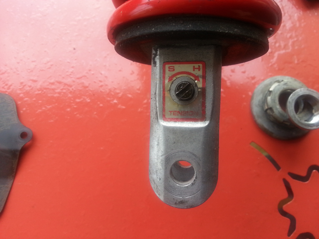

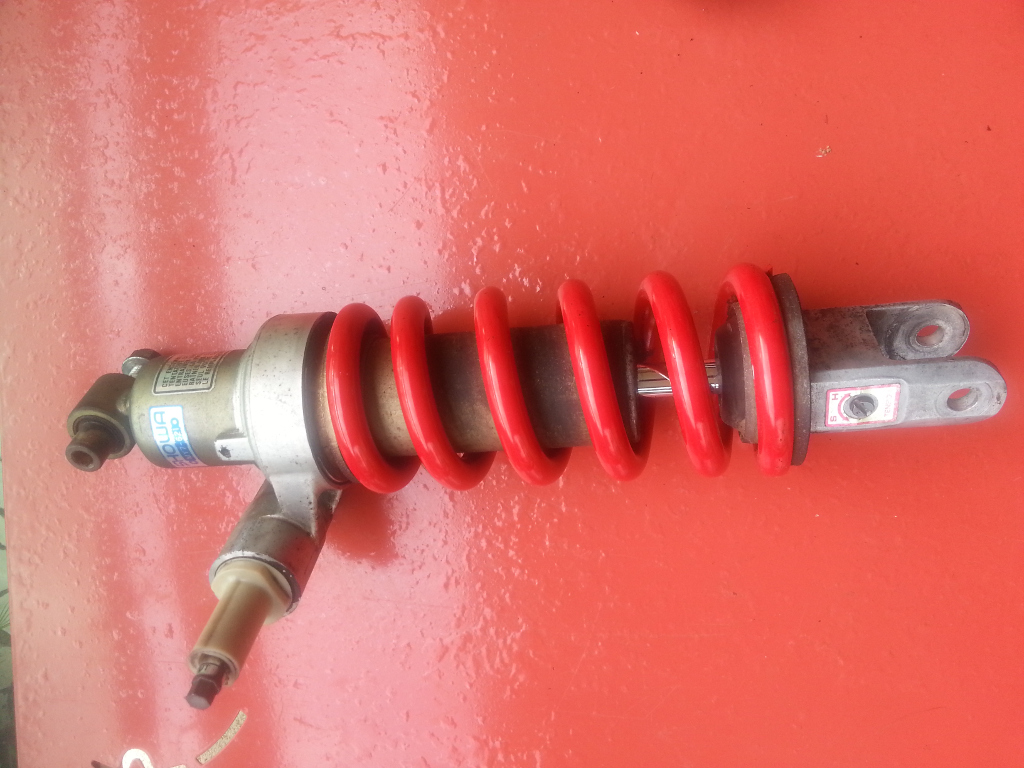

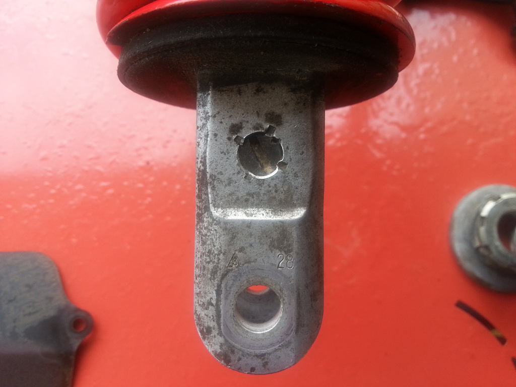

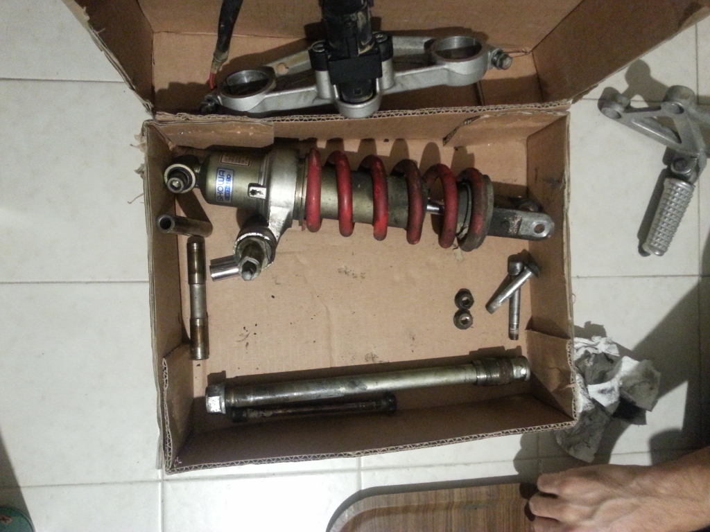

bdouvill Posted December 25, 2015 Author Posted December 25, 2015 (edited) More pictures: Shock before and atfer my wife stroke, I guess you'll find which one come before/after 😉 Preload adjuster works fine. But the screw at the bottom does not turn at all: I guess this is not normal. I would say it is the compression setting, can anyone confirm? Also on the opposite side, you can see this: I am not sure whether this is the same screw as the marks suggest the screw can not be turned/moved. On page 1-13 of the service manual, it is written that shock has both a compression and a rebound adjuster. Until now, I can not figure where is that rebound adjuster (assuming the previous screw is really the compression adjuster). I cleaned and regreased the rear suspension linkage. Thanks to the seals, all bearings are in good condition, no water ever came in 😉 Also, I removed a metal plate from the left side on the frame, I have no idea of its function. Is that to deviate air to the regulator or something? The 2 marks are light rust. I have no mean to sand it, will see what I can do with this. To finish, picture of myself fighting in the garage (until then, I won). Edited June 7, 2018 by bdouvill Broken links to pictures Quote
Member Contributer RC36Rider Posted December 25, 2015 Member Contributer Posted December 25, 2015 Screw at the bottom of the shock is really a combined low speed rebound/comp adjuster. It should turn really easily. Quote
bdouvill Posted December 25, 2015 Author Posted December 25, 2015 Screw at the bottom of the shock is really a combined low speed rebound/comp adjuster. It should turn really easily. I know. I had a GSXR 750 Showa shock on my Bandit 400 and you could easily adjust the screw position. But here, nothing happens. Can it be linked to the marks at the back that prevents the screw from turning? Quote
Member Contributer RC36Rider Posted December 25, 2015 Member Contributer Posted December 25, 2015 That looks like peening rather than accidental damage but I'm not really sure. I have a 4th Gen shock lying about at home. I can take a look tomorrow night if nobody has an answer until then. Quote

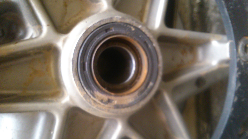

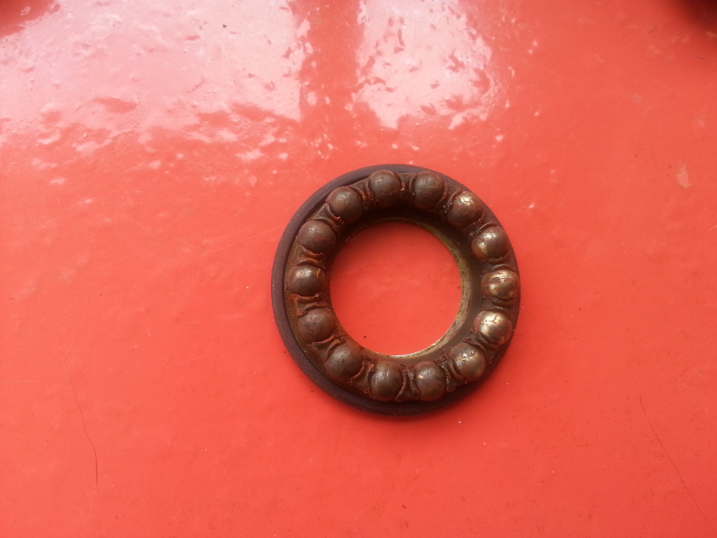

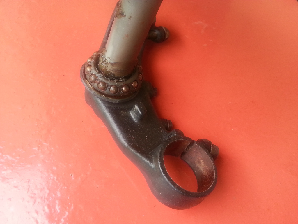

bdouvill Posted December 27, 2015 Author Posted December 27, 2015 (edited) For front wheel and steering bearing, I found that All Balls Bearings make some replacement kits that seem widely available in Europe thanks to Bihr dealers. Any comment to prevent me from ordering and rather go for Honda parts? Edited December 27, 2015 by bdouvill Quote
Member Contributer gll429 Posted December 27, 2015 Member Contributer Posted December 27, 2015 For front wheel and steering bearing, I found that All Balls Bearings make some replacement kits that seem widely available in Europe thanks to Bihr dealers. Any comment to prevent me from ordering and rather go for Honda parts? all the shops i have worked in use all balls . as for the neck bearings.. go for the tapered roller kit. Quote
Member Contributer RC36Rider Posted December 28, 2015 Member Contributer Posted December 28, 2015 Can it be linked to the marks at the back that prevents the screw from turning? It definitely does not turn along with the adjuster screw on the other side on my 4th Gen shock. Seems that it is just a plug that is peened in place to prevent tampering while the shock is under nitrogen pressure. Quote
Member Contributer JZH Posted December 30, 2015 Member Contributer Posted December 30, 2015 All Balls are okay, but they tend to use no-name bearings in their kits (unlike Honda). Bearings are fairly standardised parts, so if you can find an automotive bearing supplier in your neck of the Med, you can order most of the bearings and seals you will need for a lot less money than either Honda or All Balls. See my bearings page for part and bearing numbers (and elsewhere on the site is a lot of other information about the RC36-I). The tools you have ordered (I think) will allow you to tighten the frame and swing arm bolts, but not accurately set the torque. That requires an offset tool. However, you may become comfortable with guessing... Getting the 46mm nut off the swing arm will be difficult. The preferred method is to do it with the swing arm on the bike, the chain and sprockets in place and the bike in gear. Too late now! I have a couple of eBay swing arms I will need to attack somehow, so please let me know how you do it! The metal plate on the frame is to deflect the heat from the rear exhaust pipes. Riding your bike in summer with heat pouring onto your lower leg could be very uncomfortable without it. The OEM rear shock does not have separate compression and rebound adjusters. I believe the combine the two (like some aftermarket shocks, like Hagon, do), but it may just be for rebound. The pre-load adjuster only moves the spring a few mm, but they tend to do nothing at all once the fluid leaks out... Can be re-filled at home, though, if you're intetrested. Might be time for a new shock, anyway. For the stripped side stand thread, you can fix it with an insert. I've never used them, but they are well-regarded, assuming they are installed correctly. Helicoil and Timesert are the best known. The OEM thread for those holes is/was M10 x 1.25, which is the typical fine-pitch used on Hondas and other Japanese motorcycles. (M10 x 1.5 is the "normal" pitch, but there are no such threads used on your bike.) Ciao, Quote
Snowdog Posted December 30, 2015 Posted December 30, 2015 Not sure how many miles your rear shock has dome, but they are pretty crap to be honest. If funds allow, get a new one, makes sense as the bike is stripped. If you do, avoid Hagon, I had one for a very short while on my '93 and it was worse than the original. I now have a Nitron on the rear and Ohlins linear springs up front with a 7.5 weight oil. The difference is astounding 1 Quote
