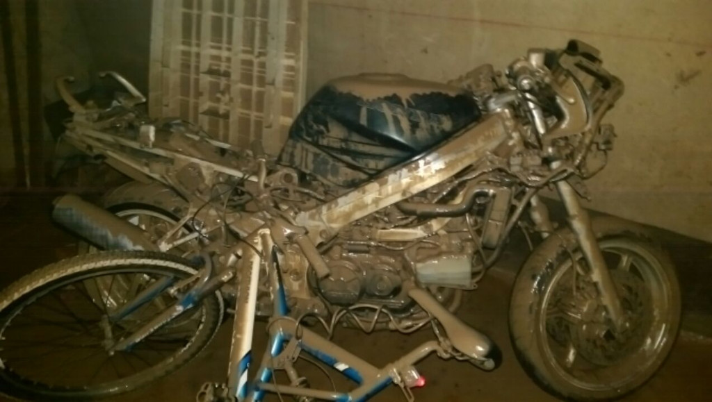

bdouvill Posted November 9, 2015 Posted November 9, 2015 (edited) Hi,  This is my first post here 😉 My name is Ben and I live on the French Riviera, South East of France. I'm 38 and have my motorcycling driving licence since 2010. Since that, I drive a Suzuki Bandit GSF 400. When I got it, it had not been running for the previous 2 years, and maintenance had been neglected by previous owner(s). So I learned how to maintain a bike with it and for the last 6 months, it became my daily driver. But this is not the point here 😉  Spending some free time on the equivalent of Craigslist here, I found that guy who was selling its Honda VFR 750 that had been flooded during early's october events here in France. There was 2 meters high of water (and mud, lots of mud) in his parking lot for 3 days (firemen were really busy pumping water out of caves everywhere) and he had no time nor the skills to put it back on the road. The price was 500 euros. The time I called, he told me someone already wanted all the fairings (and back light and turn signals), so I got the rest for 300 euros.  Here it is after the water was pumped out of the parling lot:    Note that fairings were missing at the time because the owner wanted to restore them (they were full of cracks). He dismantled the exhaust and carbs to try to remove as much water as possible so it was pretty dry when I got it. He also removed the oil and put some fresh inside. But there were still bubbles of water inside the dashboard (on the inner side of the window).  I accepted this challenge because it seemed pretty obvious to me that only a few parts should potentially suffer from the short period in the water. Most problem should have been there before (like electrical wires and connectors in used condition). The owner had the alternator and regulator changed not so long ago (I saw the bill but he forgot to give it the me) and the mechanics installed a Koso voltmeter on the upper triple clamp. Tyres and brake pads were supposed to be refreshed.  I have no special budget for this restoration but it was only 300 euros and checking everything will already take some time so I expect to be ok for the next few months. Also, I always have been a car guy, and only turned into motorcycle 7 or 8 years ago (but like really really hard) but when I was 16, the VFR 750 Carat (the commercial name in France, like Interceptor in the US) always raised on eyebrow for me.  So here it is the day when I picked it with help from a friend. It was one week ago.   I hope I (and you) will enjoy the journey. Thanks in advance for your help and support 😉  Benoit.   Edited June 7, 2018 by bdouvill Broken links to pictures Quote
Member Contributer Rice Posted November 9, 2015 Member Contributer Posted November 9, 2015 Hi Benoit. Welcome aboard! It is an exciting and fun journey. Since you don't have special budget allocated, don't track how much you have spent on the restoration. It will be more fun that way You will get lots of help, advise and encouragement here, but the first thing I would suggest is to remove the plugs and expel all the water and mud from the cylinders. And you will need to change the oil couple of times before all the water and dirt are out. Post lots of pictures of your progress - we like pictures here. Good luck! 1 Quote
Member Contributer Dutchy Posted November 9, 2015 Member Contributer Posted November 9, 2015 Put...... !!! You got your work cut out there..... But, welcome!! Quote
nick84 Posted November 9, 2015 Posted November 9, 2015 What is it with those 4th Gens recently... they have a tendency of getting themselves flooded! This is the third I've heard of in a couple of months! Anyway, good luck with the restoration. And welcome! 1 Quote

TheStig Posted November 10, 2015 Posted November 10, 2015 If you're very lucky, the engine won't have had much water inside, but the airbox isn't air tight, so chances are it got water in there too. I'd take the spark plugs out, disconnect the CDI, put on a new battery and try to crank it over to see what comes out... Your gauges will be damaged beyond repair. I have a full spare set (km/h) if you find yourself in need, that you can have for cheap. You'll also need to take apart the carbs and clean them out well, check all the electrics, etc.Your tank may also have had water inside, so that'll need cleaning.If someone tried to crank it over with the CDI connected, it may have fried it. You'll find out later. Your wheel & swing arm bearings will also need attention and I'd service the forks & brakes too, before trying to ride it. Essentially, mud & water will have seeped into most places. It's possible to get it running again, but a lot of work. Big project to make a fully running bike with fairing, etc. Keep us posted. Quote

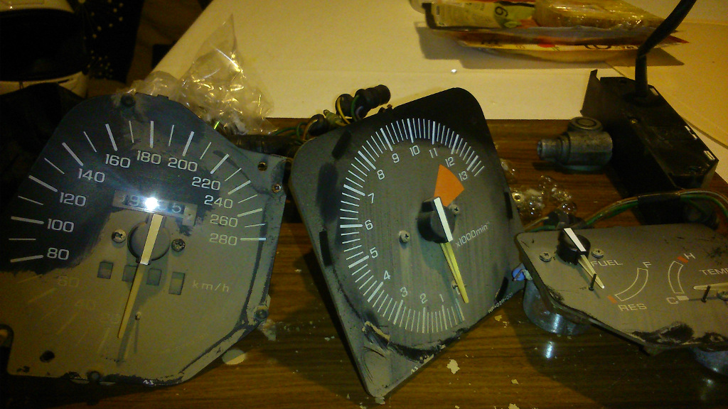

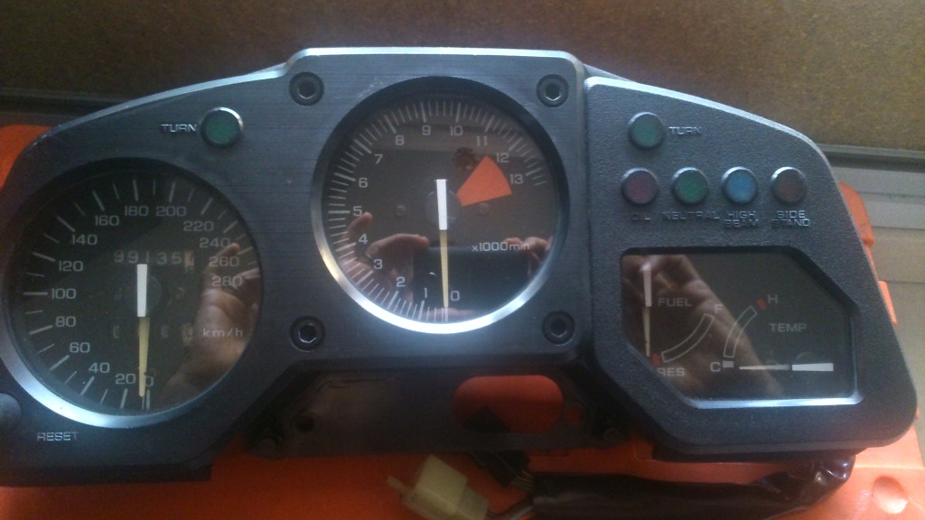

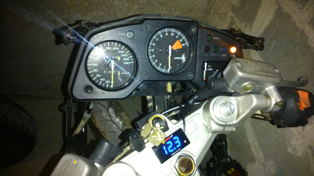

bdouvill Posted November 10, 2015 Author Posted November 10, 2015 (edited) Thank you all for your comments and support 😉 I already started last week to make the inventory of all parts the previous owner removed for cleaning that I have to figure how to mount back on the bike. I also removed the dashboard cluster, opened it and cleaned everything. Not a lot of pictures but there was a very thin layer of dry mud everywhere.   Thanks to my wife who patiently cleaned the different parts, we got this:   And back on the bike with the battery connected and contact cleaner inside almost all connectors:   Next step is to determine whether there is still water inside the motor, and check valve timing. I try to see that next week-end. Edited June 7, 2018 by bdouvill Broken links to pictures Quote

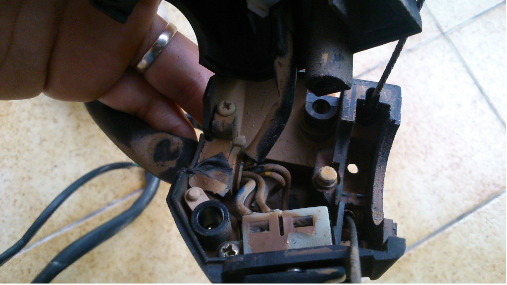

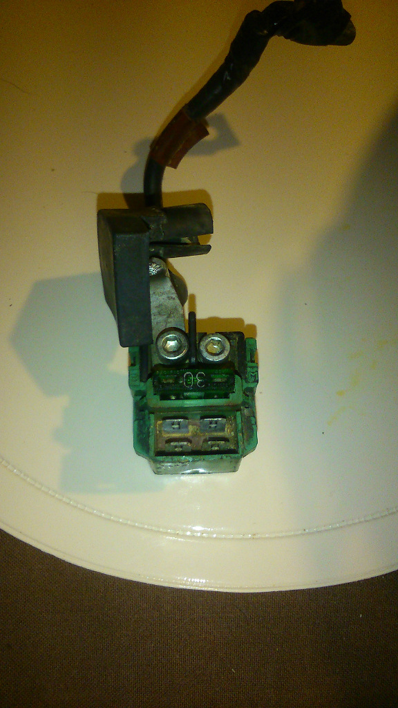

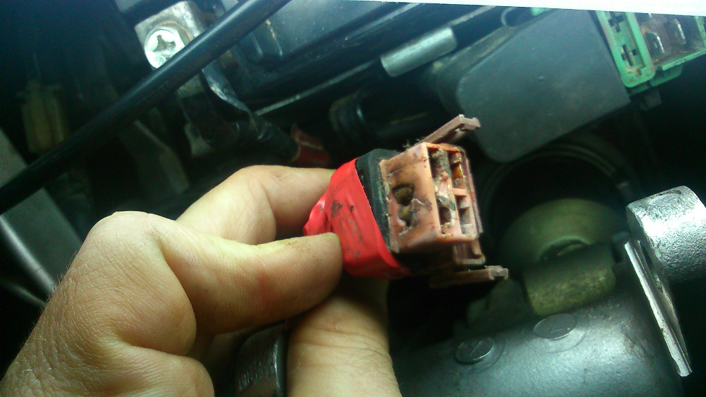

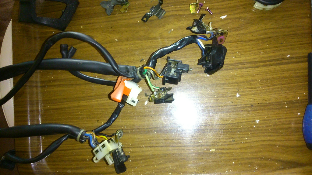

bdouvill Posted November 15, 2015 Author Posted November 15, 2015 (edited) A little bit of news 😉 and lots of questions too... I am trying to launch the starter to rotate the motor and eject some water eventually. I started by removing the commands on both handlebars because I was not sure if contact were going well, especially when launching the starter. Without surprise, they were both full of mud that dried out:   I dismantled everything:  And again with my wife help, we cleaned everything. I tested all contacts with my multimeter, everything seems fine on this side. So I tried to launch the starter and... nothing, no clicks from the relay side. I have some serious doubts about it and the connector that goes to it.  For the connector, image speaks for itself. For the relay, I am not able to separate the green part from it that is supposed to be removable. Plus the starter casing is broken and water enters inside, so no idea of its state nor how to test it. So I have several questions I'd like to share with you: 1/ How can I test my starter relay? 2/ Shall I cut the connector and replace it with single connectors? 3/ Shall I pull the clutch lever to be able to ignite the starter? I noticed that there's a clutch relay too and I have no idea what it stands for nor how to test it. Also I intrigued because the neutral signal does not light on the dashboard. I tested continuity along the main harness and it's ok. But I don't know how the clutch relay interfers here. 4/ I did all my tests with the CDI removed because I believe it should not matter but I might be wrong. Am I? Many thanks in advance for reading and helping me going on 😉 Edited June 7, 2018 by bdouvill Broken links to pictures Quote
Member Contributer Cogswell Posted November 15, 2015 Member Contributer Posted November 15, 2015 Outstanding progress! The instrument cluster looks great (by the way - your wife's a keeper :smile2:)! You can test the relay by grounding it and then applying power to the input - you should hear an audible click. While power is applied you could also check for continuity across the outputs (switch inside would be closed). If it were sealed sufficiently for no water to enter it's probably fine. If water did get in though, it may never work well and you may well destroy it to get it open. You'll just have to experiment and see what you can find. The clutch, neutral and sidestand switches should be known good before deciding the starter relay is bad. Since your neutral light is not working there's probably some diagnosis to do there as well. If you watch ebay you can probably find a wiring harness that could supply the electrical components you have that are beyond repair. Keep us updated. Quote
