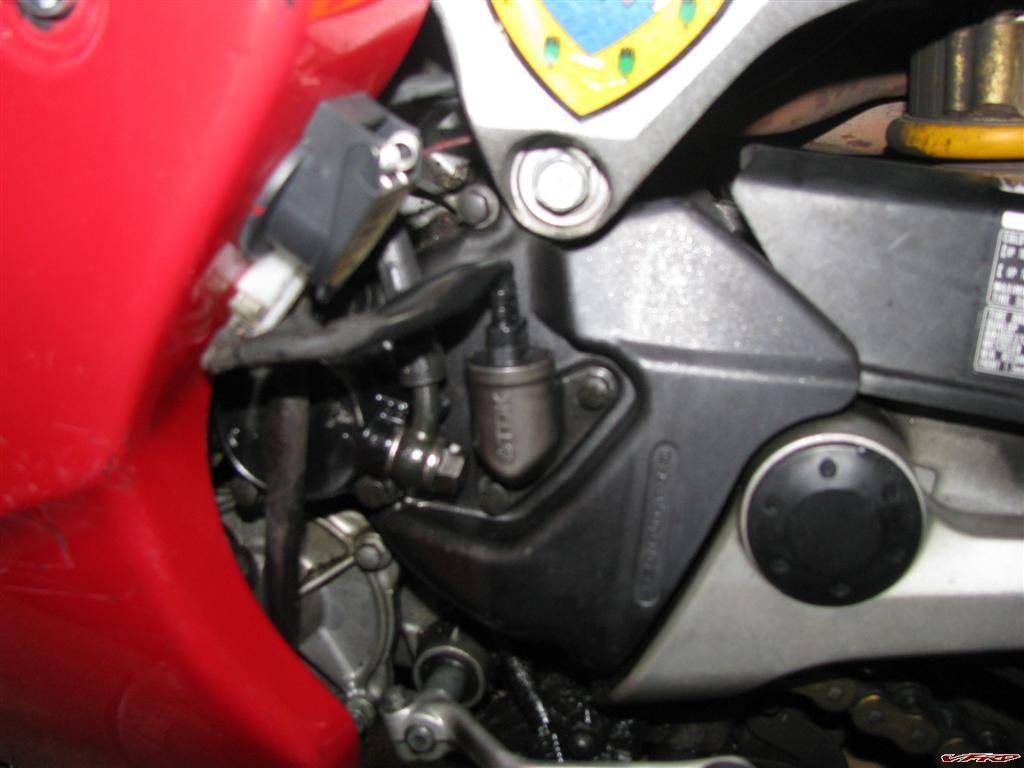

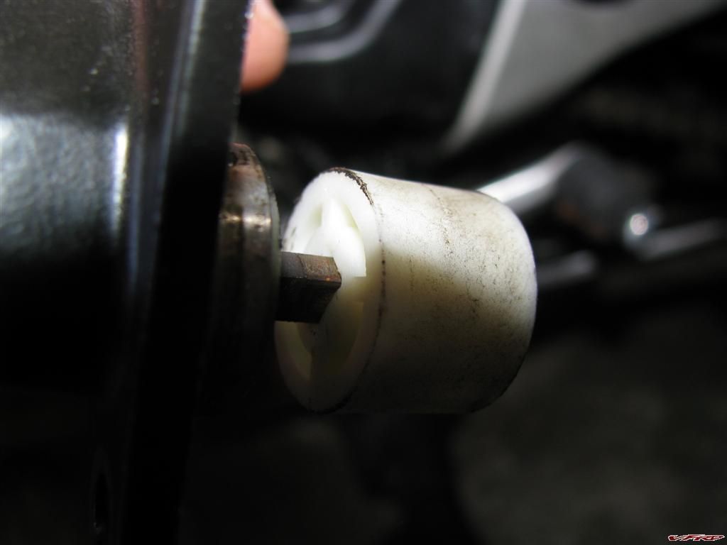

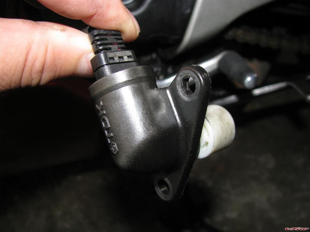

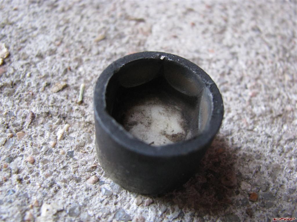

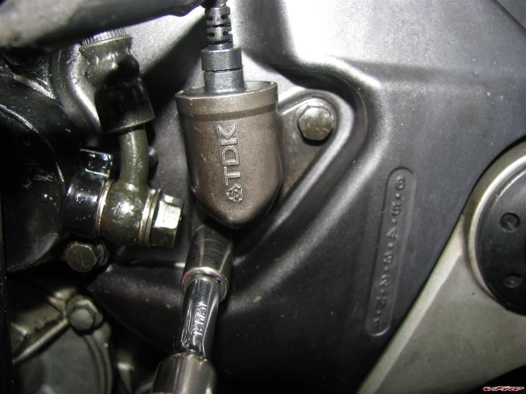

Forum CEO HispanicSlammer Posted September 9, 2008 Forum CEO Posted September 9, 2008 If you notice your speedometer is jumping around or not working at all chances are your speed sensor is wore out, or more accurately the nut that drives the sensor wont make contact with the sprocket bolt anymore. Locate the Speed Sensor it is right over the front sprocket Remove the 2 bolts with an 8mm nut driver Speed sensor pulls right out Replace the nylon nut driver the old one prys right off the shaft Old worn out nut driver the nylon part would not make contact with the sprocket bolt. It is a simple 5 minute fix and the replacement nut costs around 5 bucks Part number 44080-MR7-013 speedometer, joint 4 1 Quote

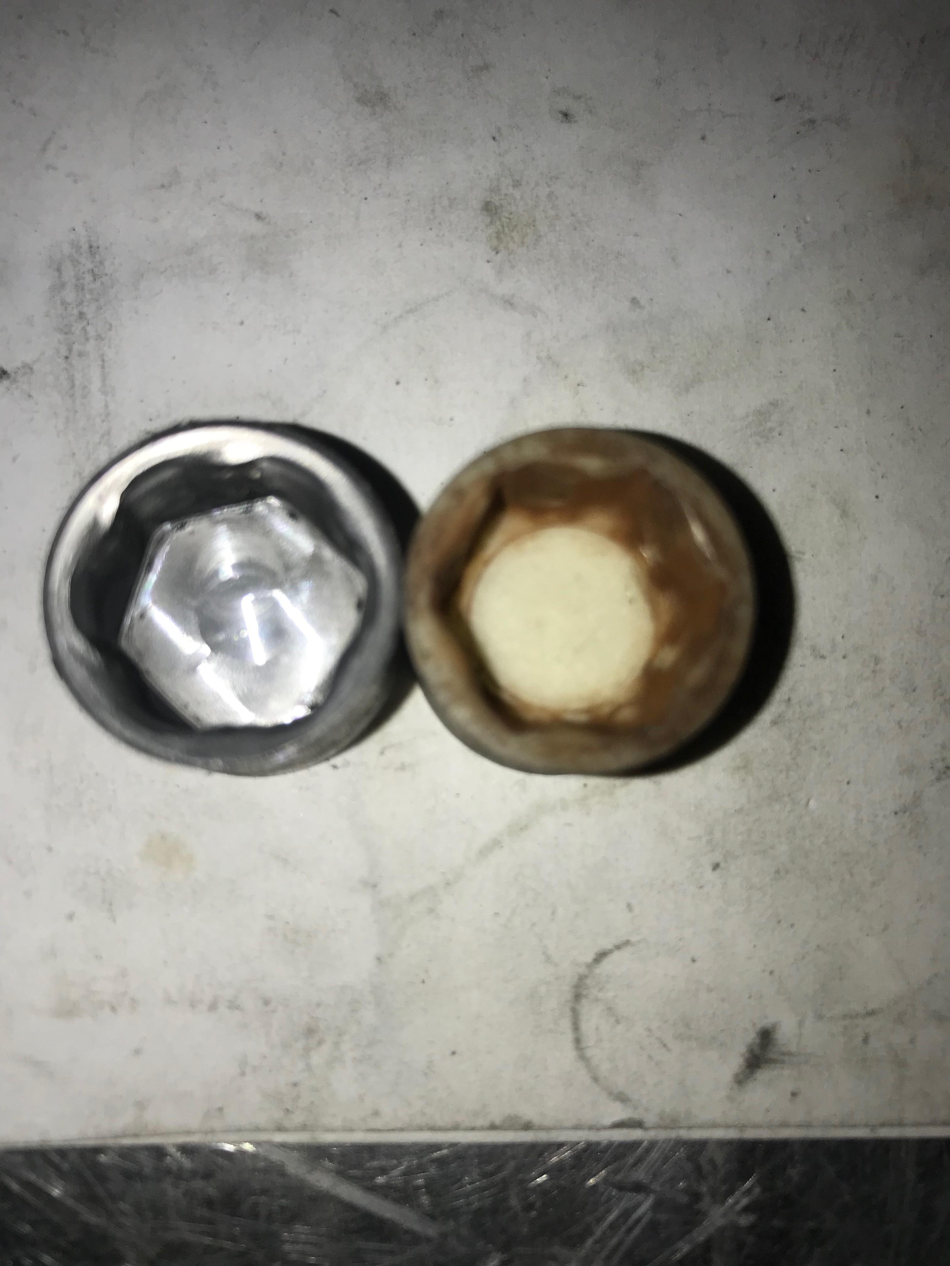

Member Contributer Duc2V4 Posted May 1, 2020 Member Contributer Posted May 1, 2020 Not to flog a dead horse but I did find a picture of the aluminum one after it gave up the ghost... Â Quote
