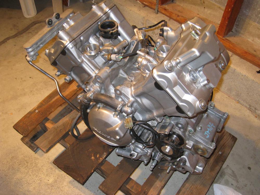

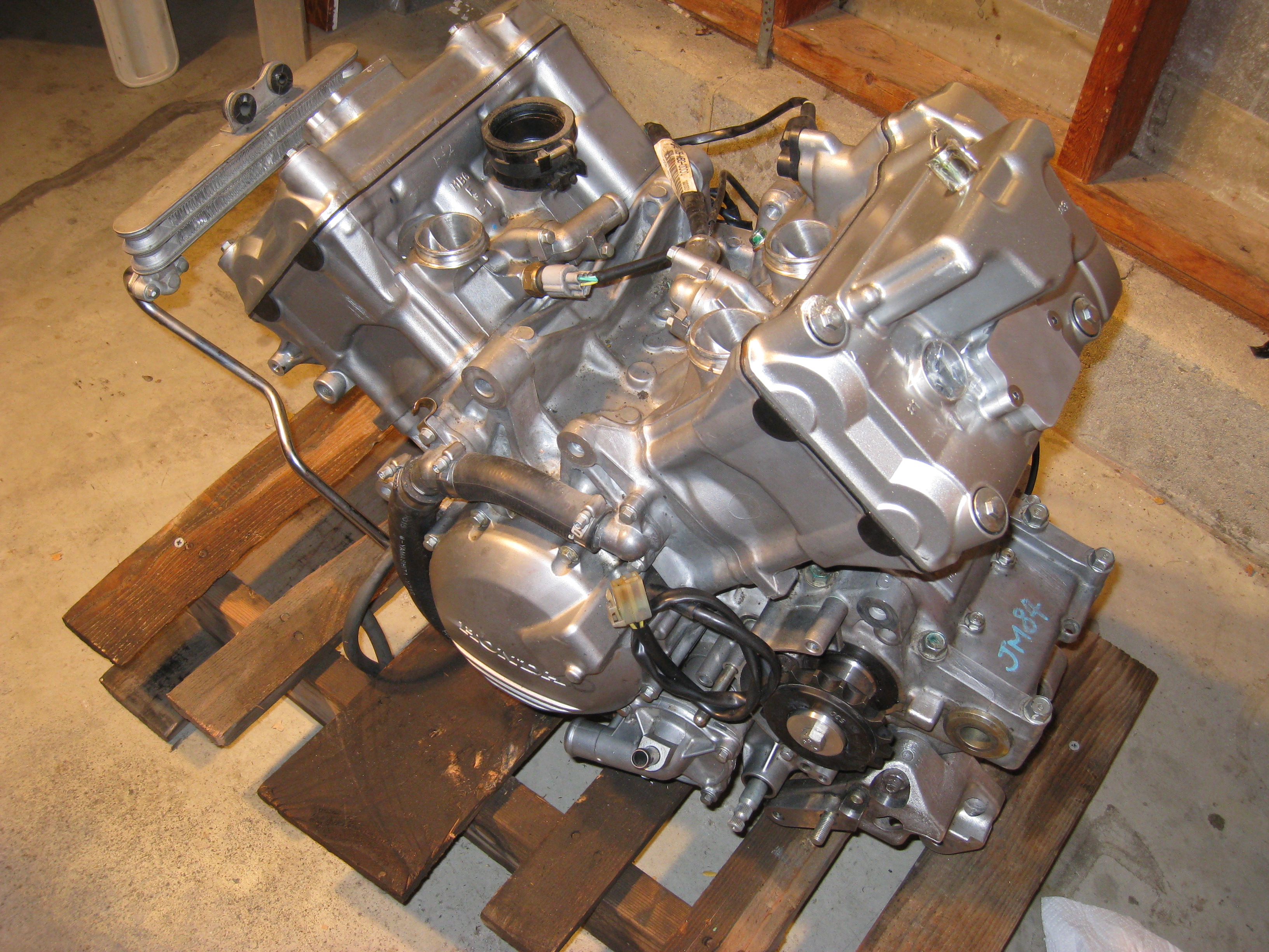

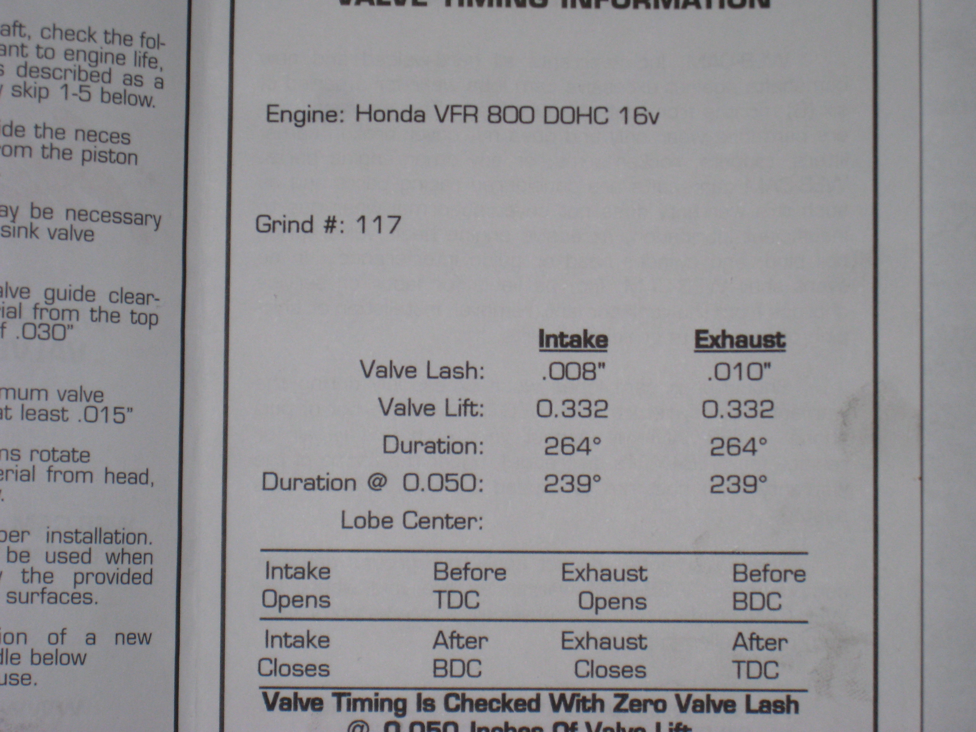

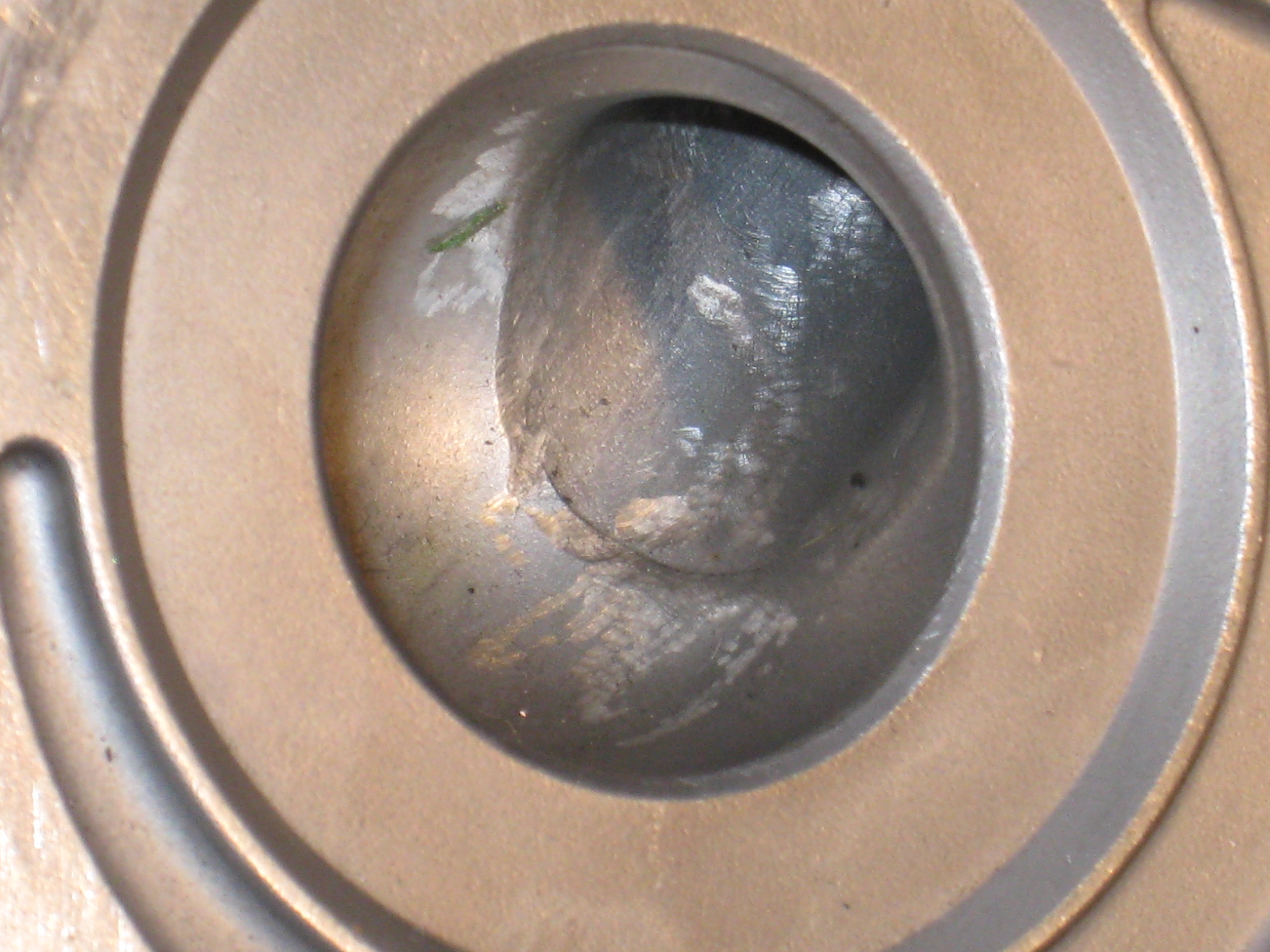

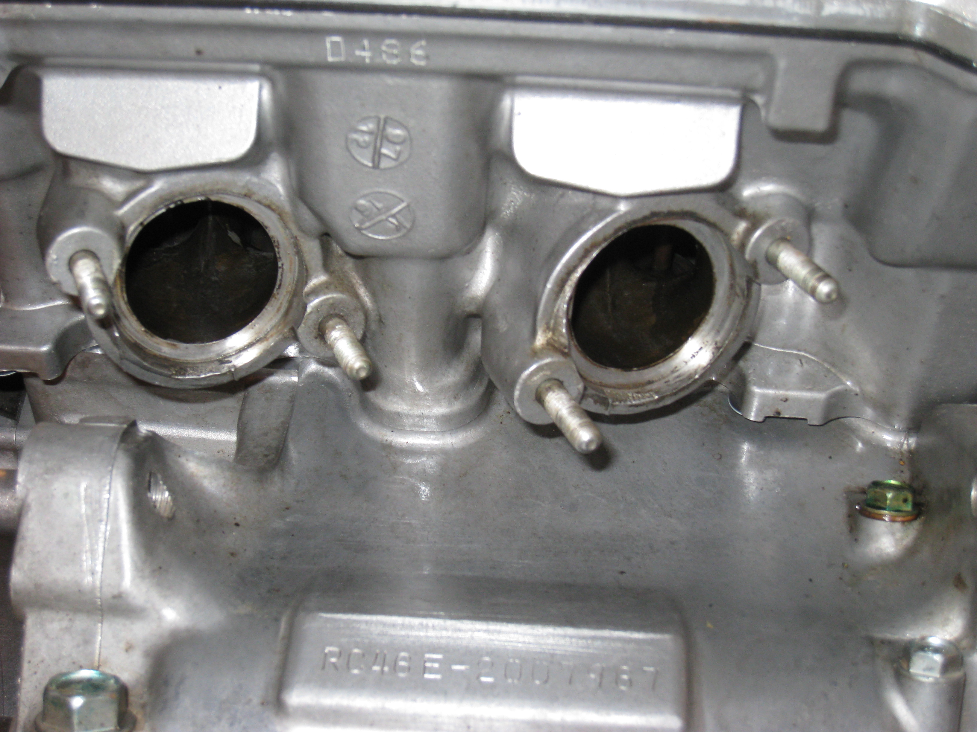

Member Contributer sa1713 Posted November 26, 2017 Author Member Contributer Posted November 26, 2017 Good news! I have the engine back from Hanson Racing Technology, Craig Hanson, in Chico, CA. I made a trip recently to ship it back east. Forward Air is about as easy to deal with as my brushless automatic car wash. No issues. Here are the build details: Mild cam hard face and grind by Web Cams (Don't ever use Dave Dodge. PM me and I'll explain) Intake and exhaust ports ported/polished. Valves and seats ground. Exhaust ports ceramic coated Water pump cover modified and ported to allow better flow Air intake funnels ground to match throttle body intake diameter Counter sprocket bolt cover (keeps rust/dust off the splines) A shift star and detent arm was installed as well as a new Custom Rewind stator. New SAMCO hoses/clamps will go on too. I'm in the process of gathering all the necessary bits for the swap. I have a spare frame (salvaged) that was turned into a three legged mare which the original engine will hang in while I decide what to do with it. I'm not sure what the results will be, but I'll get it to a dyno and post the results. 3 Quote

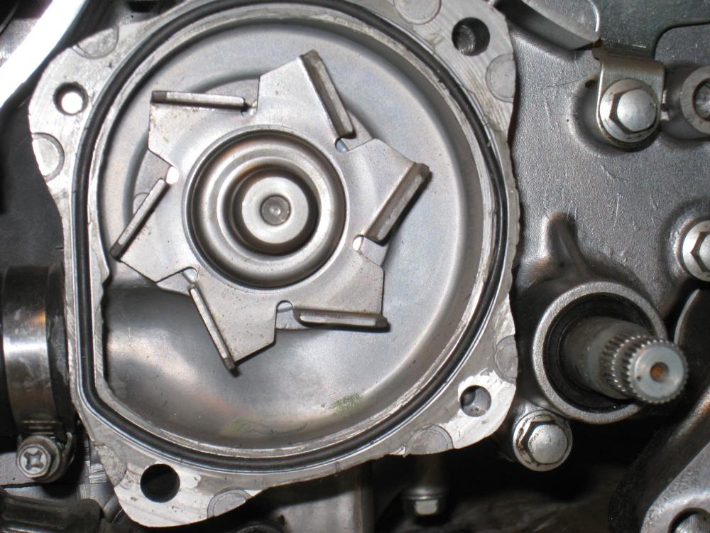

Member Contributer VFROZ Posted November 26, 2017 Member Contributer Posted November 26, 2017 Looking good. id be interested to see what was actually done to the water pump cover. Any chance you could take a picture? 1 Quote
RVFR Posted November 27, 2017 Posted November 27, 2017 Sweeet !!! and Congrats. Yes, I'll second the water pump thingy too. Quote
Lint Posted November 27, 2017 Posted November 27, 2017 Hey, Chico's not too far from me. I'll have to Google the shop and bookmark it. I'm curious about the dyno and definitely interested in the water pump mod as well. Quote
Member Contributer sa1713 Posted November 28, 2017 Author Member Contributer Posted November 28, 2017 Best pics I could achieve of the water pump. Not sure how much was done to the fins, but he cleaned up the inside of the cover. Craig is a super easy person to deal with. He is a very honest chap even when presented with an open checkbook. Cooling system is removed. Next will be the header, swingarm pivot bolt, and remaining frame mounts. Quote

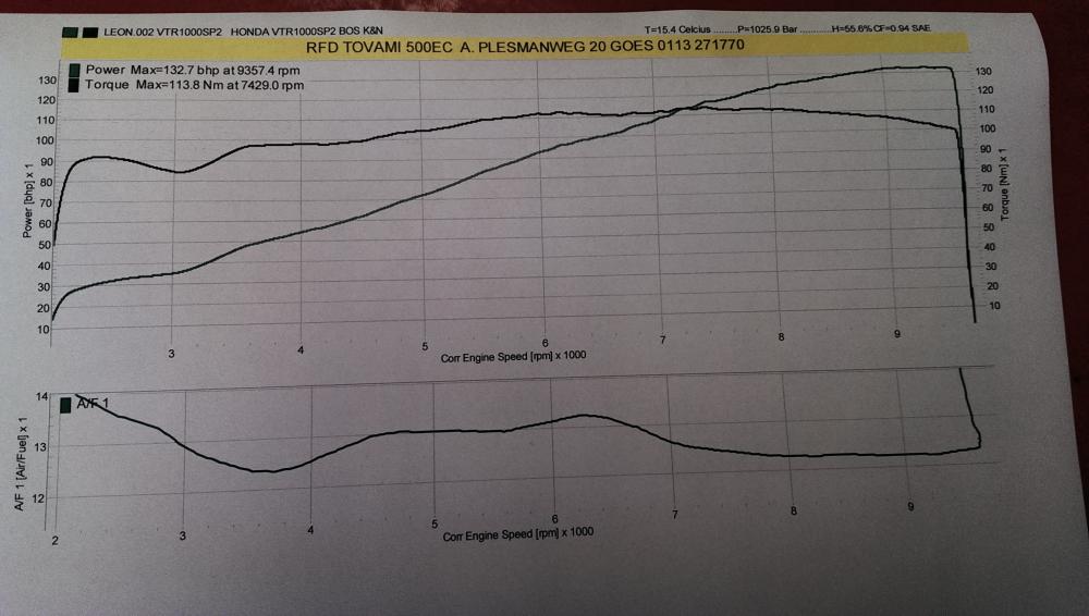

Member Contributer Dutchy Posted November 29, 2017 Member Contributer Posted November 29, 2017 Great project and tenacity Here's something to aim for then.... Quote
Member Contributer VFROZ Posted November 29, 2017 Member Contributer Posted November 29, 2017 ^ No wonder they are so much fun to ride. Quote
Member Contributer Mohawk Posted November 29, 2017 Member Contributer Posted November 29, 2017 4 hours ago, Dutchy said: Great project and tenacity Here's something to aim for then.... Sort that top end fuelling out & you have another 3-5hp for free ! :) Quote
