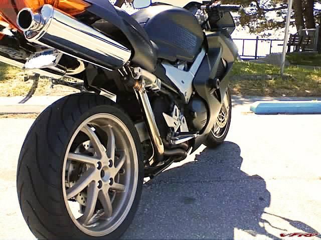

enzed_viffer Posted April 22, 2009 Posted April 22, 2009 Fork rebuild with new springs & Ohlins rear, Michelins and Viola! Where did you put the viola? I don't see it in the photo... :laugh: This is off topic(ish) but reminded me, looking at your beautiful pipes. I followed a wine-red VFR800 home last night. Dunno what pipe he had on (I think it was a TBR low-mount), but it sounded gorgeous: not very loud, but a very nice tone (nicer than my Satantune, to be honest...) He'd probably gone for the cheapest option (apart from a helmet, he wasn't wearing proper bike gear either), and while it sounded nice, it looked bad from behind, with two gaping caverns under the rear cowl where the OEM mufflers used to live. On the plus side, he lives only a couple of blocks from me, and the wine colour looked nice. Probably a cabernet or pinot noir... Quote

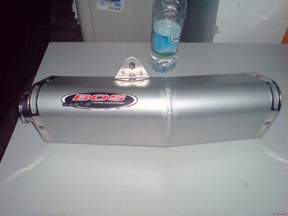

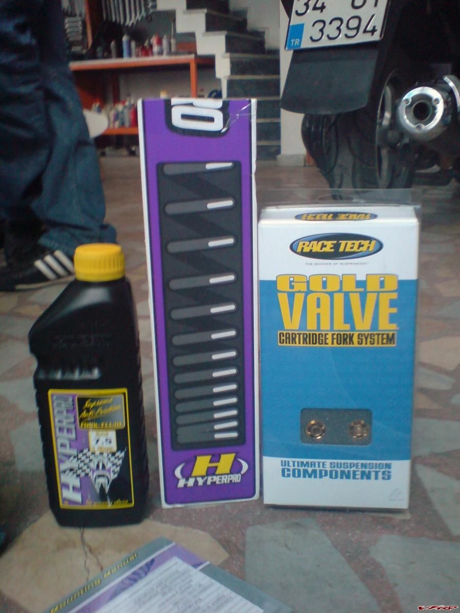

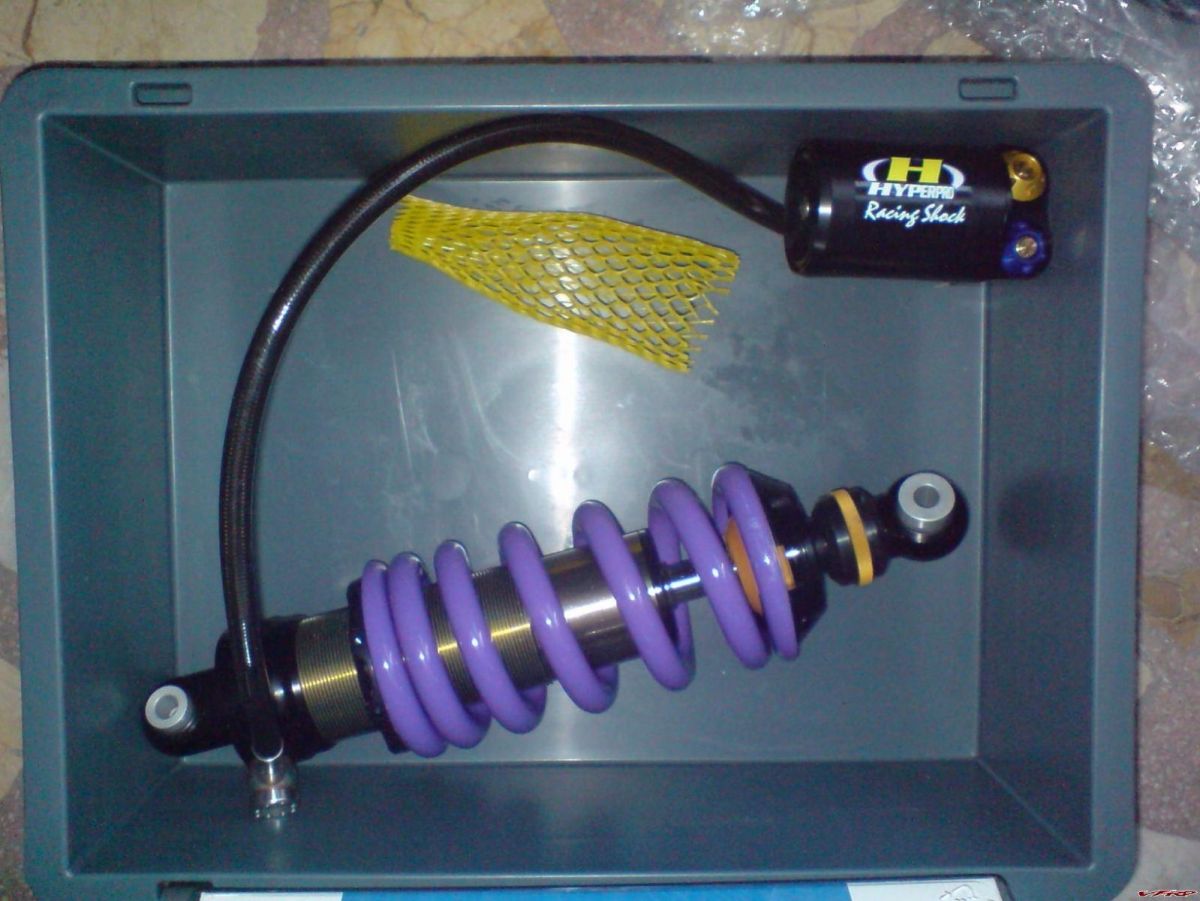

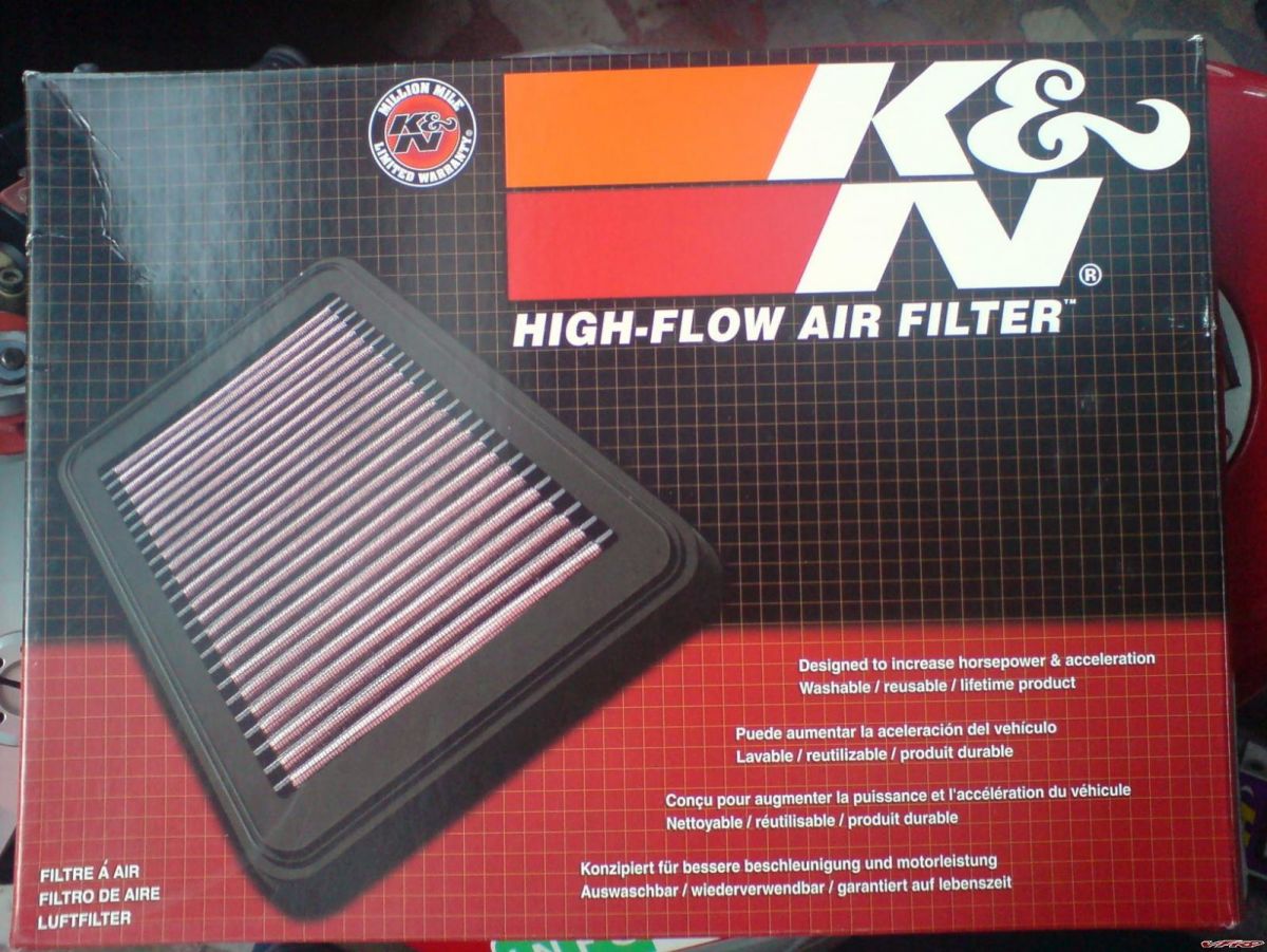

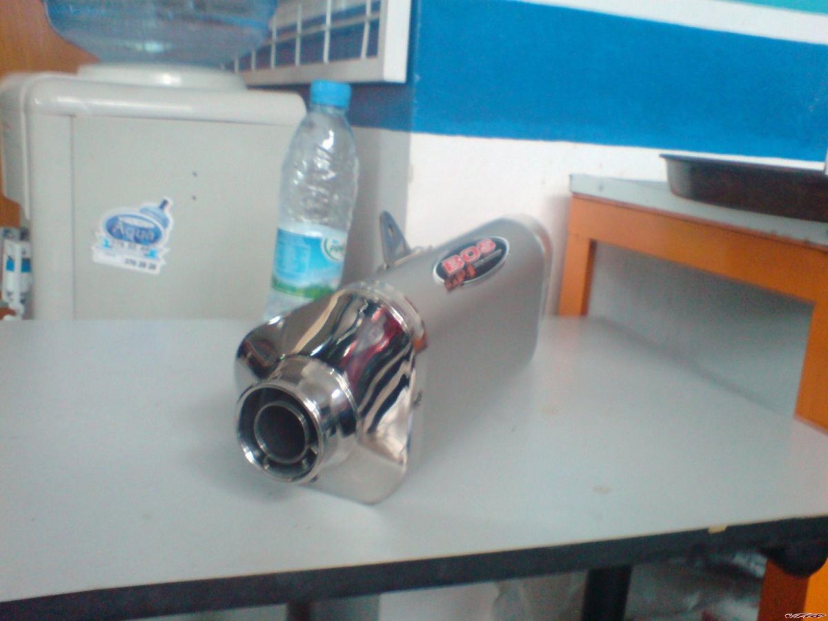

Member Contributer arrow Posted June 9, 2009 Member Contributer Posted June 9, 2009 (edited) DSC00514.JPG DSC00517.JPG DSC00516.JPG DSC00520.JPG DSC00521.JPG DSC00523.JPG I have received the suspension bits (plus some more!) I ordered about a month ago. Unfortunately, they will have to wait until I get back from holiday with the family. I will keep you guys posted! Edited June 9, 2009 by arrow Quote
