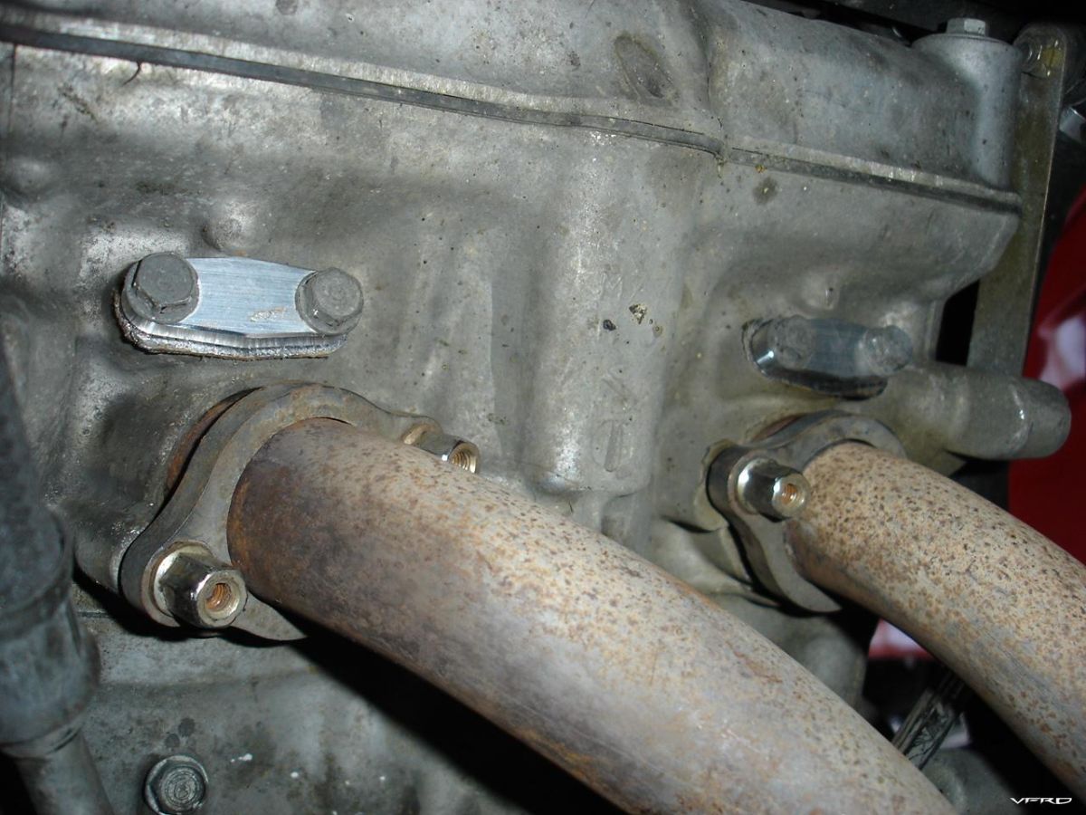

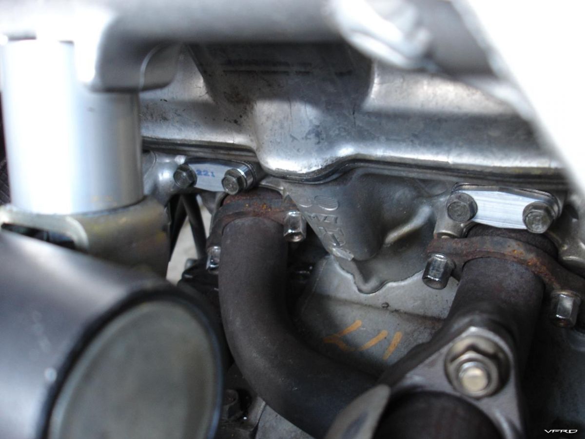

mrmatt Posted February 22, 2010 Author Posted February 22, 2010 PAIR system begone! DSC02188.JPG DSC02189.JPG I found someone on the ebays that makes block off plates for a Hayabusa for $20, which work perfectly for the VFR. Now you say, why did you not make them with your mill and save $20? Well, I probably could and should have, guess I was just lazy this time. Getting the rear pipes out was a real pain though, had to drop the tail to reach in to unscrew it, and then bend them all up trying to get it out, I didn't want to take the rear shock out too. Quote

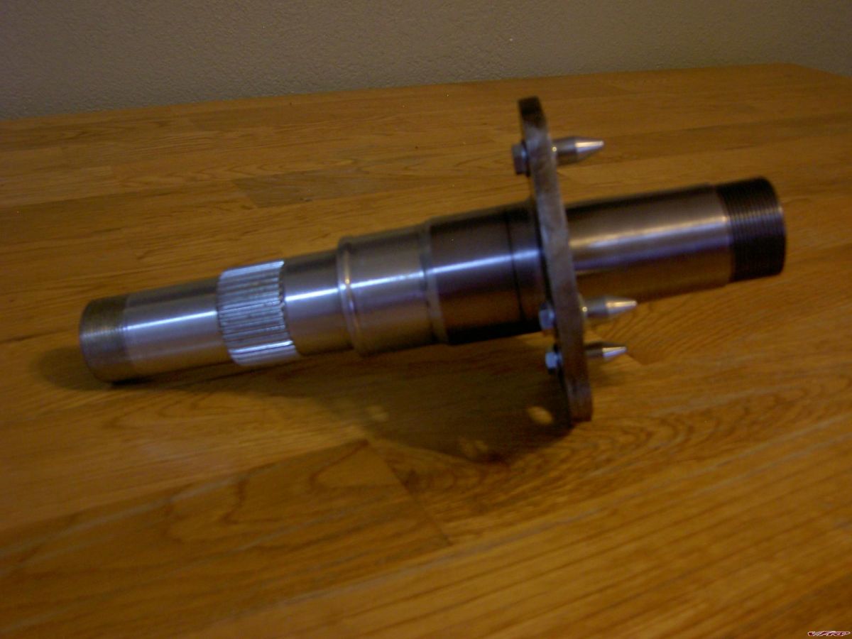

Member Contributer YoshiHNS Posted May 7, 2013 Member Contributer Posted May 7, 2013 You should be able to use any aftermarket wheel that would bolt onto the Triumph. Now that he had the spindle shortened he can only fit Ducati wheels, but there are more Duc wheels out there than Triumph wheels, so I think he came out ahead. Some pics of Doug's modified spindle before I boxed it up... PICT3153.JPG Was taking a look back through this thread. Did you remake those four drive pins? They look much pointier than the ones I have. And they came with allen head bolts on the back, not hex head. Quote
Member Contributer JZH Posted May 8, 2013 Member Contributer Posted May 8, 2013 OEM are simple hex head bolts. RC30 pins are available separately, so if they are a standard diameter, not sure why they would not have been used. When I got my NR rear wheel mount made I discovered that the NR's drive pins were a different diameter--and not available separately, of course. Rick Oliver (in the UK) managed to get a set made for me, though. Ciao, Quote
Member Contributer YoshiHNS Posted May 8, 2013 Member Contributer Posted May 8, 2013 I was thinking that was a triumph spindle. Or it is a triumph spindle for an RC wheel? Quote

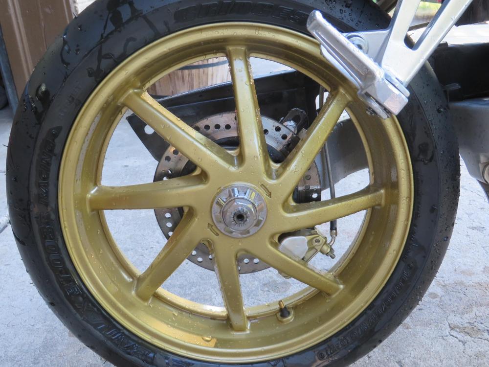

Member Contributer slo1 Posted March 1, 2019 Member Contributer Posted March 1, 2019 3 hours ago, BiKenG said: Old thread, but had to correct this. An NC30 or NC35 hub is indeed the same diameter as for the RC36 but the NC hubs are 10mm narrower. If anyone knows how to make that work, please let me know. I've even contemplated cutting the 400 hub and inserting a spacing ring and welding it all back together. Otherwise, anyone got a spare RC30 hub and axle? nt650/bros spindle works fine with rc36 hub. But is needs drive pins moved for nc/rc/Duc pattern fitment...... pic has afew other goodies..... Quote

Member Contributer slo1 Posted March 2, 2019 Member Contributer Posted March 2, 2019 14 hours ago, douglasthecook said: So if I understand you correctly, a Honda Hawk/NT650 rear axle will work for the VFR 750, just need to drill a different pattern for the drive pins? Yes, and no.... drill the drive pins to pattern, but the axle is shorter so you need the smaller nt650/bros cush drive as well. Rotor is smaller diameter, and also has different bolt pattern, so easiest to get the nt/bro's one and caliper hanger. Bros parts are cheap as chips in the UK, i think...... Summary, Axle with drive pins moved, Cush Drive, rotor and caliper hanger all from the nt/bros = bobs your uncle :) add nc30/35/ducati wheel (Duc wheel will need 2.5mm spacer to make up for the offset, goes between wheel and axle). Quote
