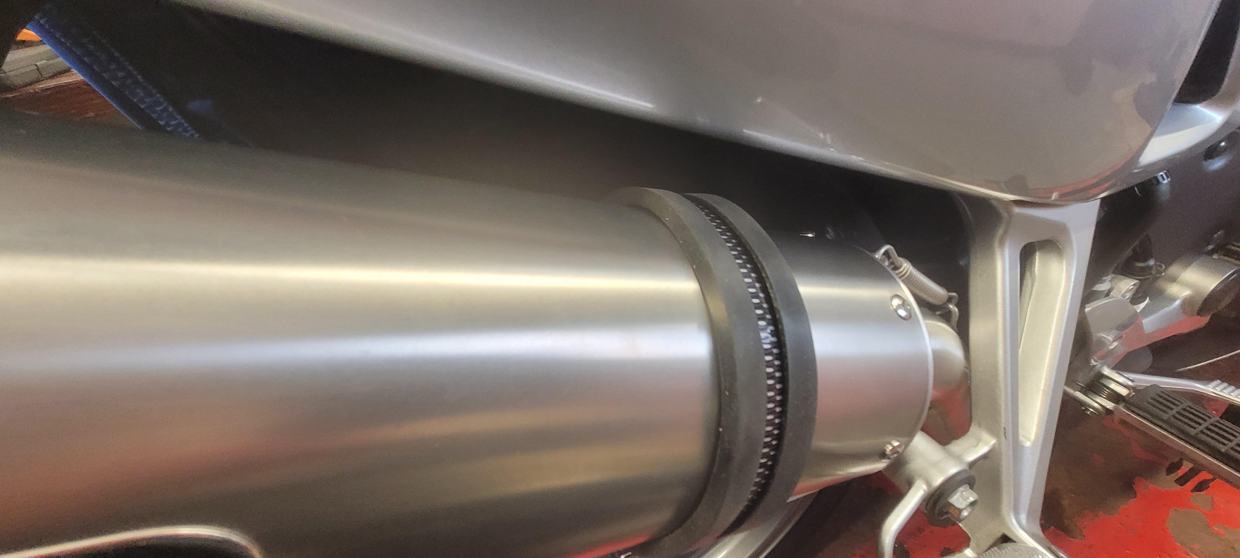

Member Contributer Skids Posted March 25, 2023 Author Member Contributer Posted March 25, 2023 Fitted. 3 1 Quote
Member Contributer Bren Posted March 25, 2023 Member Contributer Posted March 25, 2023 Got a rear view shot? Does it sit in close to the rear fairing? Looks 😋 Follows the tail piece line very nice. Quote
Member Contributer Skids Posted March 25, 2023 Author Member Contributer Posted March 25, 2023 37 minutes ago, Bren said: Got a rear view shot? Does it sit in close to the rear fairing? Looks 😋 Follows the tail piece line very nice. It's not close to the fairing but only a 2mm gap to the rear footpeg mount. Quote
Member Contributer Captain 80s Posted March 25, 2023 Member Contributer Posted March 25, 2023 Good fitment, flows with the lines nicely. That a pretty unique bracket system for the muffler camp too. Quote

Member Contributer Skids Posted April 8, 2023 Author Member Contributer Posted April 8, 2023 Only thing I forgot to mention is that whilst the GPR is a lovely end can, to get the rear wheel out it needs to be removed completely along with the link pipe, which means removing the rear cowl to get at the bolts securing the RH rear peg, which needs removing too. Not a long or difficult job, just longer than rotating the end can out of the way to remove the rear wheel, like I used to be able to do. Quote
Member Contributer Bren Posted April 8, 2023 Member Contributer Posted April 8, 2023 Isn't the exhaust clamp fixed at the bottom to that bracket which is then bolted to the passenger peg? The joint of the clamp/band seems to be there? I'm not seeing why the rear cowl and the rear peg needs to come off 🤔 I have givi racks so if I had to take everything apart just to get the wheel off I wouldn't be too happy. Quote
Member Contributer Skids Posted April 8, 2023 Author Member Contributer Posted April 8, 2023 29 minutes ago, Bren said: Isn't the exhaust clamp fixed at the bottom to that bracket which is then bolted to the passenger peg? The joint of the clamp/band seems to be there? I'm not seeing why the rear cowl and the rear peg needs to come off 🤔 I have givi racks so if I had to take everything apart just to get the wheel off I wouldn't be too happy. I know what yr saying but the link pipe has to rotate/move outwards to ease it off, there's barely 2mm of gap when it's fully fitted so the link pipe has to come off too. Quote
