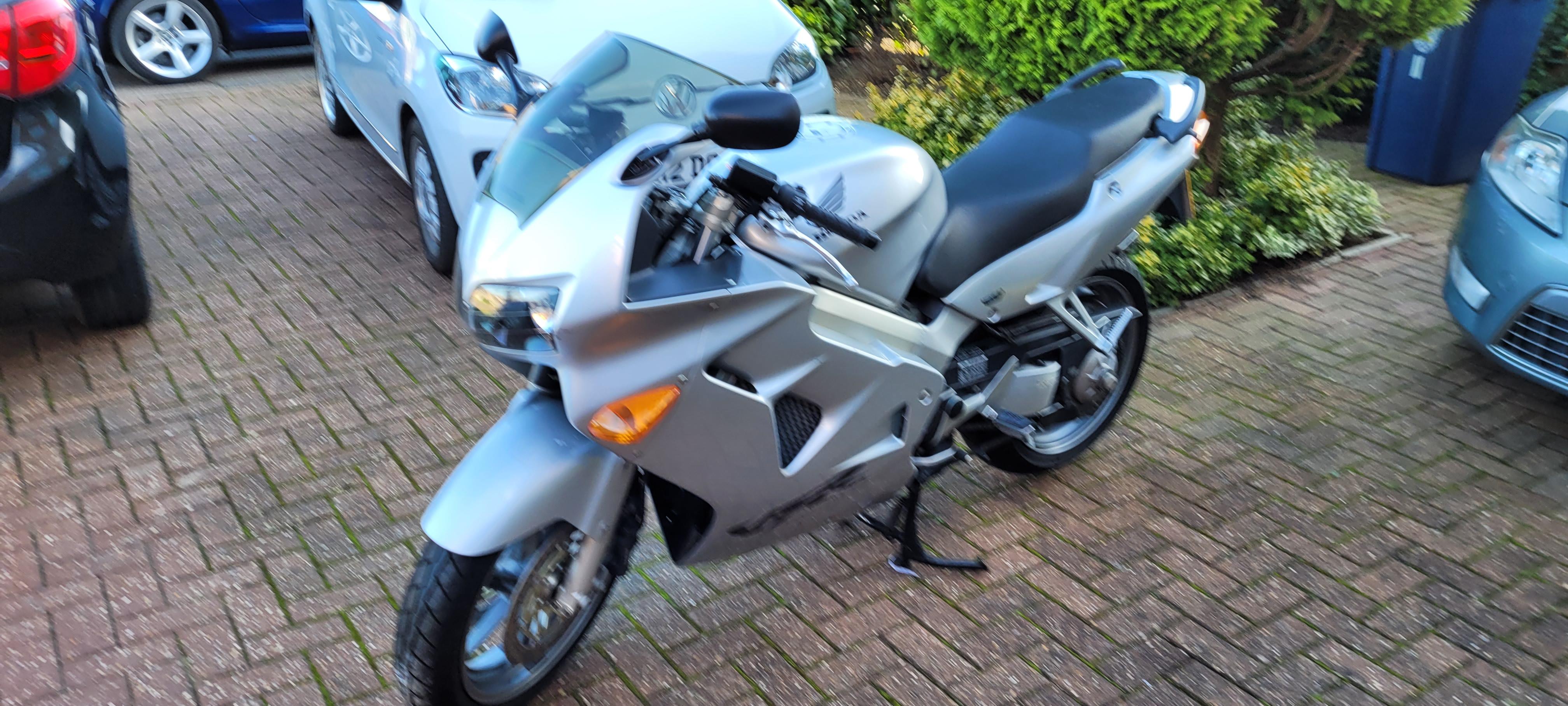

Only my 3rd, but for me that's a lot!
Agreed a purchase this afternoon and planning to collect Sat 12 Feb.
2001 model with 8900 miles from new! It's in beautiful condition, considering it's British 🌧️
Poor guy, bought it as 2nd owner in 06 but struggled to ride it due to a hip condition. The only mileage he managed was the annual ride to get it MoT'd (annual safety/roadworthiness check for any vehicle 3+ years old) and back. He's only been able to ride 400 miles in 15 years. 😞 He fitted a new Honda battery yesterday and it fired up first time from cold. He's kept it really well, there's no sign of corrosion anywhere I could find

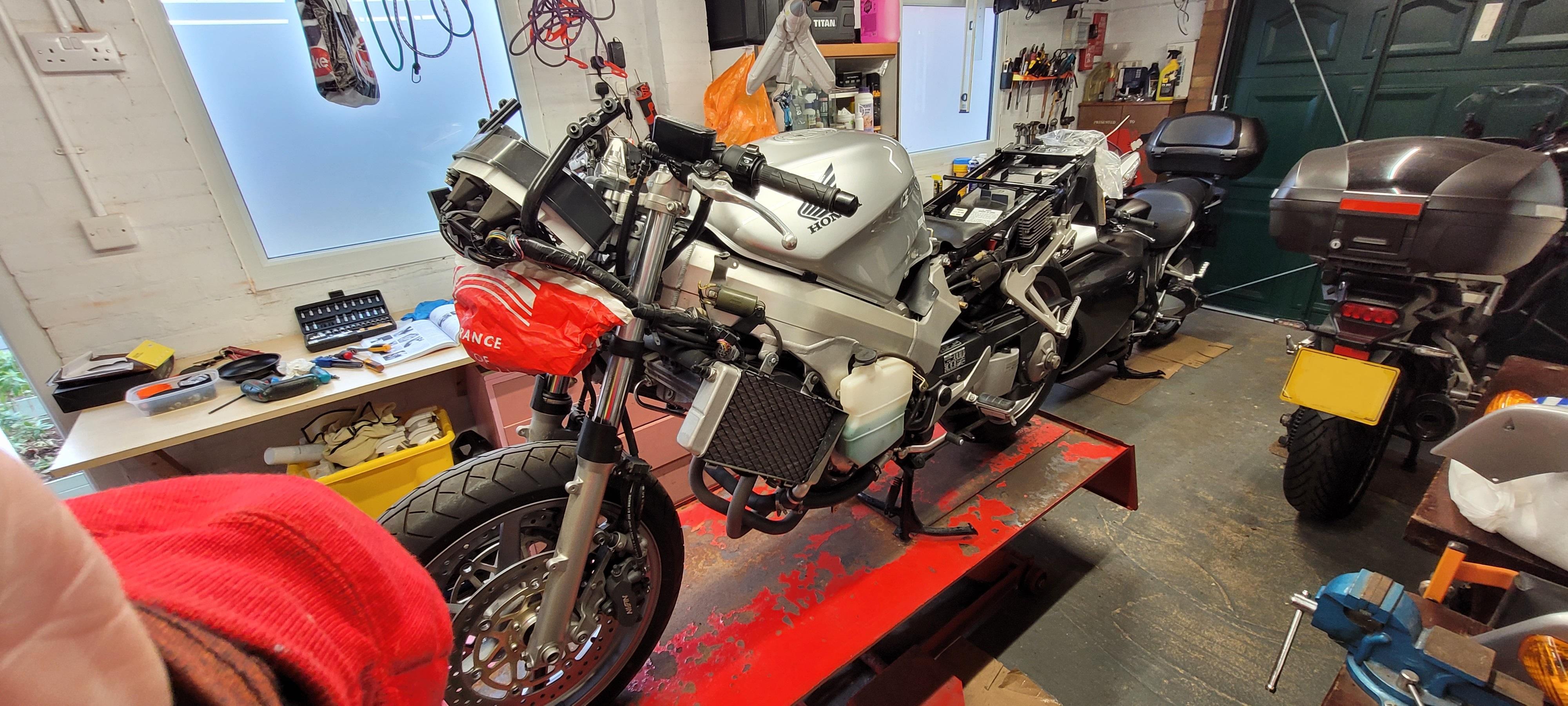

I've started to remove all the plastics so I can give her a deep clean before starting work. I don't think the fairings etc have been removed since it was in the factory.

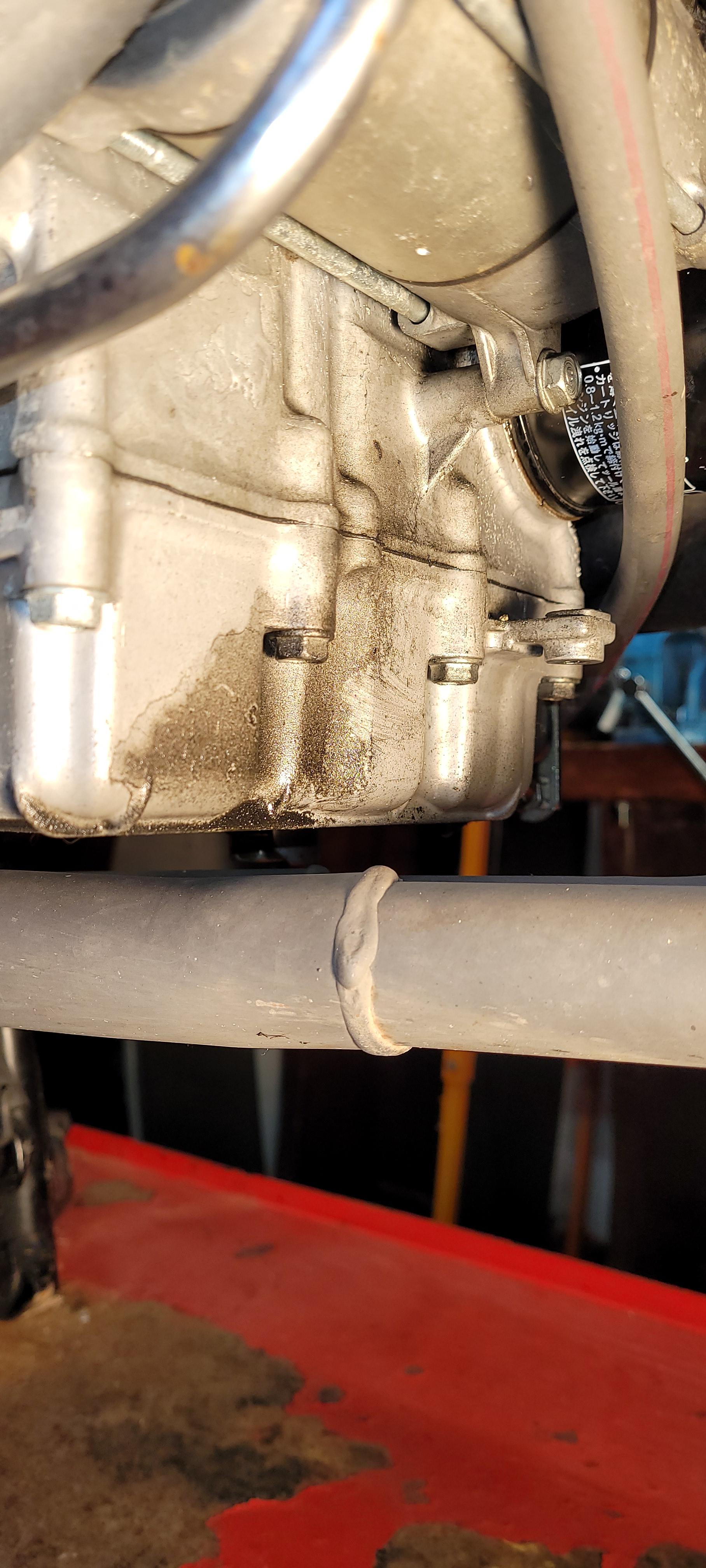

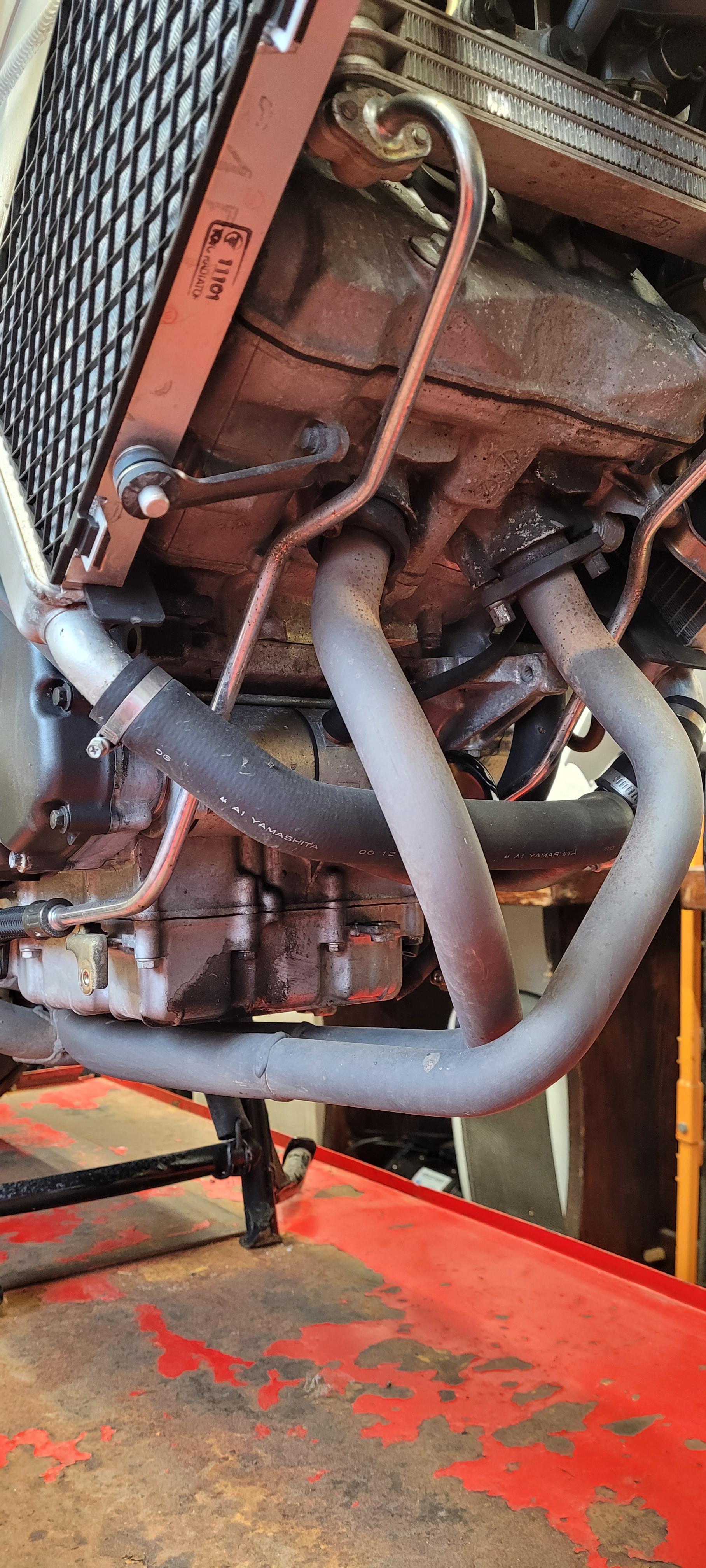

She's is pretty clean underneath, considering she's been ridden in the weather English but I did notice what looks like a small oil leak and I wondered if the expert eyes on here could determine if the leak is from the bolt holding the sump or is the gasket leaking?
Bear in mind, the oil was last changed 5 1/2 years ago, it is still clear and has done zero miles since then. The only thing is she's been started up on the odd occasion so I wondered if that could have exacerbated a leak???
The oil & filter will be changed anyway at a later date so there is an option to drop the sump and replace the gasket but if I could identify exactly what is leaking, that would help.

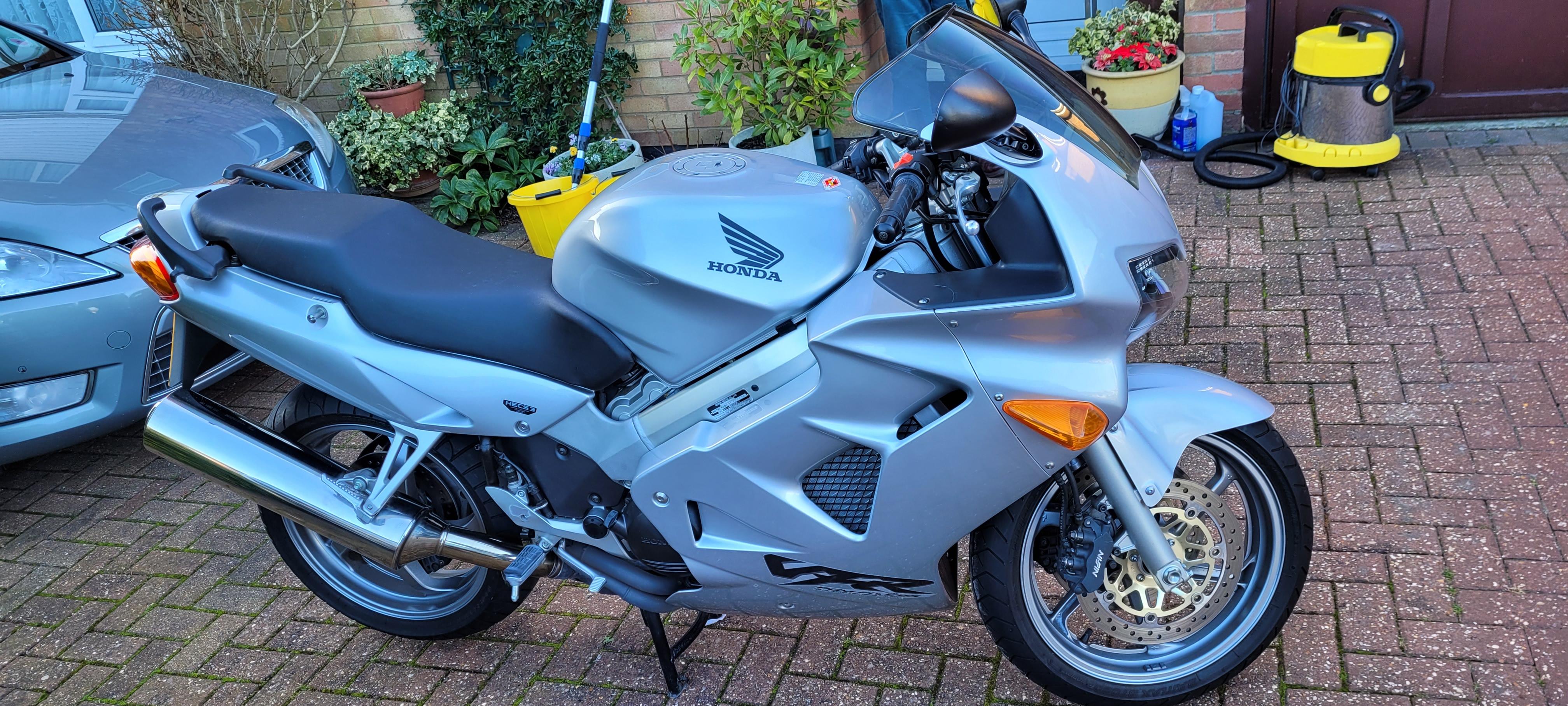

Other than that, she's pretty clean. No birds or rats nests (I have to remove the fuel tank yet) and so far I'm really pleased. Even has a complete and unused Honda toolkit. 😁
1 hour ago, Cogswell said:
She's lookin' really good!
She is. I was expecting deteriorated hoses and rubber etc but it all looks almost new still.
Looks like just from the oil filter removal/install work done on it to me from the pics.
Yeah I was thinking the same.
Wonder if there is a chance the oil filter seal from previous filter didn't come away with the filter. The old double seal effect, worth checking!
Wipe the area clean, run the engine see if the leak comes back.
Great bike you have Skids hope it serves you well.
As a self taught mechanic that has made the "he didn't check the boss or filter to see if the old gasket was still in place" mistake :blush:  , I can say from experience that if that were the case, oil would be everywhere!  It makes a gigantic mess . . . LOL!  Somehow it seems that it wouldn't, but when it comes to pressurized oil and gaskets, less is more.  As to the mechanical blunders on my learning curve, it was probably just a notch below the "he didn't replace the drain plug before refilling with oil" goof.  Thank god with the latter the drain pan was still in place - the only damage was to my ego and wallet.   I'm going to guess in this case it was from a filter that needed just a tich more clockwise muscle and seeped a bit over time.  YMMV

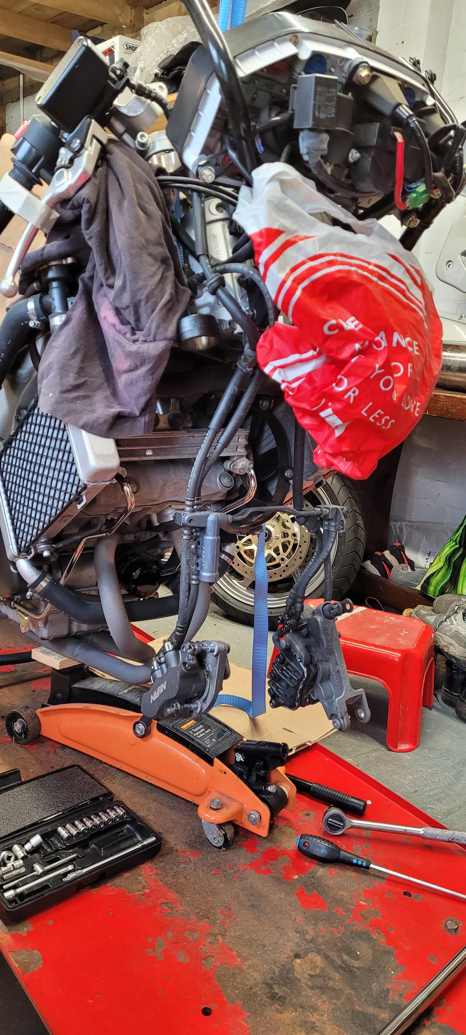

Scotland was a nice break and we even had some lovely weather too but now I know I have to crack on as I really need to get the suspension over to MCT before he gets too busy with the approaching season. So I've removed the forks ready to deliver but the rear shock has to wait until I can get a helper (Mrs Skids) to aid with removing and emptying a half-filled fuel tank so I can access the upper shock mount. Linkage plates came out easily enough though I'm wondering how to torque them back up as there is such little space in there the torque wrench and socket wont fit. I hope it doesn't involve removing the downpipes.

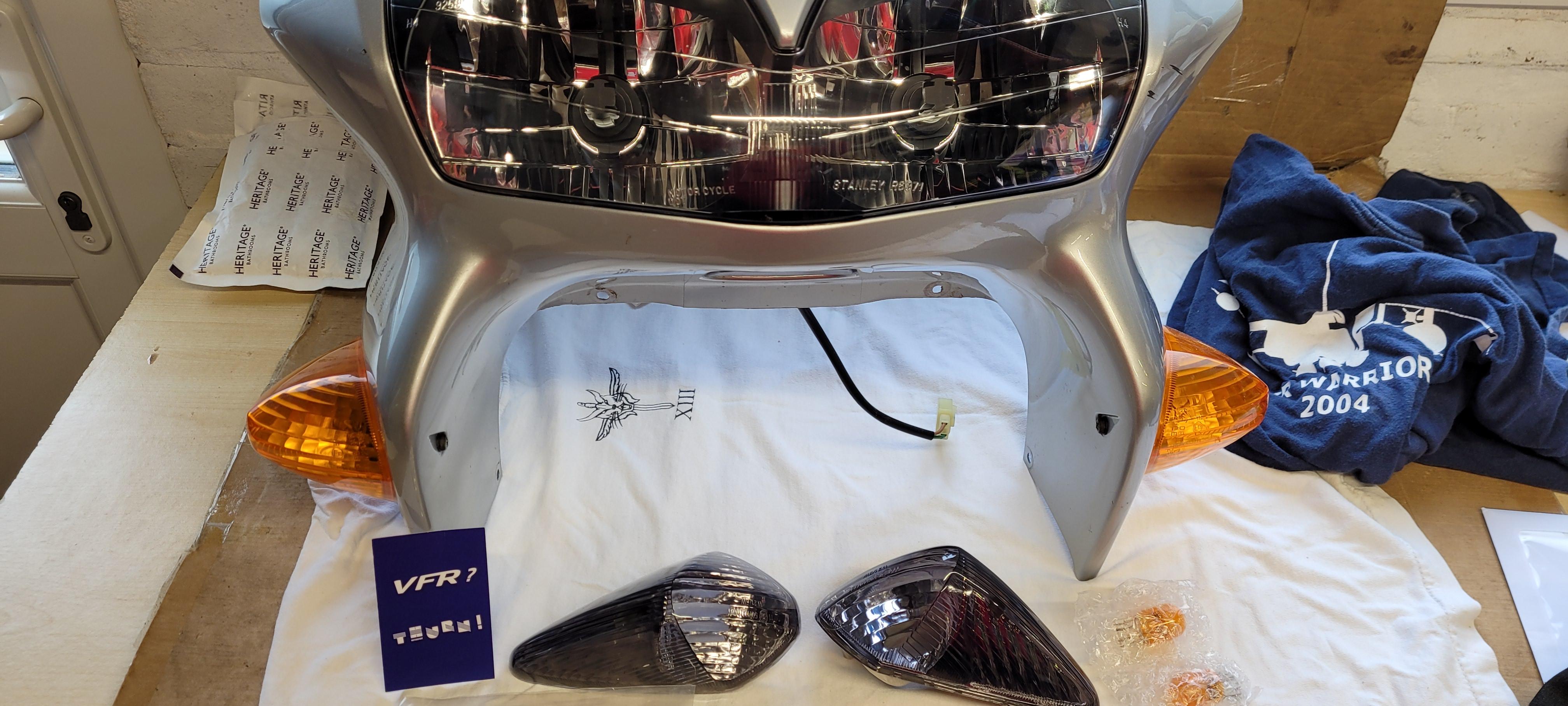

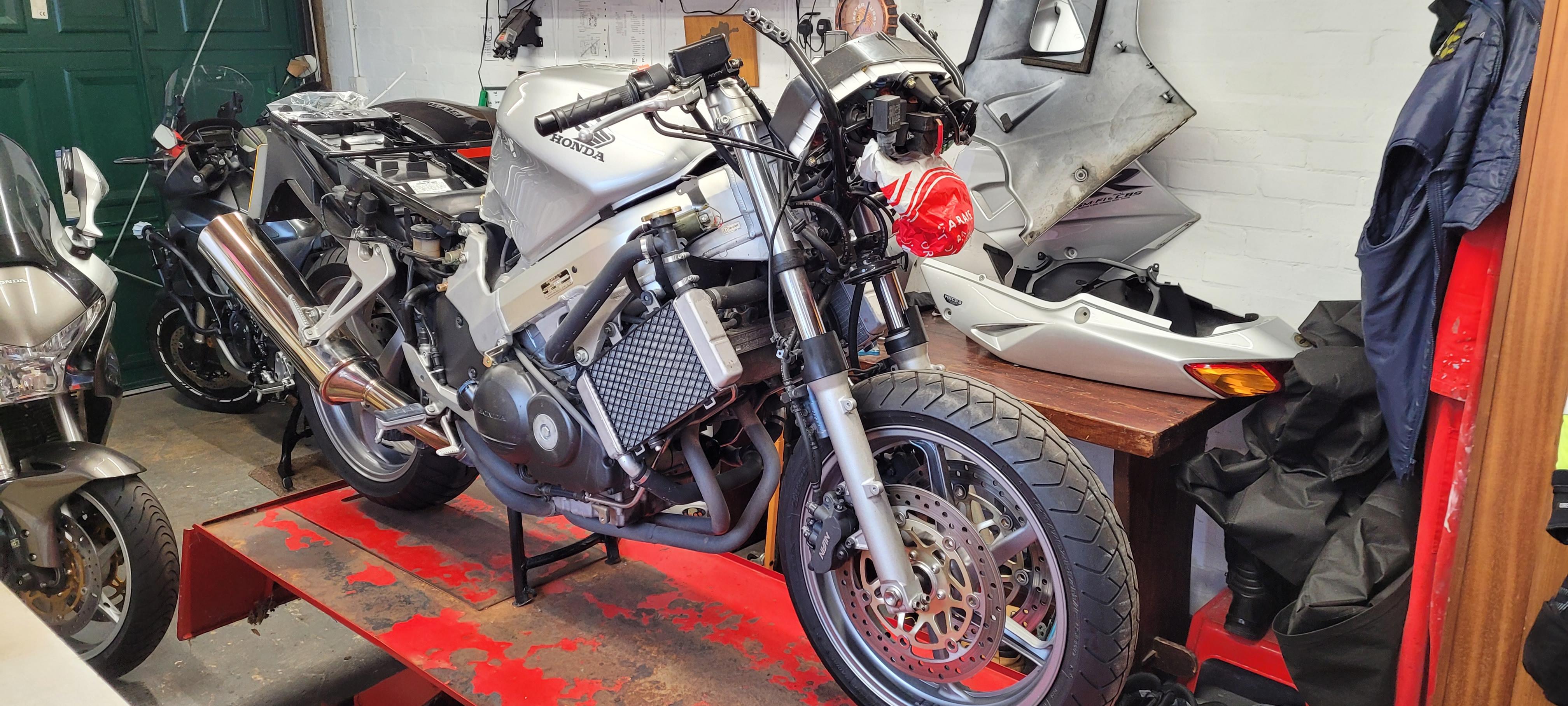

That nice man, Gerhard at Thurn Motorsports delivered the replacement smoked front indicator lenses today so I've fitted those to check them out. In Germany it's illegal to sell LED replacement bulbs so I will have to source some from over here. Can anyone confirm that these would work? Bought the indicators without having to pay import duty (thanks Brexit) because the total cost was under £135. I had to research that to check if the final price would be significantly higher with import tax. Oh for the days when we didn't have to worry about that!

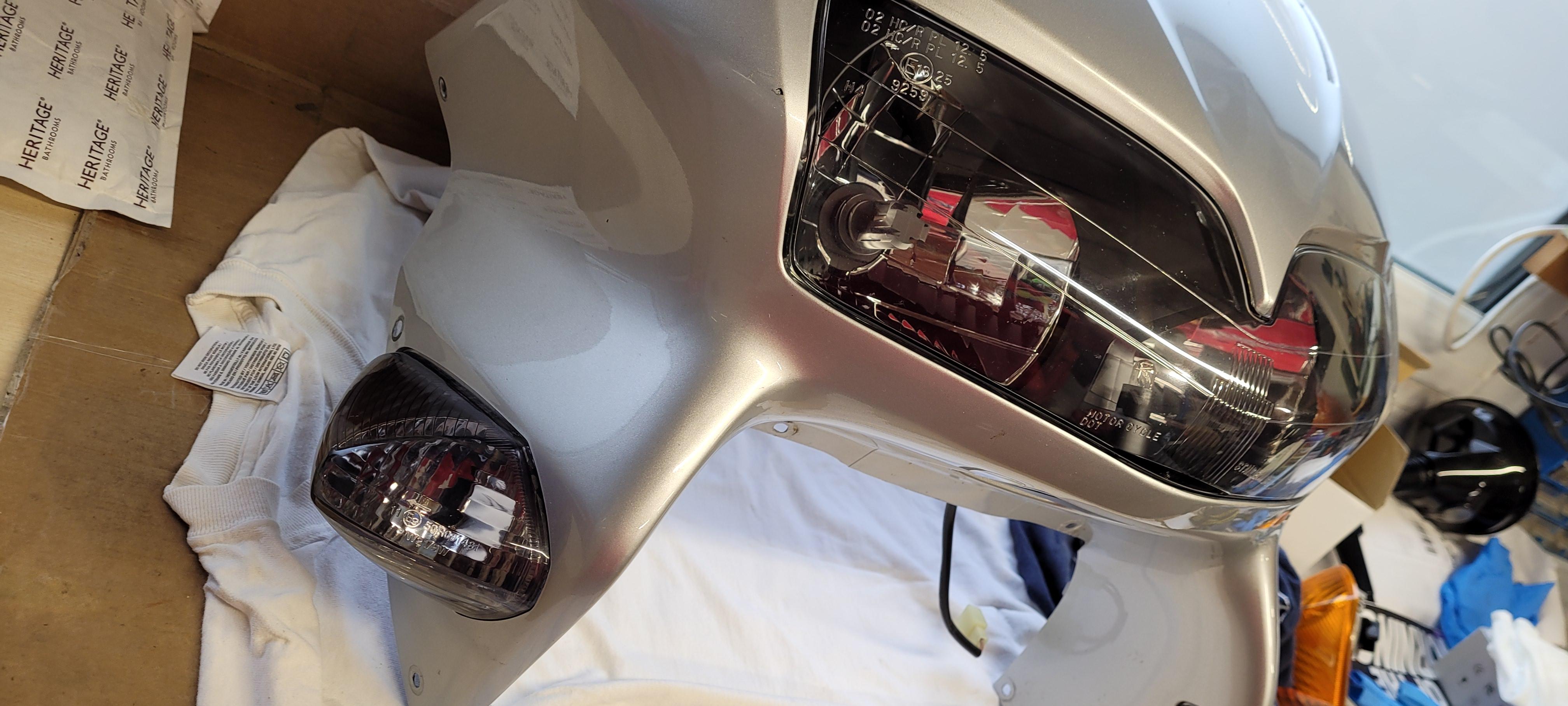

If you look carefully, you can also see the replacement LED headlamp bulbs which arrived whilst we were away. Straight replacement fit, no extra wiring or large fans or anything. Not been able to try them out yet as I've removed the battery from the bike but I will try them before putting the original incandescent bulbs back in for the MoT test. No intention of riding this bike at night, they are for safety as the VFR headlights, being so close together, are a unique sight and LED will only make that more obvious.
