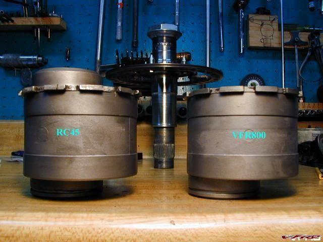

Member Contributer BusyLittleShop Posted October 20, 2021 Member Contributer Posted October 20, 2021 Check to see if the Axle rest at the 6 "O" clock position (Sweet Spot) which affords the greatest ride height... rotate the cassette forward and the axle rest towards the 9 "0" clock position which affords less ride height... rotate the cassette backwards and the axle rest towards to 3 "0" Clock position which affords less ride height not to mention possible slippage... 1 Quote

Member Contributer JZH Posted October 20, 2021 Member Contributer Posted October 20, 2021 I'm not sure which gen VFR we're talking about here, but it may be helpful to point out that the RC36 (3rd and 4th gens) have a different axle orientation than portrayed by BLS above. "Normal" for an RC36 is for the axle to be at the 12-o'clock position, rather than the 6-o'clock position. Indeed, this is why I was able to raise the rear ride height on my 3rd gen ~40mm by "flipping the eccentric" the other way. I think the 5th and 6th gens are the opposite (so, like the RC45 depicted above). Chains which do not stay "in adjustment" are usually in the late stages of life. Ciao, JZH Quote

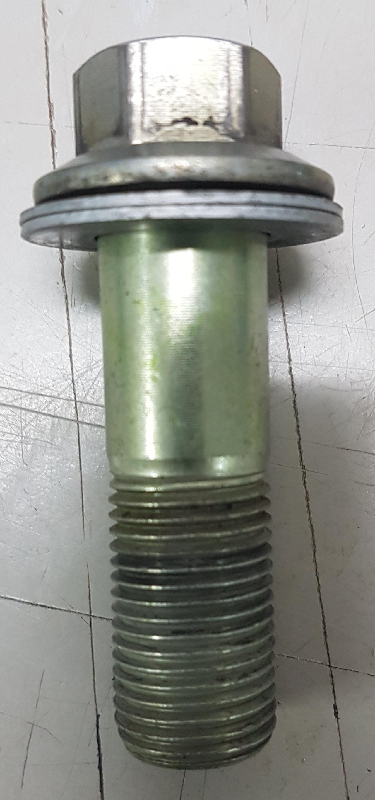

Member Contributer Terry Posted October 21, 2021 Member Contributer Posted October 21, 2021 If the washer/hose holder is not trapped between the bolt and the swngarm, the bolt can bottom out in the thread without putting full clamping force on the eccentric. Or so I've read. 1 Quote
Member Contributer Grum Posted October 21, 2021 Member Contributer Posted October 21, 2021 54 minutes ago, Terry said: If the washer/hose holder is not trapped between the bolt and the swngarm, the bolt can bottom out in the thread without putting full clamping force on the eccentric. Or so I've read. Interesting and good point you raise Terry. Just had a look at my 8gen and the pinch bolt thread is all the way through, just can't remember or find anything in the Service Manual as to the 6gen being or not being the same. Quote
jstehman Posted October 21, 2021 Posted October 21, 2021 6th gen pinch bolt hole in swingarm is threaded completely throughPaint marks on the adjuster and the swingarm to see if it's slipping, or the chain is about done dealinSent from my SM-N950U using Tapatalk 1 Quote
Member Contributer Terry Posted October 21, 2021 Member Contributer Posted October 21, 2021 Yes but does the shoulder of the bolt bottom out somewhere in the bore hole? Quote
Member Contributer Grum Posted October 21, 2021 Member Contributer Posted October 21, 2021 2 hours ago, Terry said: Yes but does the shoulder of the bolt bottom out somewhere in the bore hole? Think you could be right on the money here Terry. Absolutely needs checking that the washer/hose holder is fitted under the bolt head. Removed the pinch bolt from my 8gen. The upper section of the bolt hole is fully unthreaded, lower section is fully threaded. Took some measurements. When fully tightened there will be 4mm between the bolt shoulder and lower threaded section of the swingarm. If the two 1mm washers under the bolt head weren't there then you'd only have 2mm clearance, fairly marginal. Hope this is making sense? So if on the 6gen the washer/hose holder was missing, you might bottom out the bolt and not achieve maximum tightness on the bearing holder. 1 Quote
Member Contributer rhoderage Posted October 21, 2021 Member Contributer Posted October 21, 2021 You guys are so good... looking forward to OP confirming which option it is, but i bet you've nailed it I had the washer/hose-holder "ring" snap off last year... glad I went to Honda and replaced. My first thought was just to remove it, I wasn't worried about the brake lines moving... but I would not have even considered bolt length & threading and the potential of not having enough clamping pressure without it Quote
jstehman Posted October 21, 2021 Posted October 21, 2021 Did you measure the shoulder width vs thread width on the bolt? Honda parts fiche calls it a flange bolt 16x51. Sounds like a regular bolt Quote
Member Contributer Grum Posted October 21, 2021 Member Contributer Posted October 21, 2021 21 minutes ago, jstehman said: Did you measure the shoulder width vs thread width on the bolt? No, because what would be the benefit of that? The shoulder is at least the thread outer diameter. So the bolt cannot be tightened beyond its thread length, if the bolt shoulder hits the swingarm thread then thats the end, it can't be tightened any further. Sorry if I'm missing something here! Quote
jstehman Posted October 21, 2021 Posted October 21, 2021 34 minutes ago, Grum said: No, but what would be the benefit of that? The shoulder is at least the thread outer diameter. So the bolt cannot be tightened beyond its thread length, if the bolt shoulder hits the swingarm thread then thats the end, it can't be tightened any further. Ha! I meant length :facepalm: And I missed the post with the measurements Tapatalk locked me out of this for some reason and the last thing I read was about the bolt bottoming out Quote
