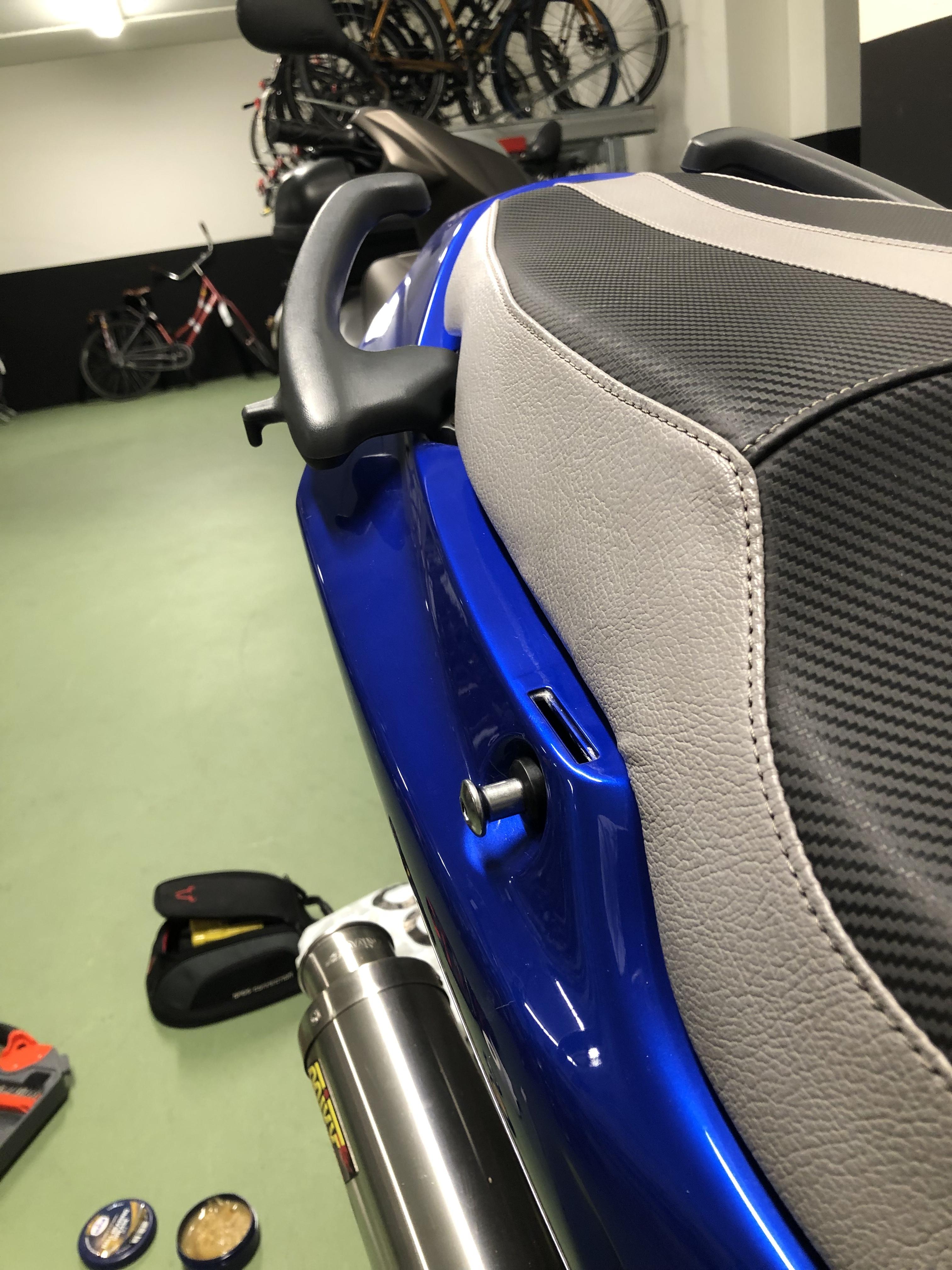

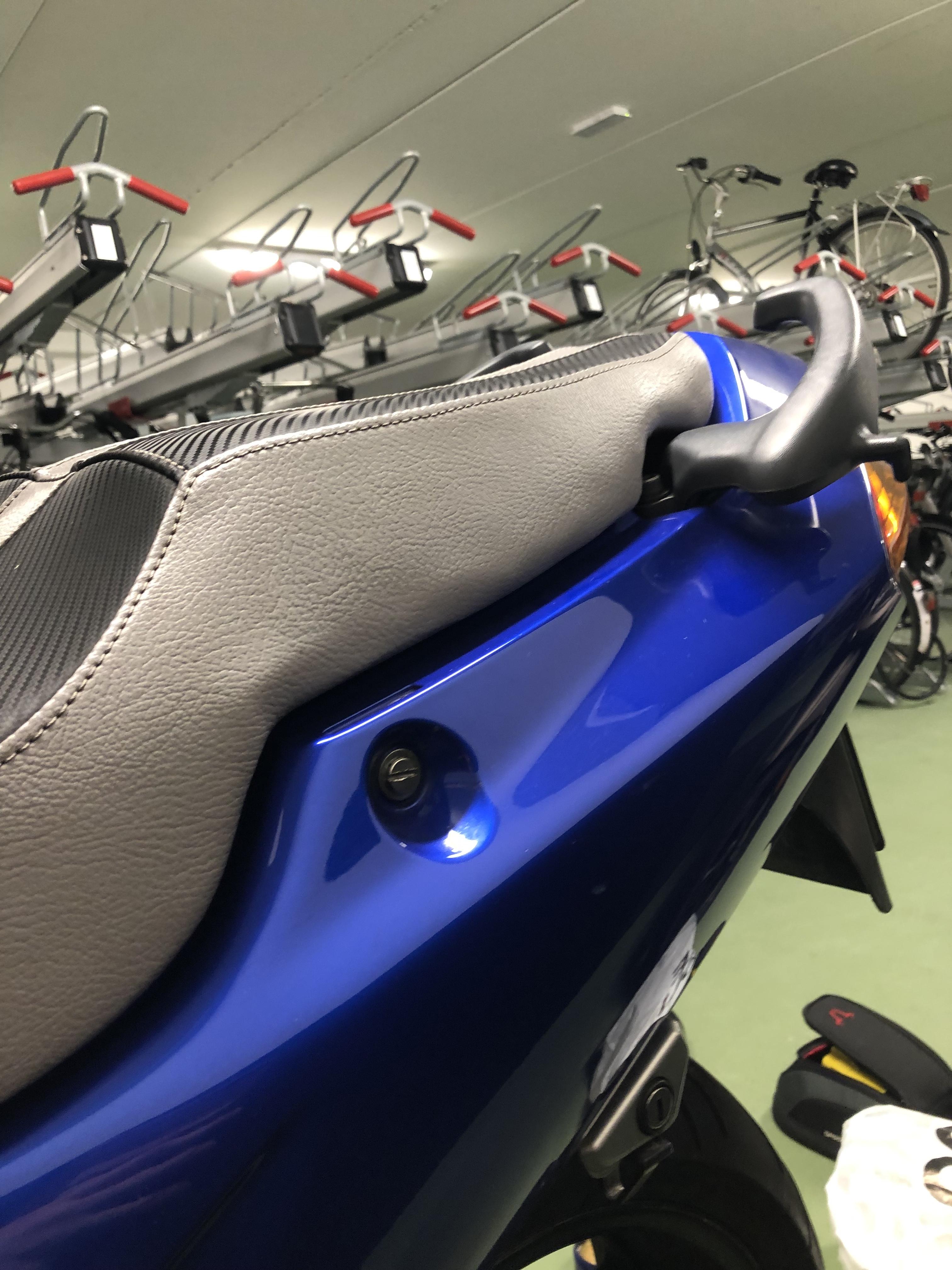

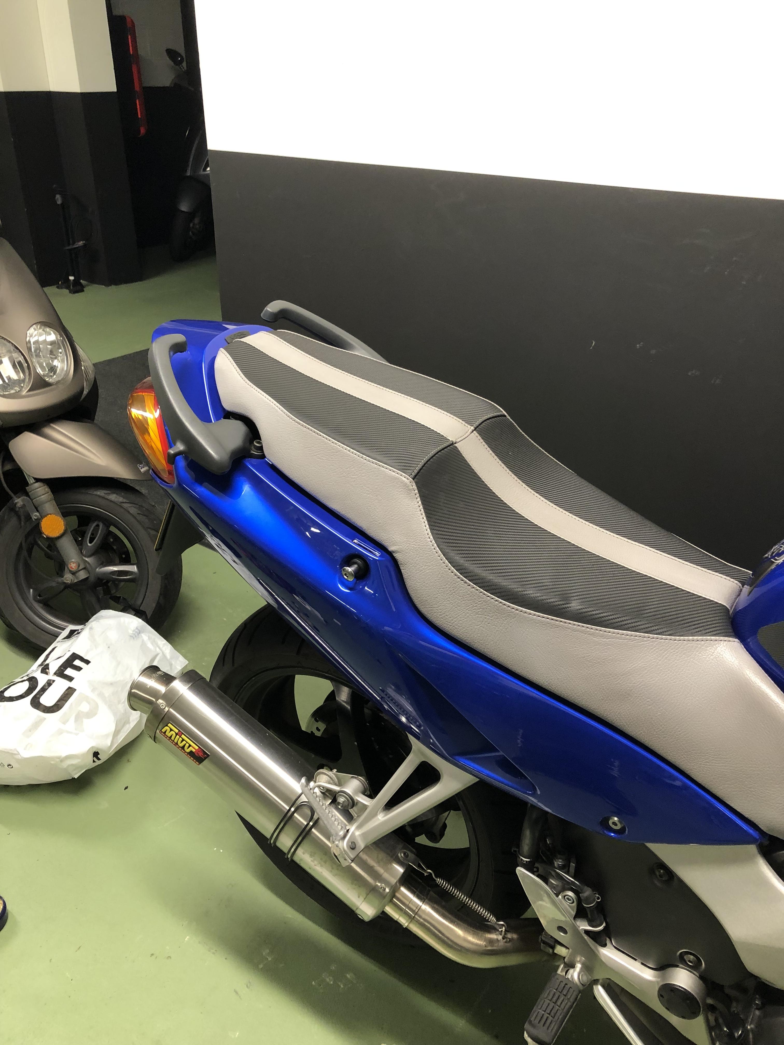

Just wanted to follow up on this. I bought all 3, the bolt, spacer, and collar. And they do fit beautifully. Attached are photos of the CBR frankenbolts and also what i had before (flat screwdriver flushmounts

Just remember you need a spacer between the frame & the rear cowl to stop the bolt breaking the cowl plastics. Those slots above the bolt are for the Honda spacer or the rear seat hump cover.
