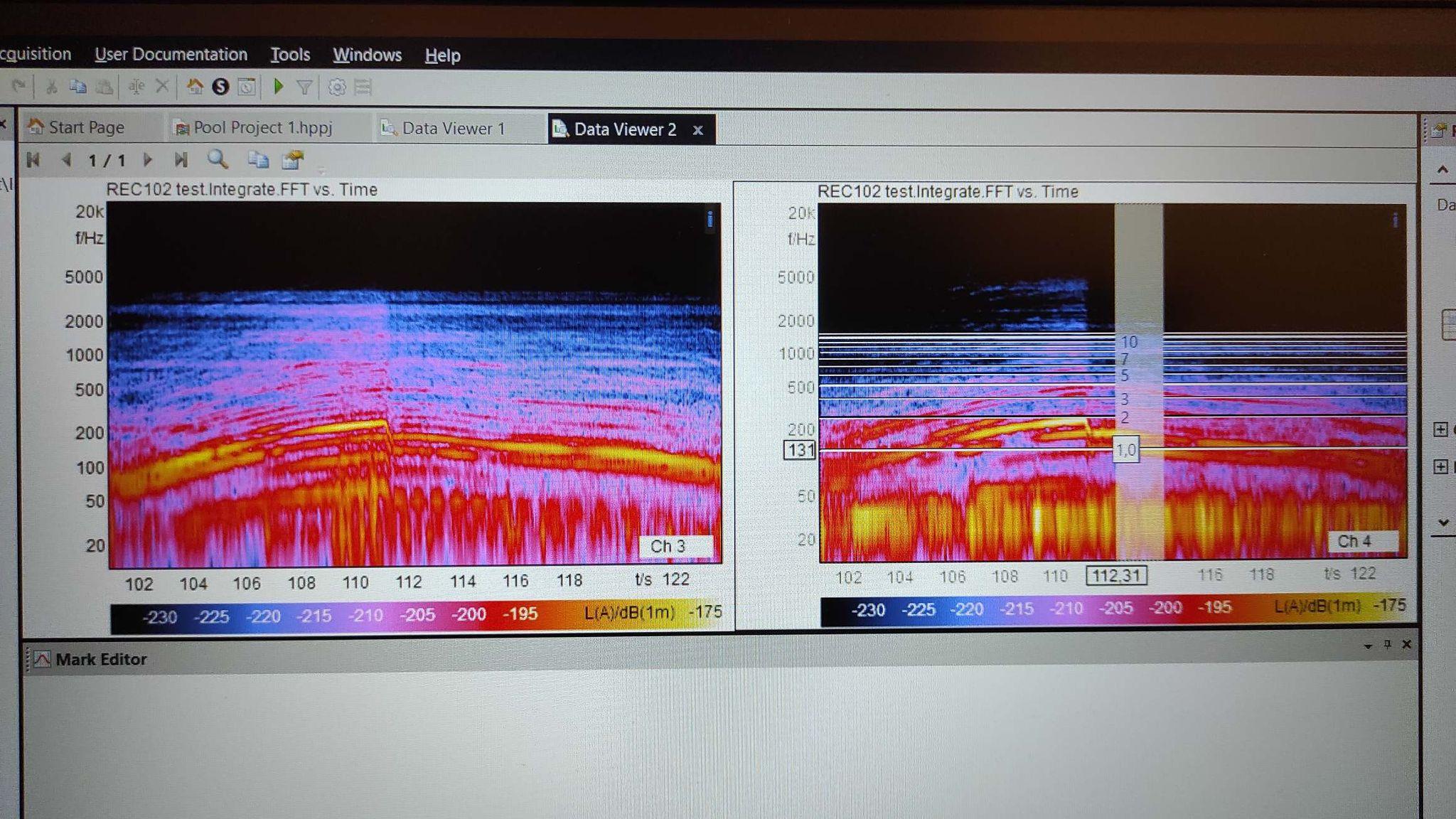

Redbike Posted September 20, 2021 Author Posted September 20, 2021 Thanks for the wishes 🙂 Well, with passenger or sporty style with more open throttle these vibrations already started from 4500RPM(from 106sec on the printscreen). This measurement I did without passenger. Left picture (sensor bellow the driver seat) shows this dominant vibration with high amplitude-yellow color in this waterflow diagram till 111 sec when I closed the throttle when reaching 8000RPM. On the rear seat this frequency was also dominant. + the 20-50Hz range showed the bending motion of the subrame far from the bolting point at the tank. But both position the 200Hz frequency I highlighted like the main symptom, what I found should be from the motor firing operation at this RPM. I did this investigation to help the dealer service center to find the root cause and solve it for my big-big happiness. But the service leader told me, has no idea they could offer me max. to retighten the subframe, if it helps... I was a 50 years old child having this loved Vtec, what I also 3D CAD modelled for myself when first came to the market. The 1200, however it won't be this nice Red, must perform without issues not to change it to some BMW boxer.... Quote
