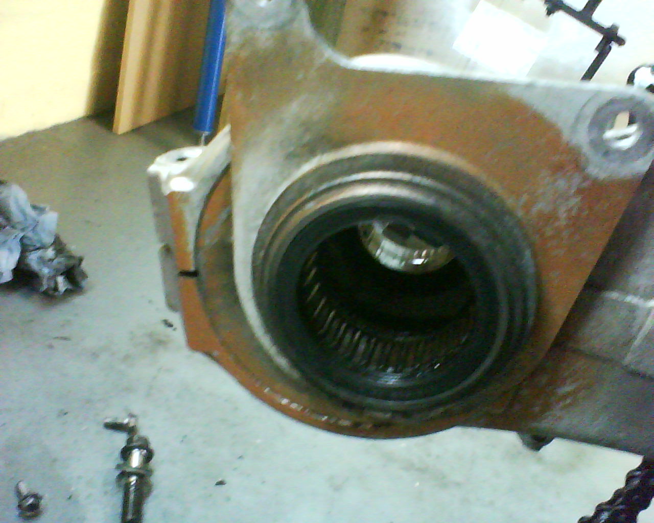

Today I decided to take the rear wheel off, clean around the swingarm and inspect and grease the eccentric bearing holder. It soon became clear that previous owners have not exactly done much routine maintenance.

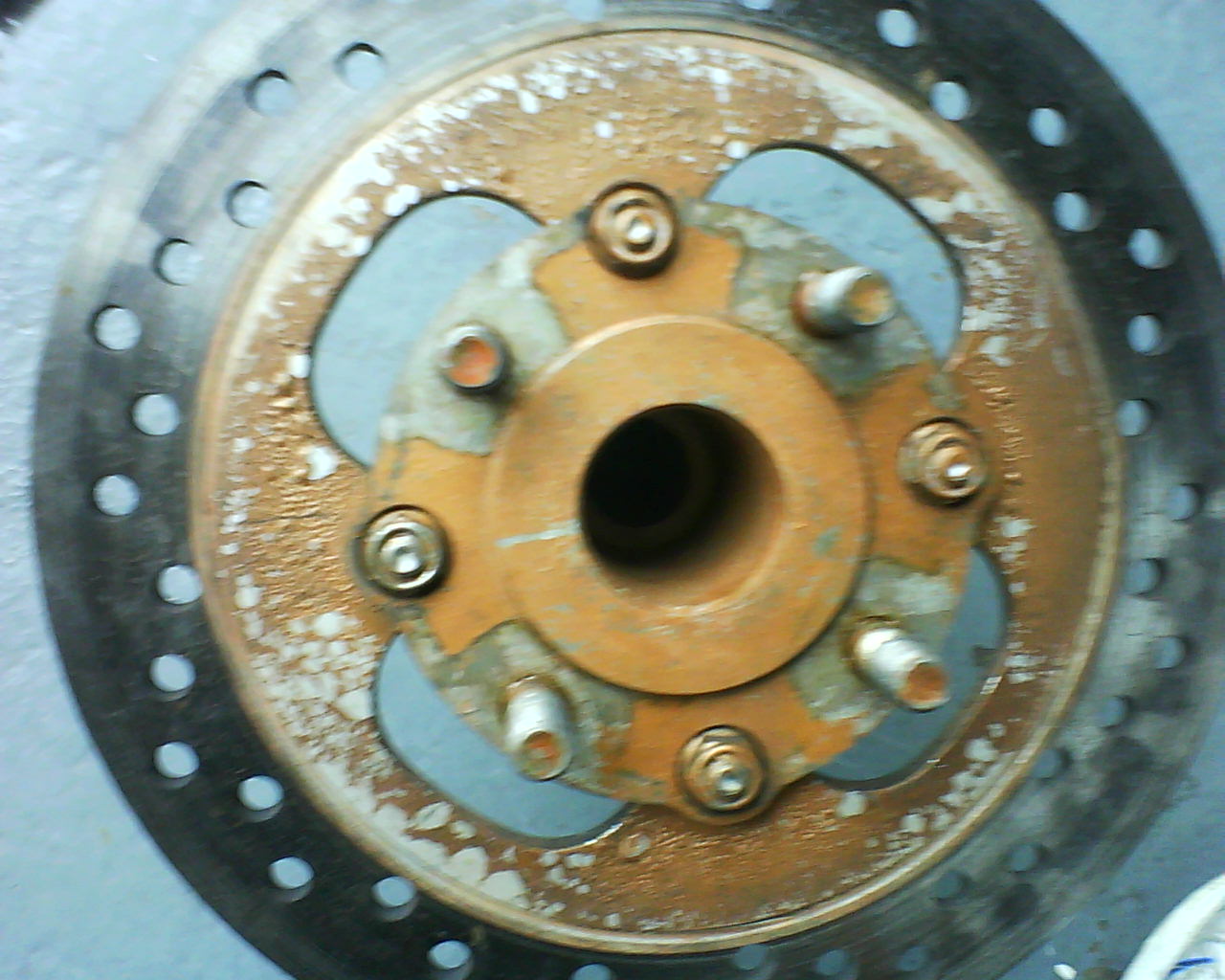

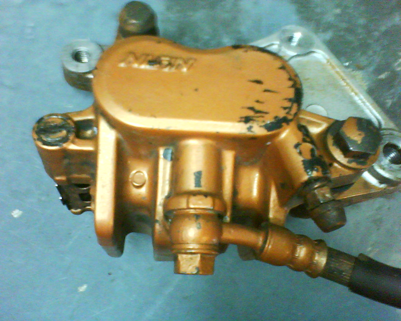

Firstly check this out : a previous owner decided to spray the brake calipers an attractive copper colour. Unfortunately they seem to have sprayed the rear one "in situ" and done an absolutely shoddy job!
It might not even be possible to clean that off everything without lifting the original paint. Grrr!

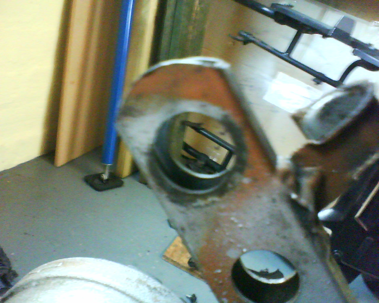

I found it very difficult separating the axle/brake assembly from the bearing holder. I literally had to use a sledgehammer! Even after that, and removing the circlip,  it was a pain getting the free bearing holder out from the swingarm. I know that prising the swingarm halves apart with a large screwdriver helps, but there was a lot of grit inside the swingarm which stopped it sliding out. Eventually I freed it using compressed air to blow the grit away. One piece of grit was about the size of a pea!

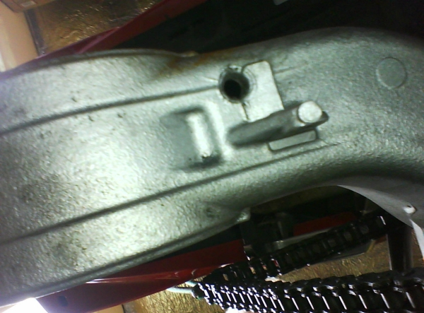

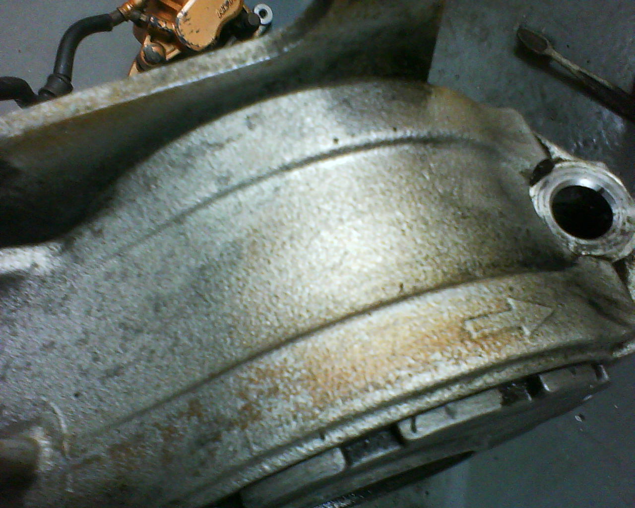

How did it get there? There is a small hole in the bottom of my swingarm. Has anyone else got this? Presumably it's meant to be there, but I'm definitely going to plug it up.
Is the hole possibly a drain?  If so, maybe not a good idea to plug it.  Can you add a photo of it?
BTW - love your tag line at the bottom.  Two of my pet peeves in "modern" English are the use of "like" and "right" repeatedly - sometimes multiple times in the same sentence!  :wacko:
That hole is there by design.
Hole is there by design. Drain for water. There should be another hole closer to the swingarm pivot.
Did the PO just spray paint the rear caliper?

Yes Cogswell, it's definitely a drain hole.
I will try and find a rubber grommet and just drain it from time to time. Yoshi, thanks for pointing out there's a second hole! The front calipers were also sprayed copper, and there's some silver overspray on the rear shock. I'm all for looking after bikes, but wish it has been done properly!

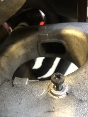

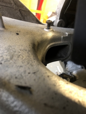

Anyway removing the shock reveals these two giant "grit intakes" in the swingarm. I can't see Mr Honda's reasoning, maybe someone can explain the point of these holes?!
Also once I'd cleaned around the front sprocket, I notice there's a little free play in it, see video. Is this normal?
No idea, but they make a good place to feed the brake line through the swing arm.  I've seen people epoxy screens over them; I've seen people fill the whole thing with expanding foam.  I wouldn't bother plugging the drain hole: the grit probably entered through the large holes anyway.

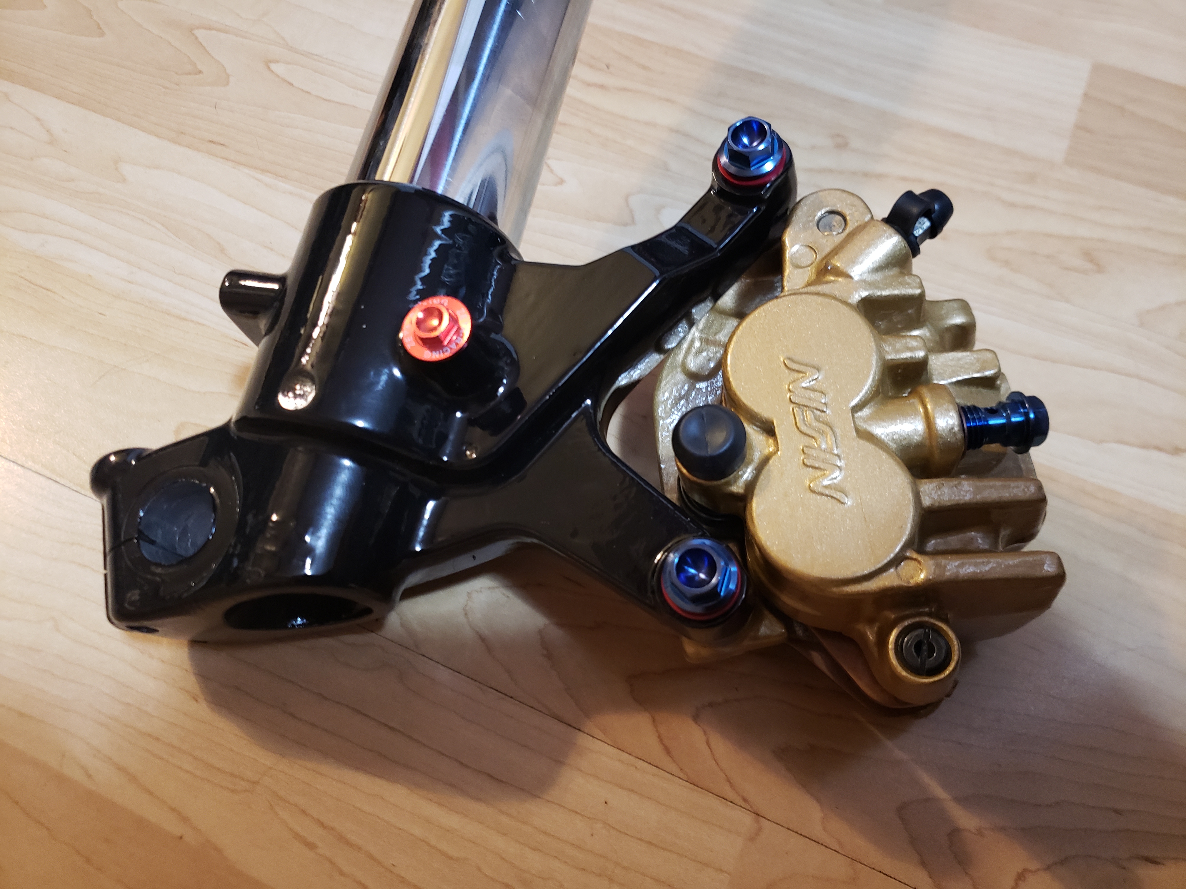

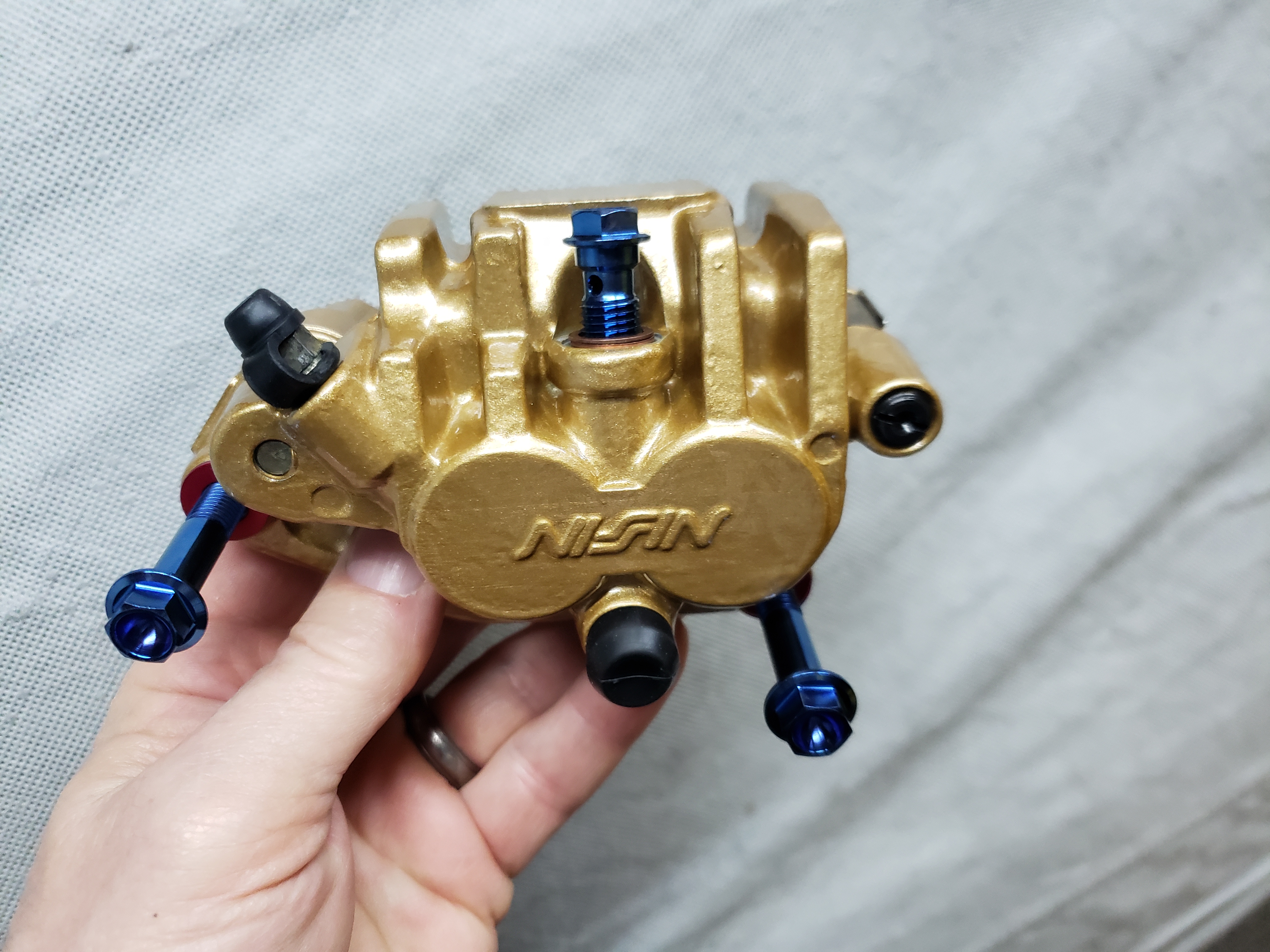

The G2 caliper paint works great, I used it on my DRZ400 Super Moto calipers, and it came out great! I brushed on 3 coats a few years ago and they still look perfect! Ebay and Amazon both sell it.

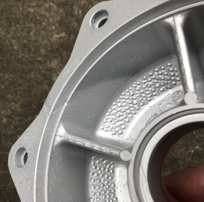

Here's something weird. A previous owner had painted the hub sprocket carrier thing with a brush. It looked disgusting.
When I got it back from the vapour blaster I can appreciate why they might have done that - this huge manufacturing flaw is revealed:
I call it my "fault line". It's as if the piece was cast in two instalments!
What do you think? It's not likely to break in two, is it?
Eventually that’s going to fail, given that it’s got a steel ring, the sprocket, around it then it’s probably going to last a long while
Theres a few on eBay for £35
Personally I’d regard that as £35 well spent
I reluctantly agree, Thumbs. Two things annoy me:
1) Honda must have sold the bike like this.
2) The vapour blasters should have phoned me as soon as they saw the flaw. They are bikers themselves FFS! Instead they coated it and charged me more.
Agreed on both points
IMHO that appears to merit replacement.  Not just that it could fail,  but the consequences of it doing so could be severe.
Although that could have been manufactured by a subcontractor,  it is still very un-Honda like for something that obvious to slip through their QC.
It looks like they ran out of material, waited a few minutes, and poured some more - I would replace it just for piece of mind.
Maybe mail it to Honda and ask for an explanation...
