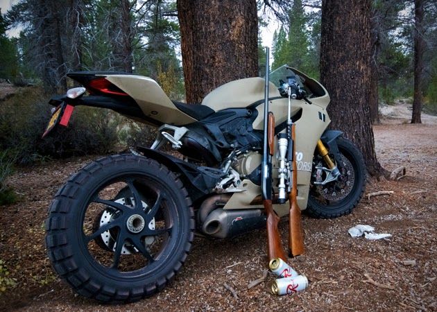

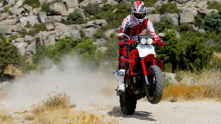

squirrelman 195 Posted November 12, 2020 Share Posted November 12, 2020 that random bike (above) is an abortion, and i wouldn't copy anything. it was built to impress ppl who know style but nothing about motorcycles. A vfr isn't a good offroad bike so no offroad tires; it's insane ! too much power and weight for dirt, tires no good for street. another show bike. 1 1 Quote Link to post Share on other sites

Member Contributer Cogswell 1544 Posted November 13, 2020 Member Contributer Share Posted November 13, 2020 It's just my own opinion and I could be FOS, but I suspect that many 3rd gens were broken for their 8 spoke, so it pains me to see another morphed in to something else that probably only the person doing it will like. Once they lose interest in it, it will then be broken for parts since it won't have appeal to anyone else. The gen 3 is such a beautiful and classic design that I wish more were preserved in their original state. I can't remember the last time I saw one in person. I'd love to own an original example, but for me time, money and space make that impractical. Quote Link to post Share on other sites
Member Contributer RC1237V 215 Posted November 14, 2020 Member Contributer Share Posted November 14, 2020 Seems like many 3rd gens get crashed and made in to off road rides. Probably cheaper than putting it back to stock. He is not the first, nor will he be the last as parts are getting harder and harder to find... Quote Link to post Share on other sites

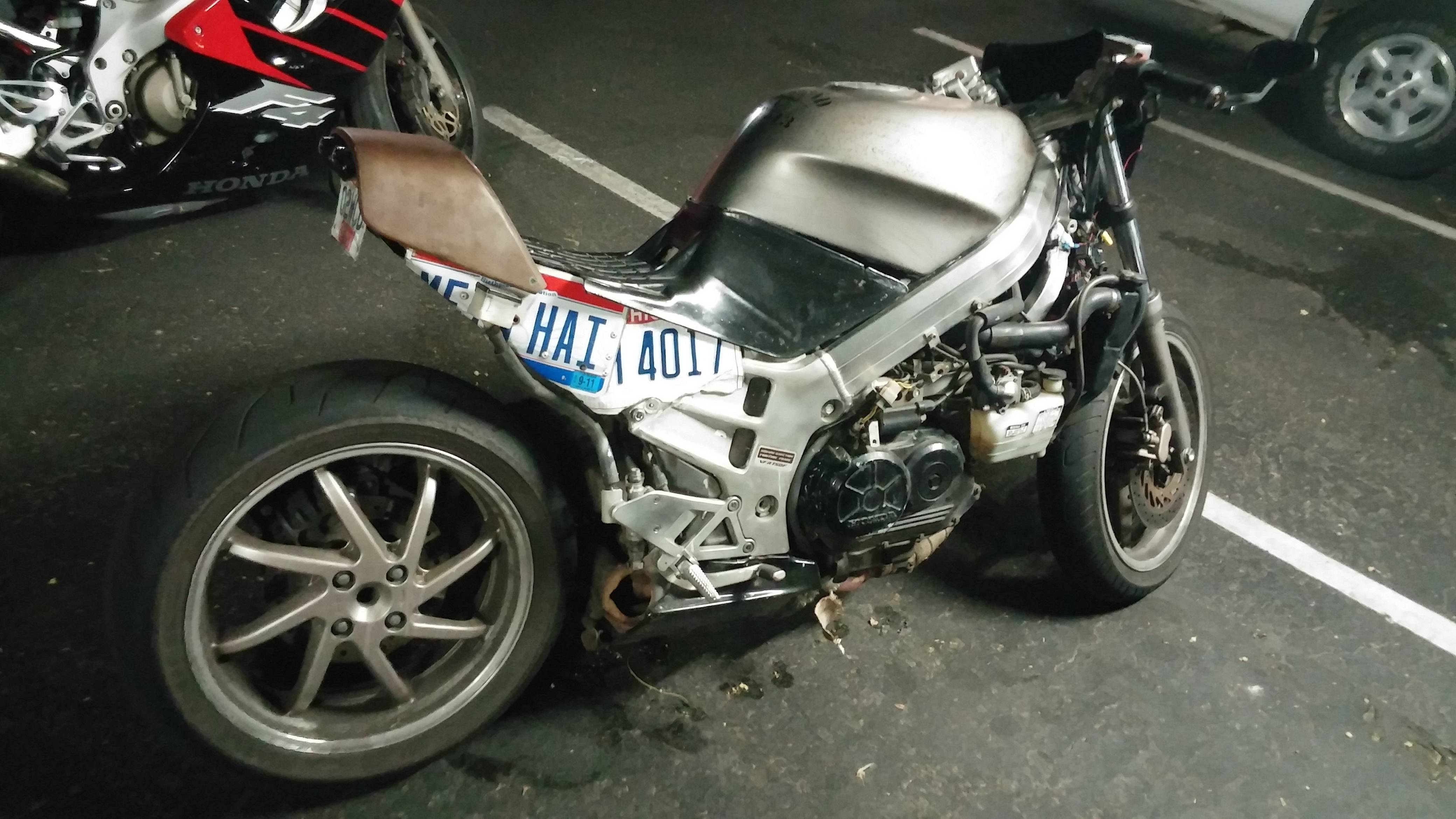

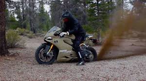

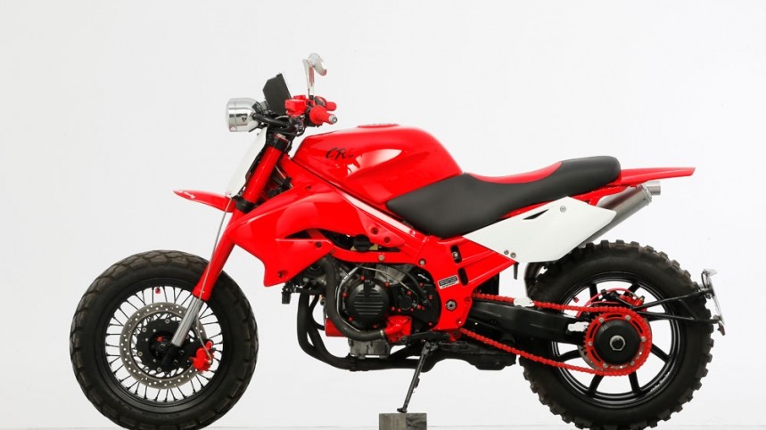

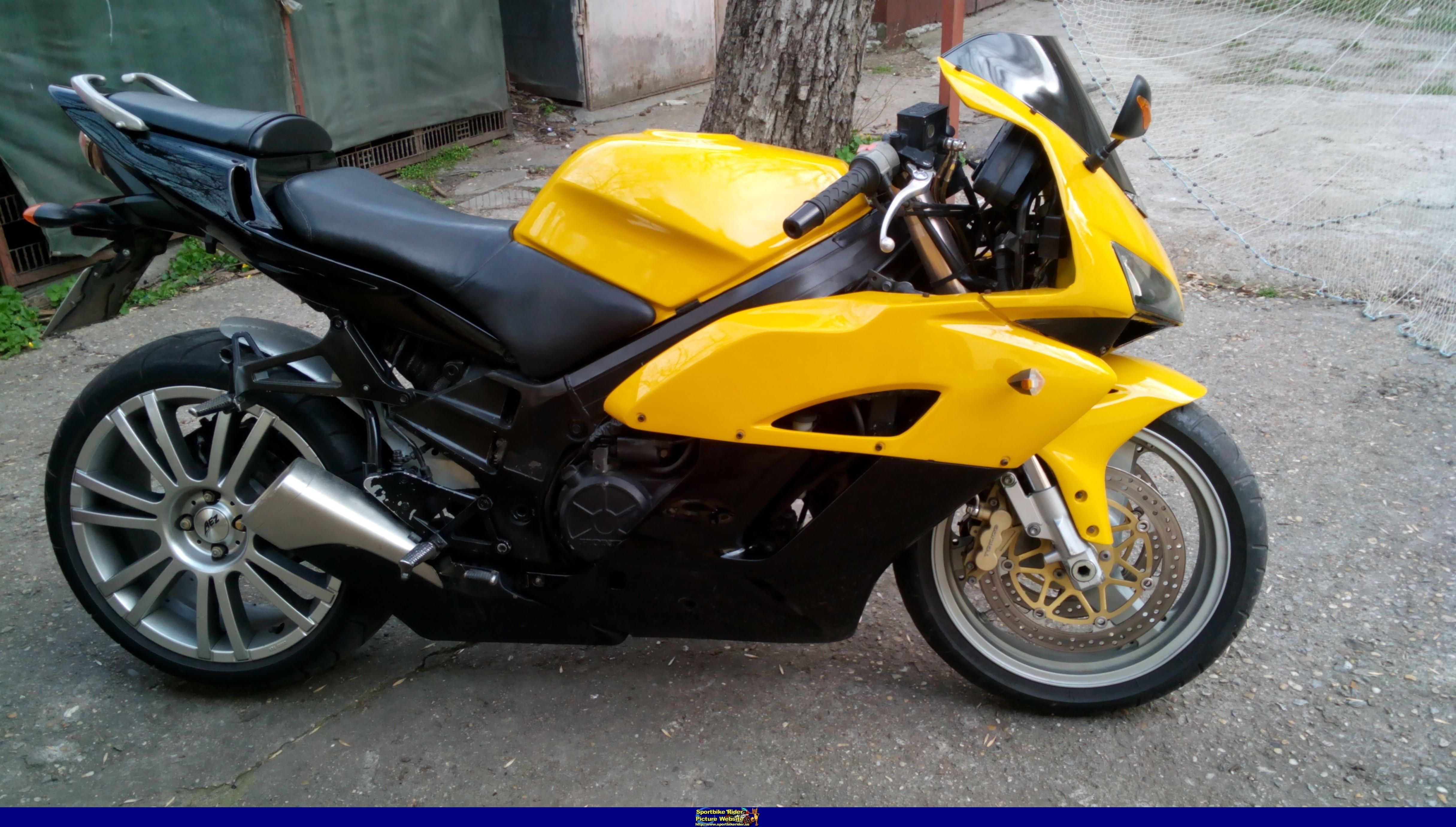

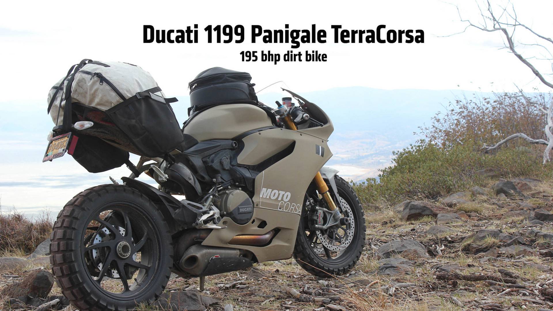

Member Contributer RC1237V 215 Posted November 14, 2020 Member Contributer Share Posted November 14, 2020 And then there is this guy.... Quote Link to post Share on other sites
Member Contributer RC1237V 215 Posted November 14, 2020 Member Contributer Share Posted November 14, 2020 Or you could do it to a $20,000 bike instead.... Quote Link to post Share on other sites
Member Contributer RC1237V 215 Posted November 14, 2020 Member Contributer Share Posted November 14, 2020 It's hard to kill a 3rd gen, but people have tried....they seem to be the one people tear into the most because they can be found so cheap.... Quote Link to post Share on other sites

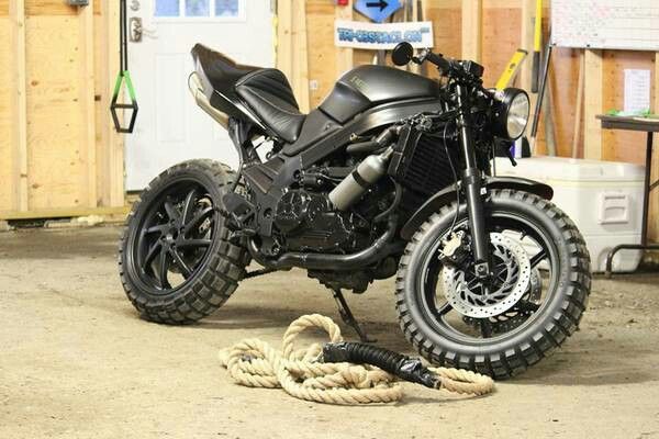

Captain 80s 218 Posted November 14, 2020 Share Posted November 14, 2020 I just puked in my mouth a little bit... burns Quote Link to post Share on other sites

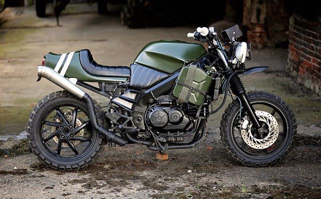

Member Contributer RC1237V 215 Posted November 14, 2020 Member Contributer Share Posted November 14, 2020 I did the same when I saw this one.... Quote Link to post Share on other sites
